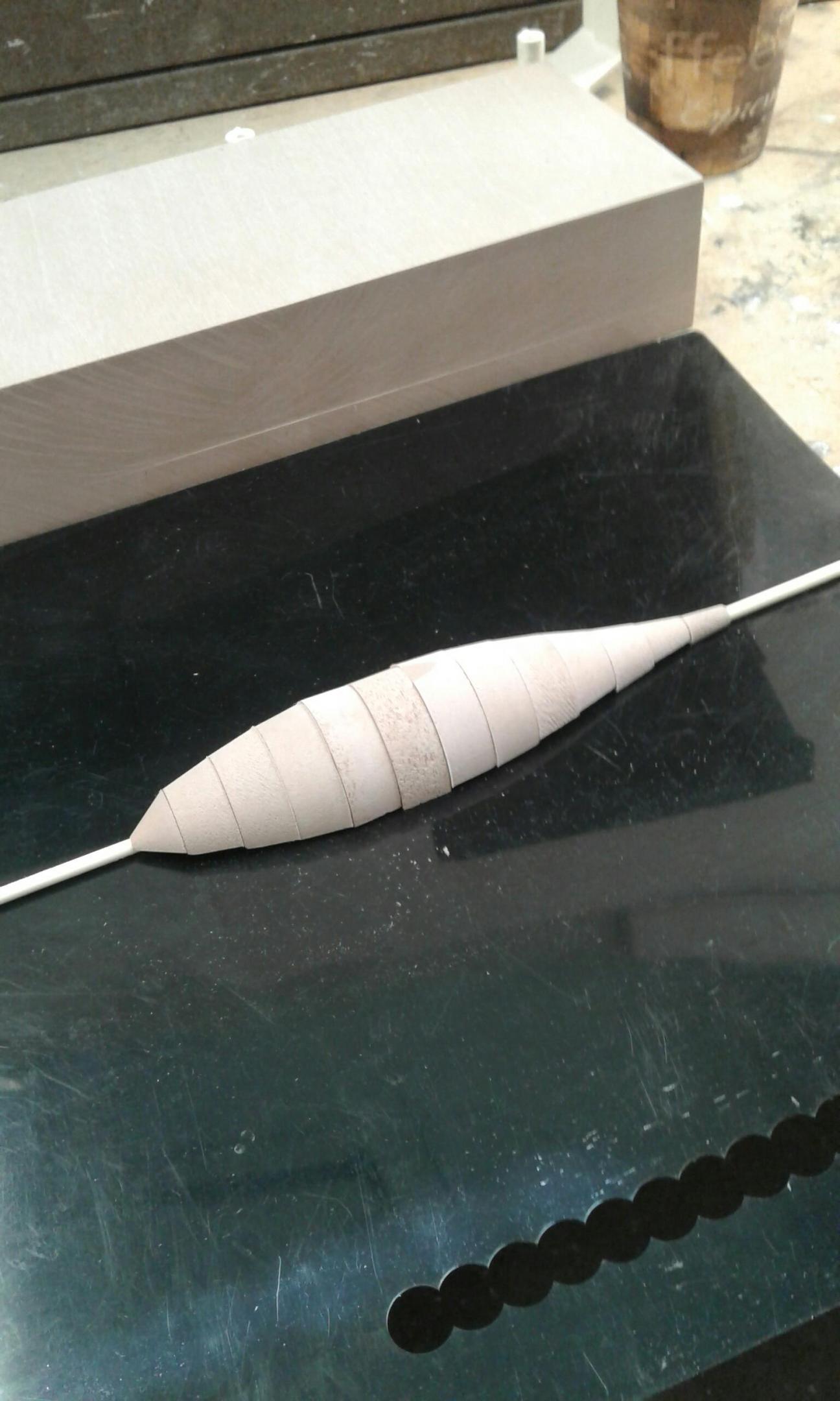

My next project will be a belly tank racer. I will vacuform the body using model board for the plug. I turned  each station to P38 aircraft specs with a .149 hole running down the middle of each one then cut each station 1/2” in thickness resulting in 13 “doughnuts”. Then, I cut them in half and will glue them together to layout on a platen that will have a .149 half rod down the middle for alignment. The photo shows the stations put together laying on an alignment rod unglued and unsanded at this time. I will do the same with the other stations to make two identical halves. I’ll keep updating as I go along whenever my honey loosens the leash.

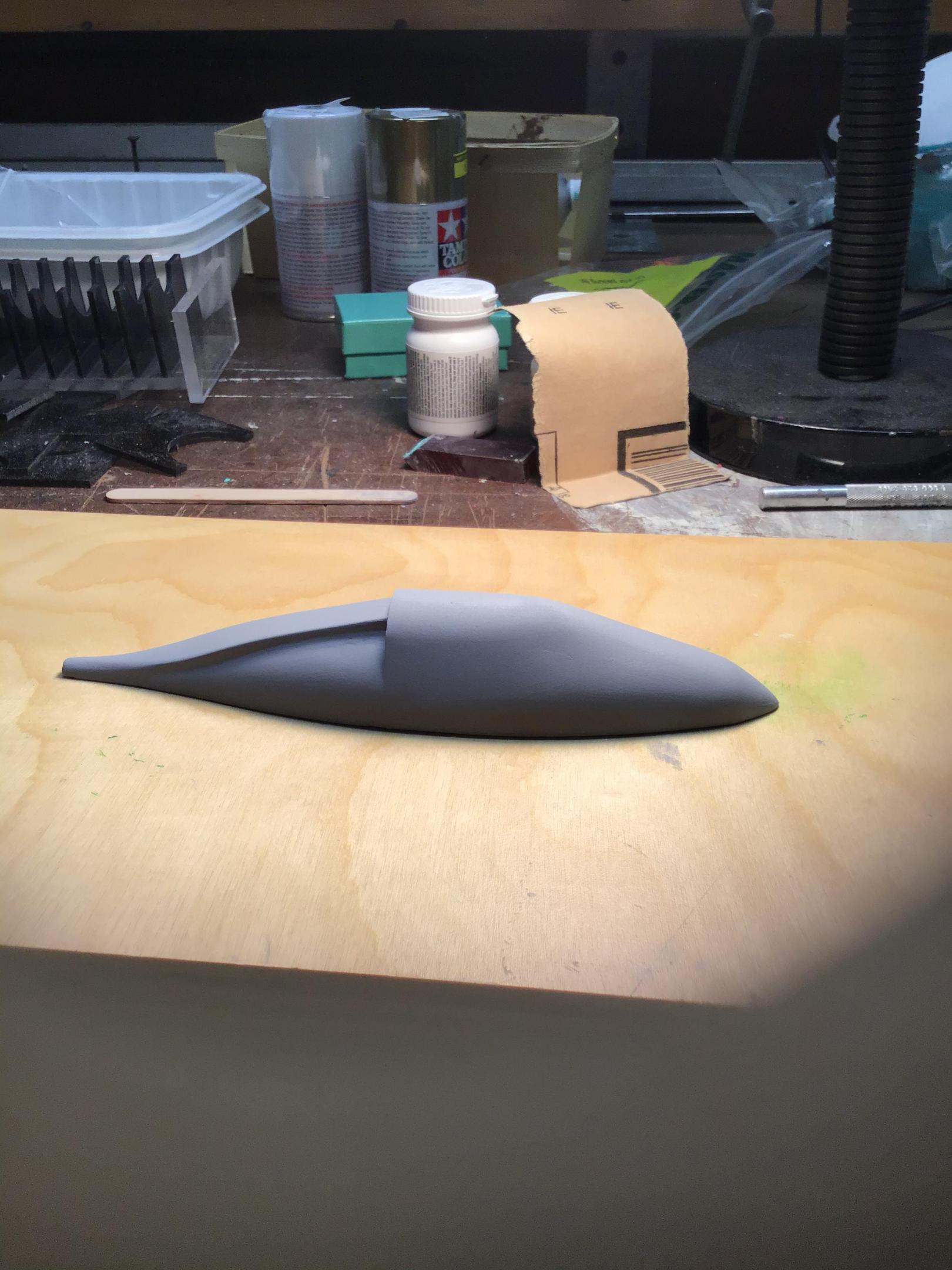

Moving right along, I finished my master and made silicone rubber molds to cast solid vacuum form plugs. I formed the halves with .062 thick polystyrene. I will attach a .03 flange all around the top half with MEK and pass them around to friends. The last photo shows a converted master top for my personal use. I’m planning on casting this with a clear .062 PETG sheet in order to mask off the canopy and paint the rest. This will look similar to the 2013 GM belly tank.
