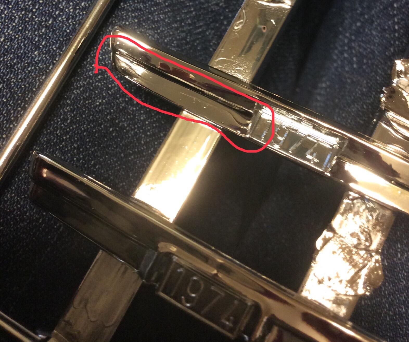

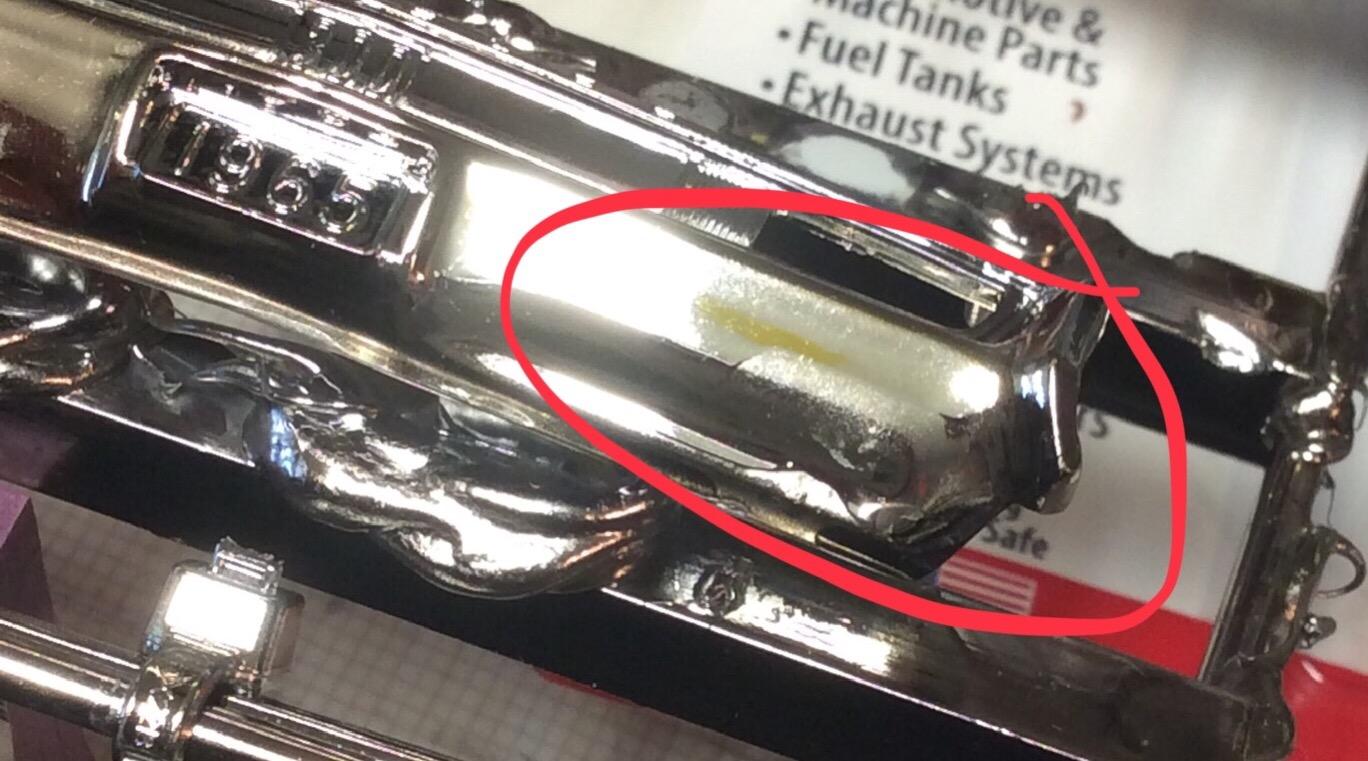

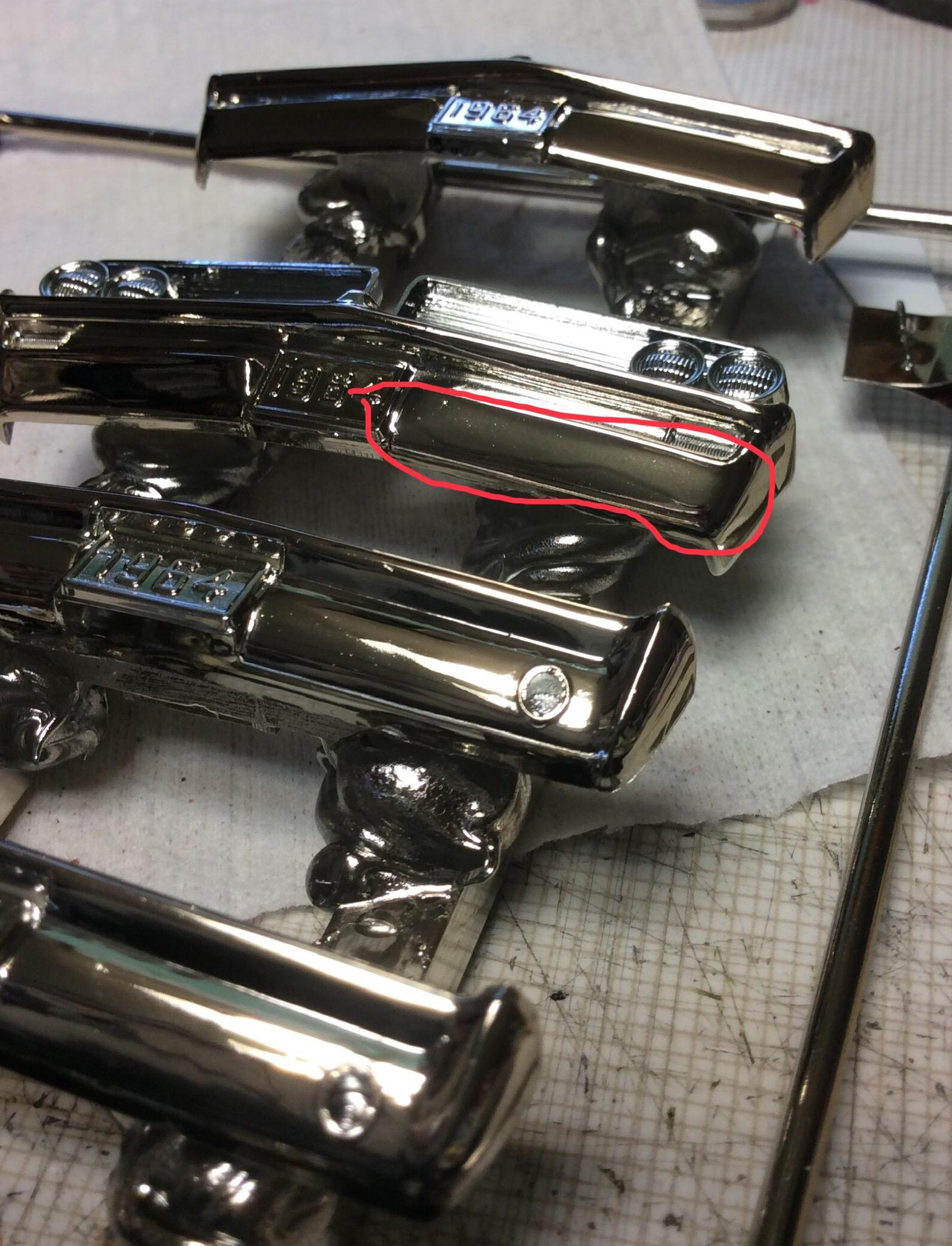

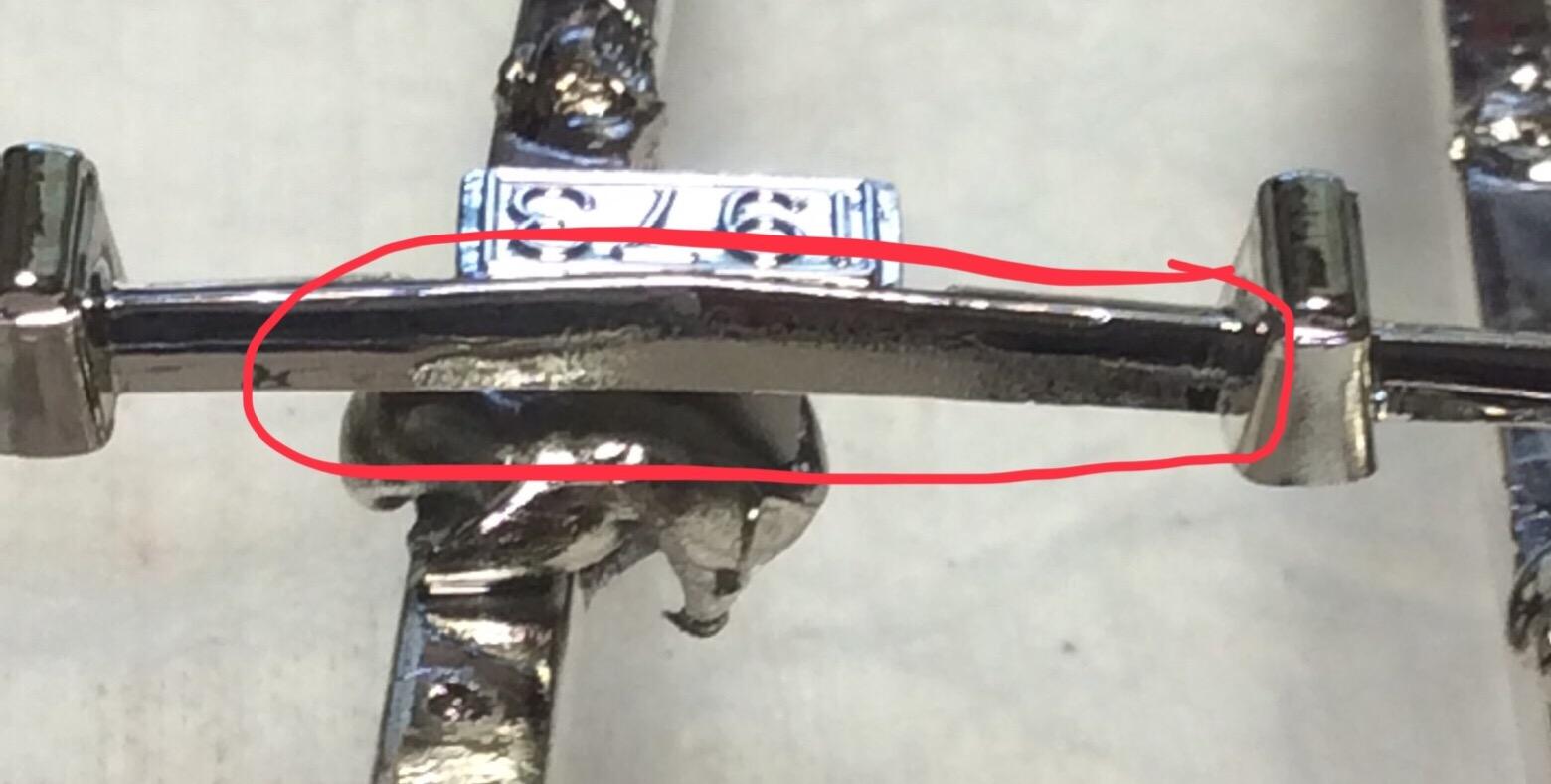

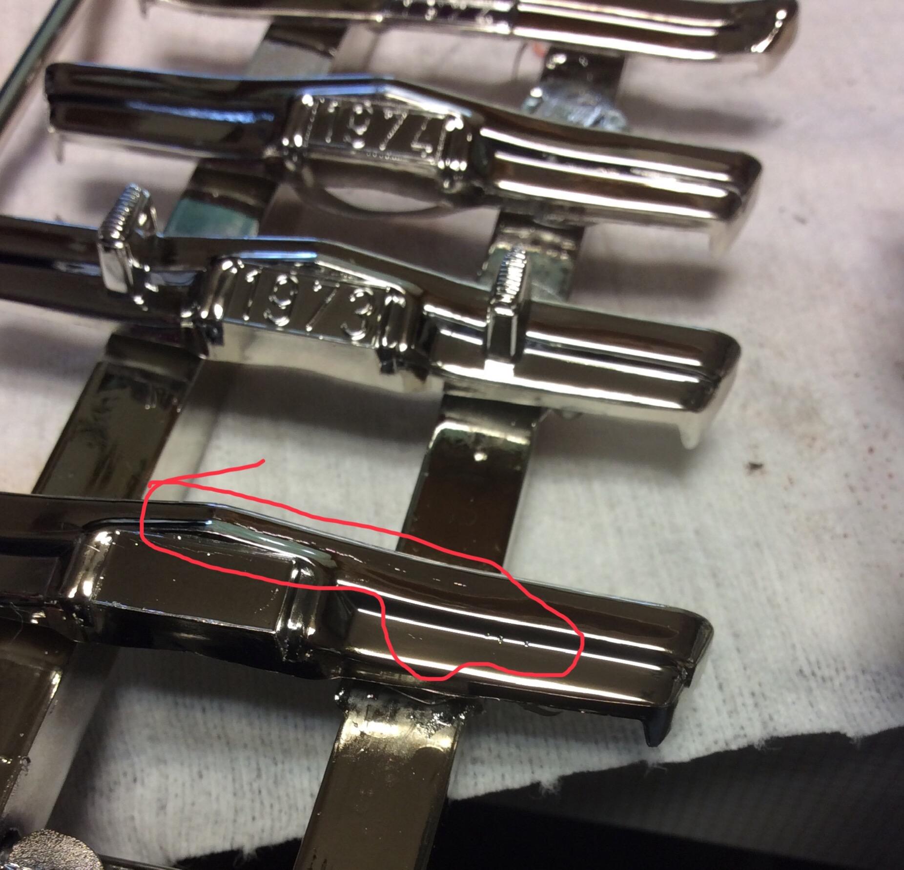

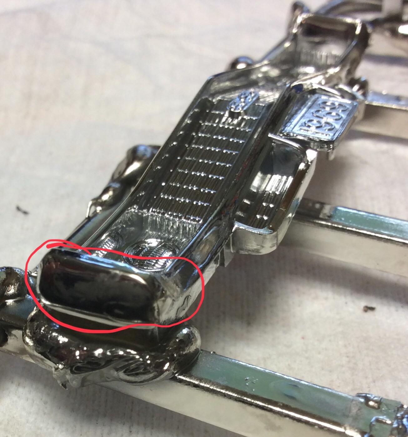

GoodbuildNY Posted March 15, 2021 Share Posted March 15, 2021 Hello all, As the title says I’m unhappy with the results of chroming that was done. First, I’m not going to say who had done the work as I don’t want to turn this into a bashing session on the vendor. Let me explain a little. I’ve sent many racks out to this place and a majority of the time no big issues although the second to last order came back with some mild discoloration and what looks like dust in the chrome but overall I was still happy. This last order I got back was definitely worse than the last. I’ve included some pics but they don’t really do it much justice. The discoloration ( kind of goldish in hue) is more prevalent, more what looks like dust and tiny bubbles in the chrome, dull patches and runs in the chrome. I’ve used the same tedious process every time in my prep including even blowing off the racks with the computer canned air before putting them into new ziplock bags. The parts were stripped in super clean, rinsed thoroughly in warm water, than washed with warm water and dawn followed by another rinse and blown dry with compressed air. Not every part looked bad, some looked fantastic, especially all the wheels that came back. It was mostly on the bumpers. I don’t know if it’s just me being overly picky or if this result is not typical. I don’t want to be that guy complaining so I’m reluctant to contact the vendor. What do you guys think? Quote Link to comment Share on other sites More sharing options...

espo Posted March 15, 2021 Share Posted March 15, 2021 I agree that you have a write to be unhappy with the results. That said I would contact the person that is doing your chrome work and let him know that you're disappointed with this set of bumpers. I would give him a chance to correct the problem and I would suggest you contact him ASAP. They may not even be aware of a quality issue and you should at least give them the a chance to correct the problem. I have no idea how this all would have happened but I would think that making you a happy customer would be more important to him than any profit he maybe making on this. I would do this before airing any problems with his work and there may be a problem with the bumpers that this is as good as it gets, but he should have a chance to explain that if that is the case. Let us know if he just stiffs you on this because that is something we would like to know as well. Quote Link to comment Share on other sites More sharing options...
Plowboy Posted March 15, 2021 Share Posted March 15, 2021 Contact them, strip them once again and send them back. Is it possible that you didn't get the clear coat underneath the chrome off completely? Quote Link to comment Share on other sites More sharing options...
peteski Posted March 16, 2021 Share Posted March 16, 2021 (edited) Well, I know of currently only one "plating company" that caters to modelers, so unless you found someone else we all suspect we know who it is. Or if you do know another cmpany that does plating for modelers, I would love to get more inf about them. I would not be happy with the missing metalization and the yellow area either. Years ago, when ChromeTech USA was my go-to company, I had a similar problem with them. While they offered to redo the plating for free, most of the labor was on me (as I had to strip and remount the parts). That was very frustrating! Edited March 16, 2021 by peteski Quote Link to comment Share on other sites More sharing options...
GoodbuildNY Posted March 16, 2021 Author Share Posted March 16, 2021 Thanks everyone for the responses and good advice. I’m going to reach out to the vendor . In all honesty I believe the vendor will make it right without any problems. They seem like good people. I’ll keep you posted. 18 minutes ago, peteski said: most of the labor was on me (as I had to strip and remount the parts). That was very frustrating! This thought absolutely ran through my brain. However as frustrating as it is, it is still the lesser of the evils because the way they are now would drive me crazy EVERY time I looked at the model. Quote Link to comment Share on other sites More sharing options...
