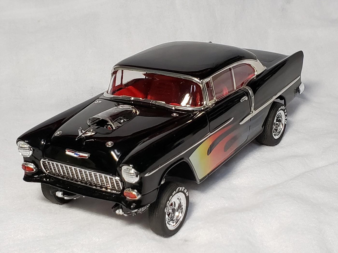

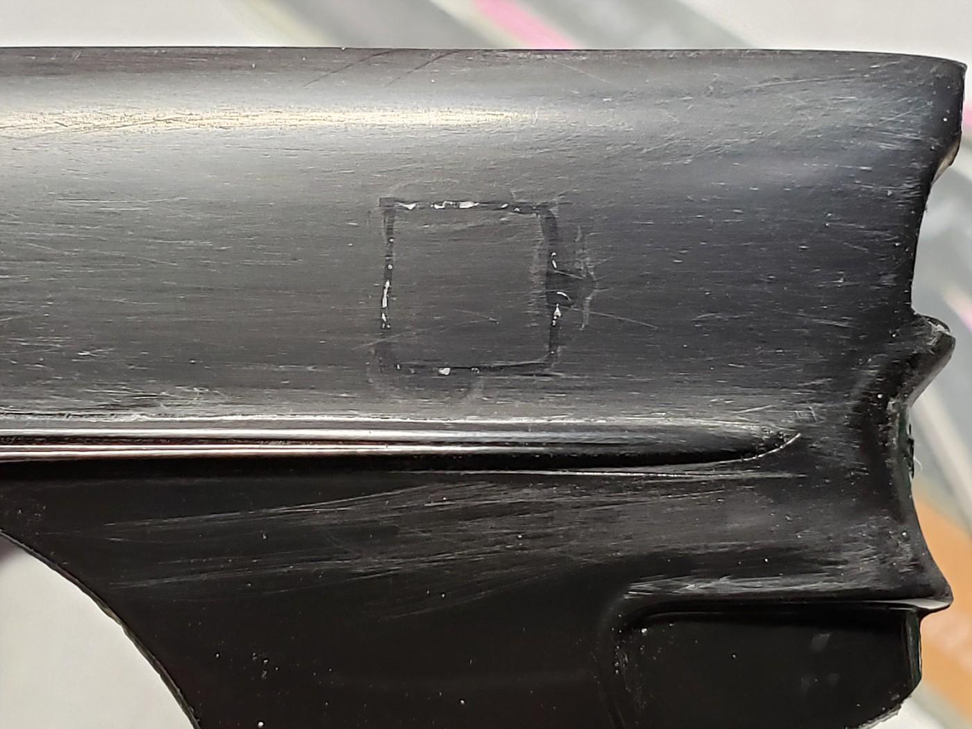

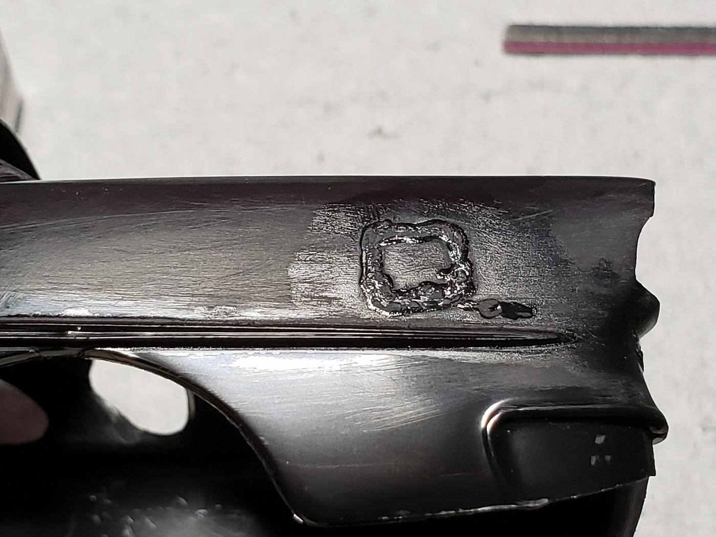

peteski Posted March 22, 2021 Posted March 22, 2021 On 3/22/2021 at 3:53 AM, Nacho Z said: Besides using CA glue for holding parts together, I use it for filling gaps, deep scratches and ejector pin marks, besides other things. I make a nice little dome of glue and hit it with accelerator. Leave it sit for just a minute or two and begin sanding it away to level. Best to do this very shortly after using the accelerator. I have read and have experienced, (at least in my mind), that the glue gets much harder after it sits for, say, 24 hours. Just food for thought Expand Yes, while CA sets instantly, it takes some time to fully harden. It is easy to sand within few hours of application, but eventually it gets harder than styrene (basically it becomes as hard as Acrylic), so sanding it surrounded by softer styrene will become difficult.

Nacho Z Posted March 22, 2021 Posted March 22, 2021 A couple of pictures to illustrate the gap filling properties. No shrinking and can be sanded smooth. My example is the gas tank door on the Monogram ‘55 Chevy Street Machine.

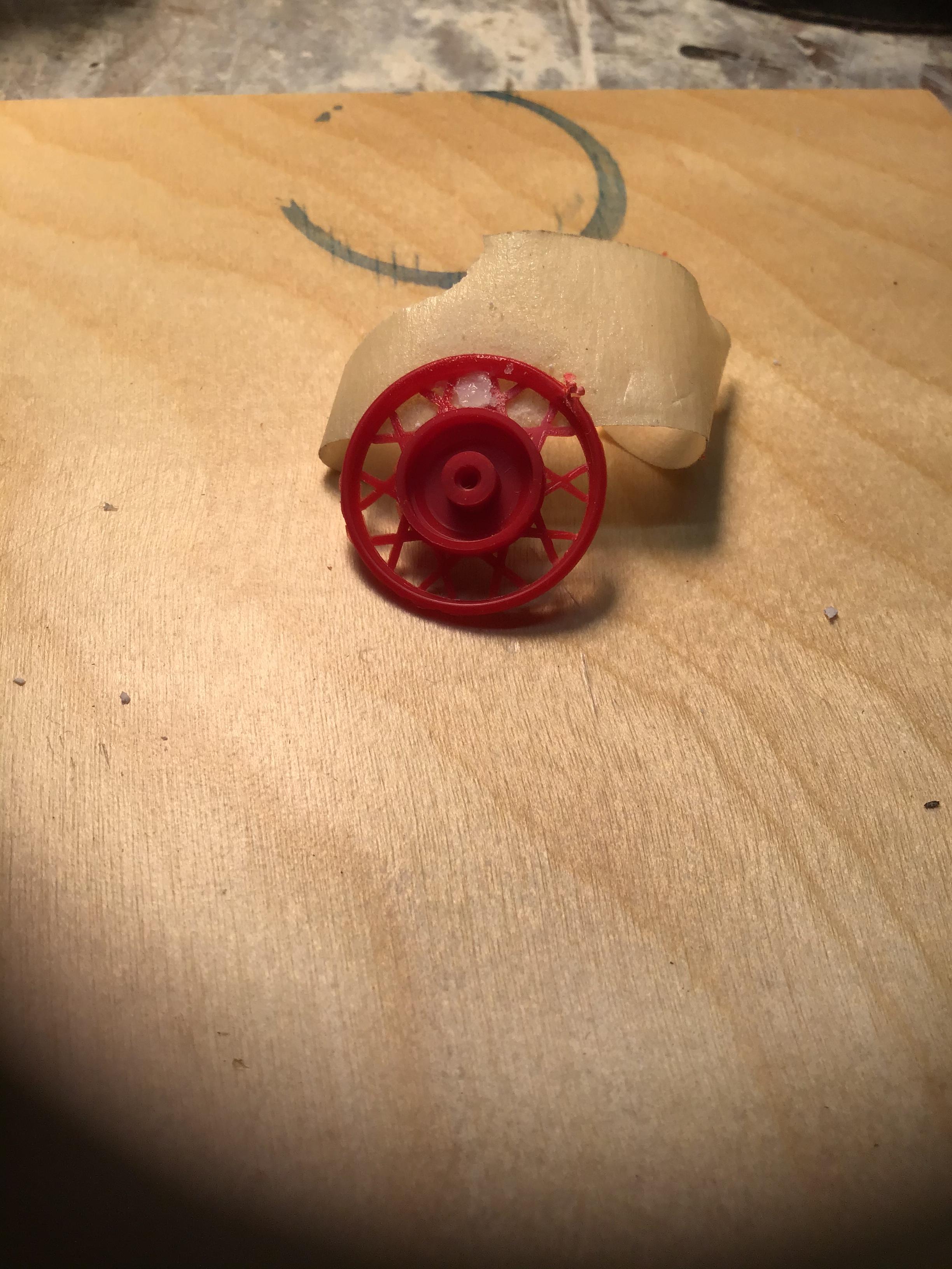

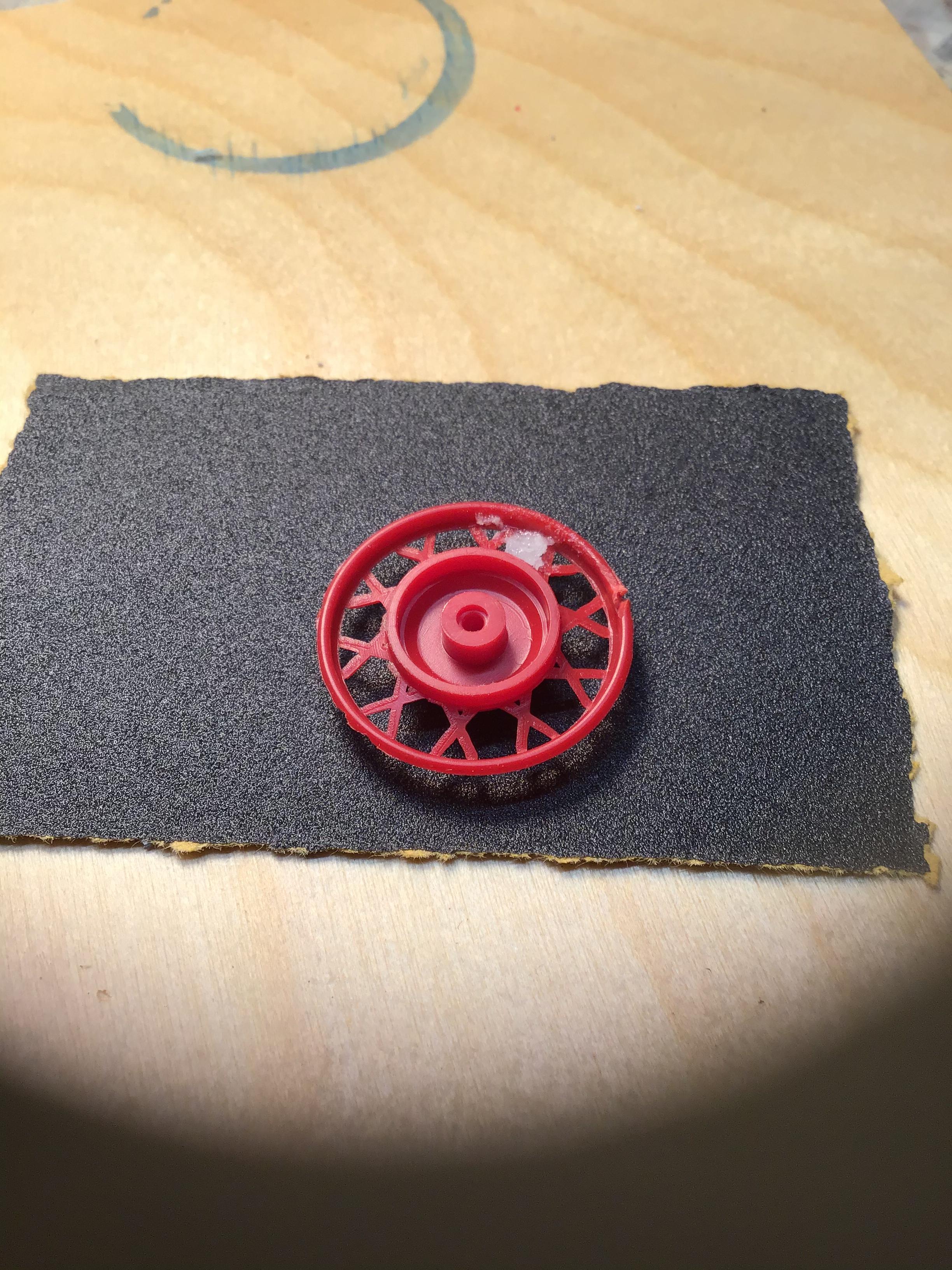

Rick L Posted March 22, 2021 Posted March 22, 2021 Another cool use for CA is that it reacts quickly to baking soda as a filler. The first picture shows a super large gap filled with baking soda. A drop of CA is dolloped on the baking soda and “kicks”. The result is an acrylic based filler that will hold and sand well. Shown in second picture.

bobthehobbyguy Posted March 22, 2021 Posted March 22, 2021 You really don't want to use superglue and baking soda as filler. The baking soda can absorb moisture and expand and grow. Its better to use micro balloons with superglue.

Rick L Posted March 22, 2021 Posted March 22, 2021 On 3/22/2021 at 2:57 PM, bobthehobbyguy said: You really don't want to use superglue and baking soda as filler. The baking soda can absorb moisture and expand and grow. Its better to use micro balloons with superglue. Expand True, it can be hygroscopic but it’s negligible if painted. Baking soda is something everyone keeps around the house.
peteski Posted March 22, 2021 Posted March 22, 2021 (edited) On 3/22/2021 at 2:57 PM, bobthehobbyguy said: You really don't want to use superglue and baking soda as filler. The baking soda can absorb moisture and expand and grow. Its better to use micro balloons with superglue. Expand Same here. I would *NEVER* use baking soda and CA. Not only what Bob mentioned, but the baking soda can cause the super glue to heat up and bubble up uncontrollably. Especially when used with the thin CA glue. IMO, there really is no reason to do this - accelerators work just fine, and are designed for the job. Baking soda works well for baking cookies. Edited March 24, 2021 by peteski
