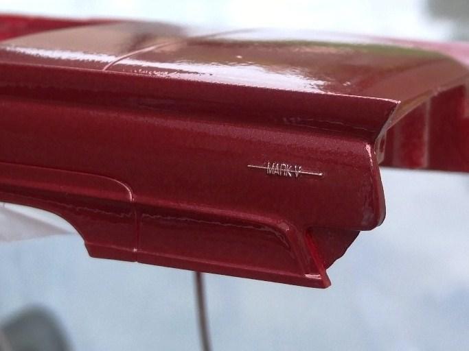

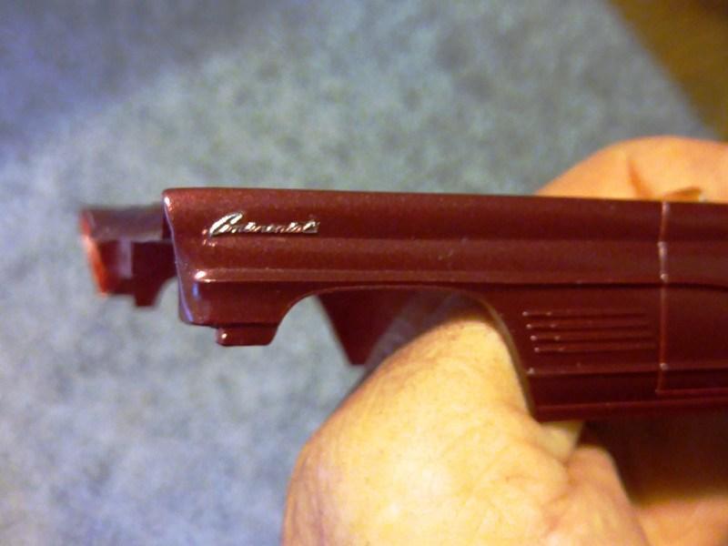

StevenGuthmiller Posted April 3, 2021 Posted April 3, 2021 I think you all know my opinion.? I don’t think it’s possible to do a better job on scripts than using the “fup” technique, with the exception of using PE parts. The technique is very sound. Execution of the technique is where the problems arise. Steve
doorsovdoon Posted April 3, 2021 Author Posted April 3, 2021 Thanks for all the suggestions, guys, I really appreciate it. It seems foil under paint is the way to go, I just need to work on the technique of removing it afterwards and using the right products and tools. I'll try all that's been suggested here on my next build and see what works. I'll post an update here of the result.
MrObsessive Posted April 3, 2021 Posted April 3, 2021 I'm another that can certainly vouch for Steve's method! I tried this on a Ford Cougar II model I built and it came out quite well. In some cases, this is the better way to go than scripts as some of them are a bit..........big.
