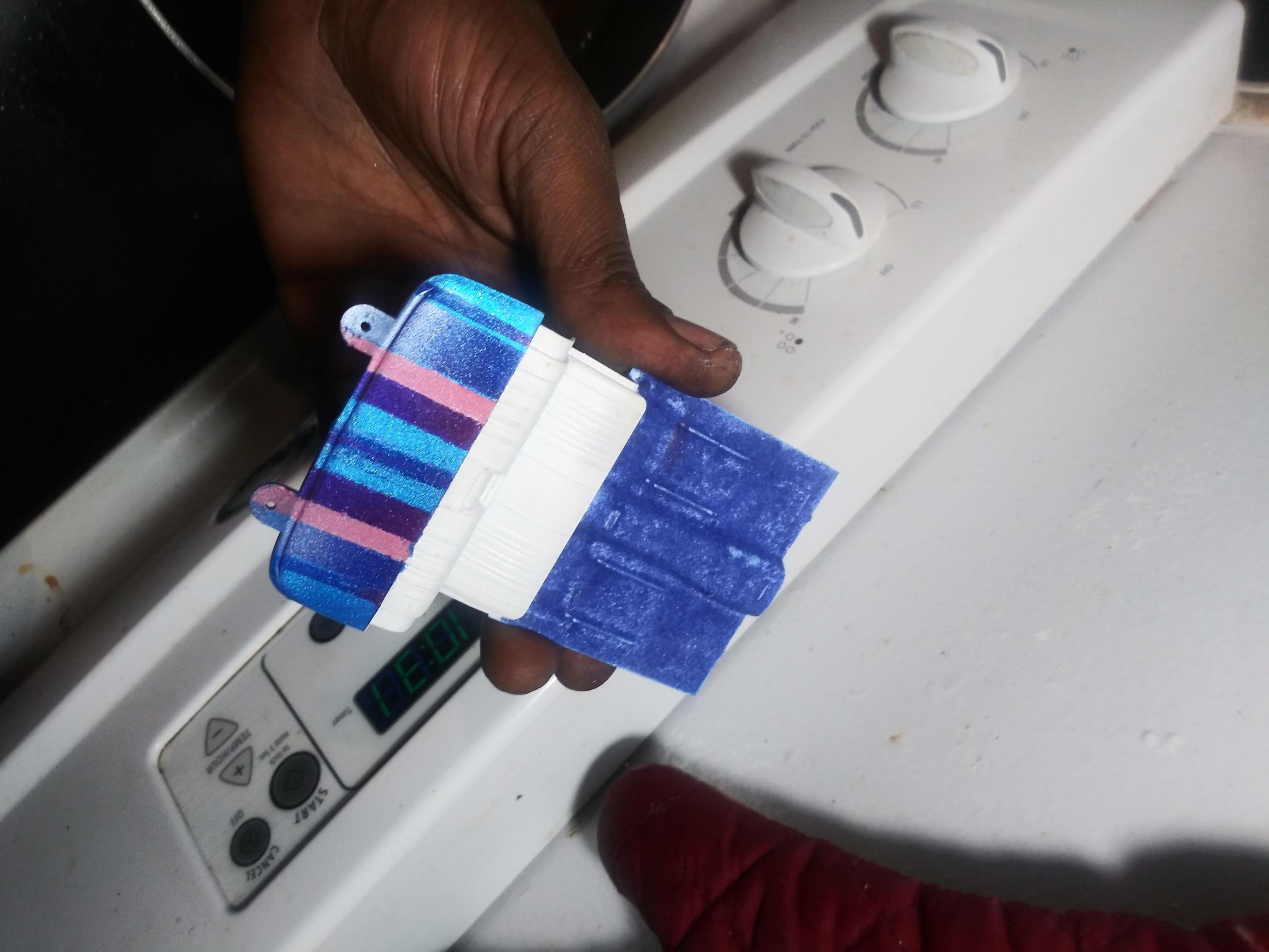

First things first.. Drop that icy blue flake on the body.. Remember this is kitchen table primitive building so with time I'll get better pics with a backdrop. Thanks for being patient with me.
Link to post

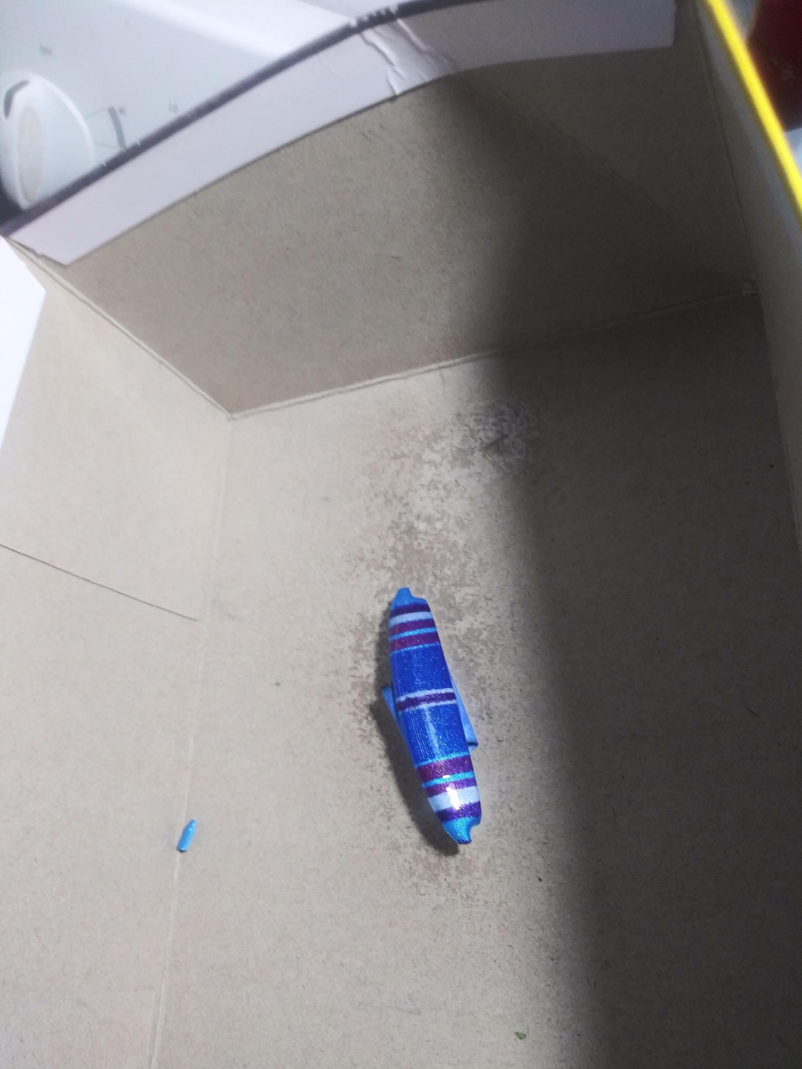

Since I last built anything theyve come out with molotow? I love these things. Yaasss!!! This is what the games been missing! Only thing I wonder is will clearing ruin the finish? Til I know for sure I just won't handle it after being applied.
Link to post

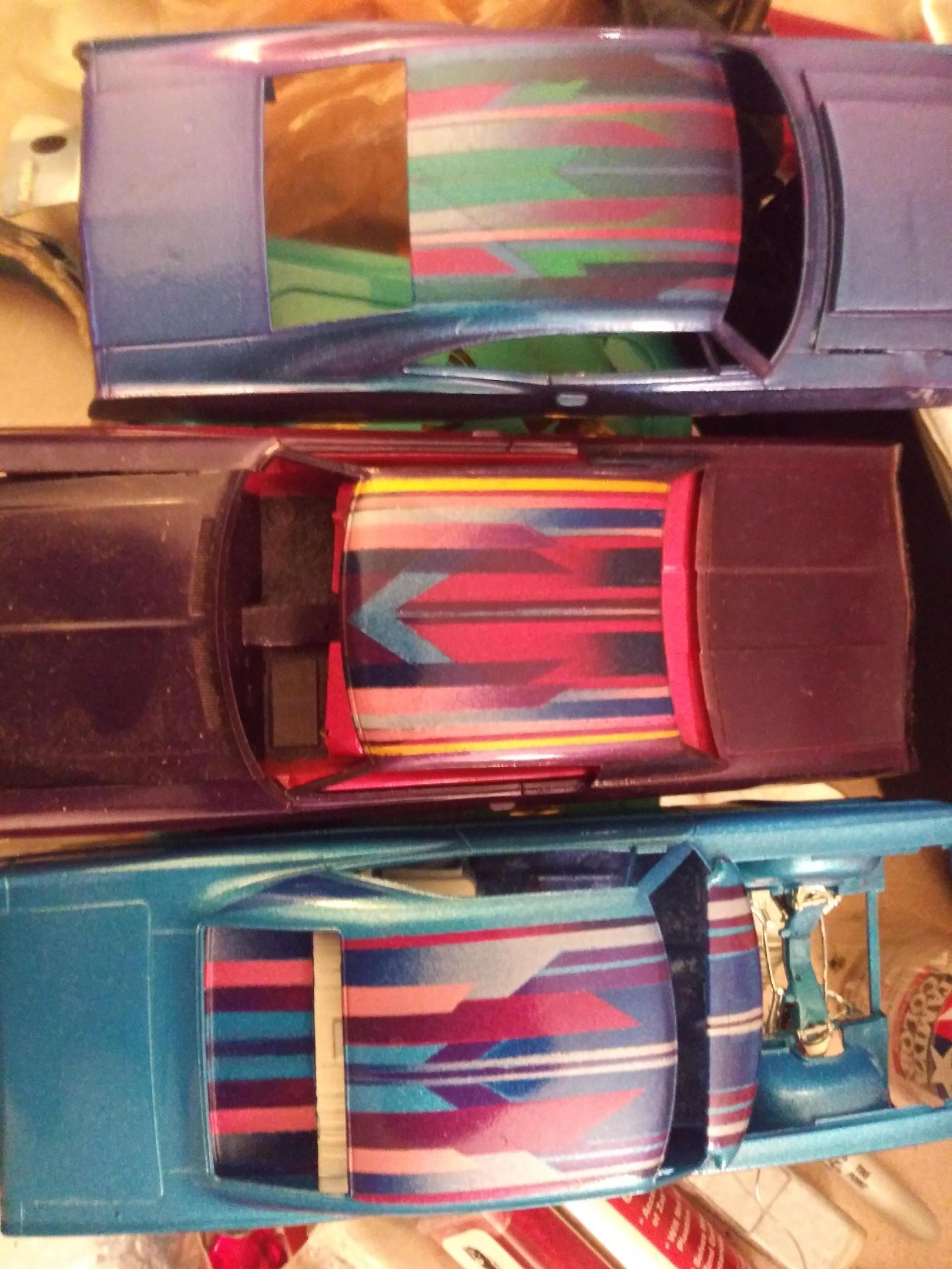

Painted block Orange chromed almost everything else. Done heads in aluminum wired distributor in body color blue hard to capture detail but had throttle return spring throttle linkage fuel line fuel filter small detail decals etc all sorts of hidden goodies..
Link to post

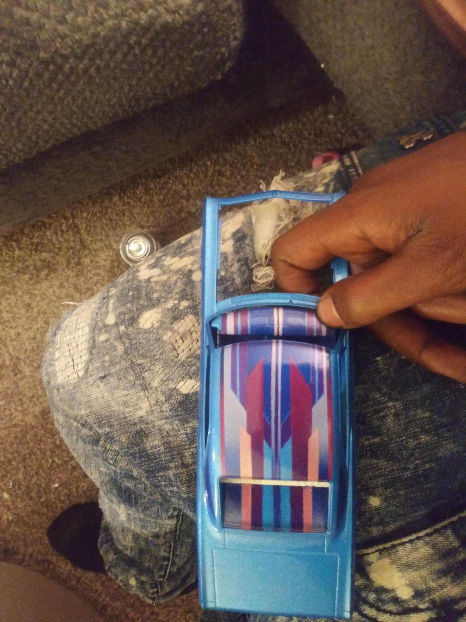

I like that added detail of graphics continued onto package tray and dash; nice touch! You're getting some nice edges, what's your masking tape of choice?
Link to post

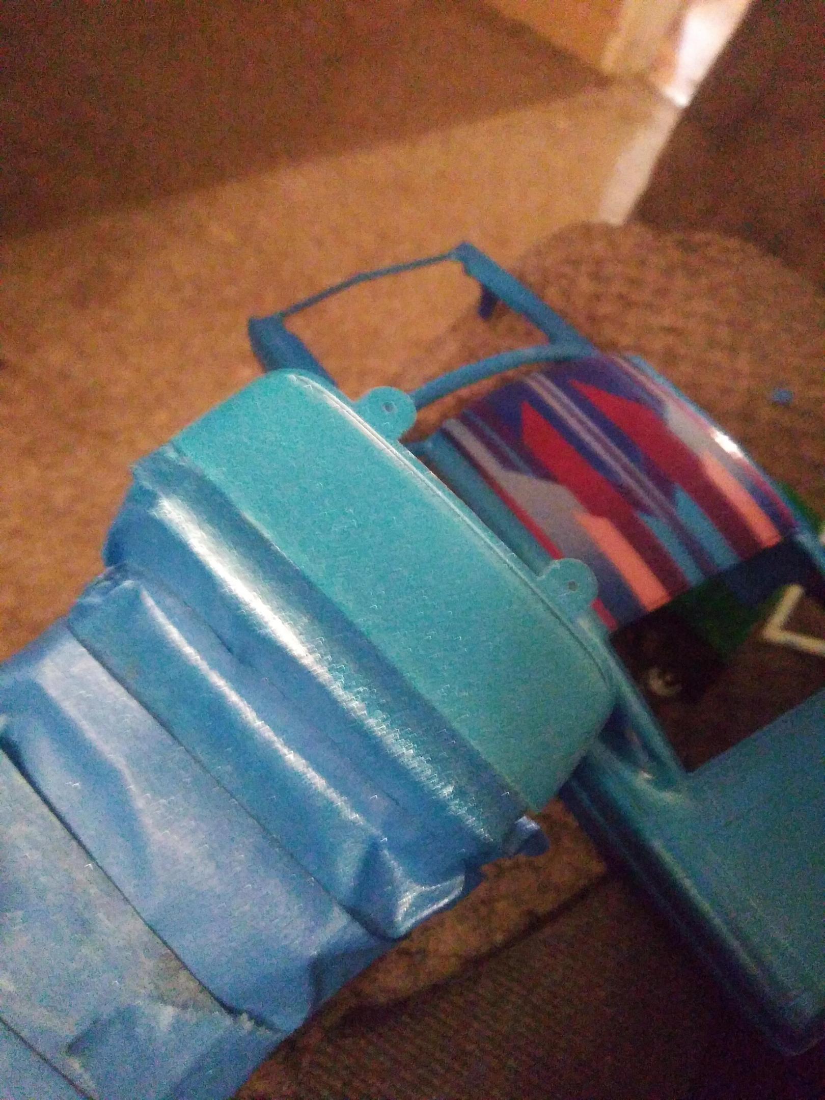

Regular 3m blue tape my brother. I lay it out on my table and either use an exacto or 2 razors taped together side by side to cut the tape thin. I do get rough edges when I do I backtape and respray the panel til I'm satisfied. Alot of time and tape.

3 hours ago, Modlbldr said:
Man, your work is amazing and the sequence of photos is very helpful. I am surprised that you don't seem to have any build up in the paint like I always got by using spray cans. They tend to throw a lot of paint. Yours looks extremely smooth. How do you manage not to have build up between the layers?
I appreciate your style of builds. I'd love to see more lorries on this site. Keep them coming.
Later-
Stay back up off the car about 12-18" when spraying and every few layers of panels I'll drown it in a few coats of clear. That's how I do fades. If you get far back enough you can almost get airbrush consistency.
