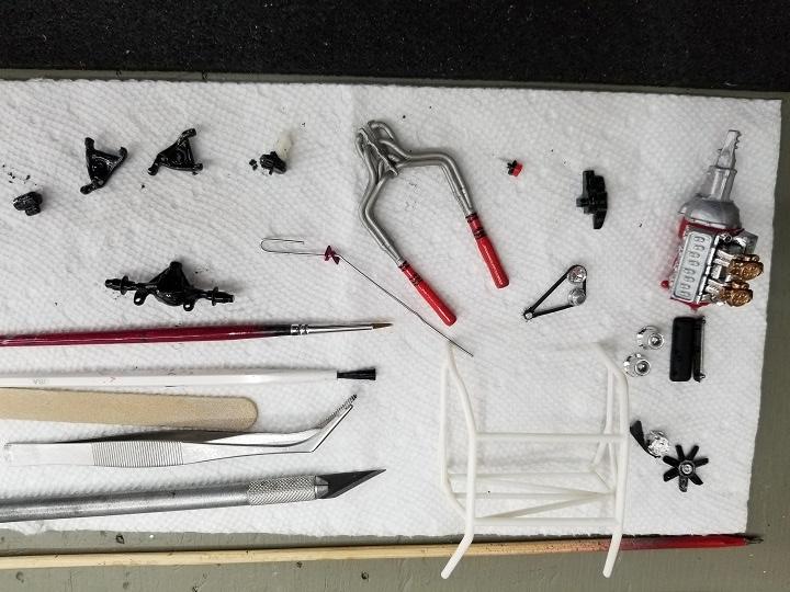

I assembled the roll cage on the frame of the car to make sure is wasn't warped.  Once I got all the pieces together I tack glued it and then moved it off the frame and fully glued it.  I'm trying my hand at drilling out the stock distributor for all the wires and it was a success.  Now I need to find some place local that sells wire small enough.  I know there are a lot of places online selling distributor wire but I just can't justify paying 3 times the price of the wire for shipping.

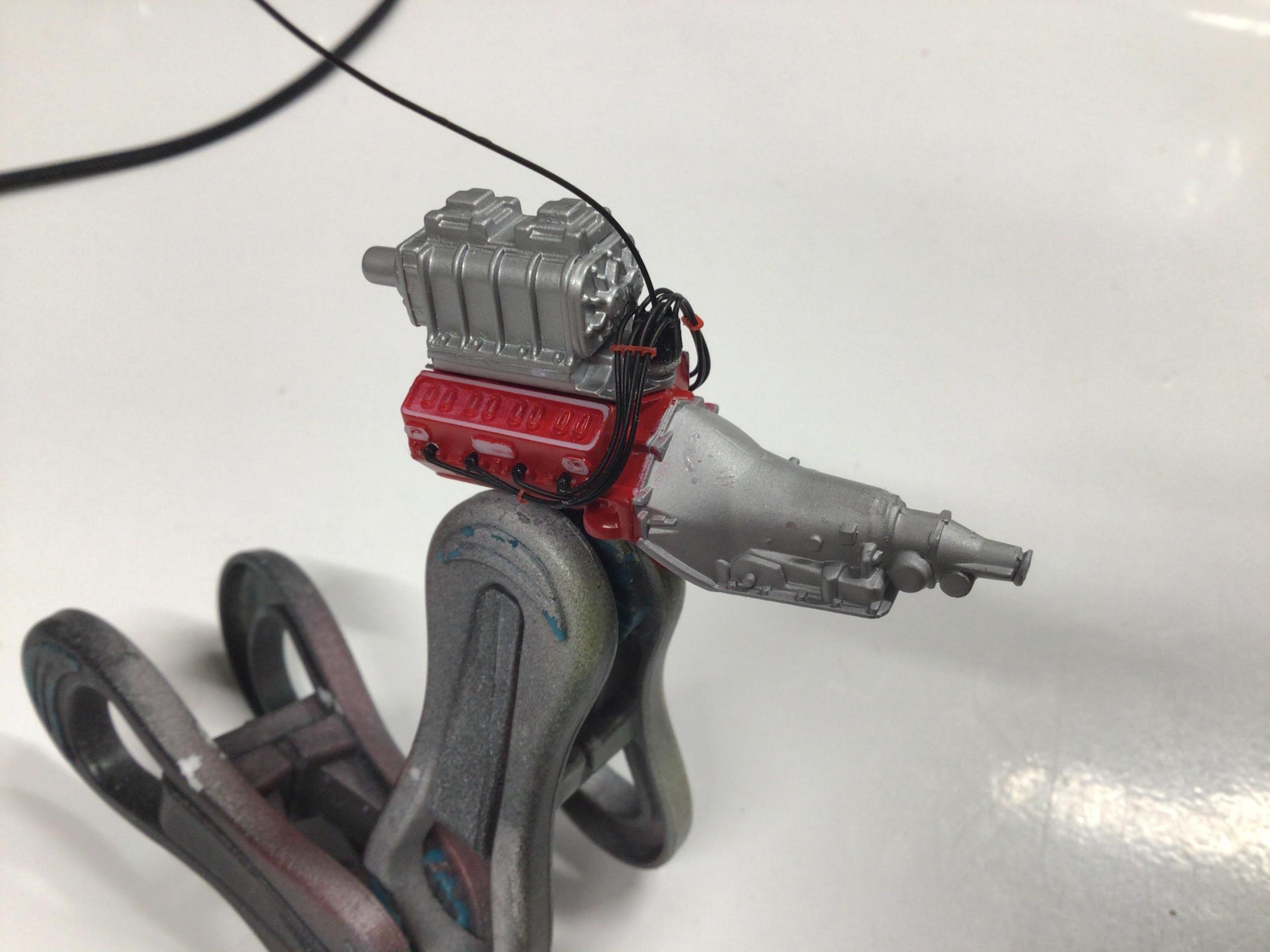

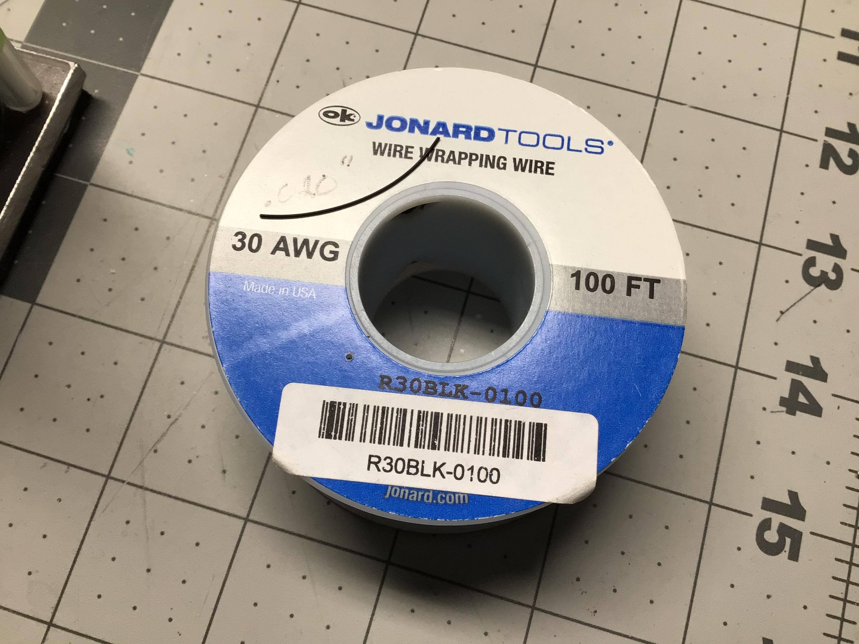

This is the 30 ga. wire I use. It is 0.020” diameter which is 1/2” in 25th scale. I got it at an electronics supply shop.

Greg, Thanks for the info.  That size looks great.  I'll check into it.
The wire you guys are using....is it solid or stranded wire?  Which works better to lay down and are you using spark plug boots?

Those look perfect to me!!  How did you do the angled boots??

I think those were the insulation off of some slightly larger wire that I notched and bent to 90 degrees or so. I also sometimes use very tiny shrink wrap that I stretch while heating it.

Thanks Greg, gotta try it.

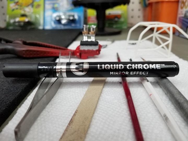

  Fellows....I looked all over at HL and even got a lady in the area to help me.  They just don't carry them.  We have 3 hobby shops in town and I did not check one of the 3 out as they mainly deal with the electric/gas car guys but this morning I checked the website out and halaluya brother......they have them.  Guess where I'm headed to this morning ☺  Since I could not locate any 30 AWG wire locally I ordered a 100' roll of the JohardTool wire that NOBLNG mentioned.

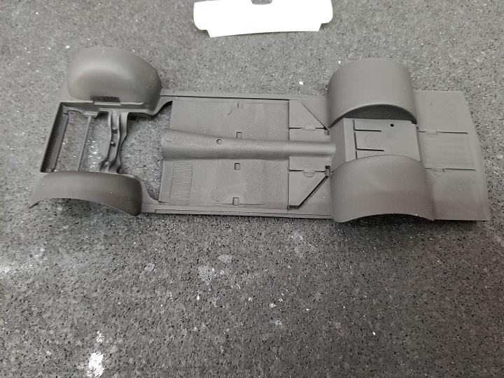

I am really disappointed in this amt kit.  It is full of flash, warped parts, and the parts don't fit very good at all.  The heads do not want to mate up to the Tunnel ran setup and look nice enough for me.  I shaved the nubs off the bottom of the heads to move them around for a better fit and look presentable.
Update : Last one Hobby Town USA had in their show case.

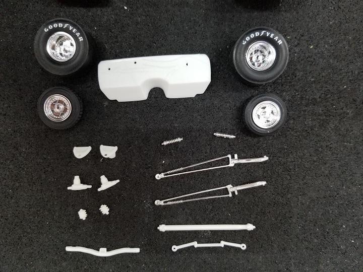

Not much going on with this build. Got the flash removed from some of the smaller parts and painted.  Waiting on my 30 AWG wire to come in today so I can with the engine.  Still looking around the garage for something to use for plug wire boots.
