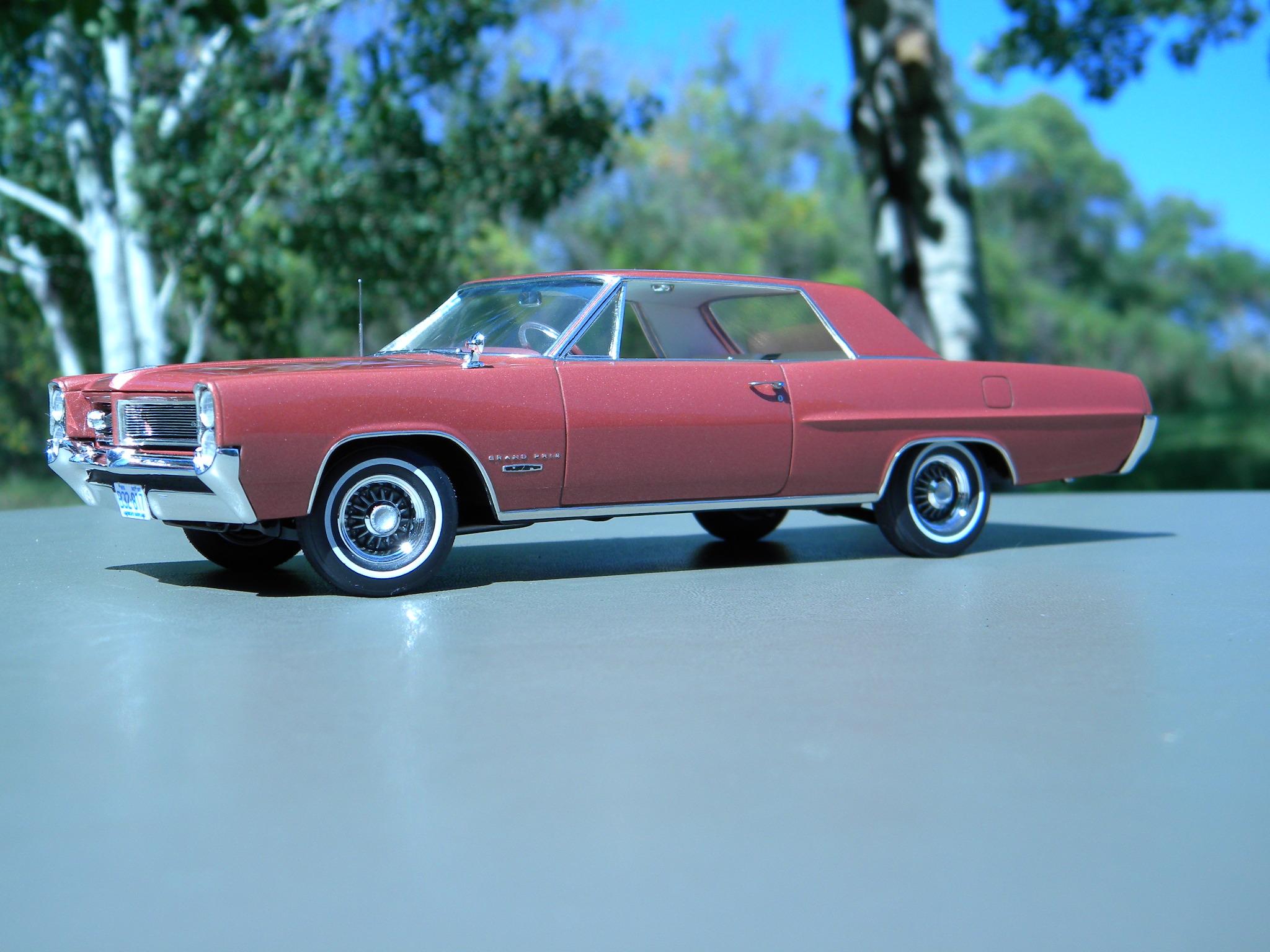

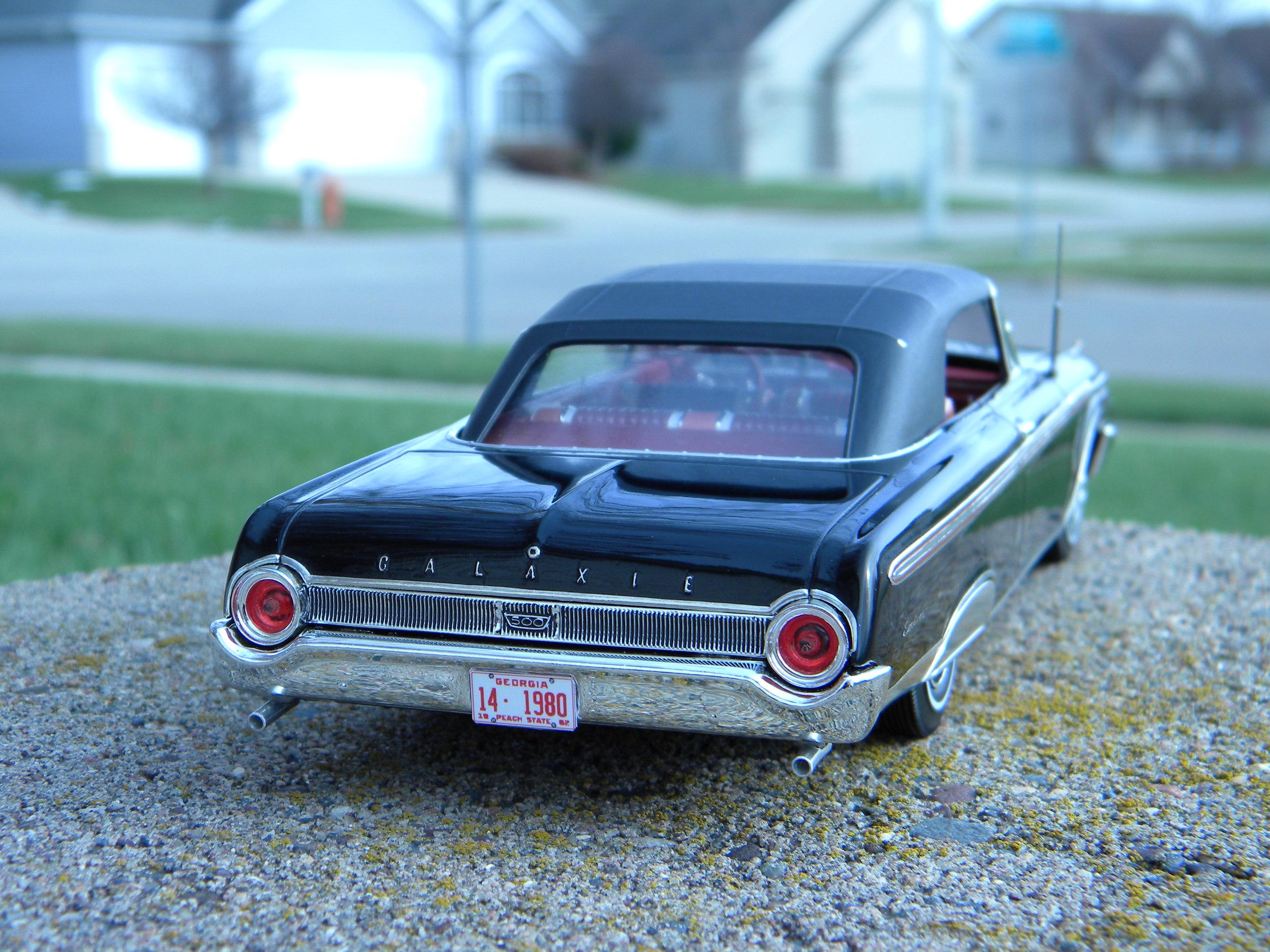

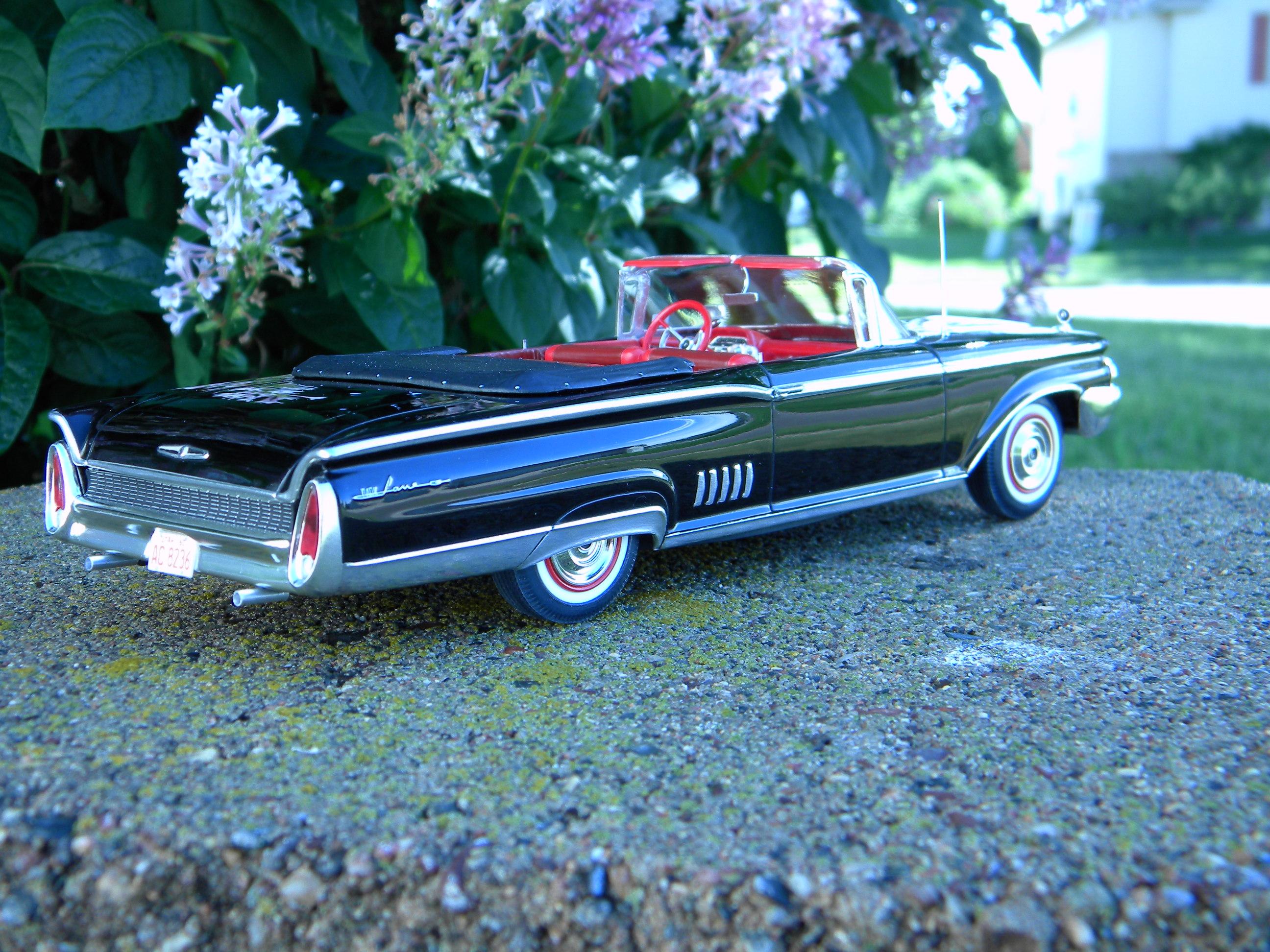

Examples of Foil Under Paint on some very fine scripts.
