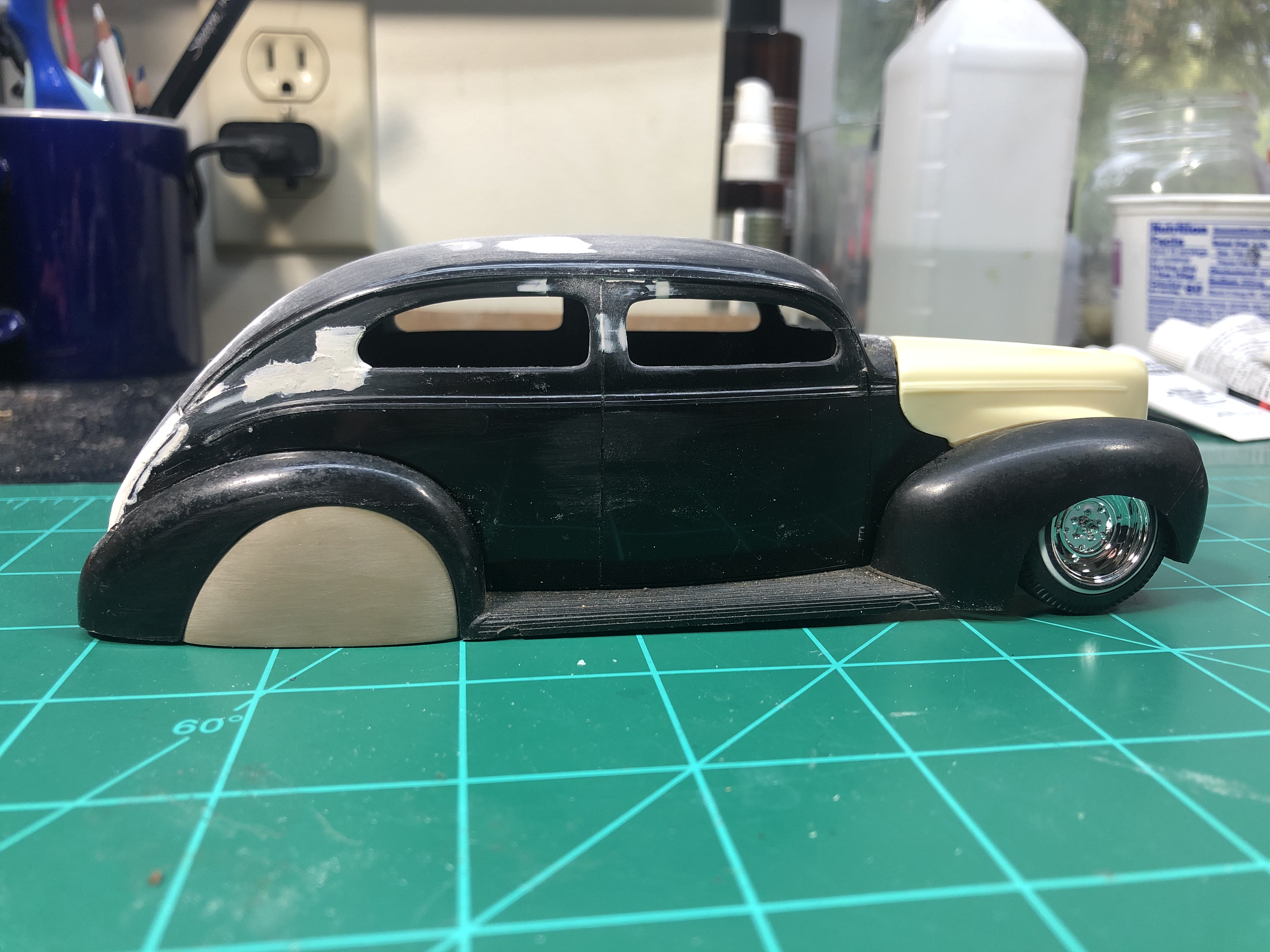

Misha Posted November 23, 2021 Posted November 23, 2021 Wow ?! That’s such a smooth ride you’re achieving… the flush rear skirts, the tailights, and then the chop! Betcha you’ll go further than a curbside? Enjoying your work as it gets my mind to consider doing a forty chop, great look. Cheers Misha
Katsusauce Posted November 23, 2021 Posted November 23, 2021 Awesome looking build....love the overall look and feel of this bomber ?
espo Posted November 23, 2021 Posted November 23, 2021 Body is looking nice and smooth. I like how you used the Corvette style Bumpers.

Zippi Posted November 26, 2021 Posted November 26, 2021 On 5/8/2021 at 7:07 AM, James2 said: Working out of town limits bench time. But here’s a little update. Body work is looking really sharp man. I have a question. I'm always affraid to sand to much for fear of removing to much material. How in the heck are you getting those heavy sanding marks out without sanding to much plastic away?
James2 Posted November 26, 2021 Author Posted November 26, 2021 48 minutes ago, Zippi said: Body work is looking really sharp man. I have a question. I'm always affraid to sand to much for fear of removing to much material. How in the heck are you getting those heavy sanding marks out without sanding to much plastic away? Thx Bob, normally I wouldn't gouge the surface like this but this was a real glue bomb when I started. I guess the easiest answer would be I use a couple deferent sand papers. The courses being 220 and work up to a 400. Then I like to use an automotive filler primer lightly sprayed. I will sand that almost completely off and then start the process over again until I am satisficed. Usually there are spots that need more attention but I work on them individually just re-priming where needed. After that I'll wet sand the entire body and then prime it with Tamiya primer in very light coats. If you do this make the two primers are compatible. There's hundreds of ways of doing it but this works best for me.
Zippi Posted November 26, 2021 Posted November 26, 2021 57 minutes ago, James2 said: Thx Bob, normally I wouldn't gouge the surface like this but this was a real glue bomb when I started. I guess the easiest answer would be I use a couple deferent sand papers. The courses being 220 and work up to a 400. Then I like to use an automotive filler primer lightly sprayed. I will sand that almost completely off and then start the process over again until I am satisficed. Usually there are spots that need more attention but I work on them individually just re-priming where needed. After that I'll wet sand the entire body and then prime it with Tamiya primer in very light coats. If you do this make the two primers are compatible. There's hundreds of ways of doing it but this works best for me. Thanks for the info Rooster.

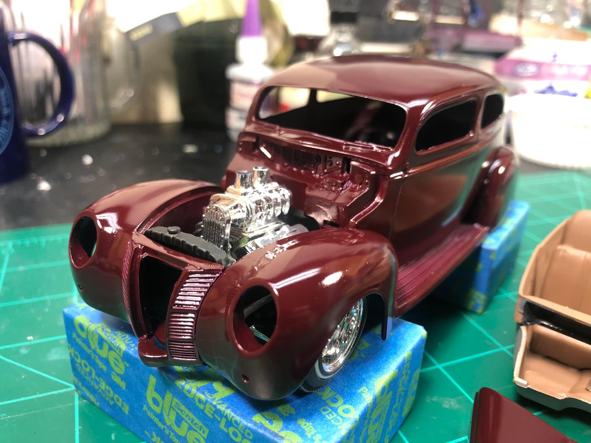

TransAmMike Posted November 28, 2021 Posted November 28, 2021 Oh wow, that color and paint job look great!!?
Paul Payne Posted November 29, 2021 Posted November 29, 2021 That maroon is just gorgeous! Great color pick!
James2 Posted November 29, 2021 Author Posted November 29, 2021 Thanks Guys, I'm pretty happy with it too. It's kind of funny but I'm trying to build on a budget and not purchasing any new supplies right now. Number one funds for models are a bit low, number two I have so much stuff. I'd love to use as much of it up before replacing it. Maybe some have felt the same? I'm going to try to get caught up on the few unfinished projects I have this winter hopefully I won't get distracted by new ones... Blessed Holidays!
Zippi Posted November 29, 2021 Posted November 29, 2021 14 hours ago, James2 said: Managed to apply some paint today... Nice looking color on your Hot Rod. What color is the interior? Looks really good.
slusher Posted November 29, 2021 Posted November 29, 2021 1 hour ago, James2 said: Thanks Guys, I'm pretty happy with it too. It's kind of funny but I'm trying to build on a budget and not purchasing any new supplies right now. Number one funds for models are a bit low, number two I have so much stuff. I'd love to use as much of it up before replacing it. Maybe some have felt the same? I'm going to try to get caught up on the few unfinished projects I have this winter hopefully I won't get distracted by new ones... Blessed Holidays! I can relate being on a fixed income..
James2 Posted November 29, 2021 Author Posted November 29, 2021 5 hours ago, Zippi said: Nice looking color on your Hot Rod. What color is the interior? Looks really good. It’s just a Model Masters tan.

Mr. Metallic Posted December 3, 2021 Posted December 3, 2021 That is looking slick. Great job on the chop, not the easiest one to do well. Excellent color choice too.
