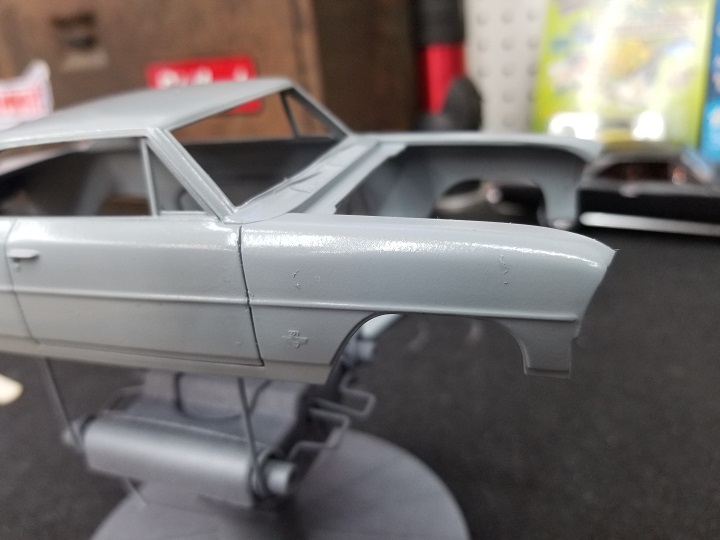

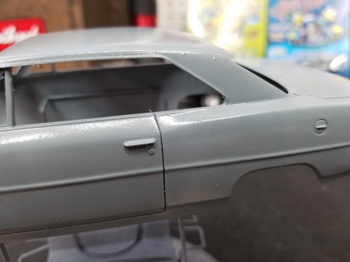

Your door lines look better now. This is how you do it: Blacken the gaps before paint, and then leave them alone.
For the future: Don't scribe the tulip pane lines (below the backlight) so deep, and don't darken them at all. This is a welded seam, not a movable panel, and should be seen as body color. Maybe you can still get some body color in there with a brush or something. Drive on! B)
I knew better.....just wasn't thinking.  Thanks man.

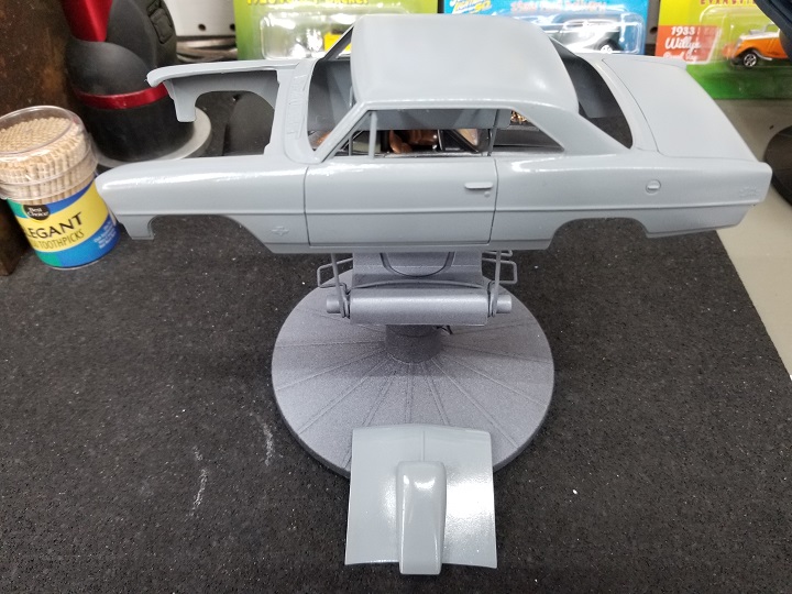

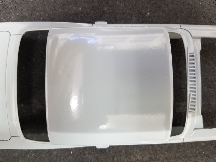

Well fellows.....after airbrushing the topcoat on yesterday morning I sprayed the 3 coats of gloss on yesterday afternoon and this morning when I pulled the plastic tub off I was surprised at what I saw.  I'm going to give it a full 48 hrs to cure but I just don't like what I see.  Once I try and wet sand some of the BLAH_BLAH_BLAH_BLAH out and polish it I'm going to take a step back and figure out what I want to do. I have done a lot of testing and I have tried different acrylic paints, rattle can & airbrush, and 3 different gloss finishes and I can't seem to get anything to look good at all.  One thing is for sure.....I'm giving up on the craft paints.  Not sure what to try next if any at all.  At this point I'm just frustrated.  I think I'm doing ok on the detailing and have learned a lot from a lot of fellows on this site but it's the body painting that has always been my downfall.

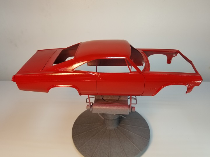

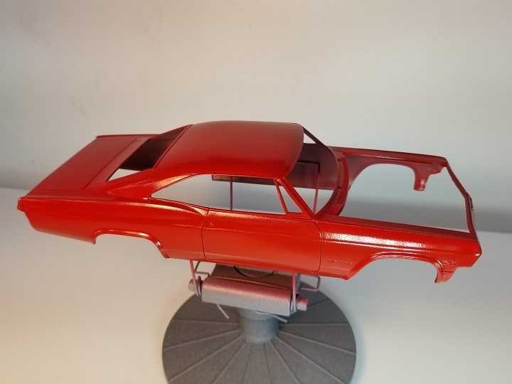

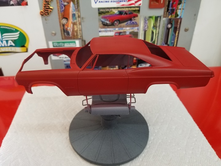

Thanks John, I guess everybody has gone through this but man I just don't have the patients to stick it out.  Came back from the local Hobby Shop earlier and bought some of the Tamiya acrylic gloss and flat along with the TS-13 Gloss.  Just got the 65 Impala test body airbrushed with the Tamiya X-7 Red Gloss paint as the body was already primed with Rust-Oleum gray primer.  I thinned it with Lacquer thinner 50/50 and this paint seem to flow out of the airbrush a lot better than the craft paint and it turned out pretty good.  I'll let it set overnight and shoot it with the TS-13 gloss hoping for better results.

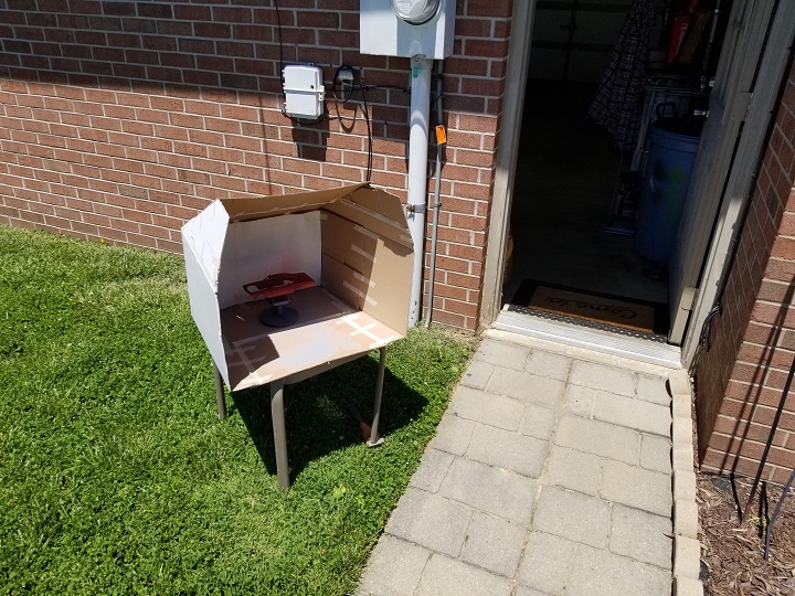

Just thought I would post a couple pics of my High end Quality controlled spray area.  My spray area is what I like to call "Sun-Ray Max lighting" with a REAM GRAPHIC PAPER Spray Booth along with a variable wind-speed environment.  Price to fit all.

6 minutes ago, TransAmMike said:
The paint as far as I can see looks great.👍
Yeah buddy.  It went down a lot better than the craft paint.  This is the first time using Tamiya acrylic paint so this was a test.

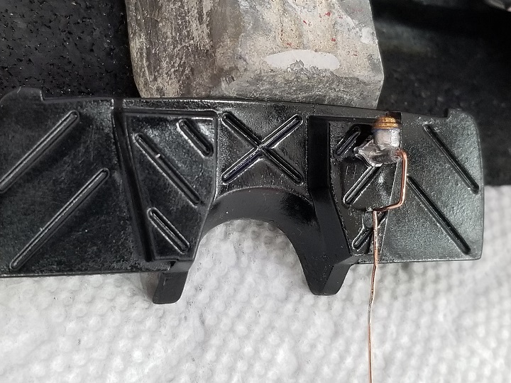

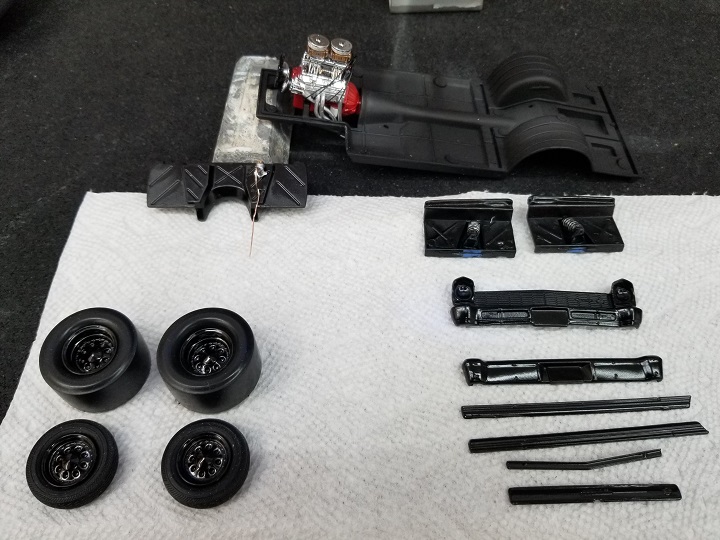

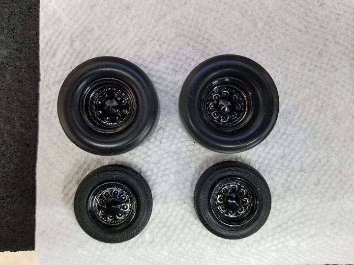

Along with all the paint issues I did manage to get most of the parts murdered out.  I also tried my hand a plumbing the master cylinder.  Turned out ok.
Link to post

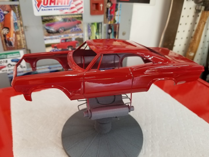

Thanks for the tip Greg.  Well.....I wet sanded the Nova with 4000, 6000, and 12,000 then polished it with Novus 2.  It took a lot of the imperfections out but I didn't like the way that it looked so it's in the drink as we speak.  I have the 65 Impala test body curing that I painted yesterday with the Tamiya acrylic paint.  I'll be spraying the Tamita TS-13 this afternoon hoping for some good results.  If this doesn't turn out satisfactory to me then I'm at my wits end and don't know what to try next if anything.

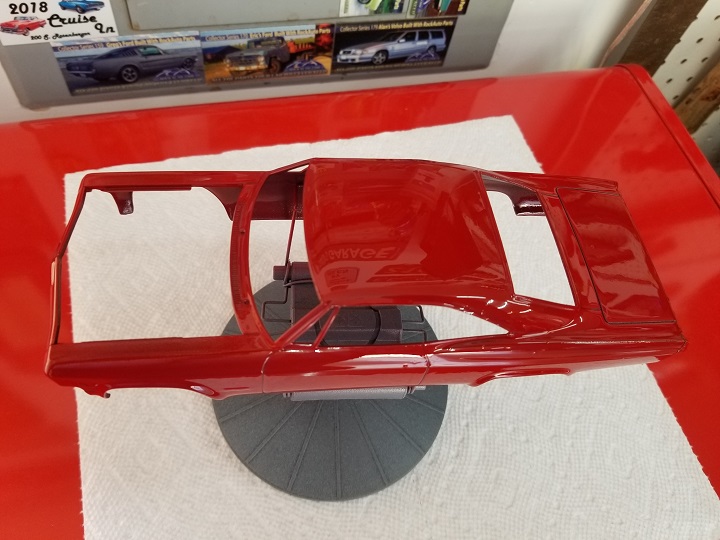

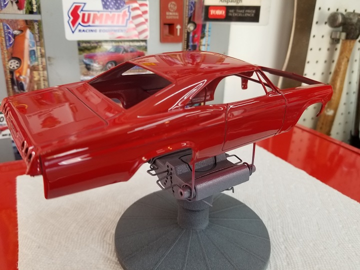

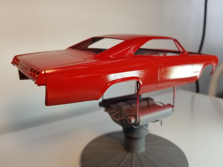

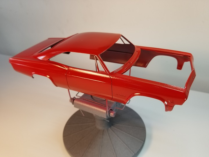

Ok.....I sprayed 5 coats of the Tamiya TS-13 over the Tamiya X-7 Red on the Impala test body.  These pics or roughly 1 hr after I sprayed the TS-13.  What do you fellows think???  The finish still seems a little rough looking to me.  Should I wet sand or just polish with Novus?
Edited by Zippi
Link to post
3 minutes ago, Rick L said:
You need to go wetter.
K.  It has been curing for about 1 1/2 hrs.  Can I spray it again wetter???
Link to post
Yes, keep making passes till it gets that wet uniform look all around. Then stop. There’s a fine line where the paint will stay and when it will run but just be sure to keep the spay can moving.
Link to post
Ok.  It's good and wet.  I was afraid to spray anymore as it looked like it wan't to run.  Feels like the spray can it getting pretty empty.  Whatya think now???
Link to post
2 minutes ago, Rick L said:
Mucho better! What do you think?
It looks much better.  If that gloss holds up during the curing process I'll be a happy camper.  I'm sure a lot of the gloss will fade as it cures but at this point I'm satisfied.  Thanks dude.  Does this hold true for the paint as well....get it on wet?
Link to post
If this still looks good in the morning I will repaint my Nova with Tamiya XF-19 Sky Grey and use the TS-13 the same way.  Wife and I are taking our 49 Chevy pickup to a cruise-in tomorrow and there is rain on Sunday so I'll try and paint it on Monday.  I'll need to pick up another can of the TS-13.
Link to post
Yes. Starting with light, medium, then full coat. Light sand any dust then the gloss will do the rest. You are correct that the gloss will fade a bit but it will still be smoother and ready for high grit sanding and a Novus 2 buffer. BE SURE IT’S DRY. The longer you wait the harder the paint will get. I’m talking days not hours. Don’t concentrate sanding on high areas like door handles, trim, or hard outside corners. There is less paint in those areas than on the flat surfaces and you will break through. Once you get a uniform flat finish on the flat surfaces the Novus will meld it all in.
