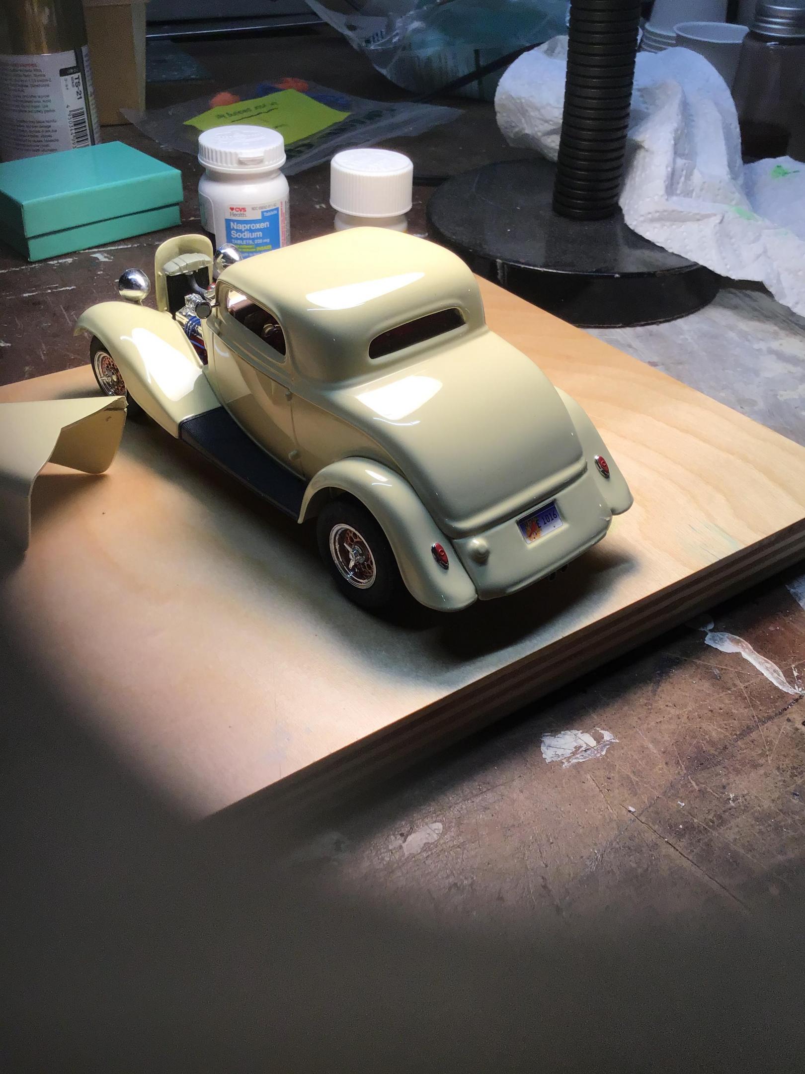

Personally, I think 12,000 might be a little overkill. The Novus will take over pretty well. I stoped at 2000 on this 33.
Nice looking coupe Rick.  Is that at 32?
Link to comment
“33” from Revell. One of the poorest designed models I’ve worked on. The roof, windshield and windows were a separate unit from the body???? It took a lot of bodywork to hide the seam. I also filled in the trunk line.
Edited by Rick L
Link to comment

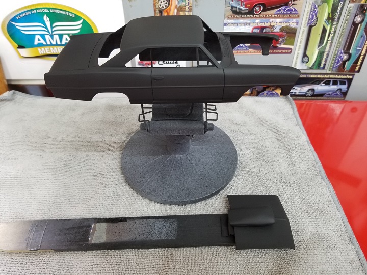

I primed the body in black this time as the grey looks a little light to me so maybe the black primer with darken the grey up a little.

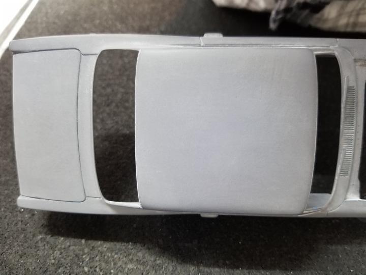

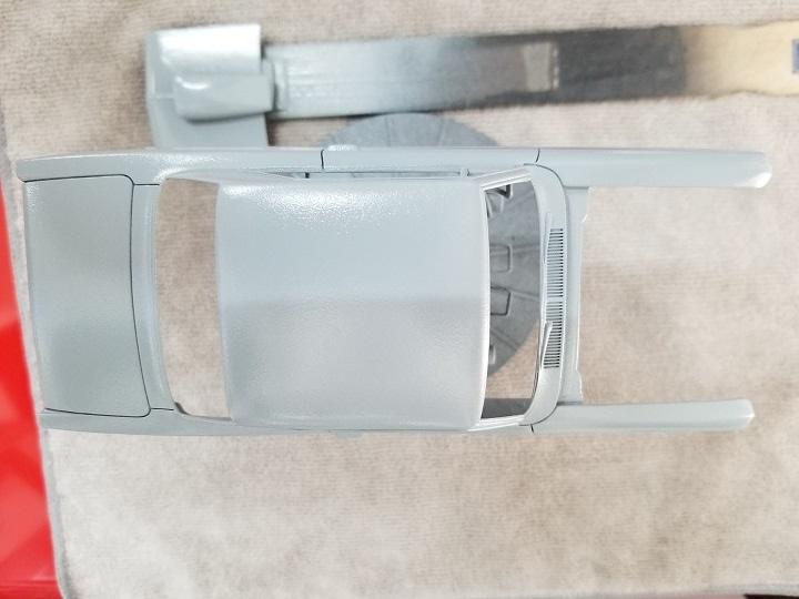

Well.....I feel like a salmon swimming up stream fellows, not making much headway.  I sprayed the Tamiya XF-19 Sky Grey and it just didn't turn out very well.  Not sure what happened as I sprayed it the same way I've been spraying with the air pressure at 20 psi, mixed the paint 50/50 with lacquer thinner, weather was about the same and I'm now airbrushing in my makeshift spray booth.  Not only that, when I came out to the garage this morning I was checking out where I'm at on the Nova build and noticed the master cylinder is missing.  I have no idea when it may have came off.  I swept the floor and emptied the trash and no master cylinder.  I stripped the body once again, sanded it, cleaned it, and re-primed it.  All looks good at this point.  This painting has got me stumped. I can normally figure things out but man oh man.  I know a better environment for airbrushing would really help but that just isn't in the cards for me.  I think at this point there is no need to proceed forward as I feel I would just get the same bad results.  I have some work I need to do on my 1949 Chevy pickup 1:1 so maybe a good long break is what I need.

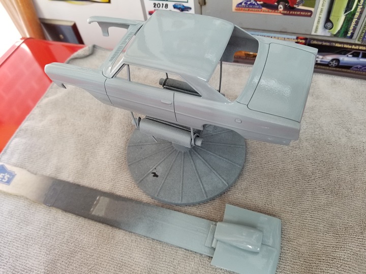

Well....after adjusting the tie rods this morning on my 1:1 1949 Chevy pickup I kept thinking about my paint issue. I checked my notes and one thing that was always consistent was the primer.  So, I thought why not try the Rust-Oleum top coat and see what happens since the Rush-Oleum primer seems to lay down really well.  I made a trip to the local Rural King and bought a can of Winter Gray Gloss and sprayed this over the Rust-Oleum black primer and I've gotta say it looks pretty good and I haven't sprayed the Clear Gloss yet.  I still have my 65 Impala test body in primer so I'll continue to work with spaying the craft and Tamyia acrylic paints.

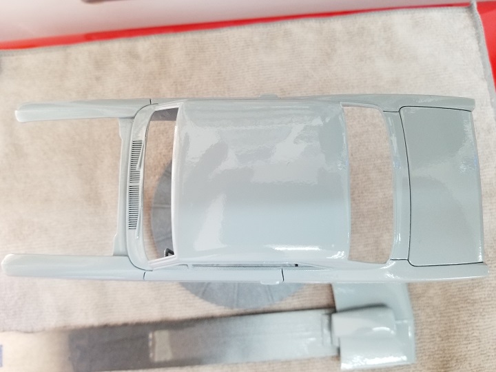

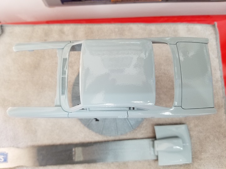

After letting the Rust-Oleum Winter Gray dry for about 25 hrs I just sprayed the Rust-Oleum Clear Gloss on the body about 15 min ago.  Has a little orange peel but everything looks uniform and the best to date so far.  I'll probably let this cure until Monday and see how it looks.  Not sure if I'll we sand or just polish it.  The last couple times I wet sanded I went a little to much and burnt through one of the edges.
Link to comment
I did go back after about 3 hrs and spray 2 more WET coats of the clear gloss.  It looks wet and much better now.  I thought it was going to run on me so I kept rotating the body for about 5 min.  It finally settled down and leveled out.
