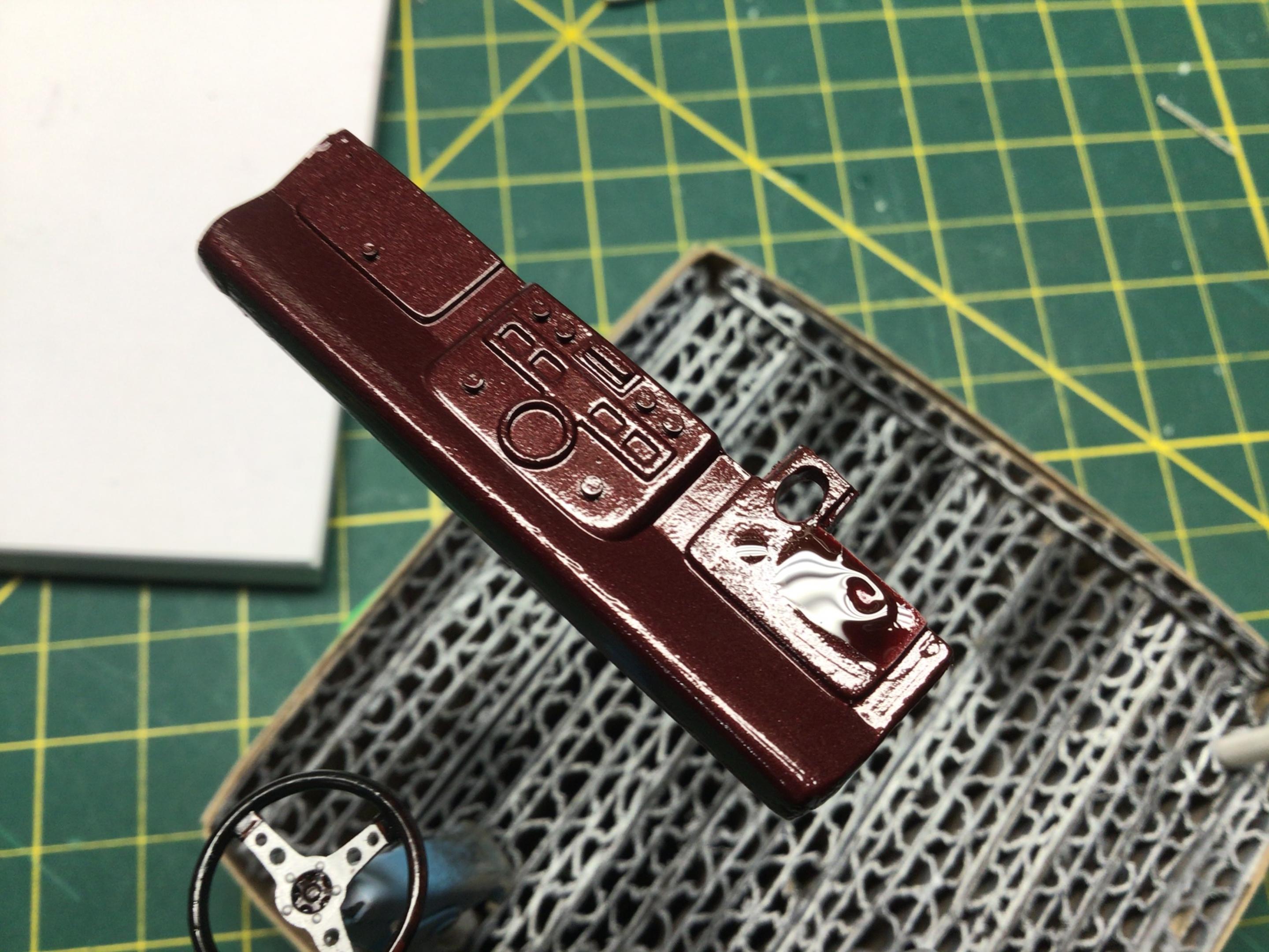

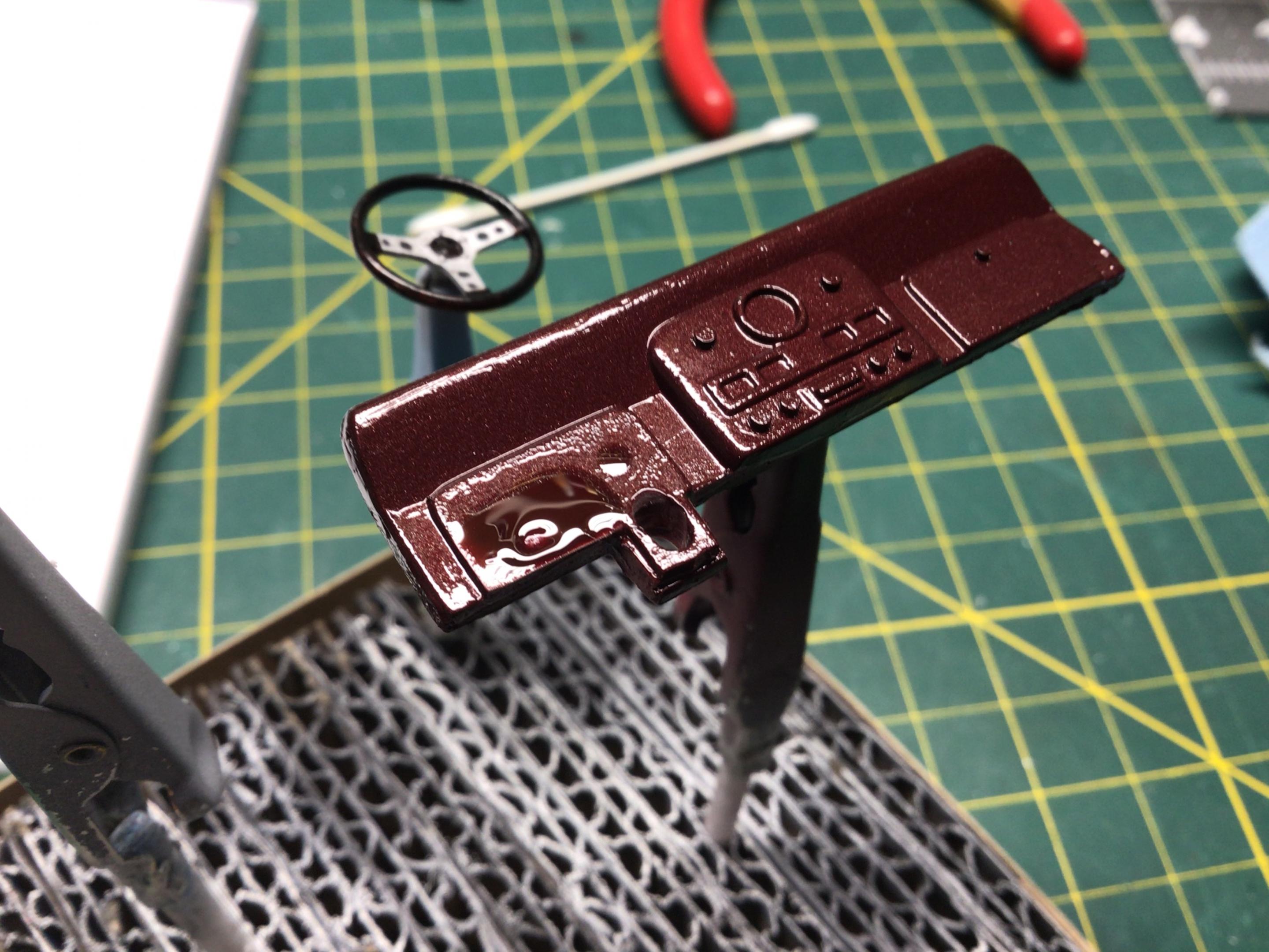

This paint was put into an aerosol can many years ago for me by an auto paint supplier. I sprayed this dash weeks ago, and it has been sitting in the dehydrator since. There is a raised portion of the dash that I filed down...and on that spot, the paint is still liquid. How long after casting does resin need to cure before painting? I must have painted this just after the filing that exposed fresher resin?

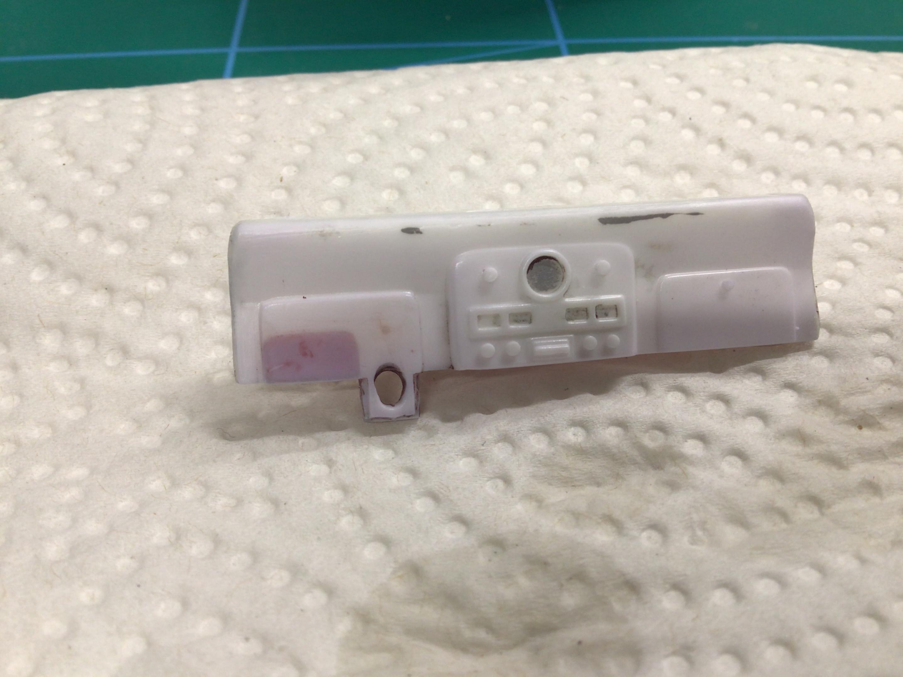

i dont know about Super Clean as i dont like it. takes to long to remove paint . i use a lot of resin parts and when i started out i did have to remove paint on a hood. i have always used Easy Off brand name in a yellow can..spray it on in vented area leave on 4 hrs scrub under warm water with old tooth brush repete if needed... wash in soppy water, dry, prime, paint ..i would toss that paint being it be so old...

Someone told me the best method for stripping resin is to wipe it down with thinners, not the quickest method but it works if you take your time. Just use the appropriate thinners for the paint used. I've used it on a qtip to strip some resin wheels, and I've used la's totally awesome cleaner for stuff that needs a soak. agin not the fastest but it works mostly, just very slow on mettalics

Unfortunately, this may be a flaw in the resin casting. Some polyurethane resins are quick curing parts A and B and one of those parts are not mixed correctly before they are mixed for casting. This results in a web of uncured  plastic inside and protruding to the outside of the part. You may have to dig it out a little or the web will keep bleeding out under the paint. You can use any stripper suggested for the paint used. It shouldn’t effect the plastic but look carefully at the area that inhibited the paint to see if there is a dark hairline web. That’s the critter you have to dig out before repainting or it will happen again.

Well it came pretty clean. I think I must have filed off that raised area and then primed and painted it right away. I’ll let it dry real well in the dehydrator and then give it one more try with this old paint.🤔

The only time that I experienced this was on a truck cab that the resin wasn’t completely mixed. The cab had cured for years. It was completely dry to the touch, but the resin had swirl marks in it. The paint wouldn’t dry at all in a couple of spots on the cab and the resin began to soften again. I suppose that the paint re-activated the resin. I’m guessing that resin that wasn’t completely cured could have the same reaction.

The dash was kind of spongy at that spot so I tossed it. Likely not mixed well enough, or because it was from an old batch of resin.🤷‍♂️
