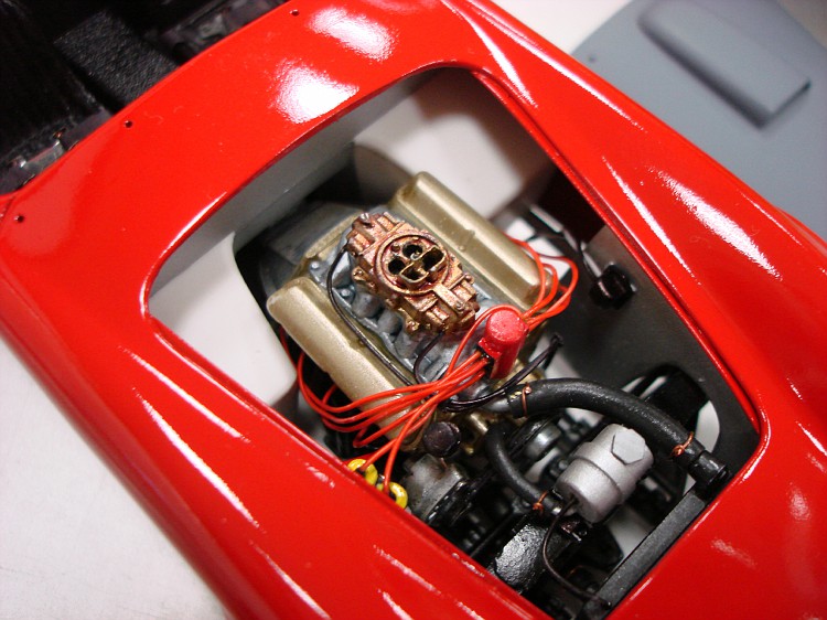

afx Posted May 19, 2021 Share Posted May 19, 2021 (edited) I agree the AMT '67 Mustang has a nice SBF in 1/25 scale. I also like the Revellogram '65/'66 Mustang/Shelby SBF. Its 1/24 scale but have used successfully in several 1/25 scale builds. In a 1/25 scale AMT '66 Falcon. Edited May 19, 2021 by afx Quote Link to comment Share on other sites More sharing options...
tim boyd Posted May 19, 2021 Share Posted May 19, 2021 40 minutes ago, afx said: I also like the Revellogram '65/'66 Mustang/Shelby SBF. Its 1/24 scale but have used successfully in several 1/25 scale builds. JC.....killer job on that engine. Looks so real.....TIM PS - Jeff, the engine in the AMT Shelby Cobra Roadster Trophy Series kit is thought to be a 260 V8 as that is what was put in the early Cobra roadsters built by Shelby....TB Quote Link to comment Share on other sites More sharing options...

afx Posted May 19, 2021 Share Posted May 19, 2021 1 hour ago, dodgefever said: It is, but it's about .080" too narrow compared with the SBF engines in the AMT '67 Mustang and the Revell '32 Fords and the heads have no detail at all. I'm building one now. I've widened the block and I'm using the heads and a modified intake from the '32 Ford kit. I have used the Revellogram SBF in several AMT Cobra builds. A few detail changes can be made for it to represents a 260. 1 Quote Link to comment Share on other sites More sharing options...
