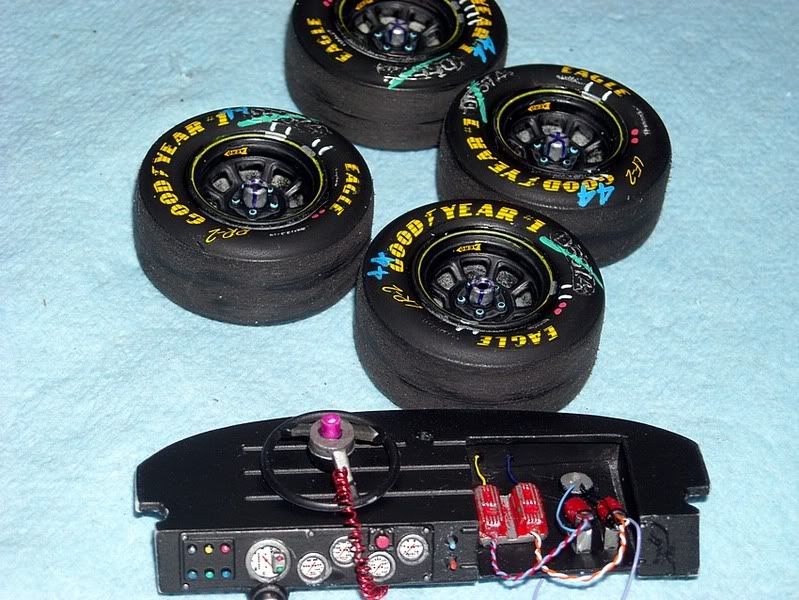

Mach2 Posted January 12, 2009 Posted January 12, 2009 I use a number of them for details and touch up on the NASCAR models I build. I like the multi colored set of fine point sharpies for marking the wheel hub lines from the lug nugs, and also use the black fine point and touck the painted lug nuts in the center to represent the wheel stud sticking from the lug nut. I use a standard silver sharpie and mark the wheels on the outer perimeter to represent wheel balancing weights. Sure wish sharpie would come out witha fine point silver one. I have a brand new silver sharpie to lightly touch the raised bolts heads on the dash panel and to highlight the bolt heads on the windows. Just remember to let the ink dry at least a day before using a lacquer clear. I sant the heads of the painted switches on the dash and touch them with different color sharpies. All kinds of usefull ways to use the different sharpies.
