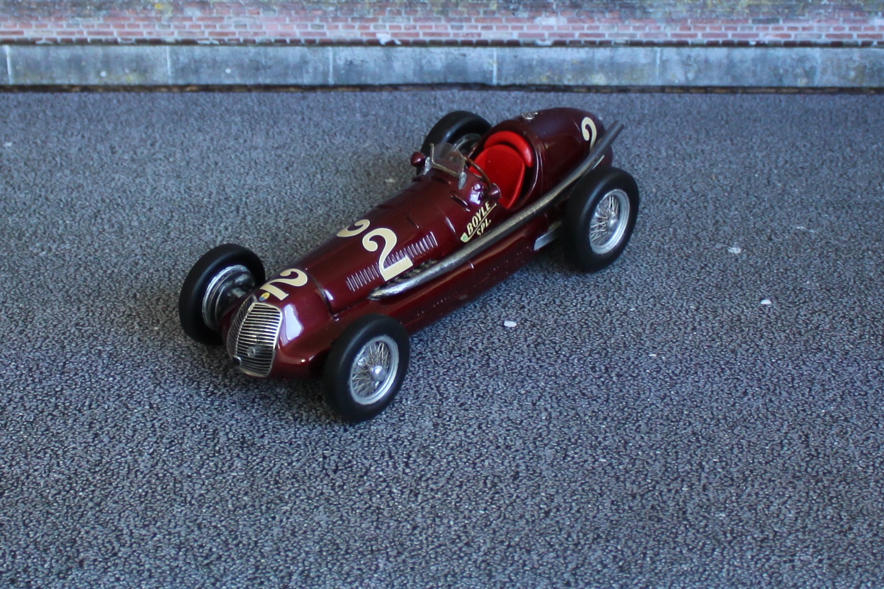

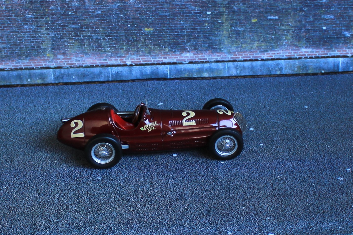

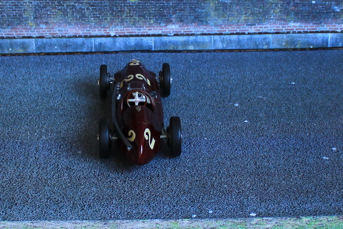

Some time back my good mate received two of these kits from a friend in the US.  As we do a fair bit of wheeling and dealing I ended up with one of them.
It was a very basic resin kit, nicely apportioned body, beautiful photo etched wire spokes and grill and nice resin wheel/tyre.  I decided the kit deserved better than the other parts supplied so proceeded to make my own rear 1/4 leaf springs and trailing arms, upper and lower front suspension arms and tie rod, brake drums (spares from a Merit Alfa 158) and backing plates. I also removed the louvres on each side of the bonnet as they were all different lengths and cut in some I had previously cast in resin from a Monogram Indy car, made up an aluminium floor area around the gearbox and changed the seat to a more accurate one.
Prepped and sprayed with auto acrylic undercoat I then mixed and sprayed my own auto acrylic maroon, clear coated and polished out.  Decals that came with the kit were applied.
A challenging build and much more satisfactory than building a "kit".  Am now hoping another mate can 3D filament print me an Alfa 33 Periscopia.

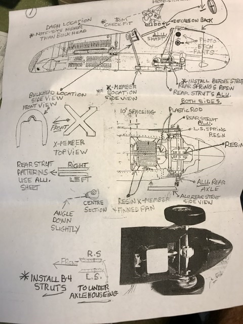

Thanks guys, sorry Larry I have no idea who made it.  Plain white cardboard box and the instructions were photocopies hand written.

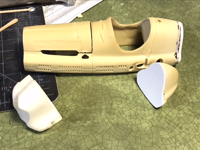

Alrighty then - you’re in Australia - I think - I’m in Miami - I think - and the kit maker is the late Gary Doucette - who lived in Toronto!   ...
The scale is 1/25.  I’ve started to mess around with my kit but haven’t really gotten much farther than you see here  -
