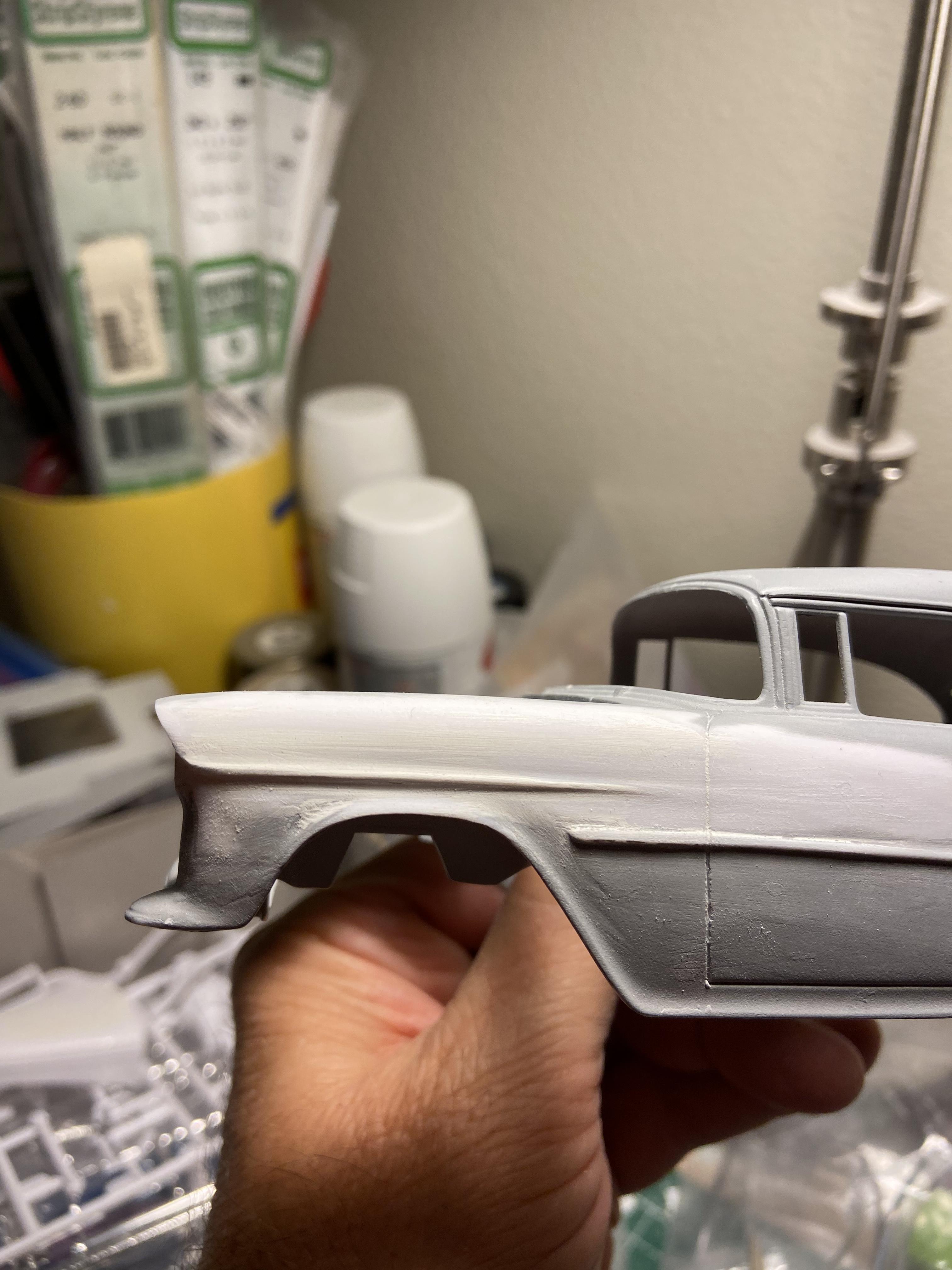

carnut Posted September 25, 2021 Author Posted September 25, 2021 Sorry it’s been quite a while since I last updated anything, but I’ve been rather busy on other projects and other things. Here is the update: I took a good look at the front fenders of the 55 Bel Air after sanding off the chrome trim and I decided to put in the stock fender brow (or whatever it’s called). So I got out my smallest styrene rod and glued on a piece on both sides. Now the fun part, to sand it down and shape it properly. No I’m not putting on the chrome trim again. But I’m putting the body line characteristic back in that the chrome trim hid. Isn’t customizing fun especially building mild customs. Cheers and keep smiling.

NOBLNG Posted September 26, 2021 Posted September 26, 2021 Just my thought…you could shorten the original raised fender detail so it ends over the front wheel like in Keith’s illustration. Then it will not conflict with the new side trim?

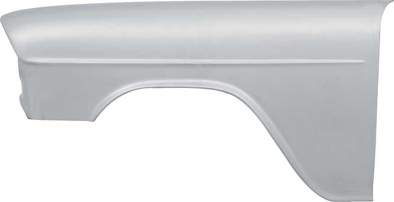

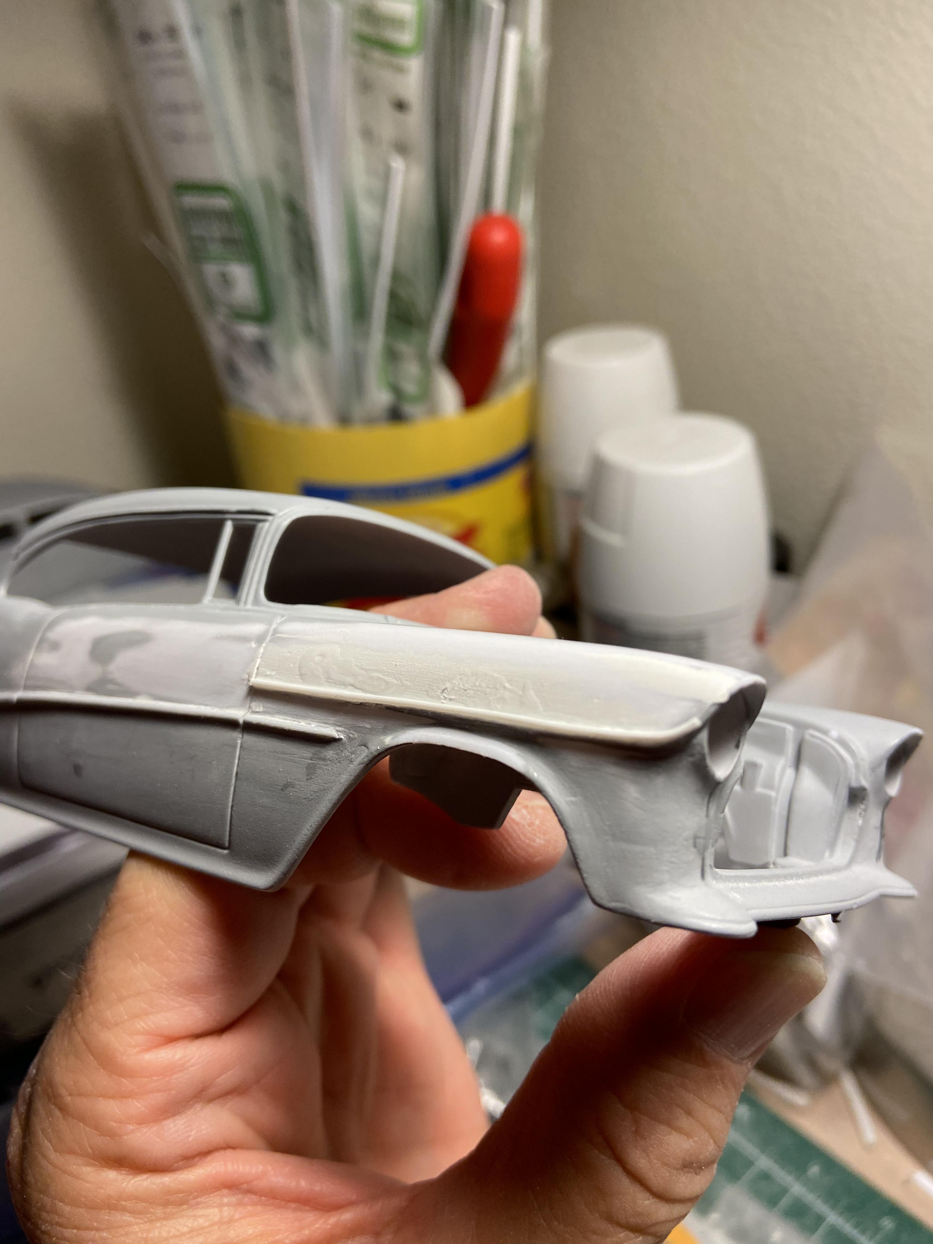

carnut Posted September 27, 2021 Author Posted September 27, 2021 (edited) This is looking a whole lot better now. The front fender is looking closer to stock. All I need to do now is apply a very thin coat of 3M Glazing Putty and sanded out and I should be good. The other photos I’m sharing is Henry Hodson’s custom 55 Bel Air built in the late 1950’s - early 1960’s, shown is the earlier versions. In 1960 he had the car chopped at Barris’s shop and repainted. There is also a photo I’m sharing of a stock 55 Chevrolet Bel Air replacement panel. I like Keith Wessner’s illustration but I’m only using it as inspiration. My intention is to remove the stock trim and hopefully restore the stock body lines. This was pretty typical of the late 50’s early 60’s custom time period that I noticed in old photos as I did my research. I did sand everything off but it just didn’t look right. Which is why you guys didn’t see any progress for a couple of weeks. I had to get a look at this and reconsider. Thanks for the comments, they are always welcome. Now onto the right side. Cheers. Edited September 27, 2021 by carnut

carnut Posted October 2, 2021 Author Posted October 2, 2021 (edited) Pardon the poor photography, getting both fenders to match. Time to re-scribe the door lines and shoot a bit of primer but it’s getting there. Edited October 2, 2021 by carnut

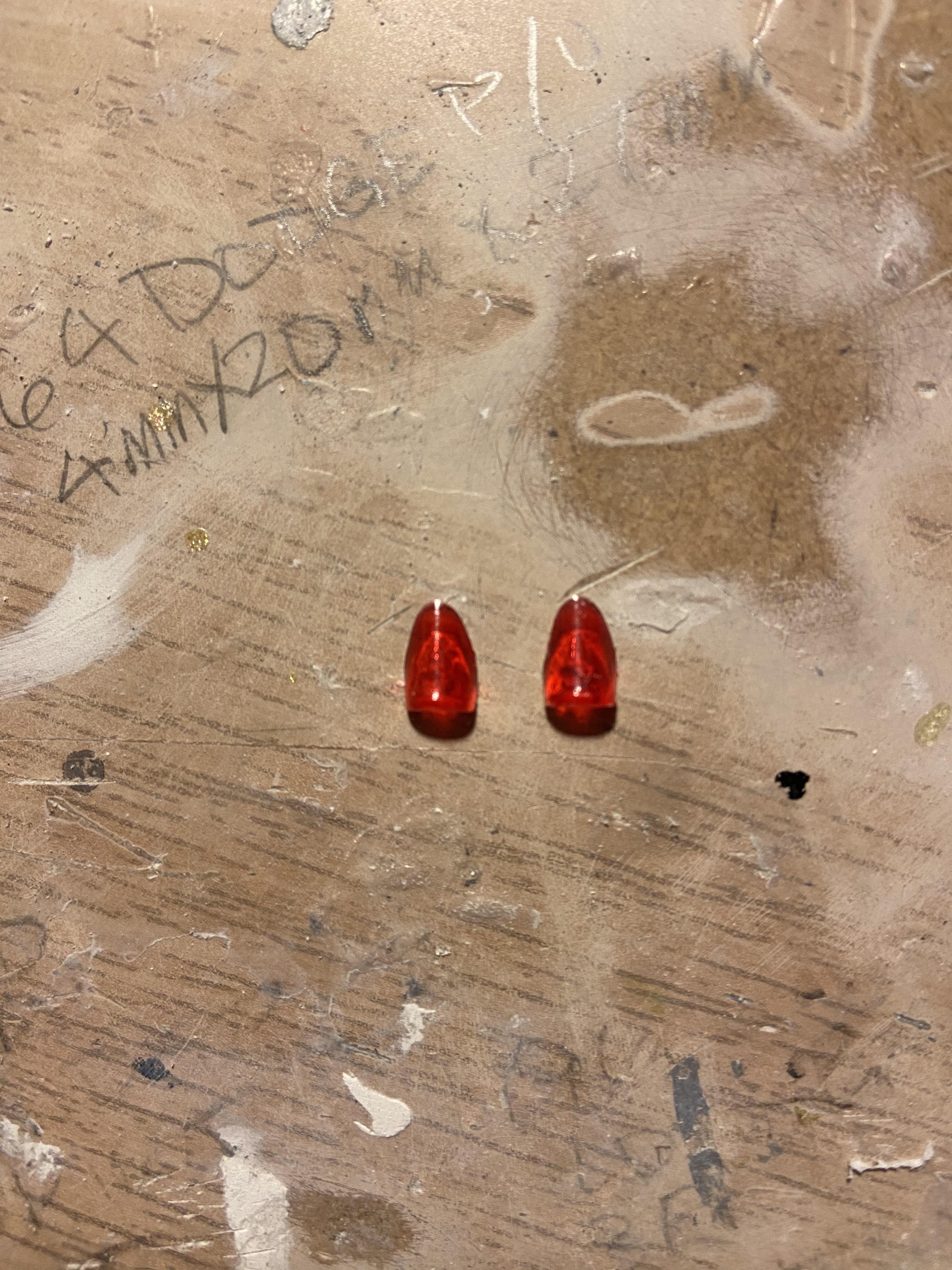

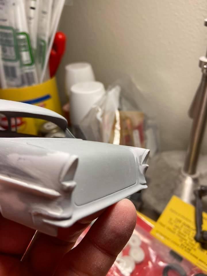

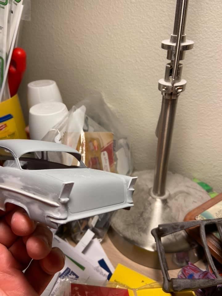

carnut Posted October 8, 2021 Author Posted October 8, 2021 Greetings all, I decided to turn my attention to the rear of the 55 Bel Air. I decided to use the custom taillights out of the AMT 55 Nomad kit. I cleaned up the bits of flash on the taillights and I did a little bit of re-shaping them. I now had to re-work and extend slightly the rear taillight housings in the fenders. So I glued on some Evergreen flat stock on the stock fender openings and using an emery board, I molded and re-shaped the Evergreen to the fenders and fitted the taillights. Then it was another bit of glazing putty and sanded the fenders smooth and a bit of primer. Not too bad. Thanks for looking, cheers.

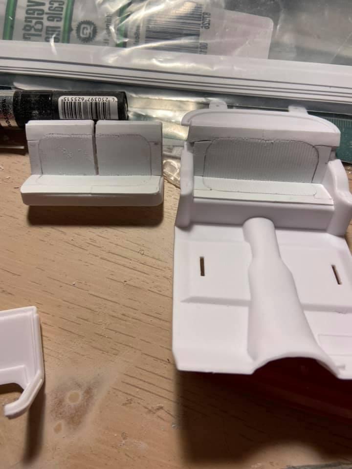

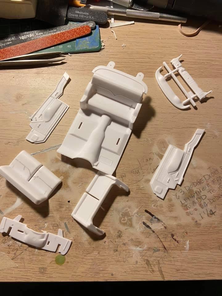

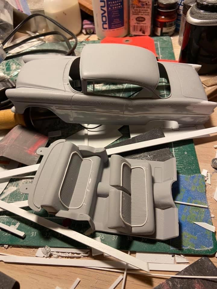

carnut Posted October 26, 2021 Author Posted October 26, 2021 Update -Interior: i just can’t seam to know when to leave things alone. I decided to do something extra to the interior. The door panels have a good pattern so I’m leaving that alone, but I decided to change the seat pattern. I just drew out what I wanted and measured everything to straighten it all out. Evergreen V Grove siding was used for the pleated inserts and I just built up the edges around the inserts with more Evergreen 1/4” strips. I cut the shapes to fit. Then filled the edges and sanded all smooth carefully. The separation line of the inserts looked terrible so I glued on some small half round to cover and straighten things out. What do y’all think?? thanks for looking and keep smiling.

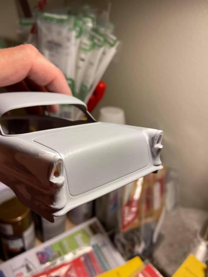

carnut Posted February 12, 2022 Author Posted February 12, 2022 Apologies for not keeping this updated, I’ve been rather busy on other things and the weather has been lousy here in the Pacific Northwest. Today the weather was good so I finally got some primer shot, the front fenders came out pretty good. Soon it will be time to paint color. Thanks for looking and the comments. Cheers. 2
