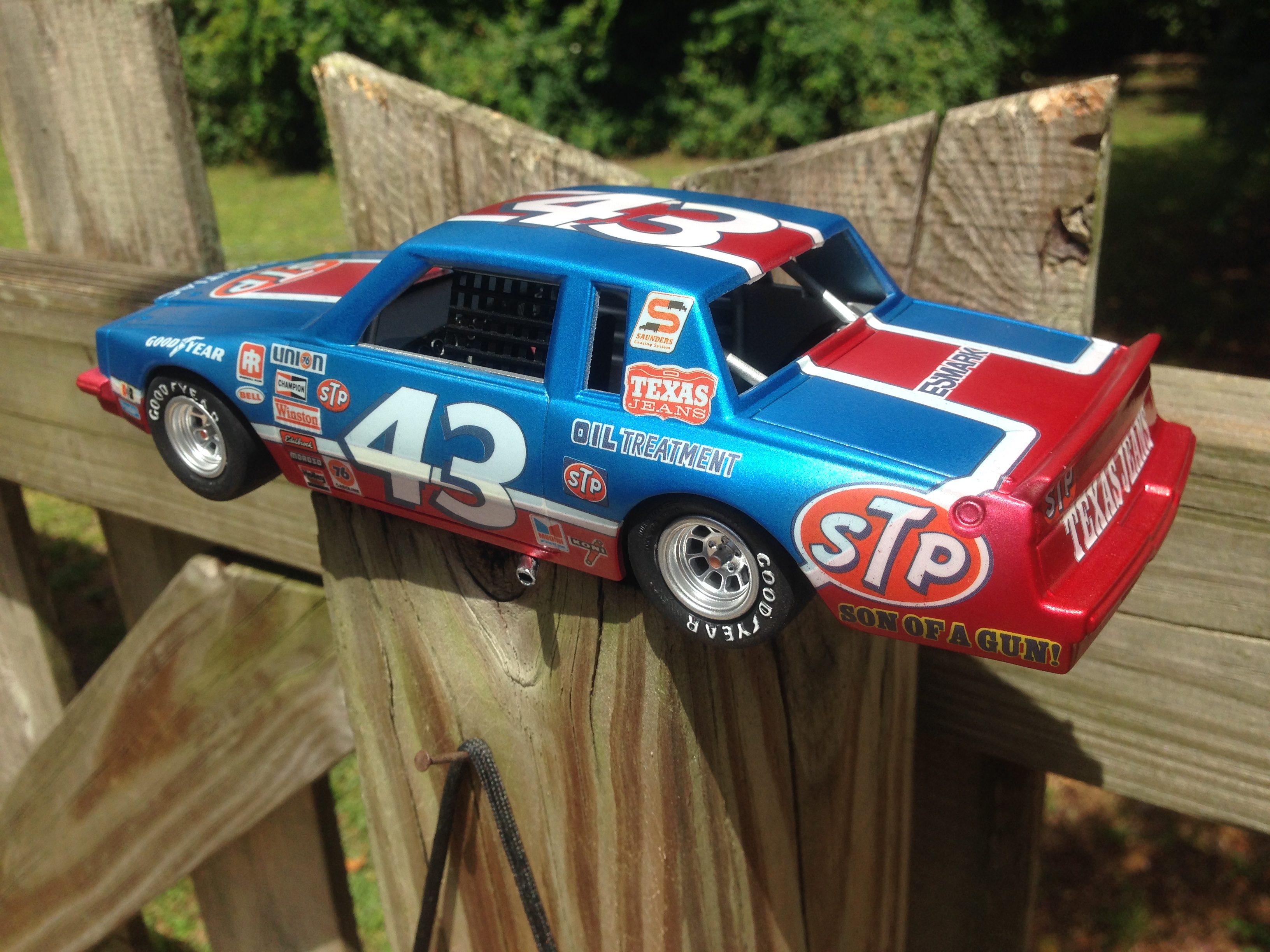

jchrisf Posted September 11, 2021 Posted September 11, 2021 (edited) The chrome paint doesn't make a great chrome paint but it does make a great base for a candy coat. Edited September 11, 2021 by jchrisf
Dave G. Posted September 11, 2021 Posted September 11, 2021 4 hours ago, jchrisf said: The chrome paint doesn't make a great chrome paint but it does make a great base for a candy coat. Awesome !! 1
