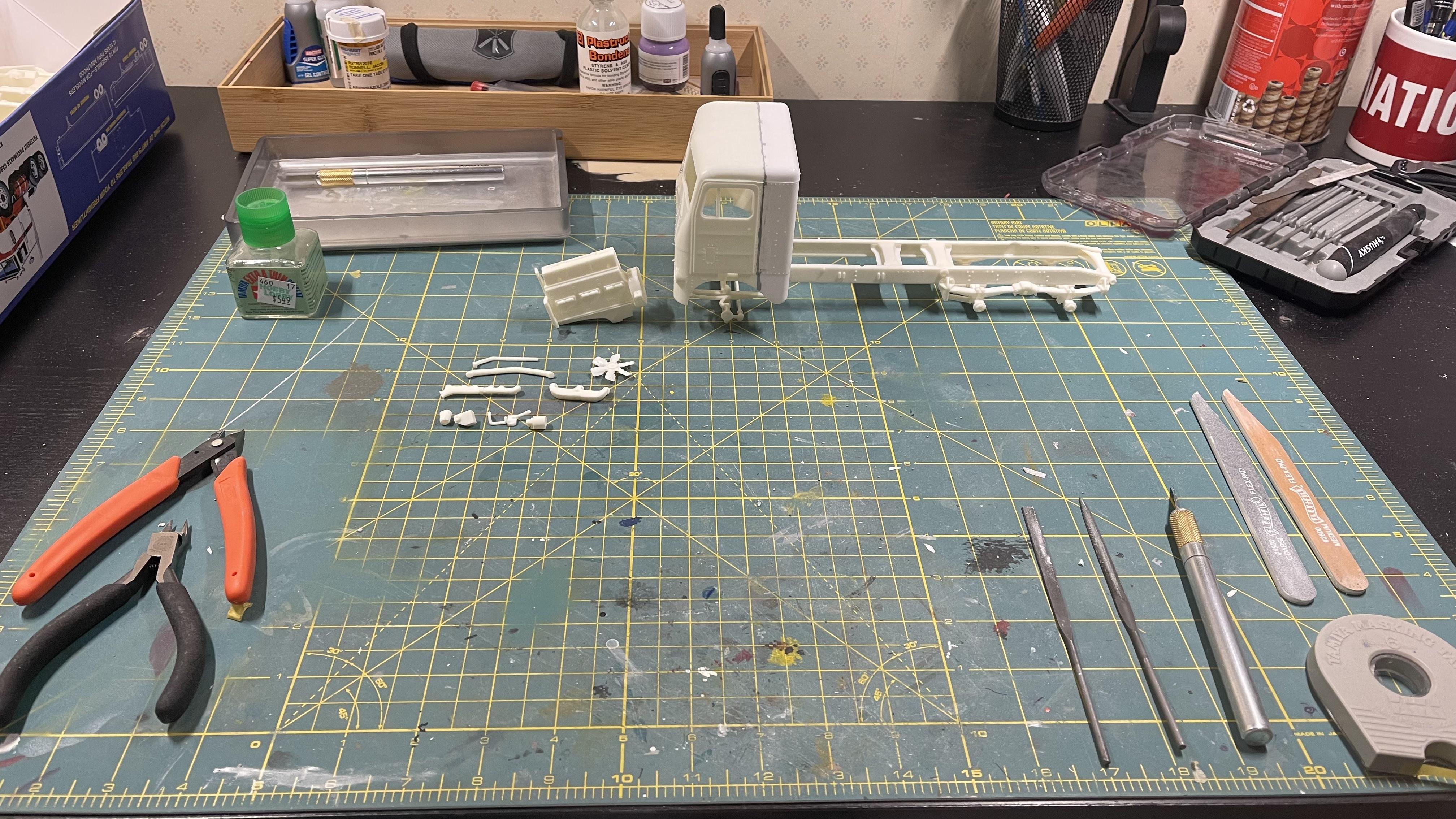

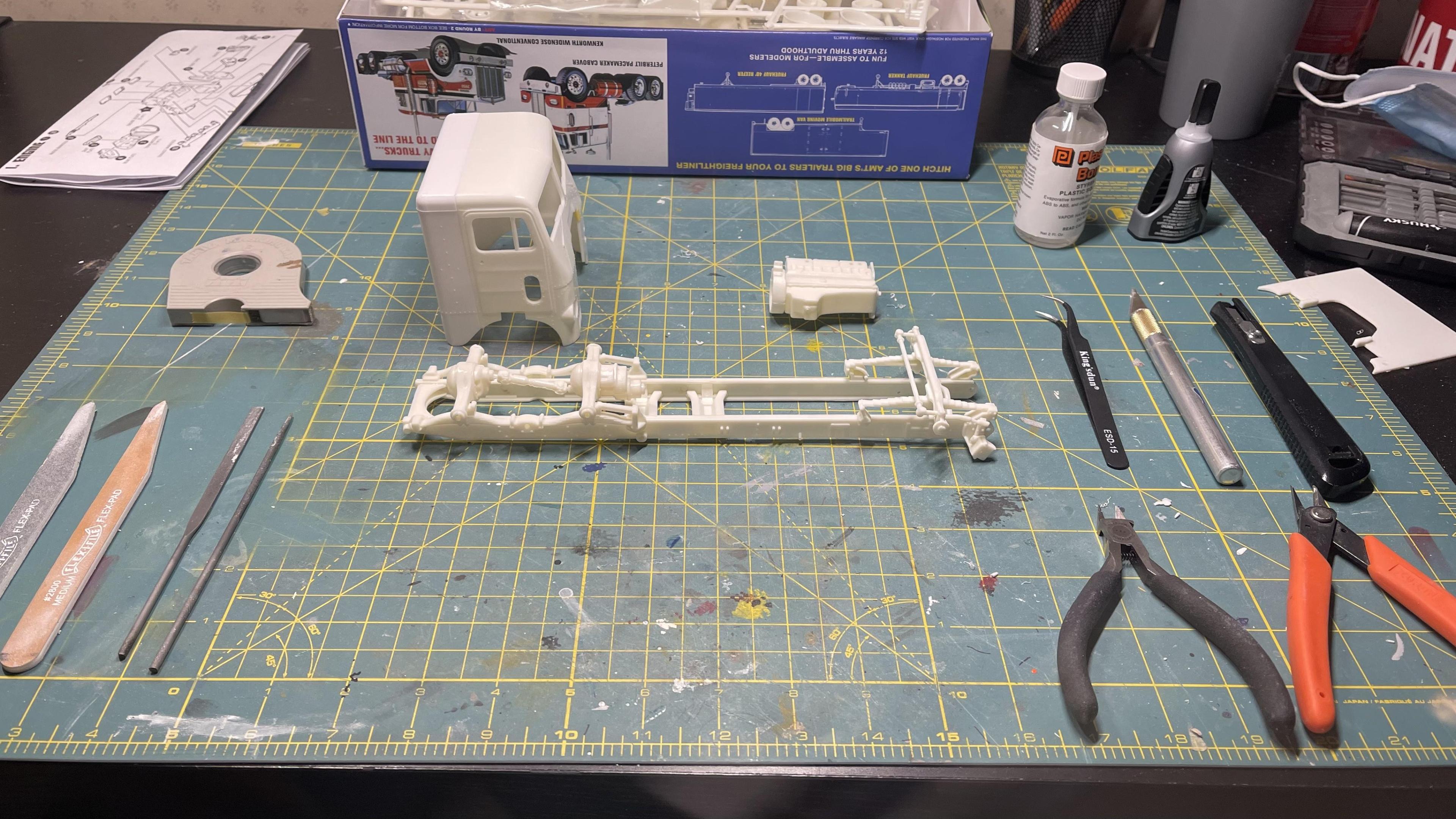

Rusty92 Posted January 3, 2022 Share Posted January 3, 2022 Howdy! This year I hope to complete a build off. I’ve built this kit before, but was not pleased with the results. I forgot how poor the instructions are at times. And the parts aren’t very crisp and have heavy flash. BUT, not going to let that stop me. So without further ado… Here is the kit in question. It’s a good challenge. I plan on building the day cab dual drive version. I’ll probably weather the kit but not too heavily. Below I’ll detail what I completed today. Today I only accomplished getting a portion of the frame cleaned up and assembled. Lots of sanding, test fitting, clamping, and filing just to get to this point. But it’s a straight frame at least! Good luck to everyone! I’m excited to see the end results! 1 Quote Link to comment Share on other sites More sharing options...

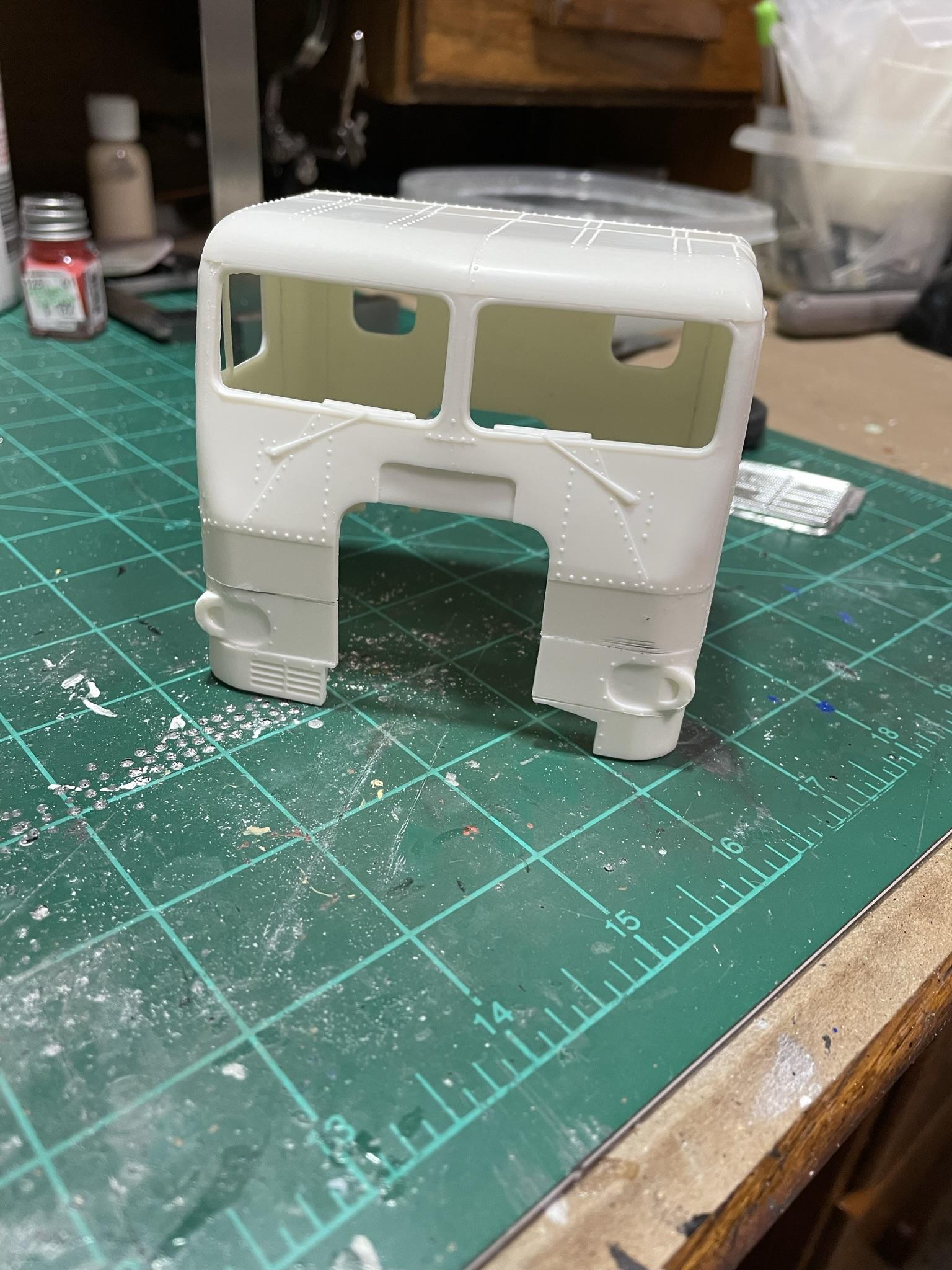

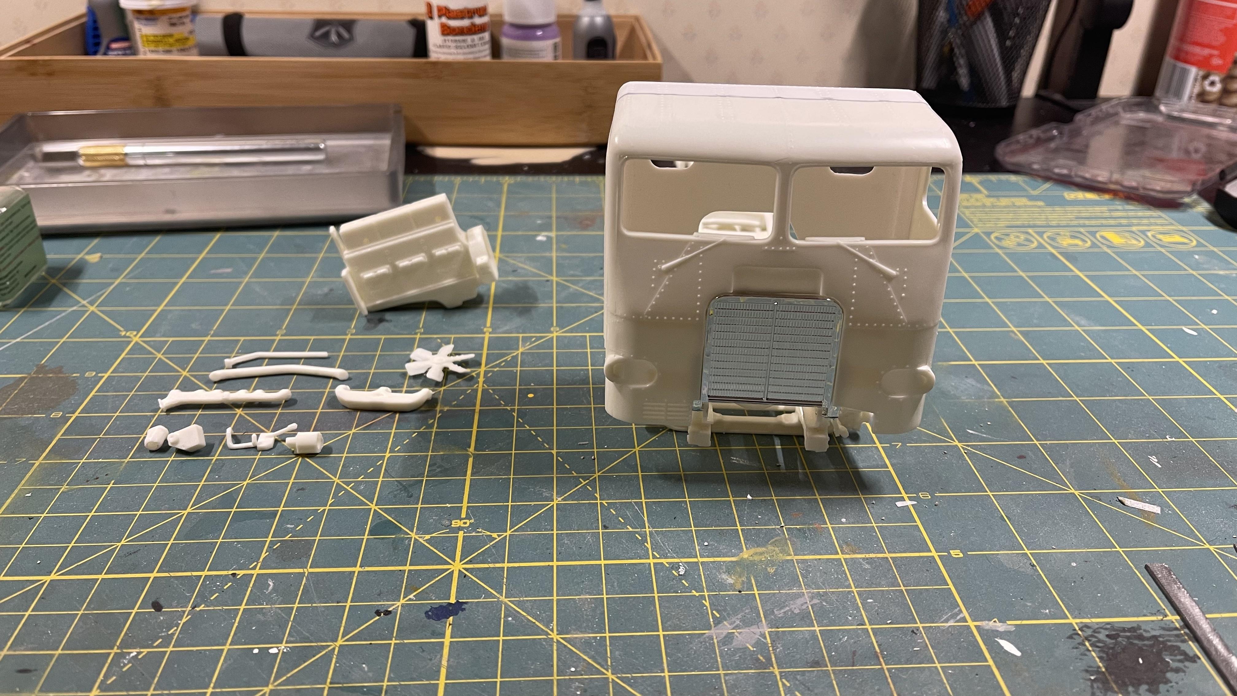

Rusty92 Posted January 4, 2022 Author Share Posted January 4, 2022 Only a little bit of progress tonight. Focused on the front end of the truck and squaring up the cab. Also started on the engine a little bit. I need to get some tan paint to match the color this Cummins would have been painted when new. Kind of frustrated that the rivets do not line up properly. Whatever I guess, it’s a small detail. I was thinking about doing a single exhaust stack for this build. A nice chrome straight pipe would be cool to me. Does anyone have an idea? The kit exhaust just looks undersized to me. 1 Quote Link to comment Share on other sites More sharing options...

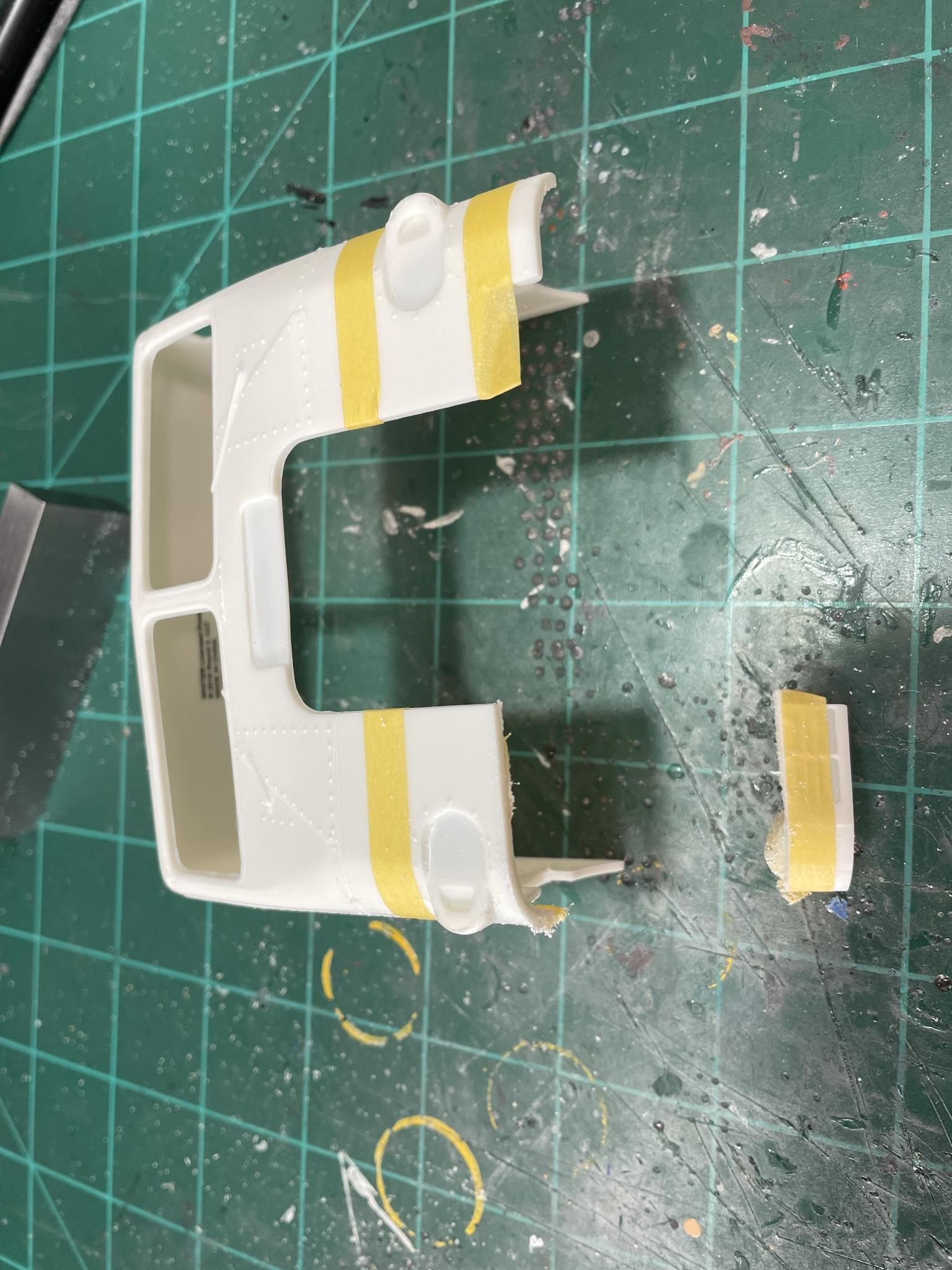

Mopar - D Posted January 4, 2022 Share Posted January 4, 2022 Nice start Jacob I’m currently rebuilding my Frightliner day cab with dual drive. Are you going to shorten the front axle and lower the head lights? Quote Link to comment Share on other sites More sharing options...
Rusty92 Posted January 4, 2022 Author Share Posted January 4, 2022 15 hours ago, Mopar - D said: Nice start Jacob I’m currently rebuilding my Frightliner day cab with dual drive. Are you going to shorten the front axle and lower the head lights? Thanks, Dan. I hadn’t thought about that at all. Is that something that builders typically do to this kit? You’ve piqued my interest. 1 Quote Link to comment Share on other sites More sharing options...
Mopar - D Posted January 4, 2022 Share Posted January 4, 2022 Yes these are known problems with this kit and there’s a couple WIP’s showing how to fix them. I cut about 1/8” out of the middle of the front axle and lowered the head lights about 1/8” also. 2 Quote Link to comment Share on other sites More sharing options...

Rusty92 Posted January 7, 2022 Author Share Posted January 7, 2022 Only a little bit of progress tonight. I got the cab puttied and sanded, cab mounts placed, and some small engine parts cleaned up. I’m waiting for my paint booth and new hobby desk to arrive before I start painting things. I think I’ll paint the semi metallic blue, but not 100% set on that. I’ve enjoyed this build so far. I hope everyone’s BRBO is going well so far. Thanks for looking. 1 Quote Link to comment Share on other sites More sharing options...

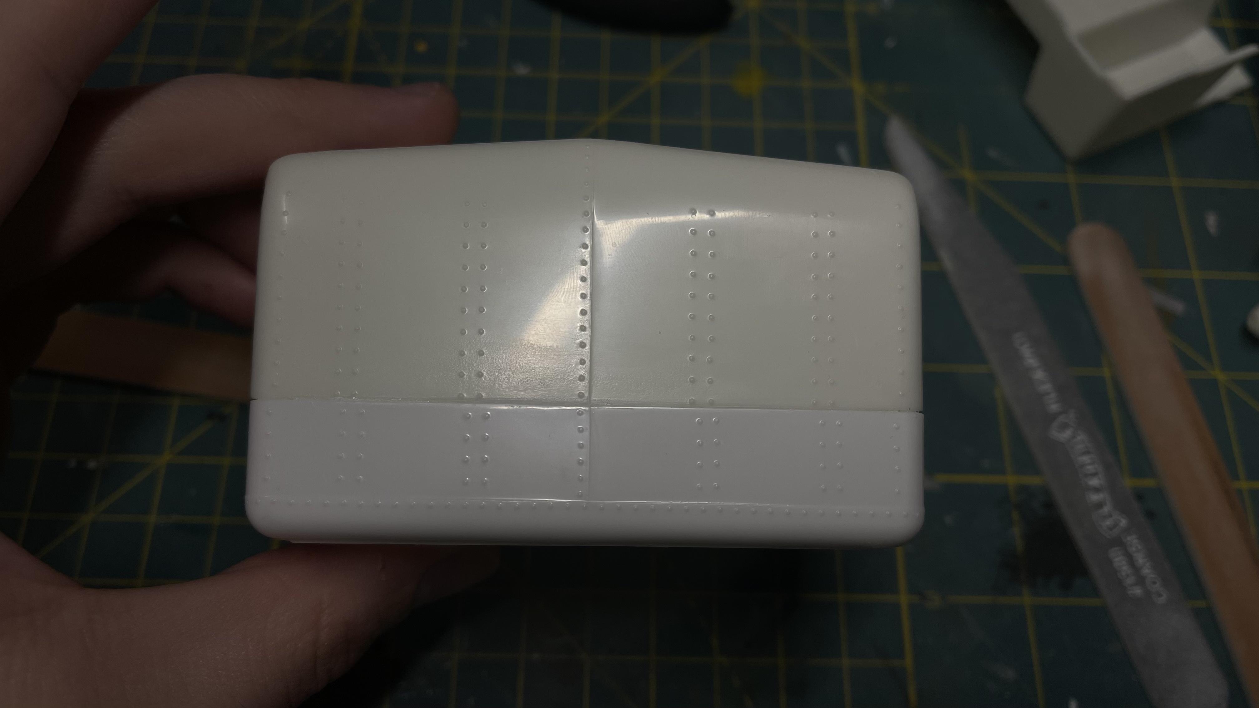

Rusty92 Posted February 9, 2022 Author Share Posted February 9, 2022 Thanks guys! I need to get back at this one. I want the cab to look great and filling in the seams is a little daunting. I don’t want to lose detail on the rivets, but sanding them off at the seam might be the easiest. I can add them back later with some small styrene round stock. 1 Quote Link to comment Share on other sites More sharing options...
