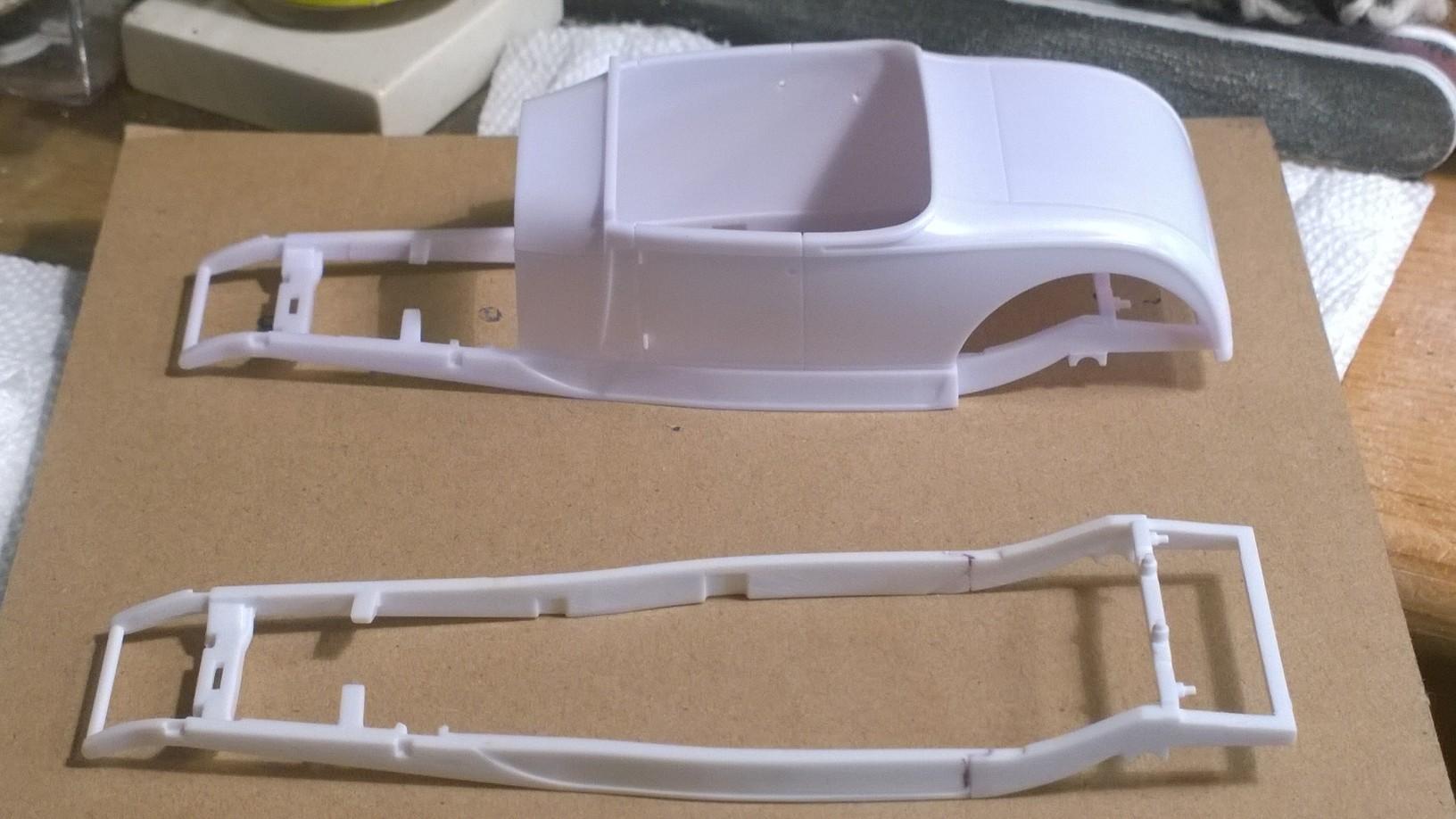

Because the Revell '29 Roadster kit offers a choice of two frames, the '29 Track Nose Roadster will be running on the '29's Deuce frame.  Revell's Deuce Rails are designed to allow the builder to have a High Boy roadster.
Looking down at the deuce rails you can see the difference between the rear of the frame designed to fit inside and under the roadster body:
To achieve the track nose's overall height the body will be channeled over the frame, so modifying the rails to fit under the body took some studying.  Here's the before and after:
Narrowing the '29 Deuce Frame Notches Kut Out
