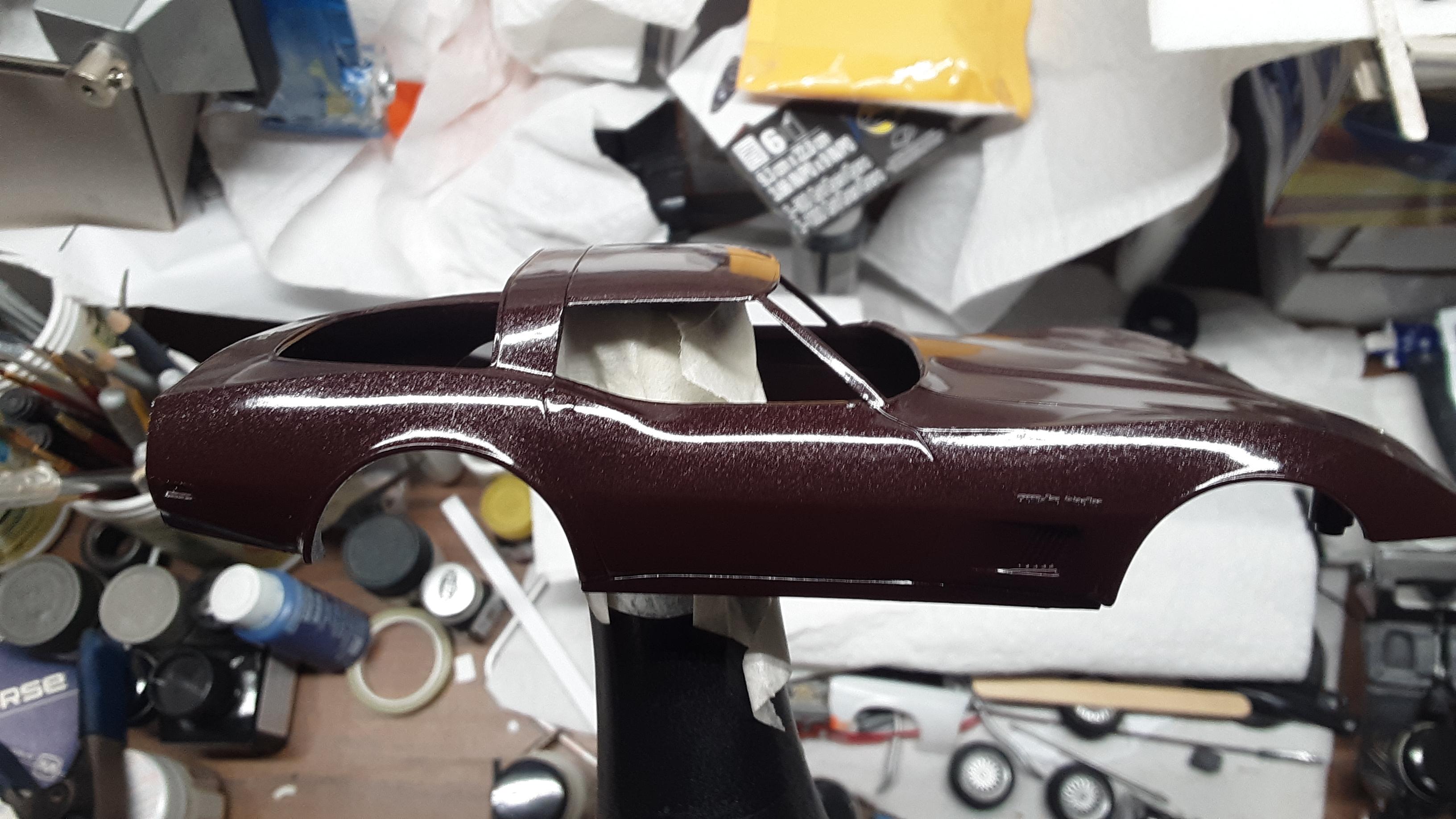

Dodge Driver Posted January 8, 2022 Posted January 8, 2022 (edited) Below is a Corvette promo body wearing its factory paint. The clear is 3 or so wet coats of Duplicolor Perfect Match Clear from the can. I am quite pleased with the results. This is my best clear coat job to date. I was astounded to see so little orange peel once the clear set up. Edited January 8, 2022 by Dodge Driver

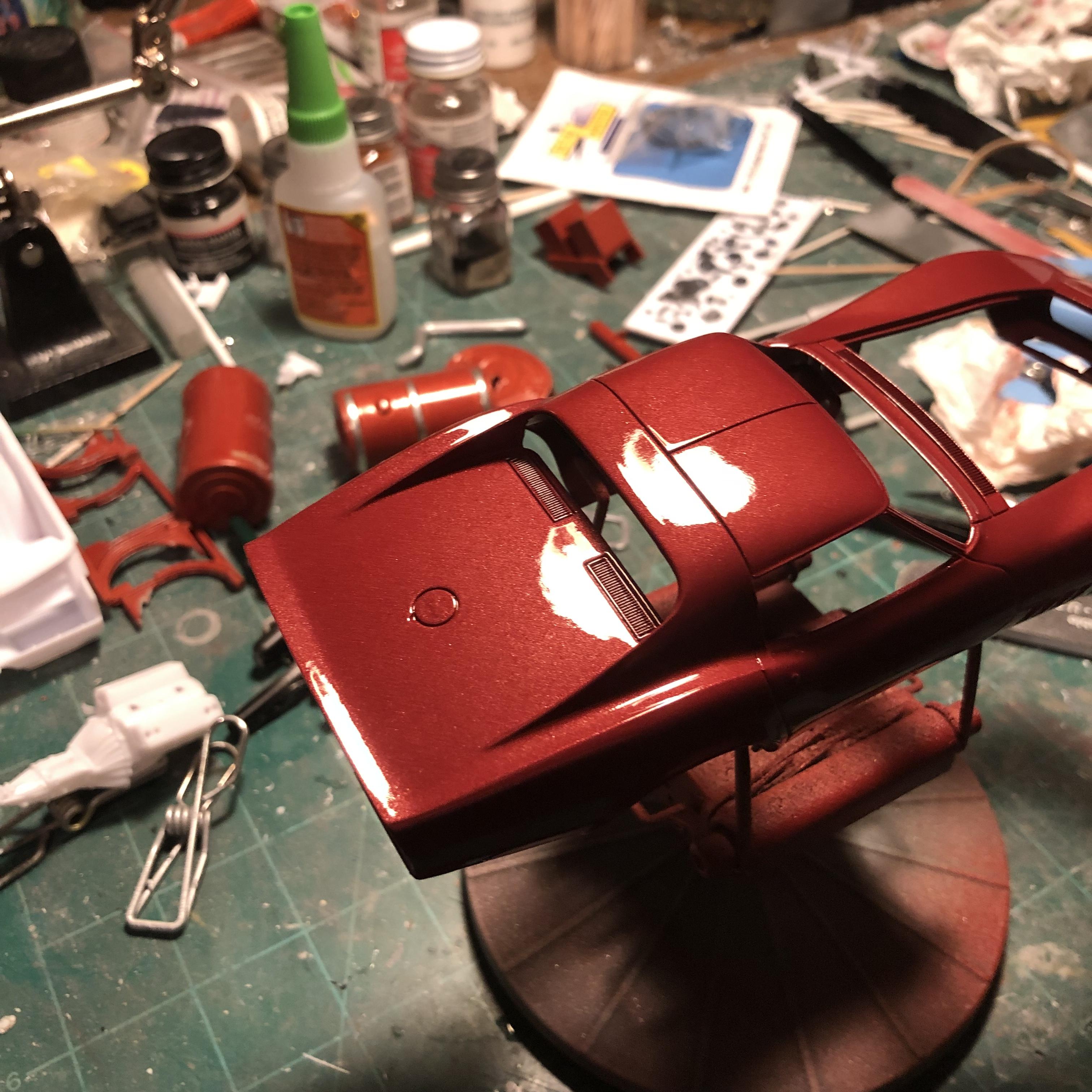

robdebie Posted January 8, 2022 Posted January 8, 2022 Try the 'Donn Yost' or 'Andy X' method! I found it some months ago, and it worked extremely well for me. Here are some test pieces - so far it worked with all brands of model enamel that I tried. The method is simple and easy, give it a try! Rob
rightrudder Posted January 8, 2022 Posted January 8, 2022 Wow, great results all around. But Luke, your Bel-Air is a freekin' mirror!! Thanks for the inspiration.

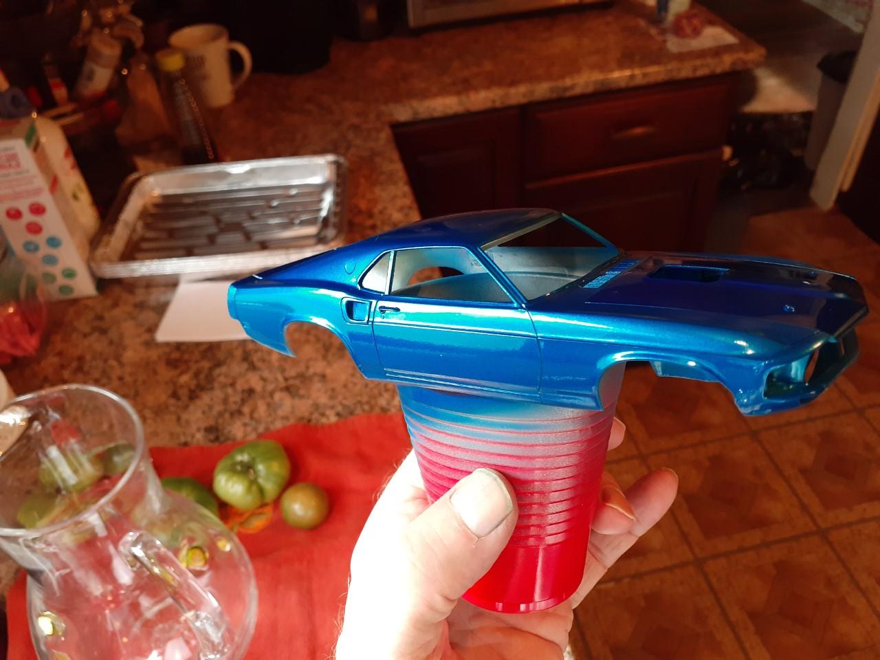

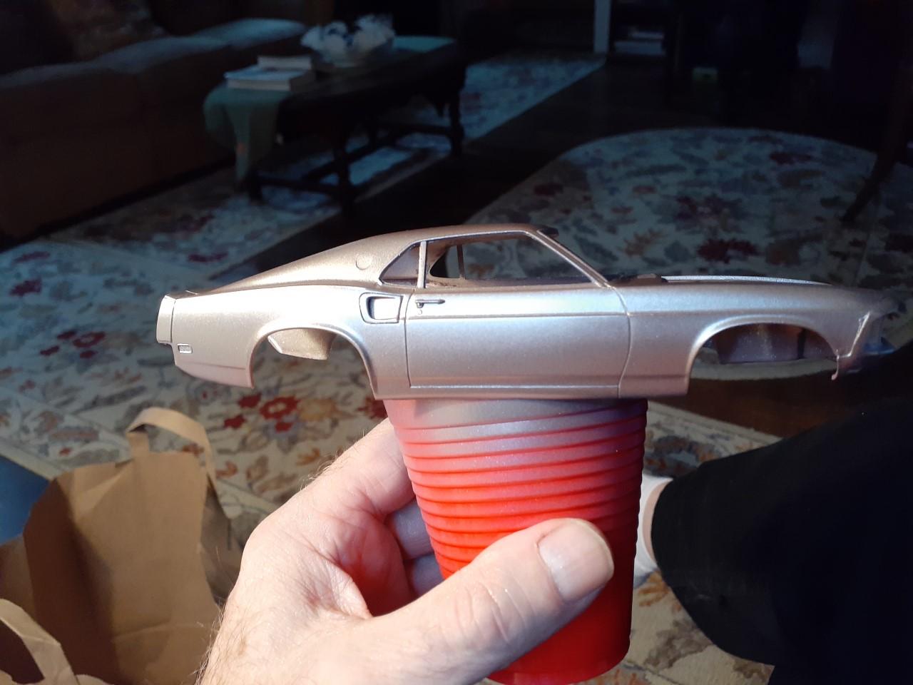

Dave G. Posted January 8, 2022 Posted January 8, 2022 (edited) The top photo is Base coat ( Craft Smart craft paint) followed in the second photo with Tamiya clear blue acrylic. Not polished , straight out of the dehydrator after drying in both cases. Edited January 8, 2022 by Dave G.
Zippi Posted January 8, 2022 Posted January 8, 2022 4 minutes ago, Dave G. said: The top photo is Base coat ( Craft Smart craft paint) followed in the second photo with Tamiya clear blue. Not polished , straight out of the dehumidifier after drying in both cases. Dave....is the silver base coat a primer or a silver that would be used for a finish coat?
Dave G. Posted January 8, 2022 Posted January 8, 2022 (edited) 25 minutes ago, Zippi said: Dave....is the silver base coat a primer or a silver that would be used for a finish coat? The primer was white Stynylrez with a drop of black in it, so kind of platinum. The silver which doesn't show in the photo is actually called rose gold, it is more silver than gold though in that particular brand but depending on your monitors color balance you might pick up a hint of the very faint underlying rose in it.. So the silver is a craft paint base coat thinned with my own thinner formula, the name is Rose Gold and the brand is Craft Smart which not my favorite craft paint. That's about 4 coats you see there, might even be 5. The blue is more like the 5-6 but progressively wetter coats till the final full wet coat . So as you can imagine I shoot the stuff pretty thinned out. The clear blue was thinned with Lacquer thinner. The Stynylrez on that model I don't recall how I thinned it but these days I thin that with lacquer thinner as well. I rarely shoot straight Stynylrez almost always thinning it. Because if you start with a rough primer coat it gets worse and worse as more colors are added. Stynylrez with LT goes on baby bottom smooth. Edited January 8, 2022 by Dave G.
