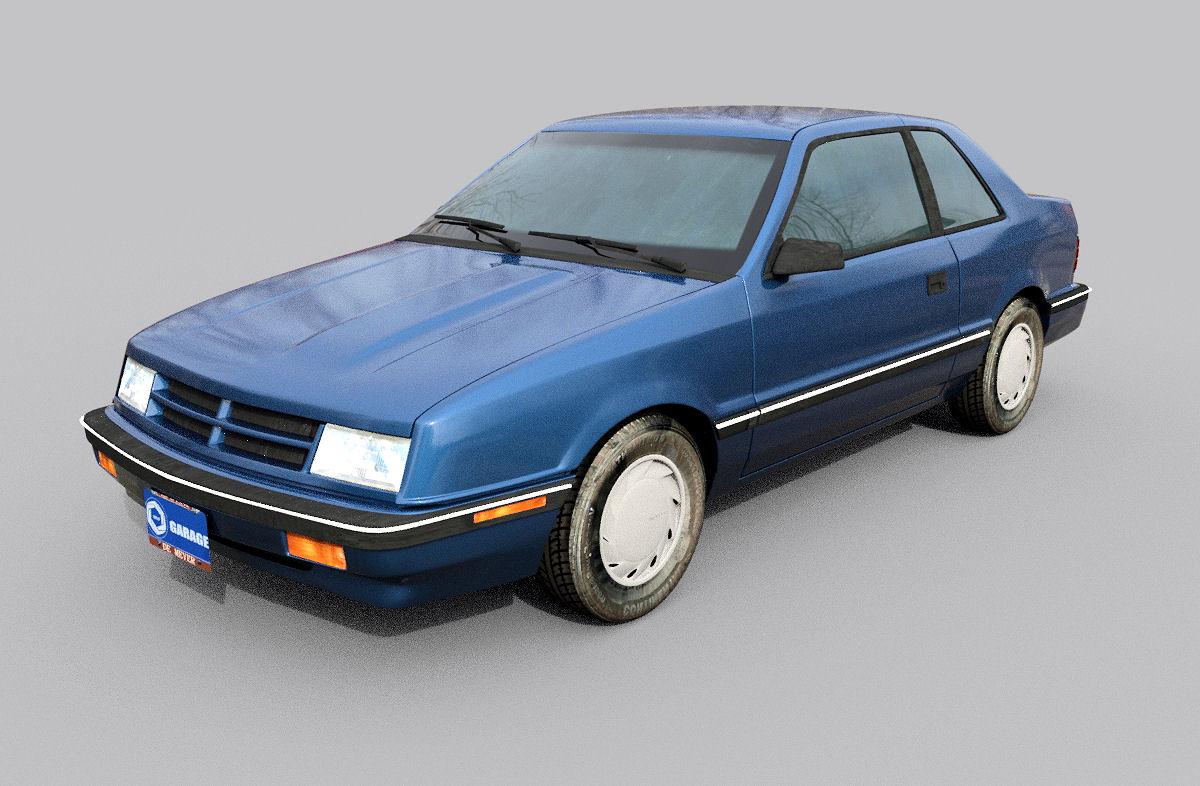

crowe-t Posted September 19 Share Posted September 19 Is there anyone here who can design a 1991 Dodge Shadow body for me? I have other pictures, drawings and can provide measurements of the 1:1. Quote Link to comment Share on other sites More sharing options...

Michael jones Posted October 1 Share Posted October 1 On 9/19/2024 at 2:04 PM, crowe-t said: Is there anyone here who can design a 1991 Dodge Shadow body for me? I have other pictures, drawings and can provide measurements of the 1:1. You can draw it yourself in blender with some time and learning. Start small and go from there. 1 Quote Link to comment Share on other sites More sharing options...
crowe-t Posted October 1 Share Posted October 1 6 hours ago, Michael jones said: You can draw it yourself in blender with some time and learning. Start small and go from there. I know but I wanted to build one for my wife soon for either Christmas or her birthday 3 months after that. I was hoping to find someone who can help me with this. Quote Link to comment Share on other sites More sharing options...
stitchdup Posted October 15 Share Posted October 15 On 10/1/2024 at 2:48 PM, crowe-t said: I know but I wanted to build one for my wife soon for either Christmas or her birthday 3 months after that. I was hoping to find someone who can help me with this. look for EDM 3D model on facebook. they have a 1990 version. i just found it on a google image search. i have no experience of their files but i have seen them used by other people on here https://www.facebook.com/story.php/?story_fbid=1209659840100836&id=100031704952544&_rdr Quote Link to comment Share on other sites More sharing options...

crowe-t Posted October 24 Share Posted October 24 (edited) On 10/15/2024 at 8:53 AM, stitchdup said: look for EDM 3D model on facebook. they have a 1990 version. i just found it on a google image search. i have no experience of their files but i have seen them used by other people on here https://www.facebook.com/story.php/?story_fbid=1209659840100836&id=100031704952544&_rdr Thanks Les! I actually found this a couple weeks ago and already got files from them of a '91 model. Edited October 24 by crowe-t 1 Quote Link to comment Share on other sites More sharing options...
