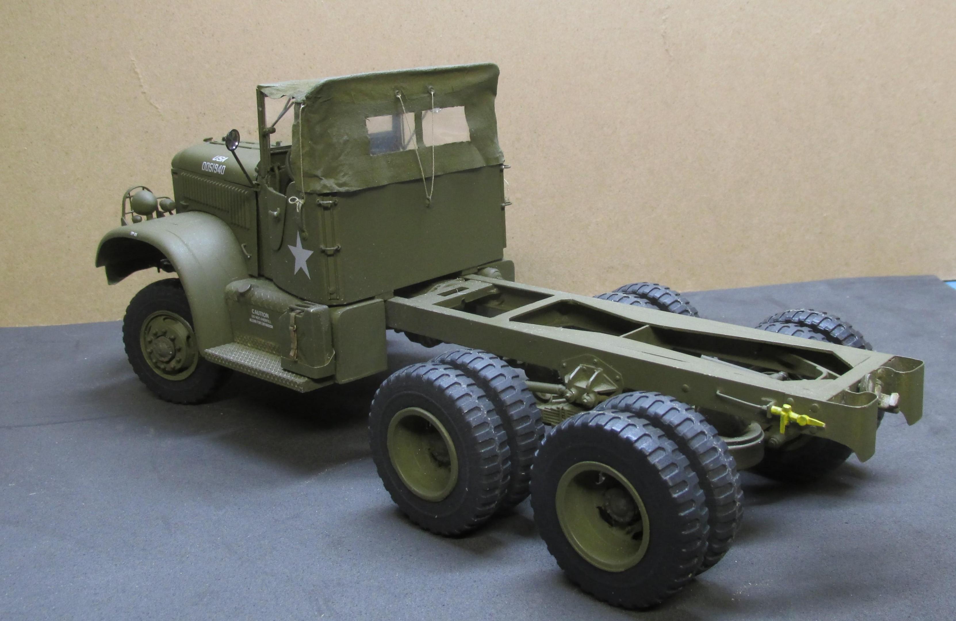

Chariots of Fire Posted December 10, 2022 Author Share Posted December 10, 2022 We can now say that the cab and chassis are complete. Time to get back to the body and the wrecker portion of this build. 1 Quote Link to comment Share on other sites More sharing options...

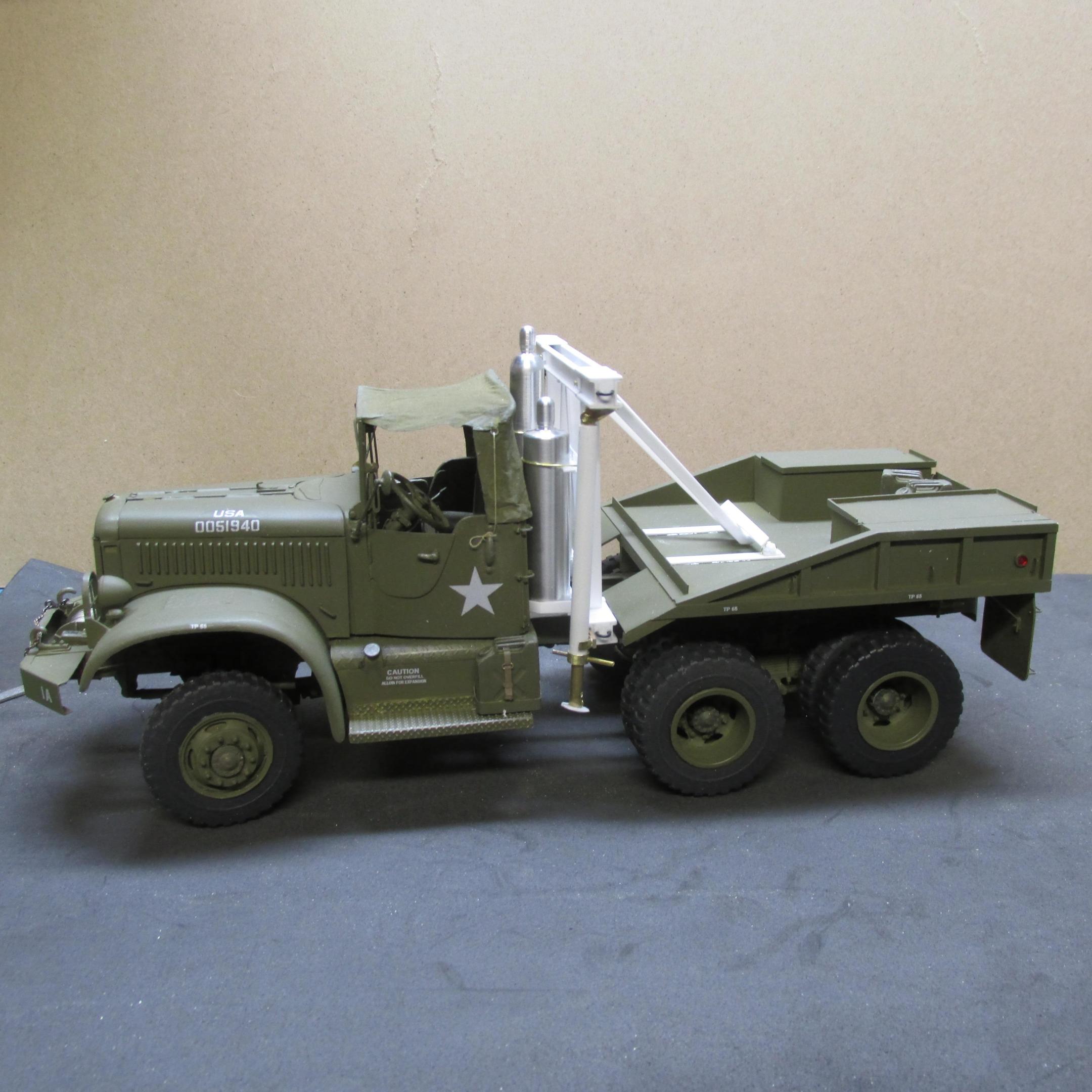

Chariots of Fire Posted December 16, 2022 Author Share Posted December 16, 2022 3 cans from now, Greg. Here's what it looks like as of tonite. I turned the acetylene and O2 tanks from aluminum rod and made mounting brackets for them. Quote Link to comment Share on other sites More sharing options...
Chariots of Fire Posted December 16, 2022 Author Share Posted December 16, 2022 Here are the turnings. They will be painted OD as well but with a red top for the Acetylene and a green top for the O2. 1 Quote Link to comment Share on other sites More sharing options...

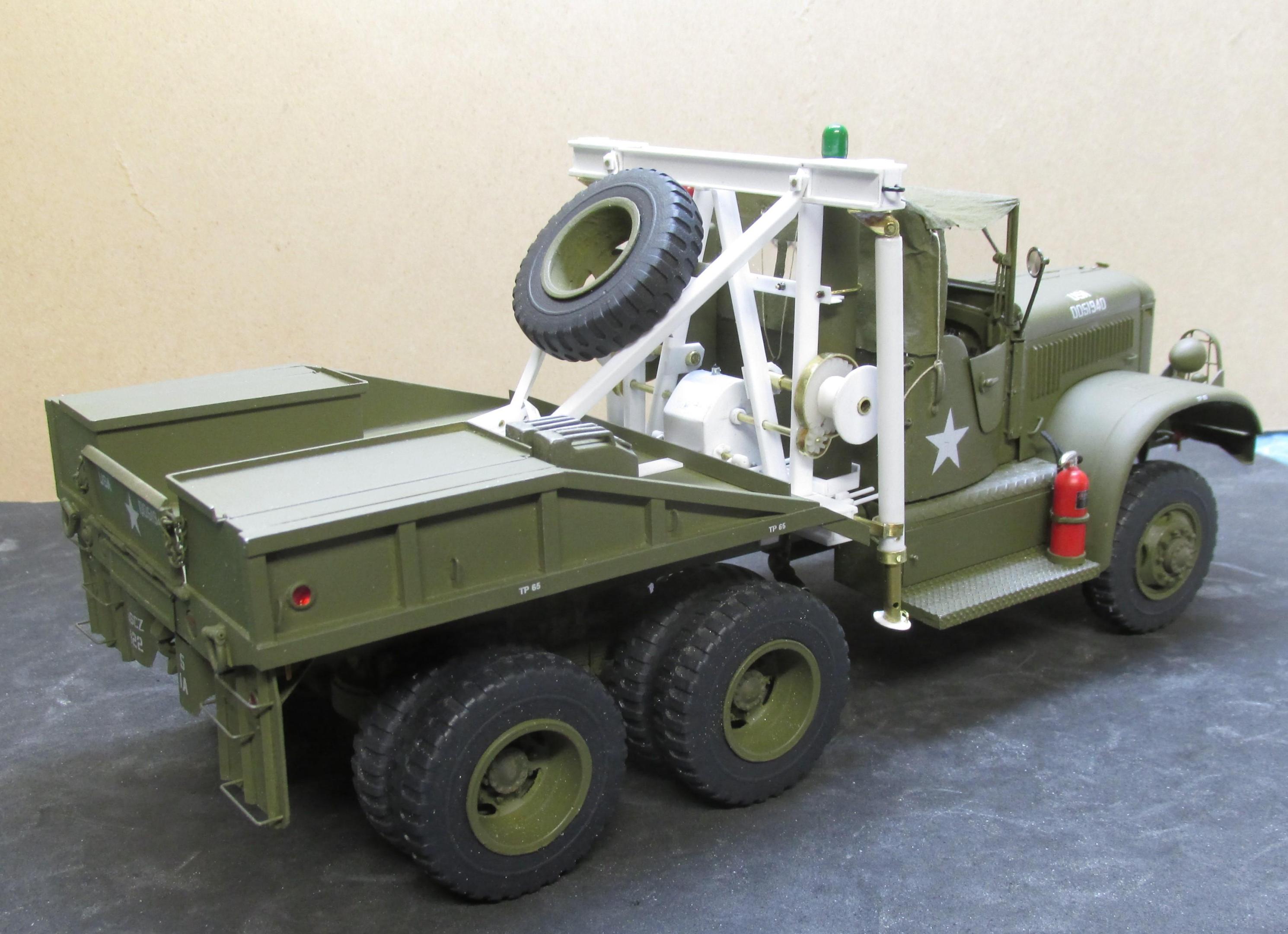

Chariots of Fire Posted December 20, 2022 Author Share Posted December 20, 2022 Here's a look at the nearly completed frame. I still have the double pulleys to make for the top cross member and the brackets for the booms that attach to the bottom cross member. The rest of the frame work is essentially done. 1 Quote Link to comment Share on other sites More sharing options...

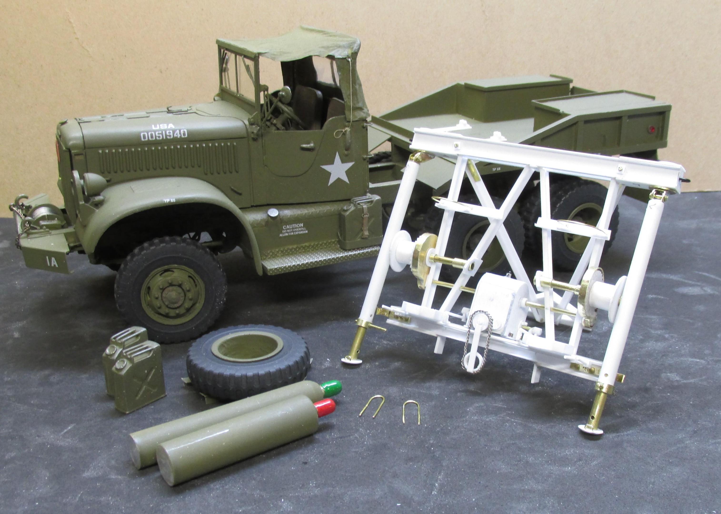

Chariots of Fire Posted December 27, 2022 Author Share Posted December 27, 2022 Been doing additional work on the wrecker frame. Winches are installed and awaiting cable. Working on the pulleys for up top. One is done. The other will be made using the brass materials shown. An air compressor and hose are done and go under the wrecker frame and spare tire. 1 Quote Link to comment Share on other sites More sharing options...

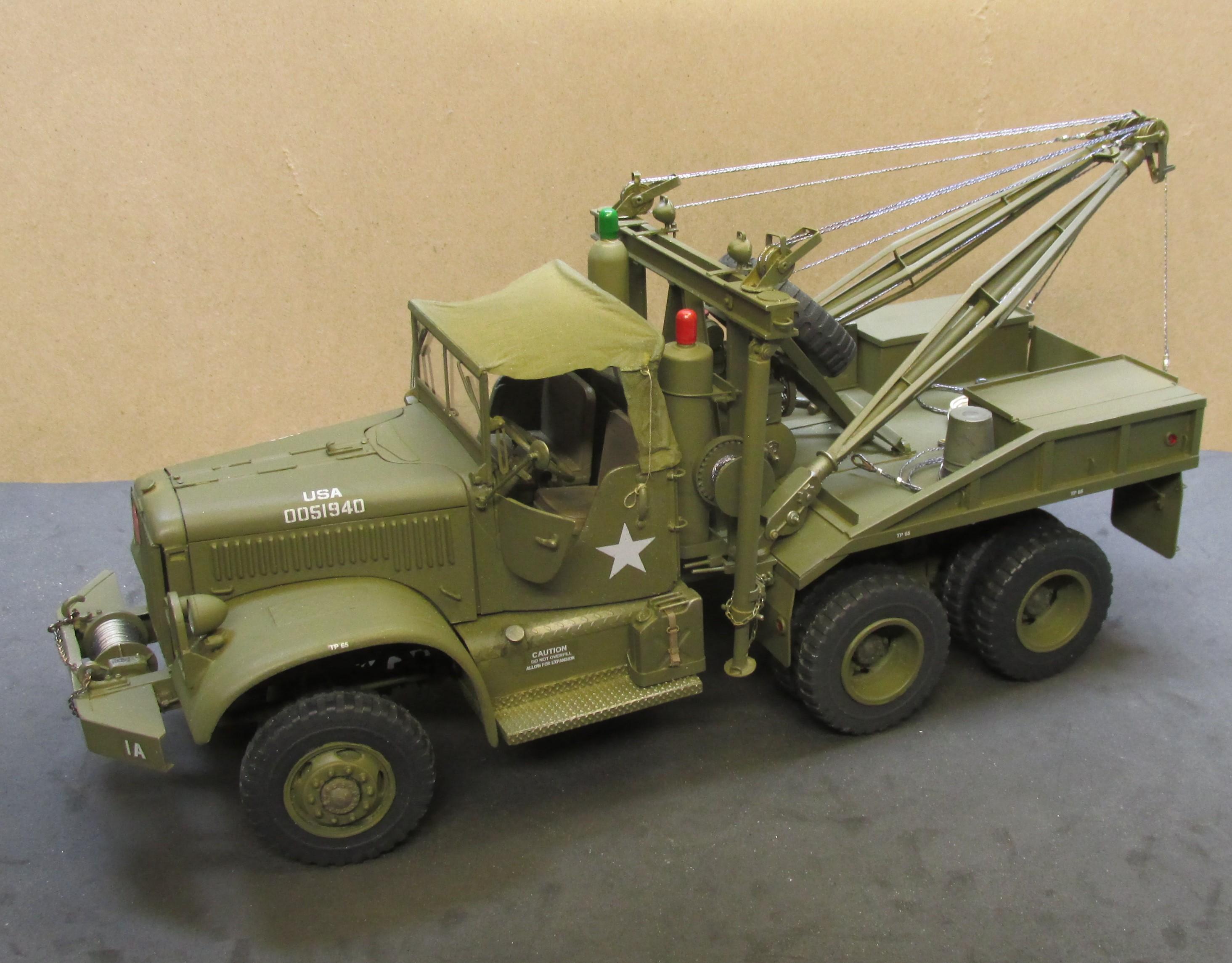

Chariots of Fire Posted January 2, 2023 Author Share Posted January 2, 2023 Still making progress a little at a time. Today marked a milestone as both booms are finished and the cables have been strung. They can move the booms up or down and can raise a load independently. Still plenty of work to do but the big stuff is finally done. 1 Quote Link to comment Share on other sites More sharing options...

Chariots of Fire Posted January 6, 2023 Author Share Posted January 6, 2023 The truck is finished. Now it is just a case of putting on the tools and materials. Two pioneer kits need to be made for the tool box lids. Got some "stuff" for the insides as well. 1 Quote Link to comment Share on other sites More sharing options...
Chariots of Fire Posted January 6, 2023 Author Share Posted January 6, 2023 On 1/4/2023 at 12:14 PM, DRIPTROIT 71 said: WOW!!! I've missed a lot in the past few weeks!! I wish that I had half of your skills!! The boom looks amazing!! The canvas top looks perfect! Every time that I think that this can't get any better, you make it better!! Top notch work all the way!!! Hey, Brian. Thanks for the comments. The top is made of two ply facial tissue painted in place with 50/50 white glue and water. After if dried I was able to lift it off and paint inside and outside with Tamiya OD. The offsetting color is just the way it came out. Sort of sun bleached if you will. It was made with two parts; the back and sides and then the top. Quote Link to comment Share on other sites More sharing options...
