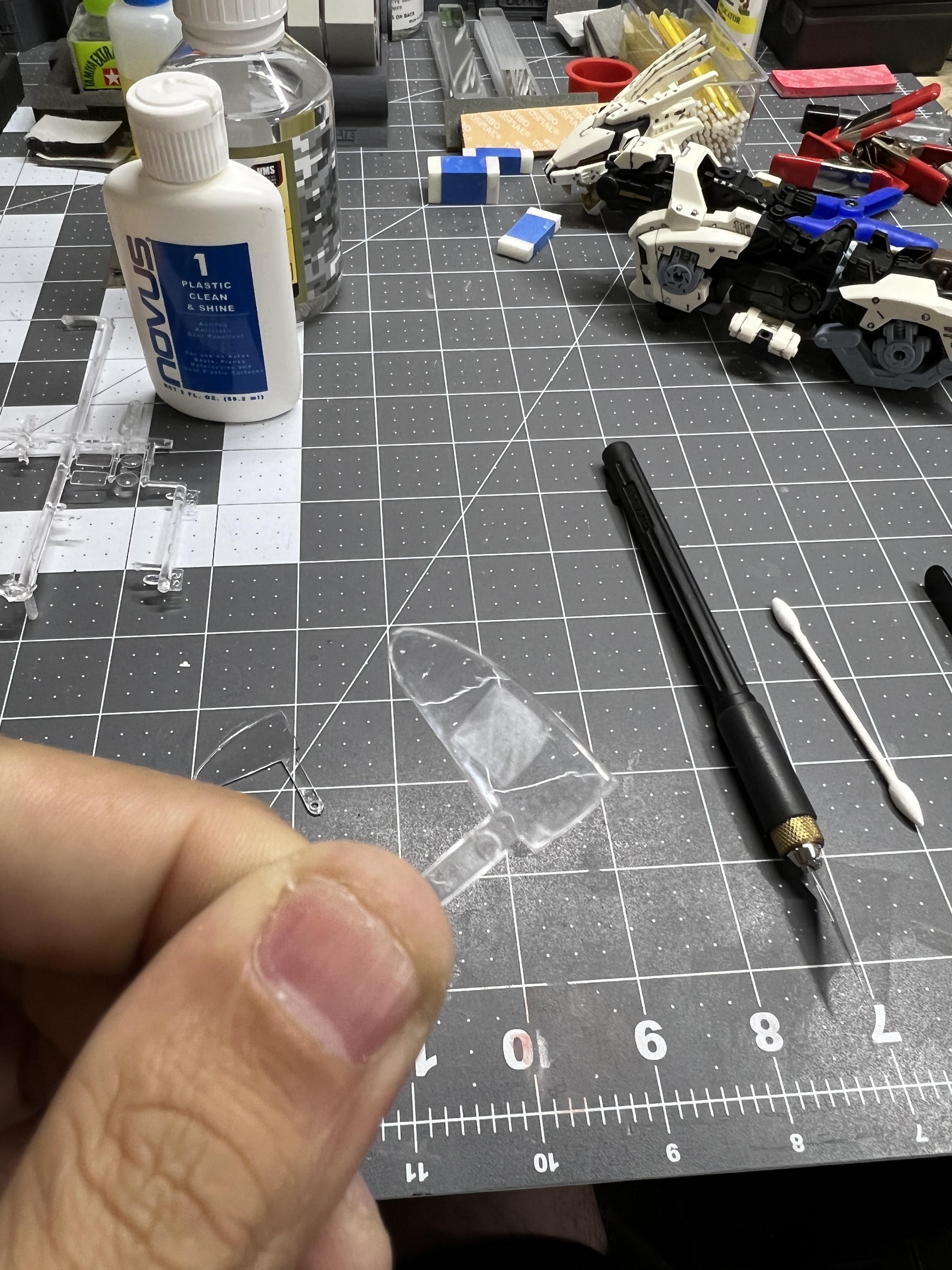

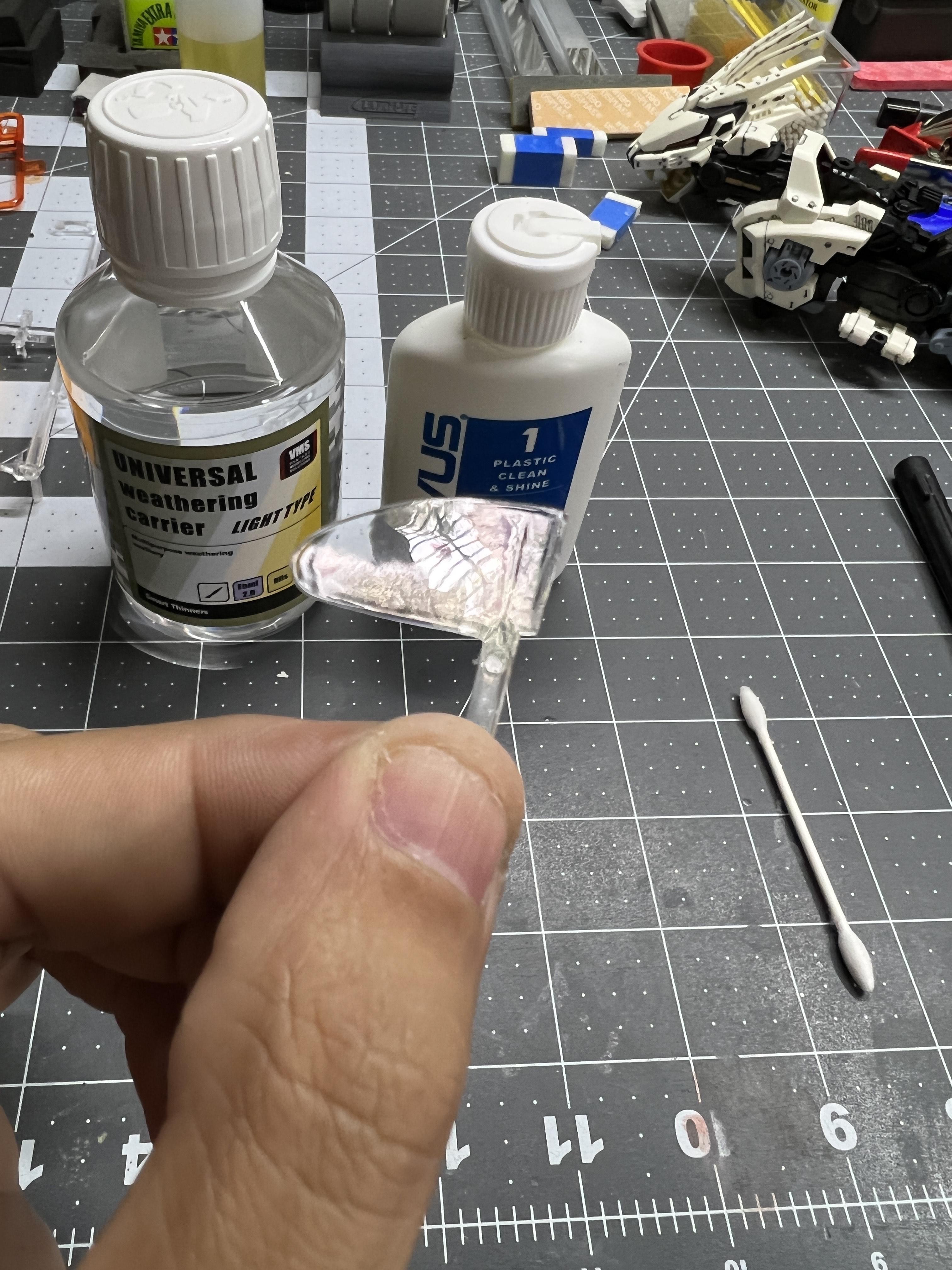

So i did some testing using two products on removing the BMF film from glass and these two products work perfect.  I tried 91% ISP, but it left a haze on the glass.   The piece of glass in the pic was cleaned with novus step 1 only took a few passes with a Q-tip bout like you're sanding.  The UWC product works perfect as well, and can also be used to clean enamel panel line washes up which works beautifully.  Now this is just a tip for folks that might already have these products especially novus.  Also don't mind the zoid he still got some work to be done and cleaning up to be had lol
