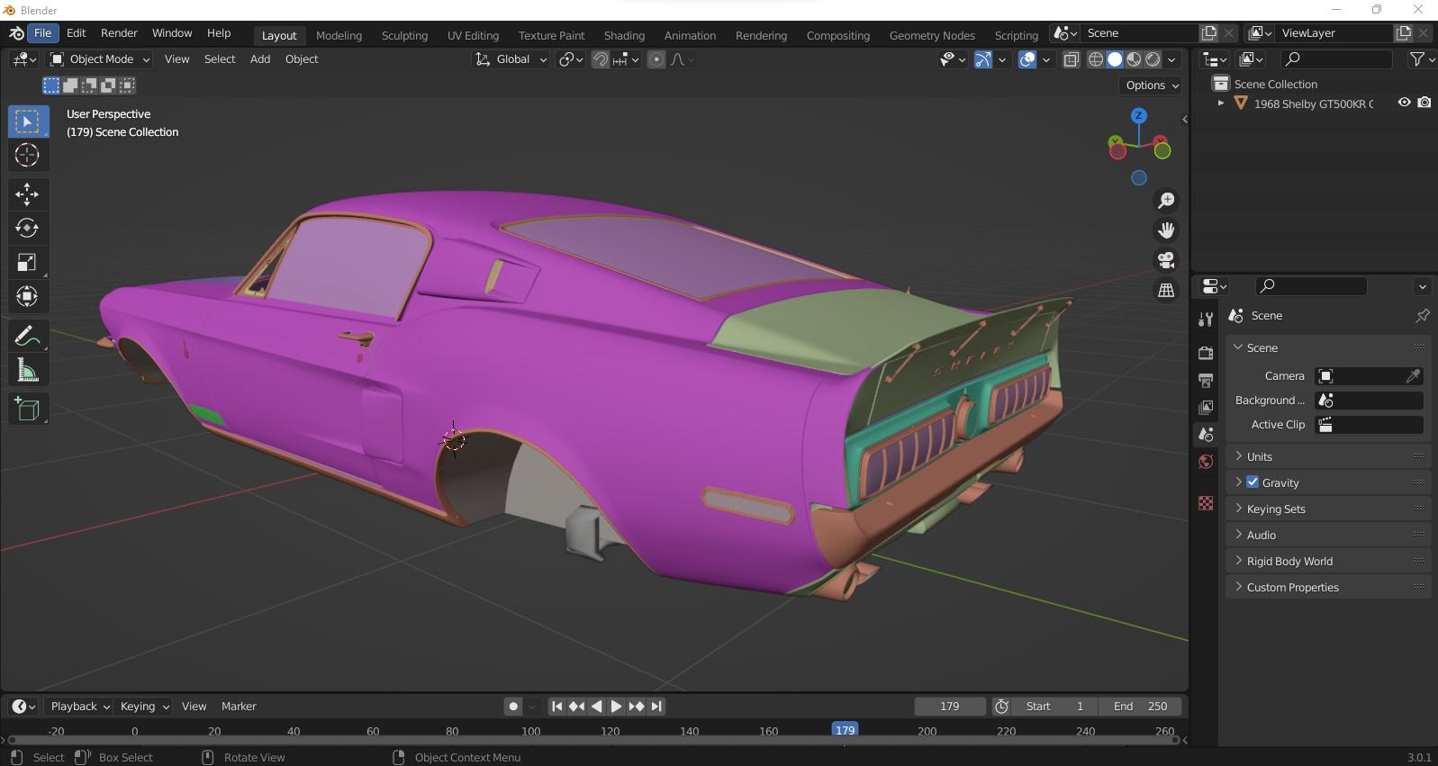

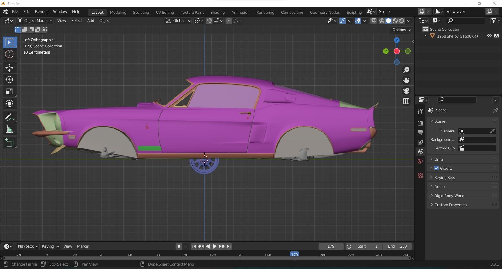

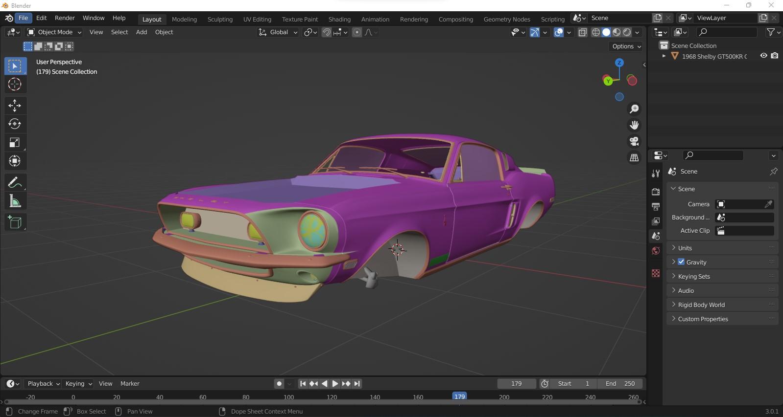

OK! Here are some screenshots of the Shelby........the different colors represent texturing which is used as part of the video game format. This file is so good (one separate file for a COMPLETE ACCURATE interior), it even includes a file for the 10 spoke wheels. Now you have to extract them, but for the exception of the wheels I showed above, NO ONE has done that wheel correctly.
