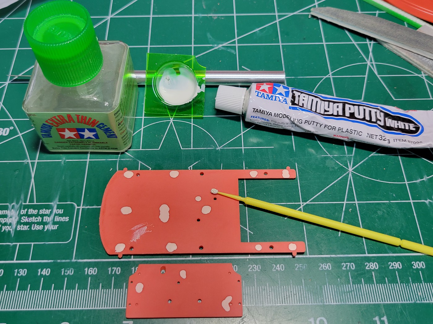

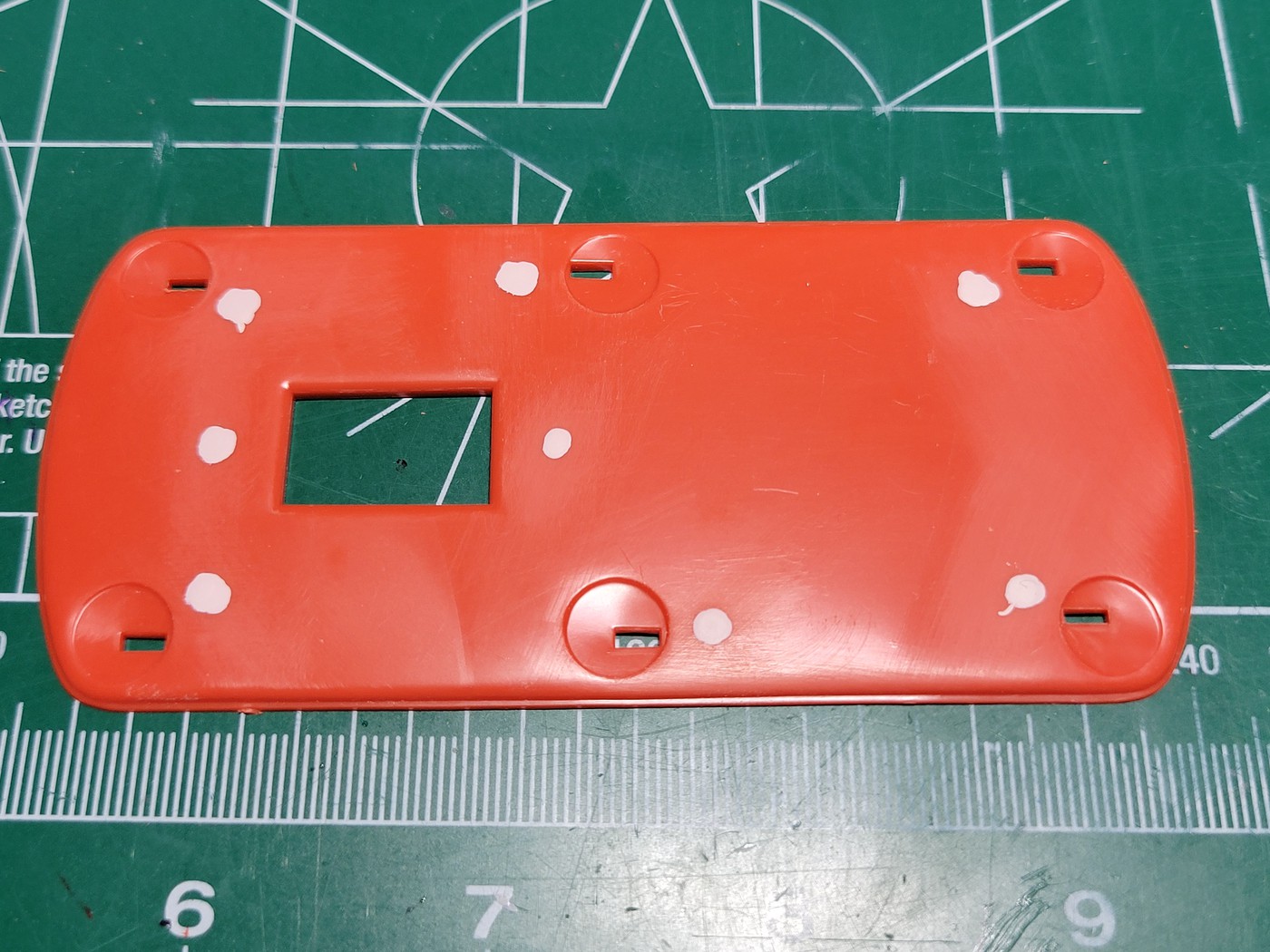

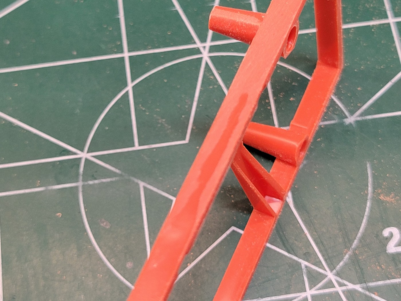

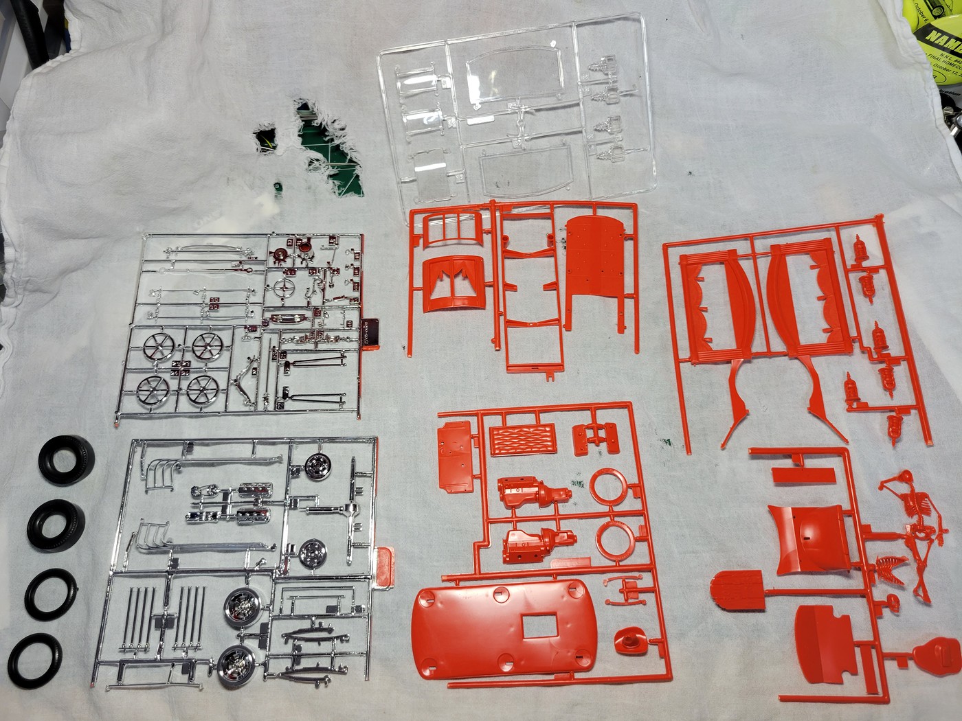

Nacho Z Posted October 24, 2022 Share Posted October 24, 2022 I thought I would share what I am currently working on and what is keeping me away from my 1:12 Tamiya/Ebbro Matra MS11. I am building the Boot Hill Express for a Halloween themed FB group build. I have 1 month to build it, (the month of October), and have underestimated how long it is going to take me. In my defense, I am going a little above and beyond with it but not overboard. As with just about every build thread I do, I am further along than what I am posting. I like to document what I do for two reasons, (mainly). First, it helps me to remember what the heck I did and secondly it may be of some use to one of my fellow modelers. In this thread I will caption each photo as needed. I would love to hear from you guys. Let me know what you think and what you may have done differently. Thanks! Mine is the 1994 issue of the Boot Hill Express. It was molded in a horrible orange styrene. Why?!?! There was a lot of clean up that went into this. Too much to list but let me say that I worked on just about every single part with only a few exceptions. I also made the decision to strip all of the chrome and airbrush it in AK Interactive Xtreme Metal Chrome. More to come shortly. Quote Link to comment Share on other sites More sharing options...

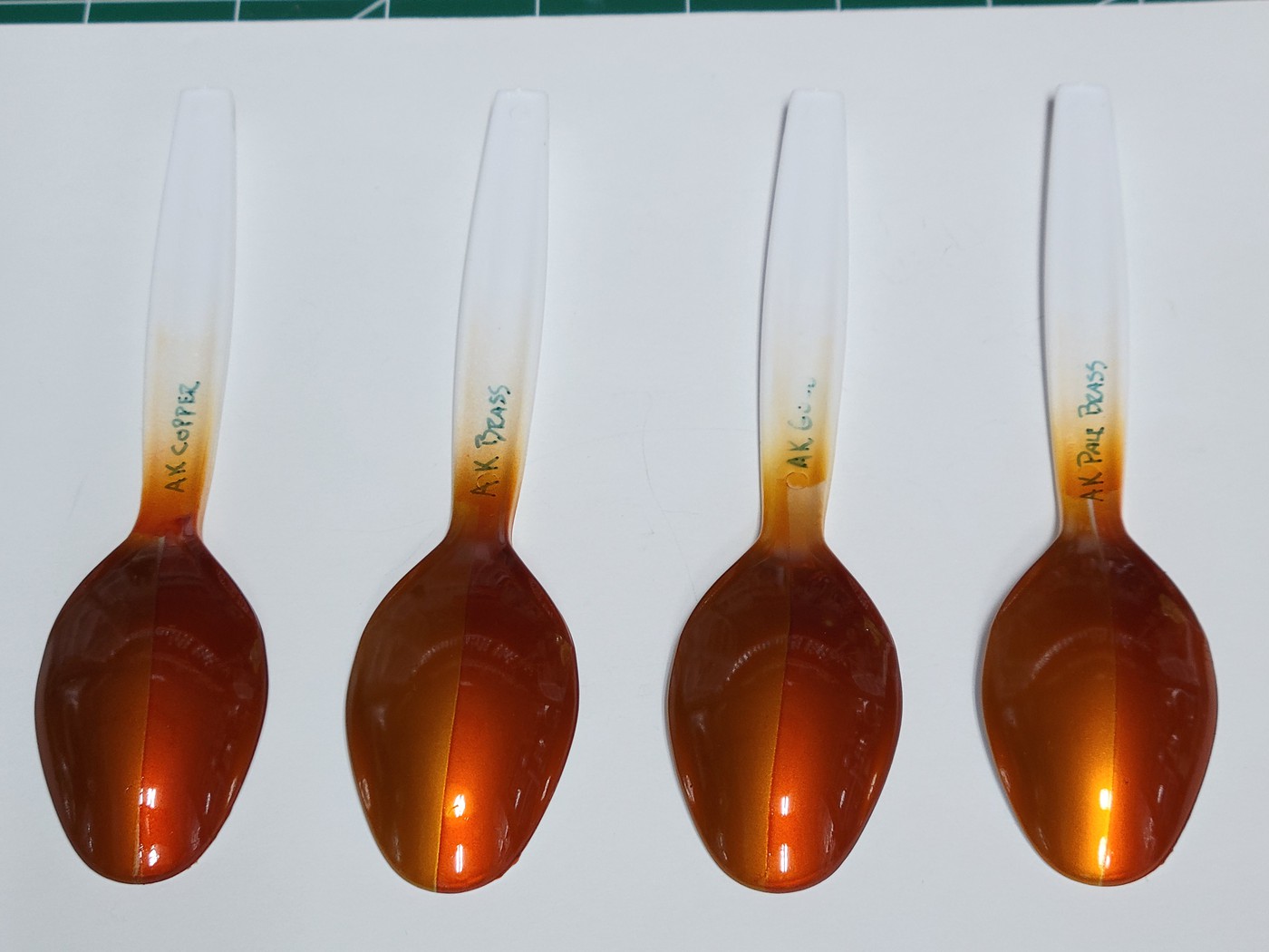

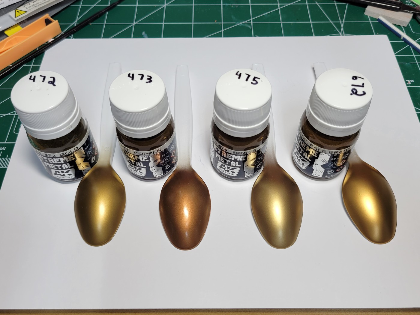

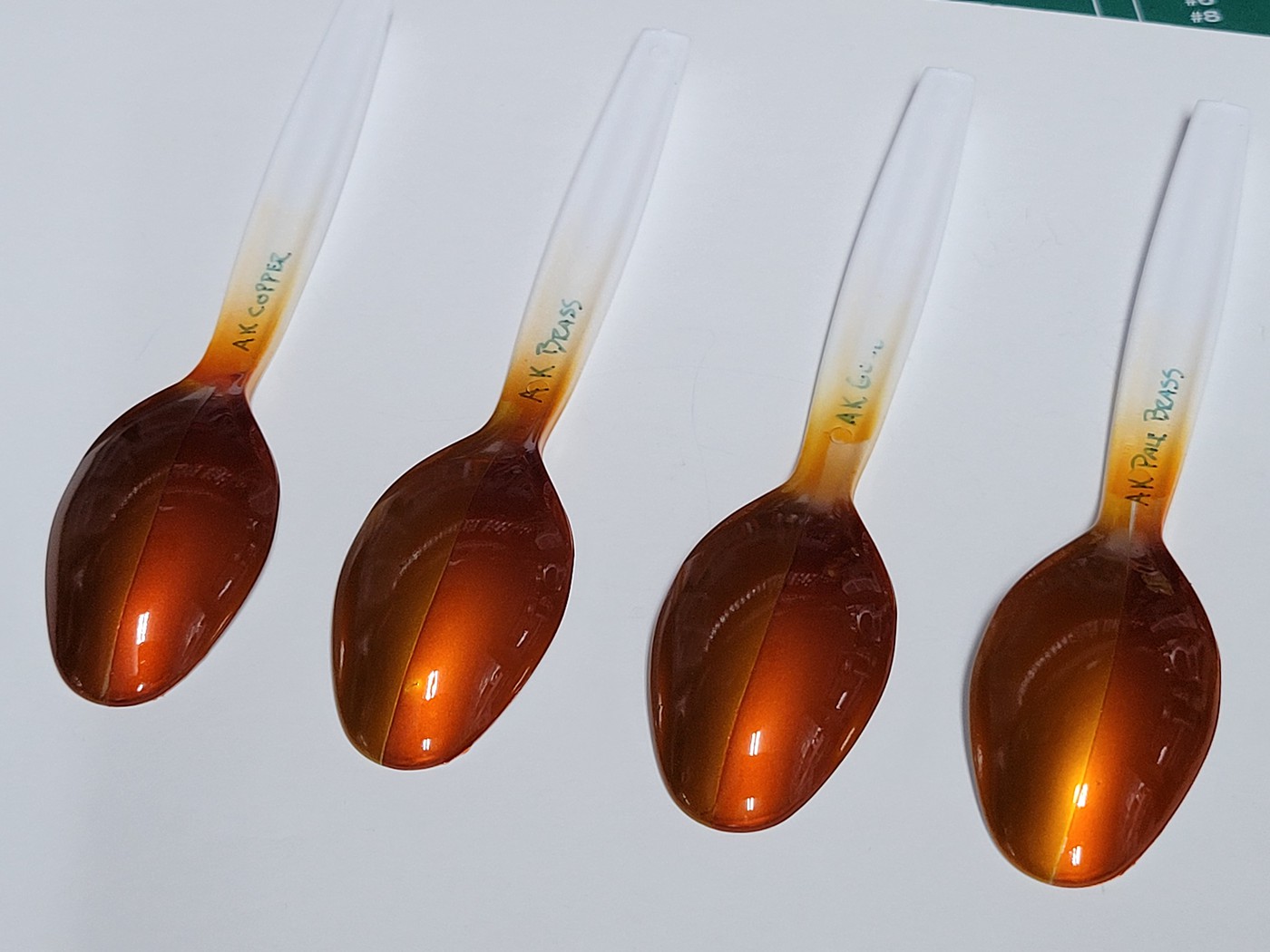

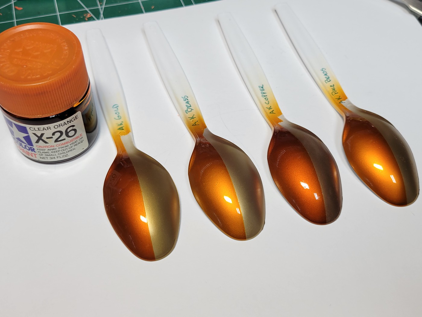

Nacho Z Posted October 24, 2022 Author Share Posted October 24, 2022 Along with all of the parts clean up, I had to decide what color to paint this thing. I have read what others have done and it seems no two people have painted it the same way. I fell in love with the color(s) of one particular Boot Hill Express at the Speedway Motors Museum of American Speed. I believe that the original BHE was painted in a gold color. That is also how it appears on the box art, (although I feel the box art photo has been drastically overexposed or lightened in some way), but I digress. The photos I fell in love with are much more of an orangish color. I do know that lighting and shadows play a big part in photography and that is probably at play here. Anyhow, here are a couple of pics of what I am going to try to replicate. Now, how to get that color. I painted 4 spoons with AK Interactive Xtreme Metal colors, (the spoons are labeled), and then sprayed clear orange over half of each one. I had a hunch that the color would not be deep enough or too orangey. So for the other half of each spoon I added clear red to the clear orange. These would not be the final color but I'll save that for later. Please note that the spoons are not in the same order as the first picture but they are labeled. And now with red added. Lots of parts under primer. I always prime all of my parts. I know that not everybody does and that's cool if it works for them. I just always have and probably always will. Drilled out the 8 exhaust tips. Next update will be the engine. I'm pleased with what I did to dress it up just a bit. Quote Link to comment Share on other sites More sharing options...
ramblerman Posted October 25, 2022 Share Posted October 25, 2022 This is my favorite Show Rod. I had a first issue when I was 12 in 1969 (long gone) and 2 of the orange plastic kits now (unbuilt). I have never seen it in person but hope to one day. I like the richness of the color on the Pale Brass spoon. Quote Link to comment Share on other sites More sharing options...

Nacho Z Posted October 25, 2022 Author Share Posted October 25, 2022 23 hours ago, Rocking Rodney Rat said: I have purchased several of these kits over the years but I have never built one. I'm looking forward to seeing yours come together. Carry on.... -RRR Thanks, RRR, I'm hoping that I will do this kit justice. 22 hours ago, Engine 51 said: I have heard that this is a very challenging kit. So far, Joe, I have ran into a lot of flash, mold seams and ejector pin marks. The directions are really just an exploded view and you have to figure out where some things attach. I guess what I am saying is a typical '60s kit...lol. Quote Link to comment Share on other sites More sharing options...
Nacho Z Posted October 25, 2022 Author Share Posted October 25, 2022 20 hours ago, ramblerman said: This is my favorite Show Rod. I had a first issue when I was 12 in 1969 (long gone) and 2 of the orange plastic kits now (unbuilt). I have never seen it in person but hope to one day. I like the richness of the color on the Pale Brass spoon. Jim, it is one of my favorites also. I forgot to mention in my introductory post that I put a poll up on my FB page and asked my friends which kit I should build for the Halloween themed build. There were four to choose from. This was the overwhelming favorite. I really liked the Pale Brass too. 18 hours ago, ea0863 said: Can't wait to see it done. It looks great! Which color are you going with? I was kind of thinking the brass? Thanks, Emre, I appreciate it. I'll show the color I went with in a post coming up soon. It was really a tough choice. 18 hours ago, 250 Testa Rossa said: Can't wait to see this one as well! I have the same kit and plan to use some aftermarket parts on it. Thanks, Maxx! I think if you have the time, skills and the right items you can make a killer model out of this. I am very limited by time, (probably skills too...lol). I am making a few modifications to mine but I have to keep myself in check. I'm committed to making the deadline. Quote Link to comment Share on other sites More sharing options...
