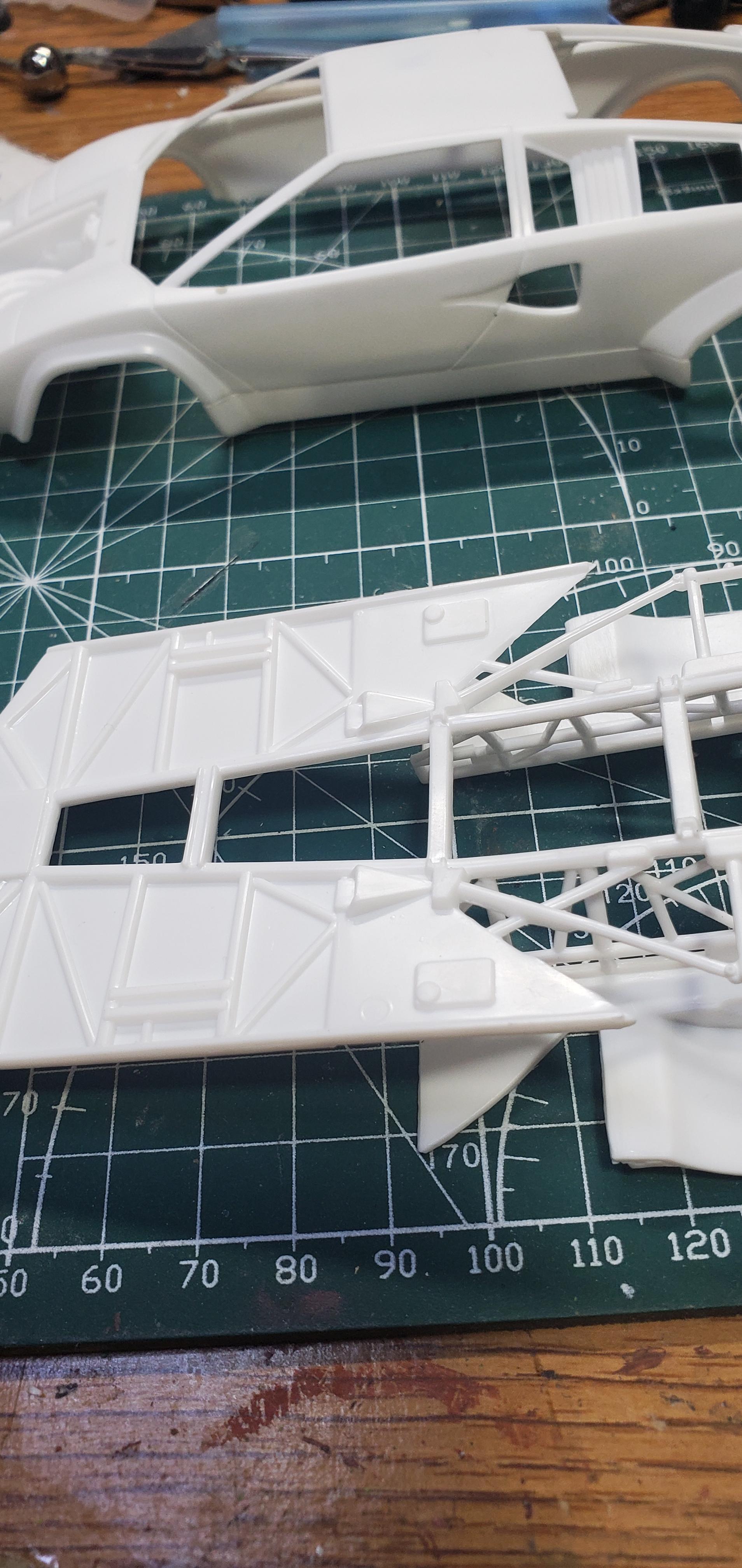

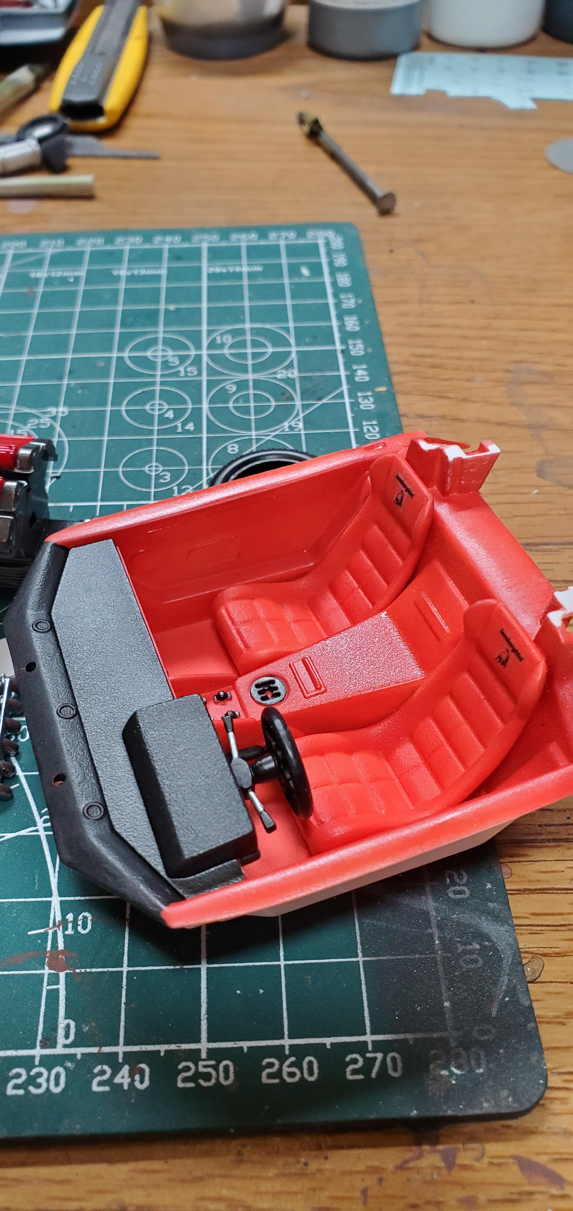

LL3 Model Worx Posted November 15, 2022 Posted November 15, 2022 Started this a few days ago... got the kit in a trade a few years ago. Figured I'd try and do it basically box stock... it will be a warm up for another Countach coming up soon. I started by sawing the lower body panels off the chassis pan and attached them to the body, it made no sense why they were made this way. My chassis pan was warped, so had to heat it and straighten it out. Its basically flat now. I scabbed a piece of styrene in the backside so I could keep the panel gap intact. I've been working on the engine and interior today, I've got most of it in base color... I grabbed Steel Alcad instead of aluminum and didn't realize before I started spraying the engine... but I kinda like the darker appearance, so left it. I've been adjusting the height of the interior tub because the top bulkhead where the rear glass goes stops the tub from sitting flush to the roof. I'll post more as I go along.

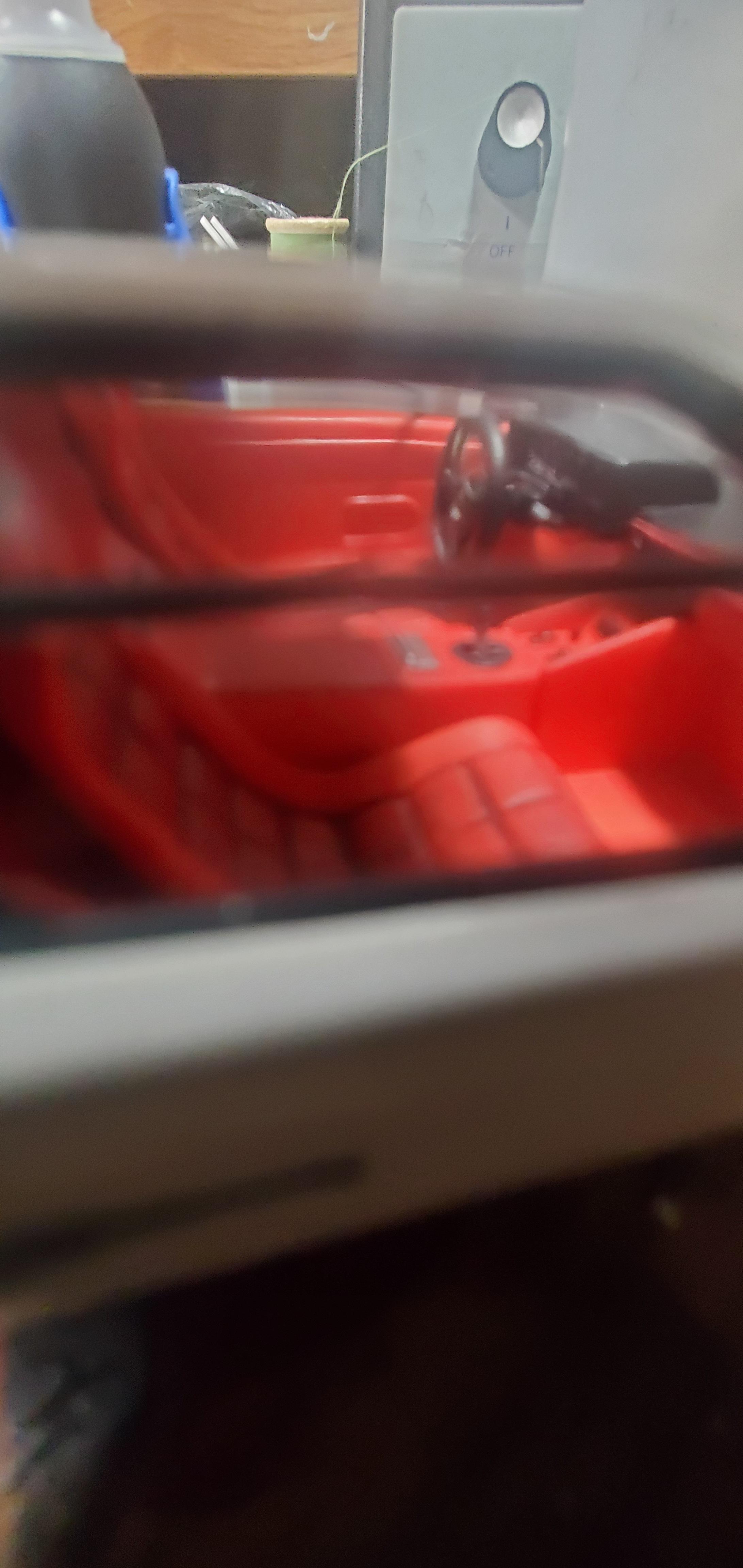

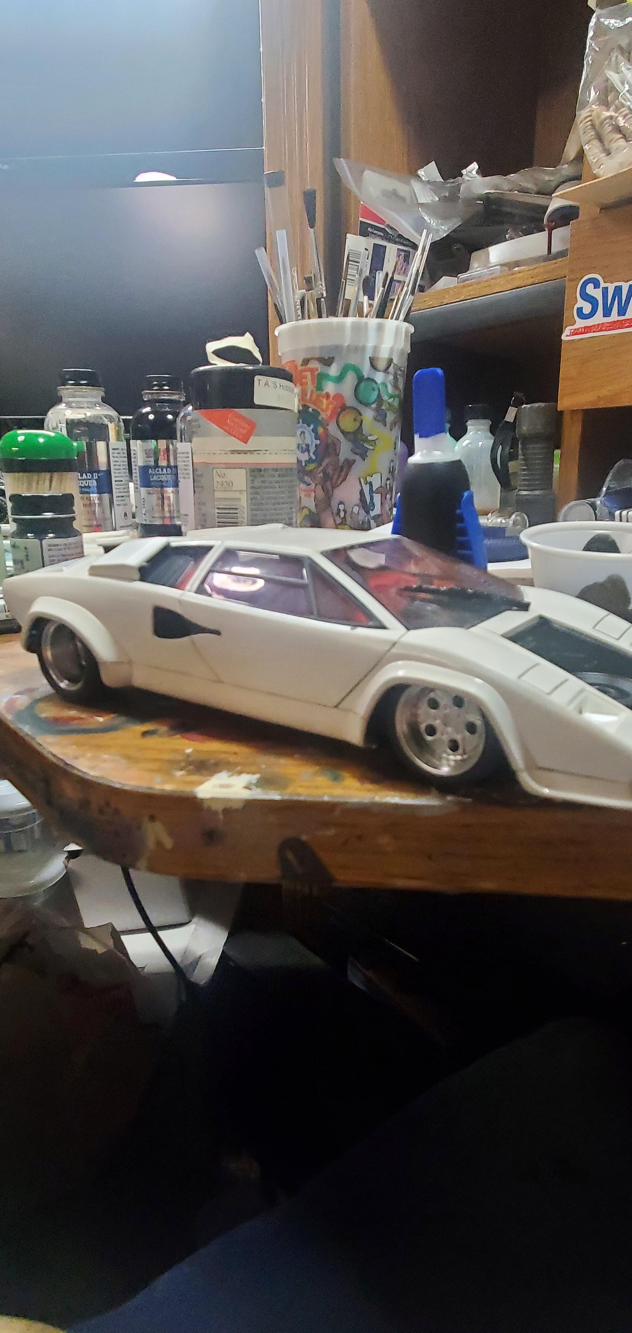

LL3 Model Worx Posted December 8, 2022 Author Posted December 8, 2022 Probably the last update on this one... I've not set my photo booth up yet, so pics are still lame... I've got a few things left to do.. like mounting the wing, and mirrors and a few other odds and ends. It's basically finished though. Gotta put it away for another project. Thanks for looking. I doubt I'll post it in the complete section...
Oldcarfan27 Posted December 8, 2022 Posted December 8, 2022 On 11/15/2022 at 12:50 PM, LL3 Model Worx said: I started by sawing the lower body panels off the chassis pan and attached them to the body, it made no sense why they were made this way. Maybe the roll under was too deep for the tooling design to release from the mold that way? Just a guess.
LL3 Model Worx Posted December 8, 2022 Author Posted December 8, 2022 4 minutes ago, Oldcarfan27 said: Maybe the roll under was too deep for the tooling design to release from the mold that way? Just a guess. Hadn't really thought about that, but it sounds reasonable considering it is pretty deep.
