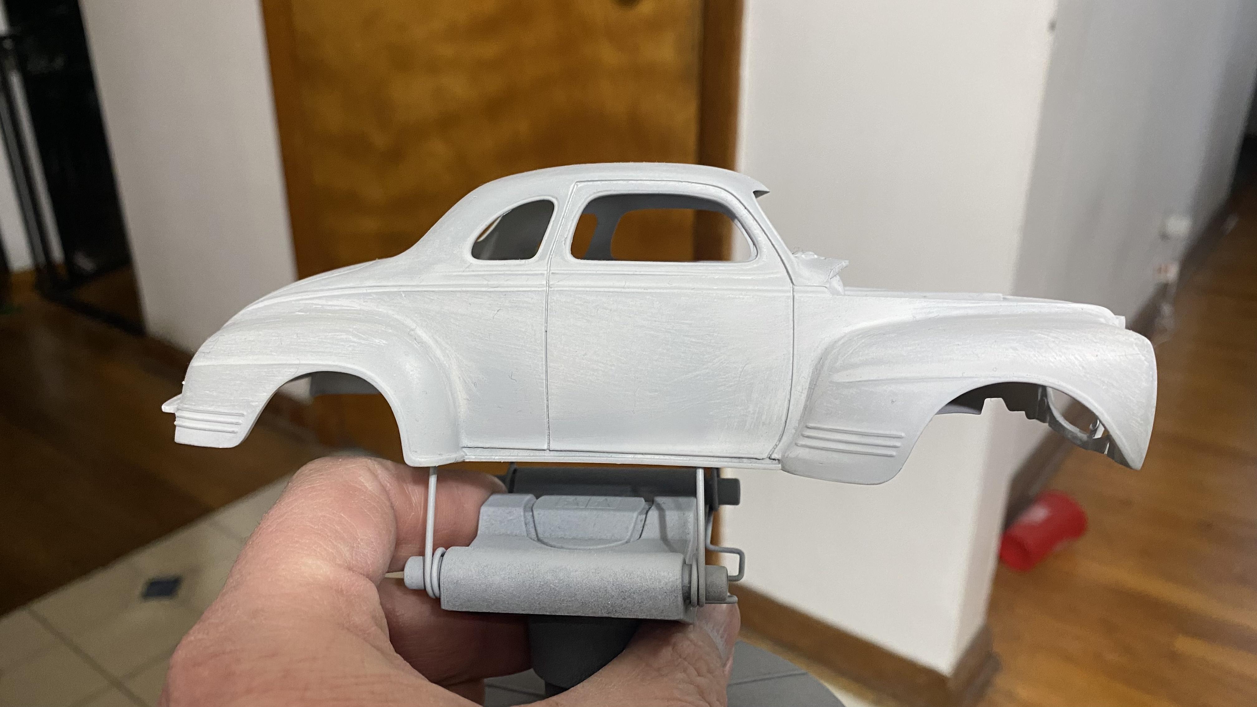

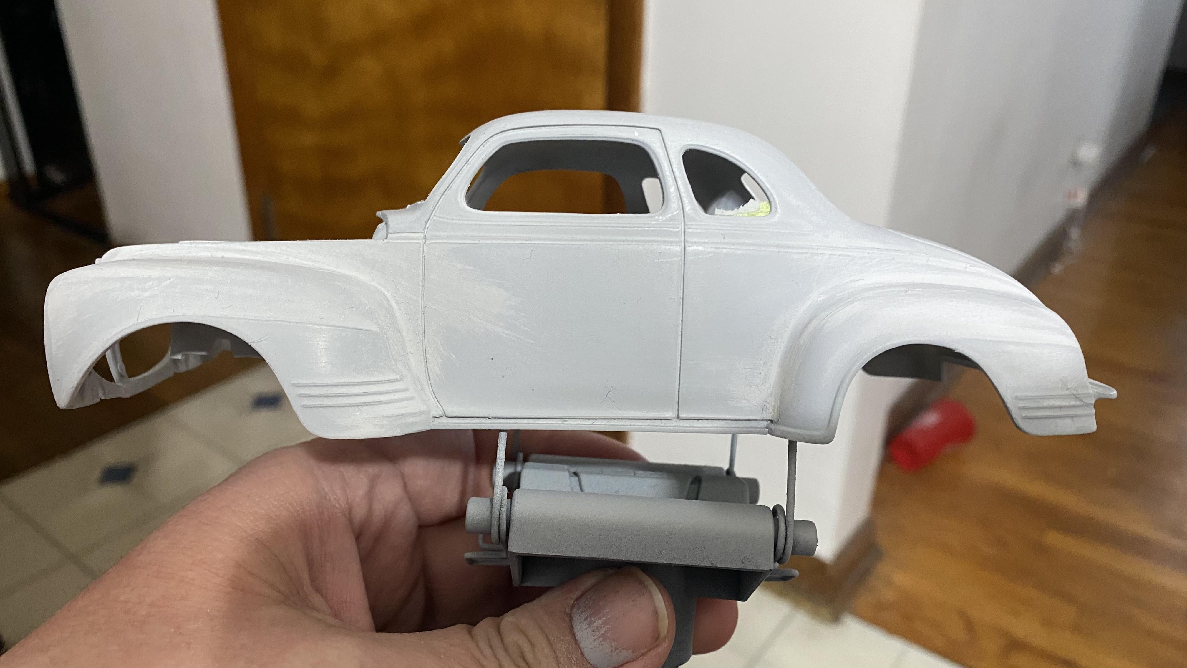

Guess I never started a thread for this one, been working in it off and on for the better part of the last year, just an AMT ‘41 Plymouth with some custom work and Pegasus wheels.  It was being built for my club’s Christmas party and was maybe 75% done by spring, but found other new shiny things to distract myself with and now need to do the last 25% by Saturday ??

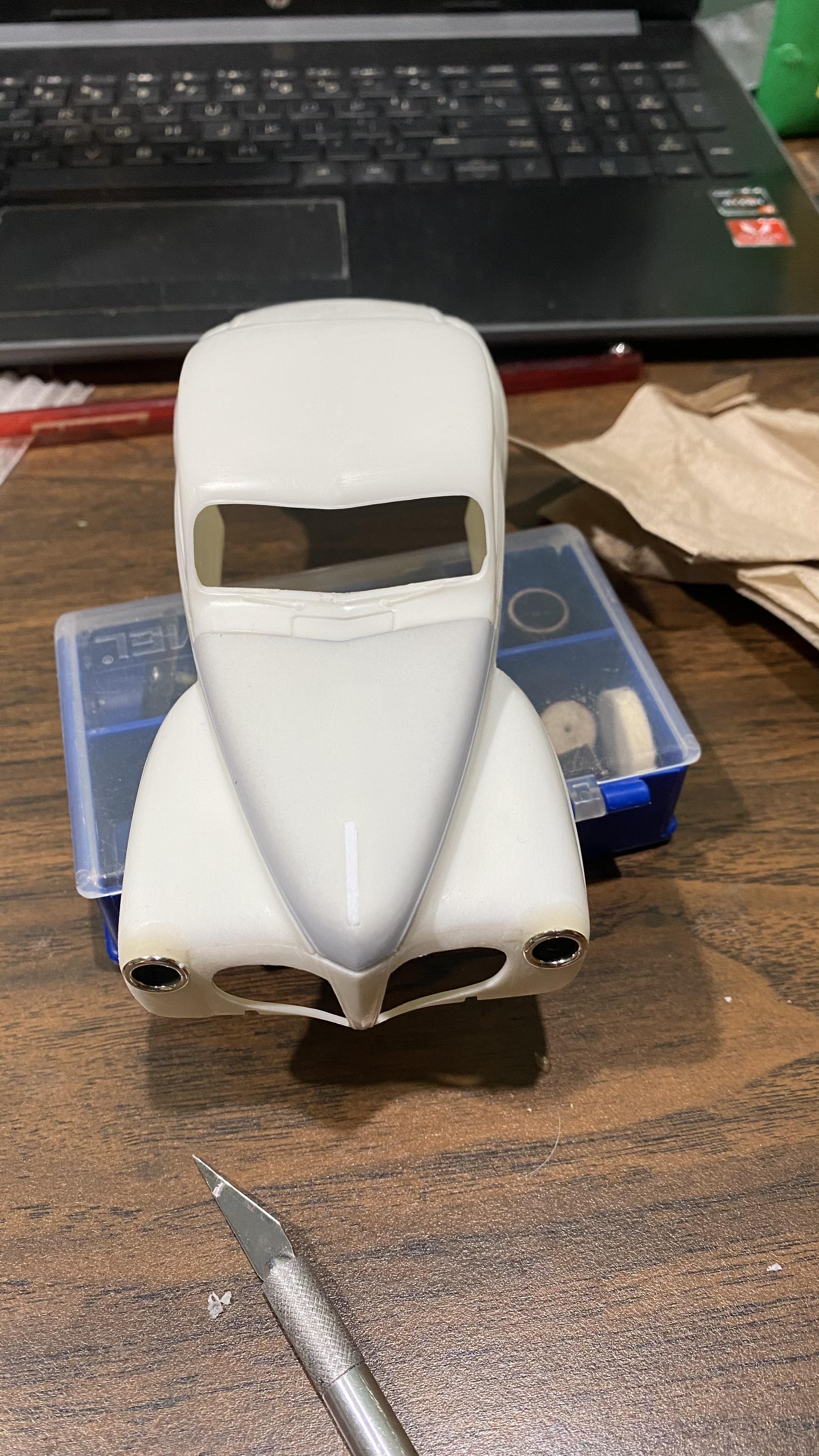

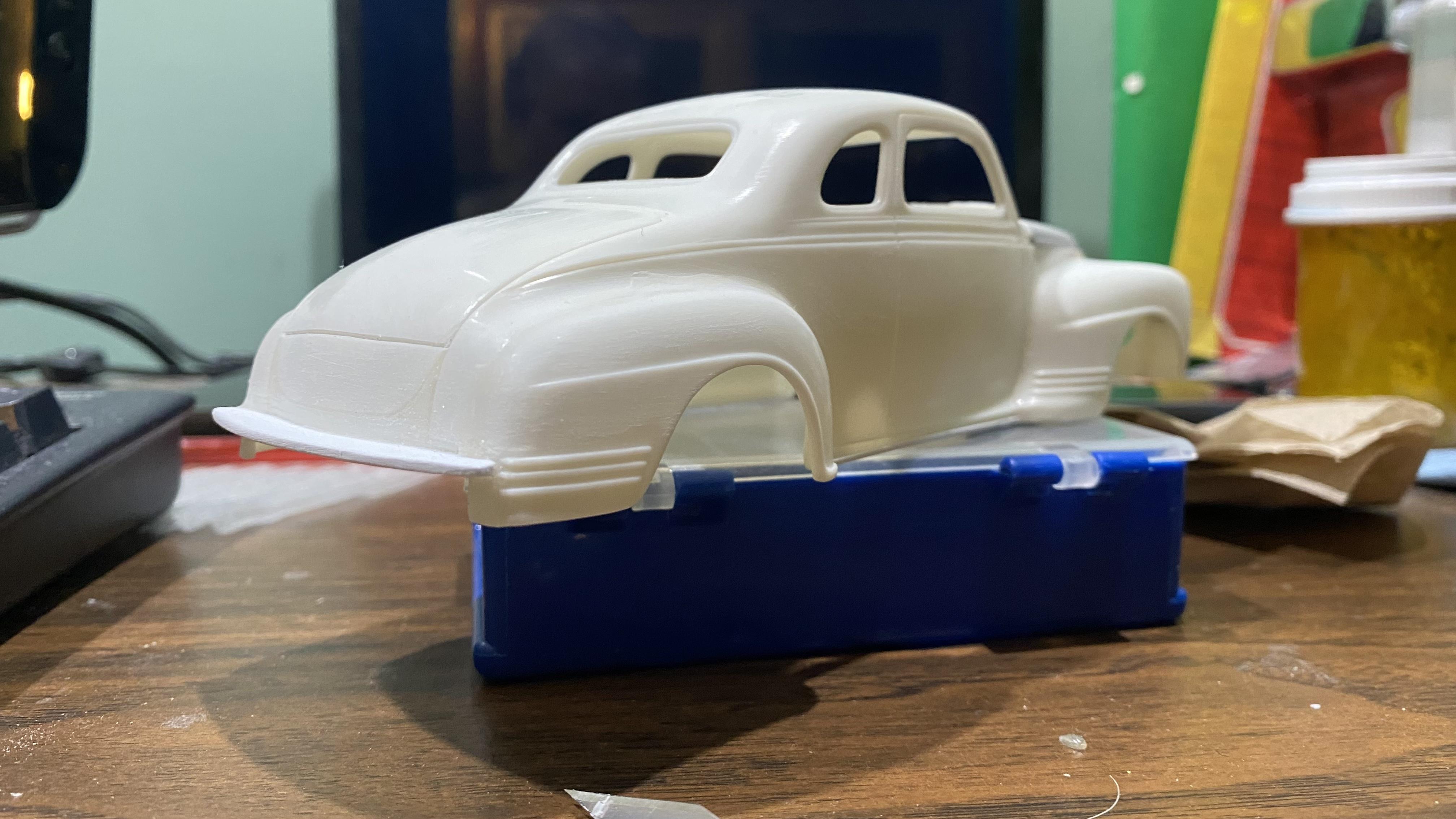

here’s where I started, had been partially shaved by the time I took the first pic.F6B8685C-F183-4E14-900A-3E6B0E66C23D.jpeg.cf694de7e727f8e3f362862b02fb3743.jpeg

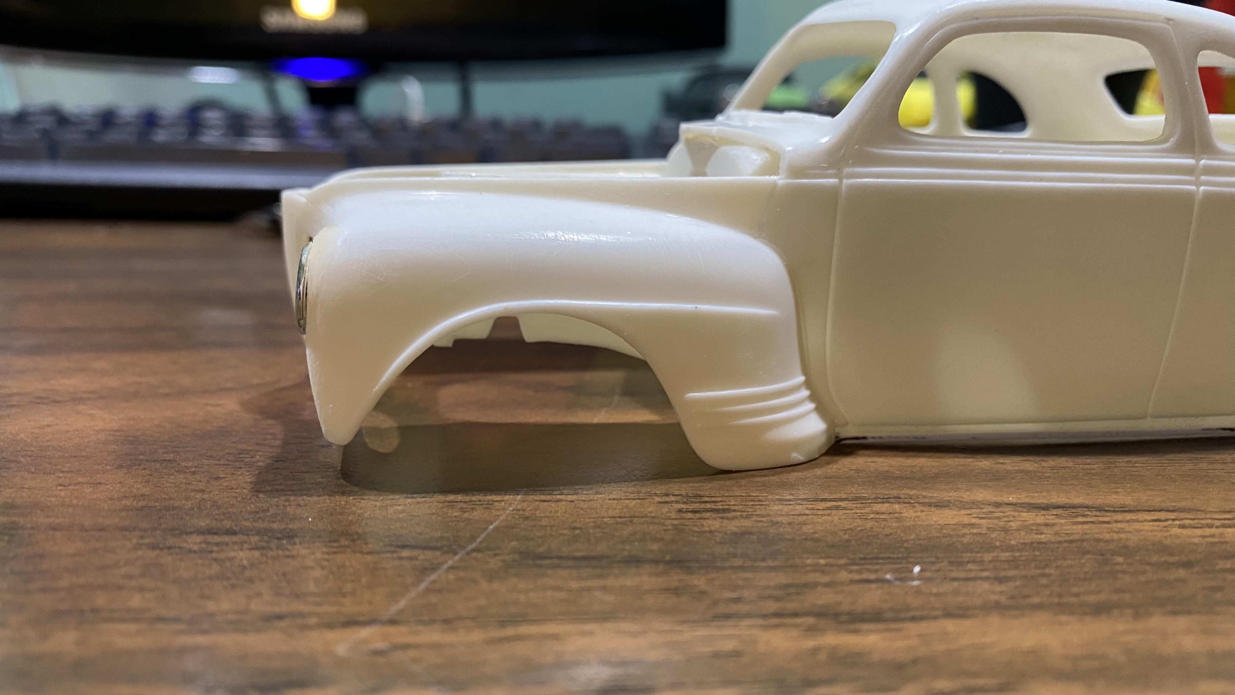

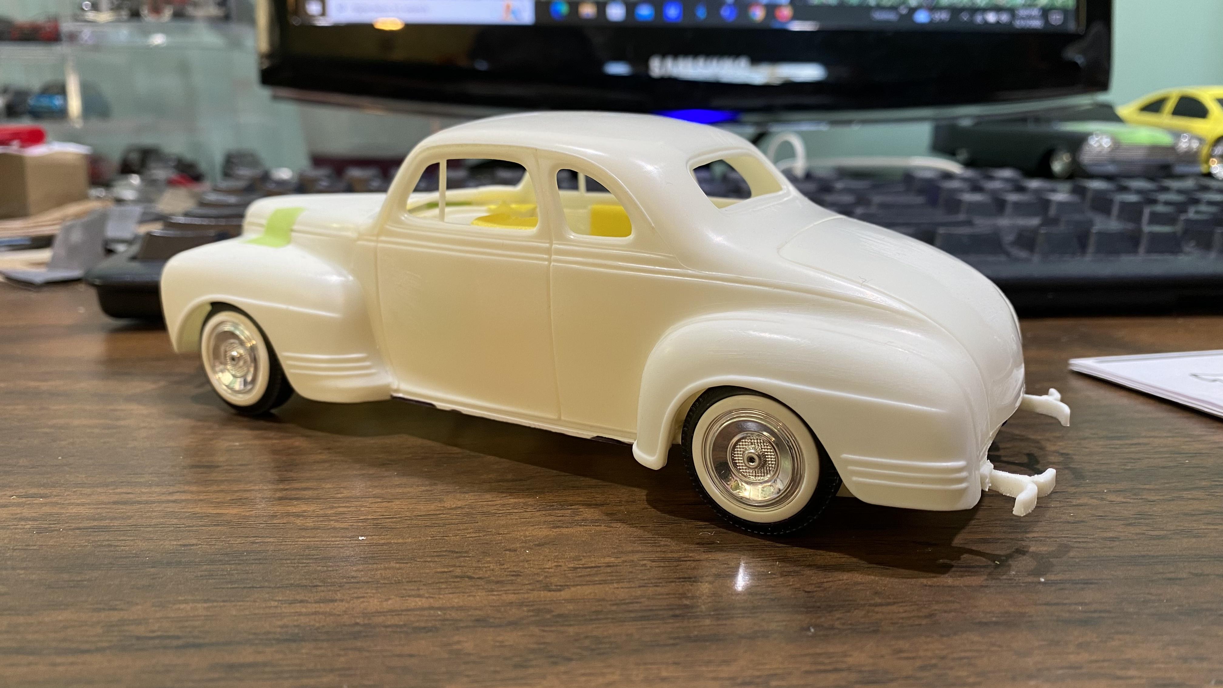

Then decided to lose the running boards and add the Pegasus Crossbars with wide whites.

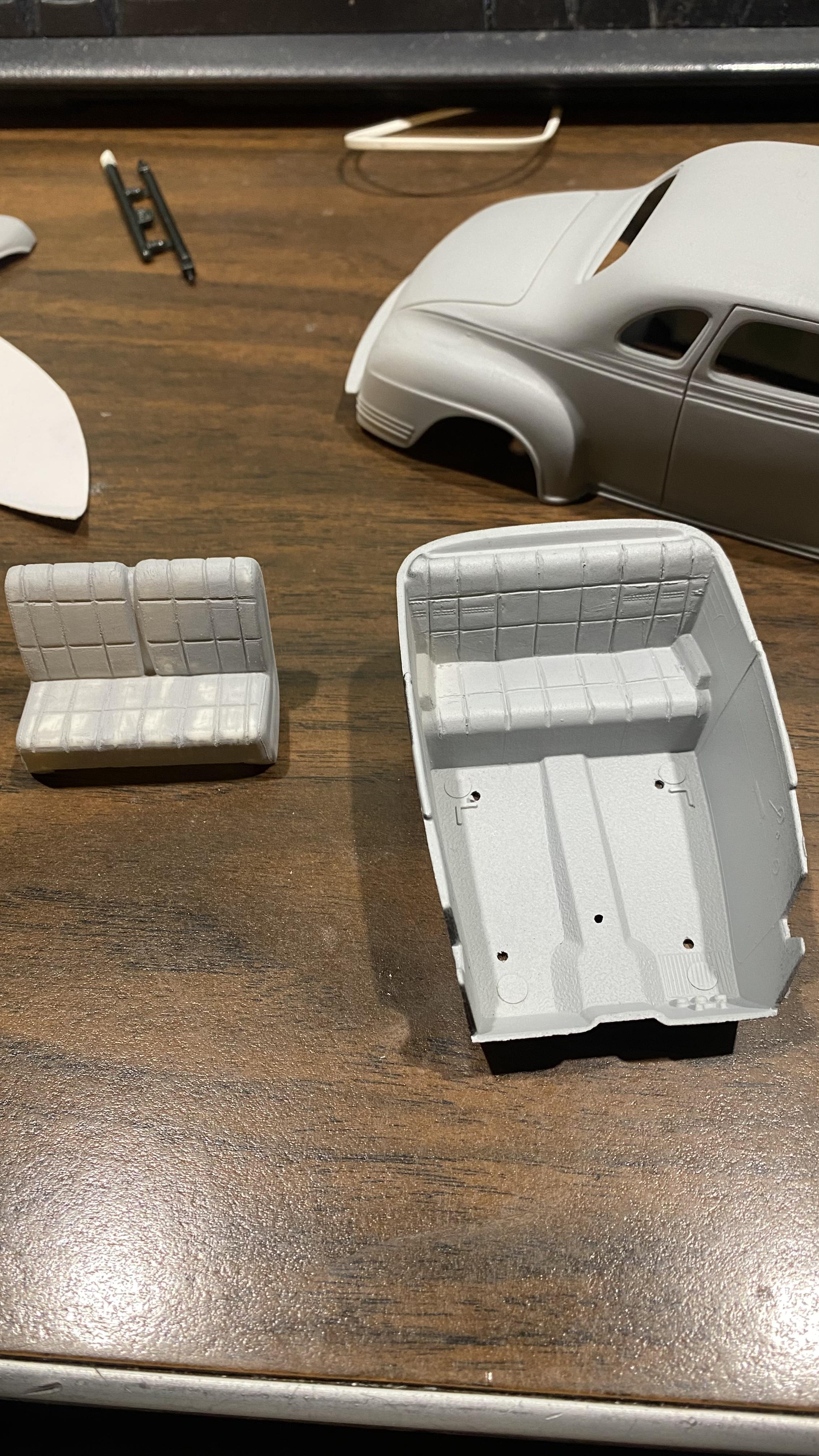

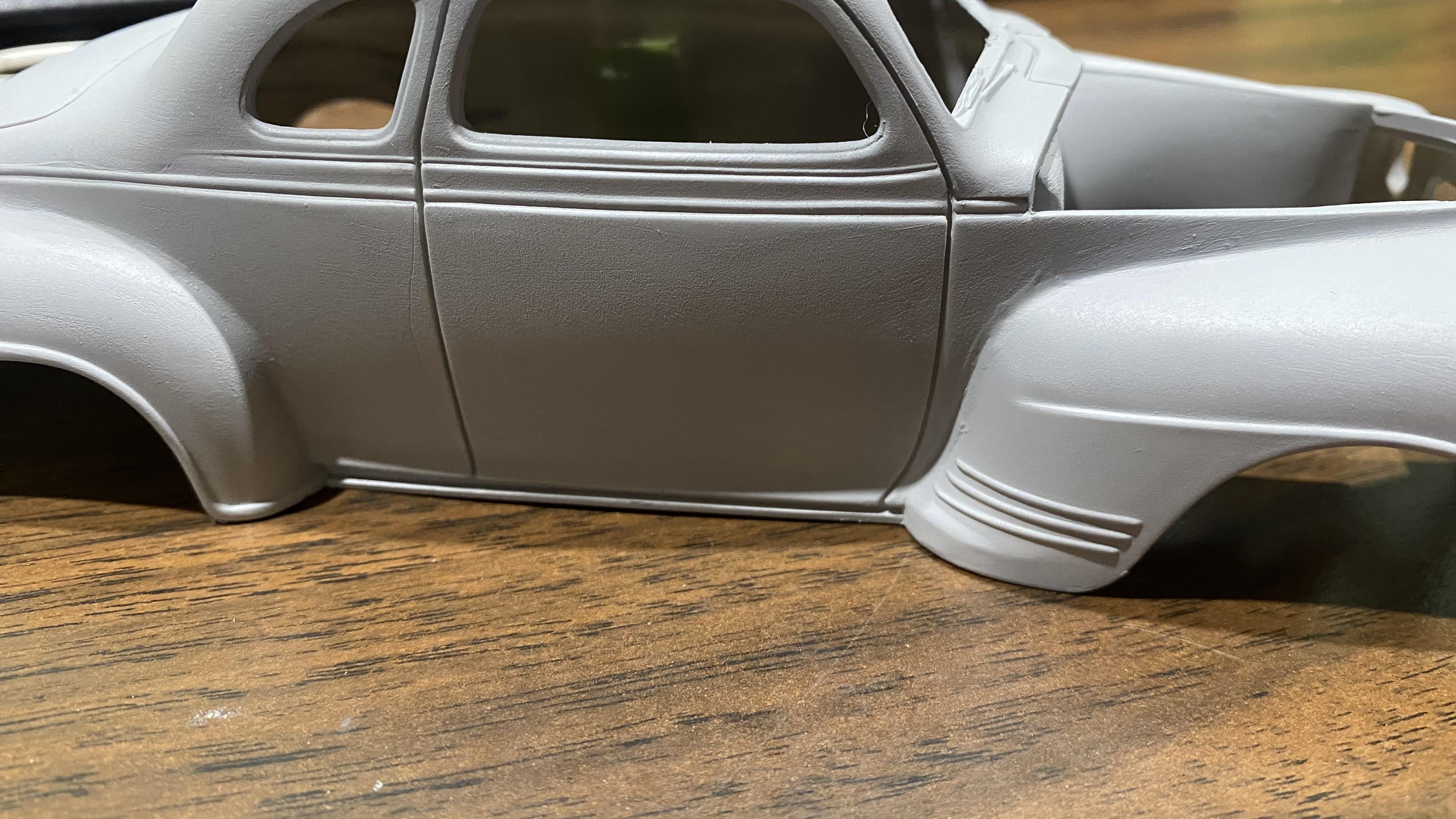

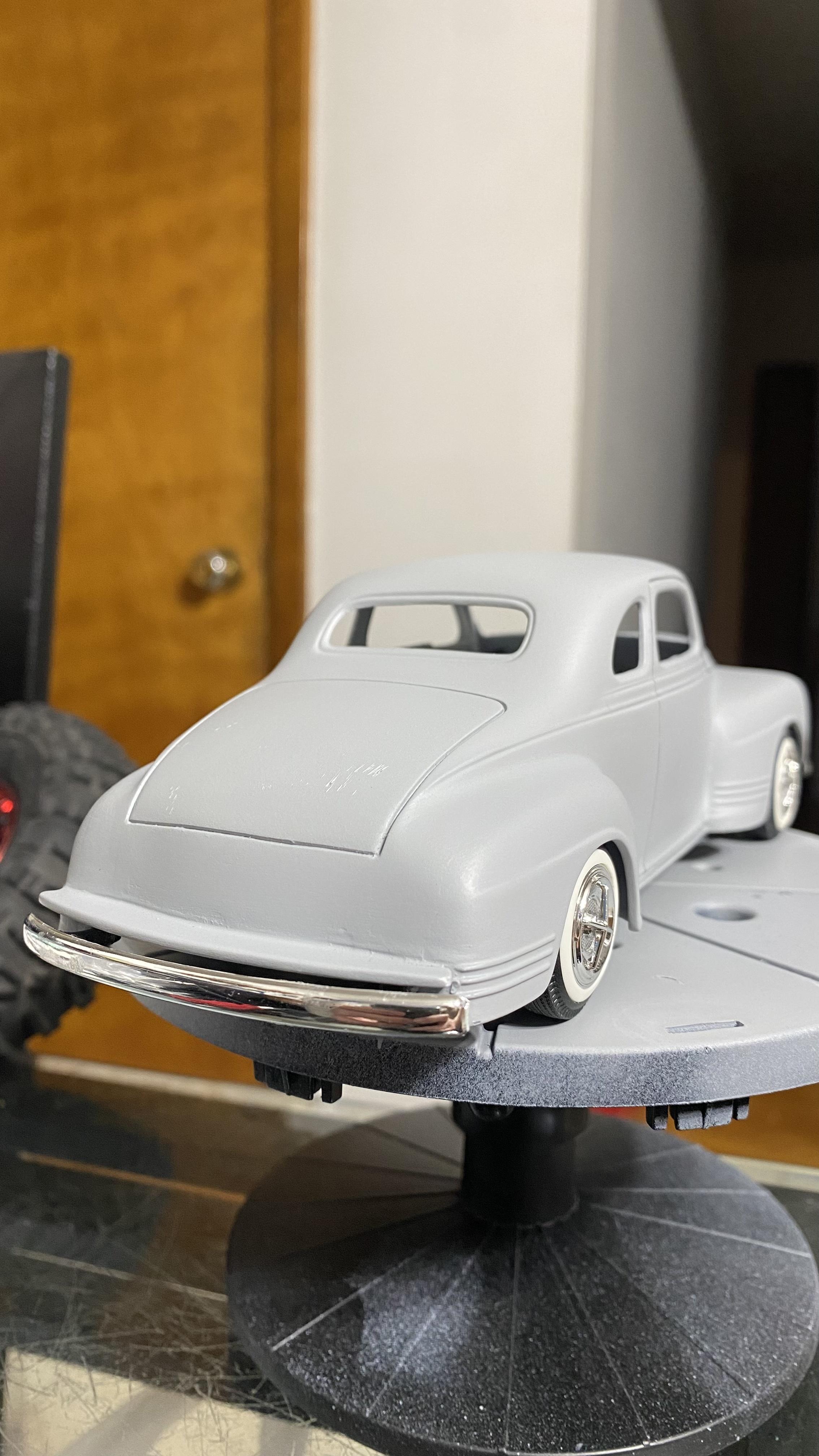

here’s where I stopped, did a very slight body drop by sanding the bottom of the interior tub flat, fabricated my own drop spindles and lowered the rear by grinding away at its mounting points, then added some square styrene rod along where the running boards would but up against the body under the doors
I had also hand carved pleated squares into the kit seats too!
and this is where it stood after pulling it out of the box, plus a change of venue!

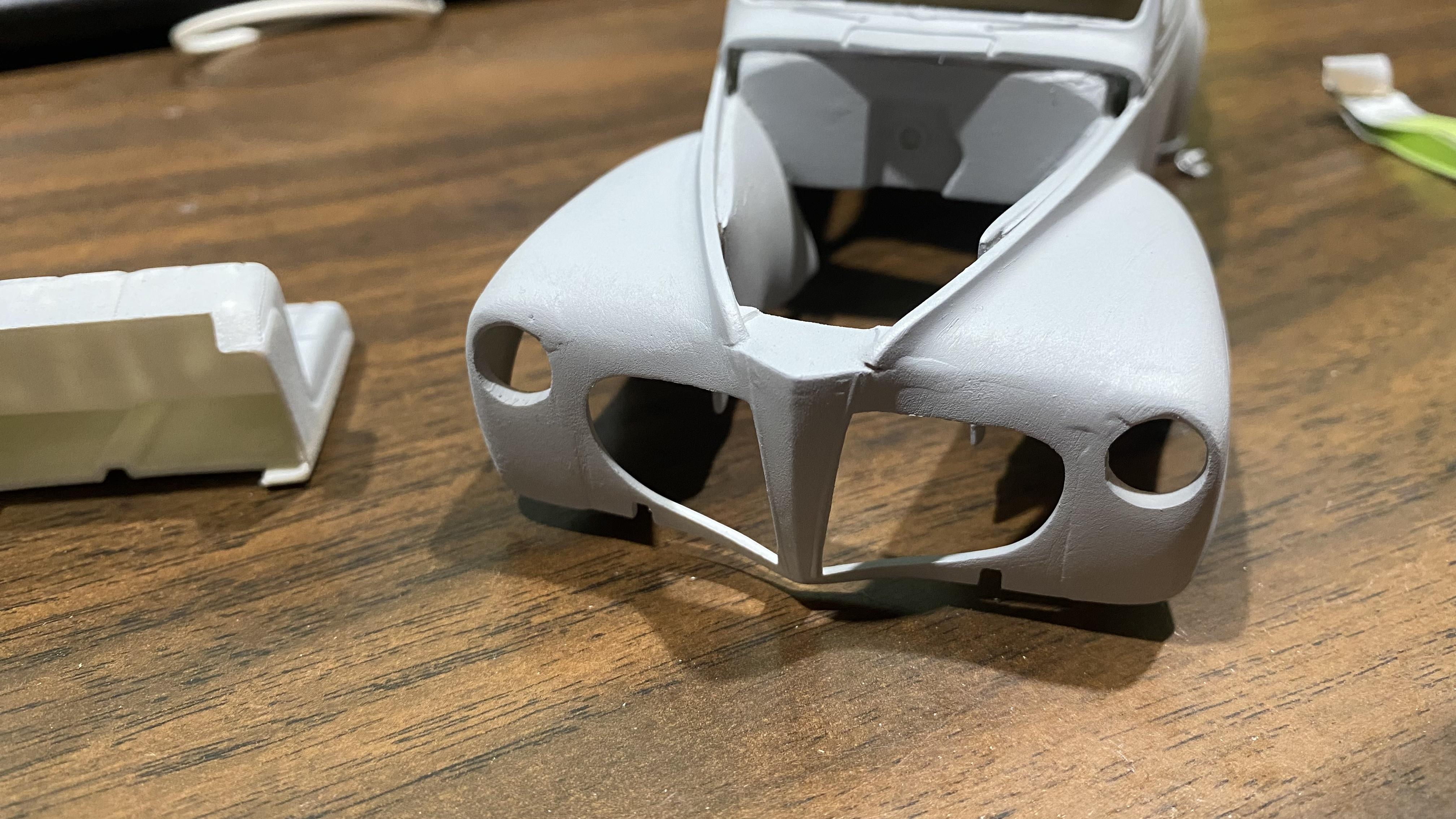

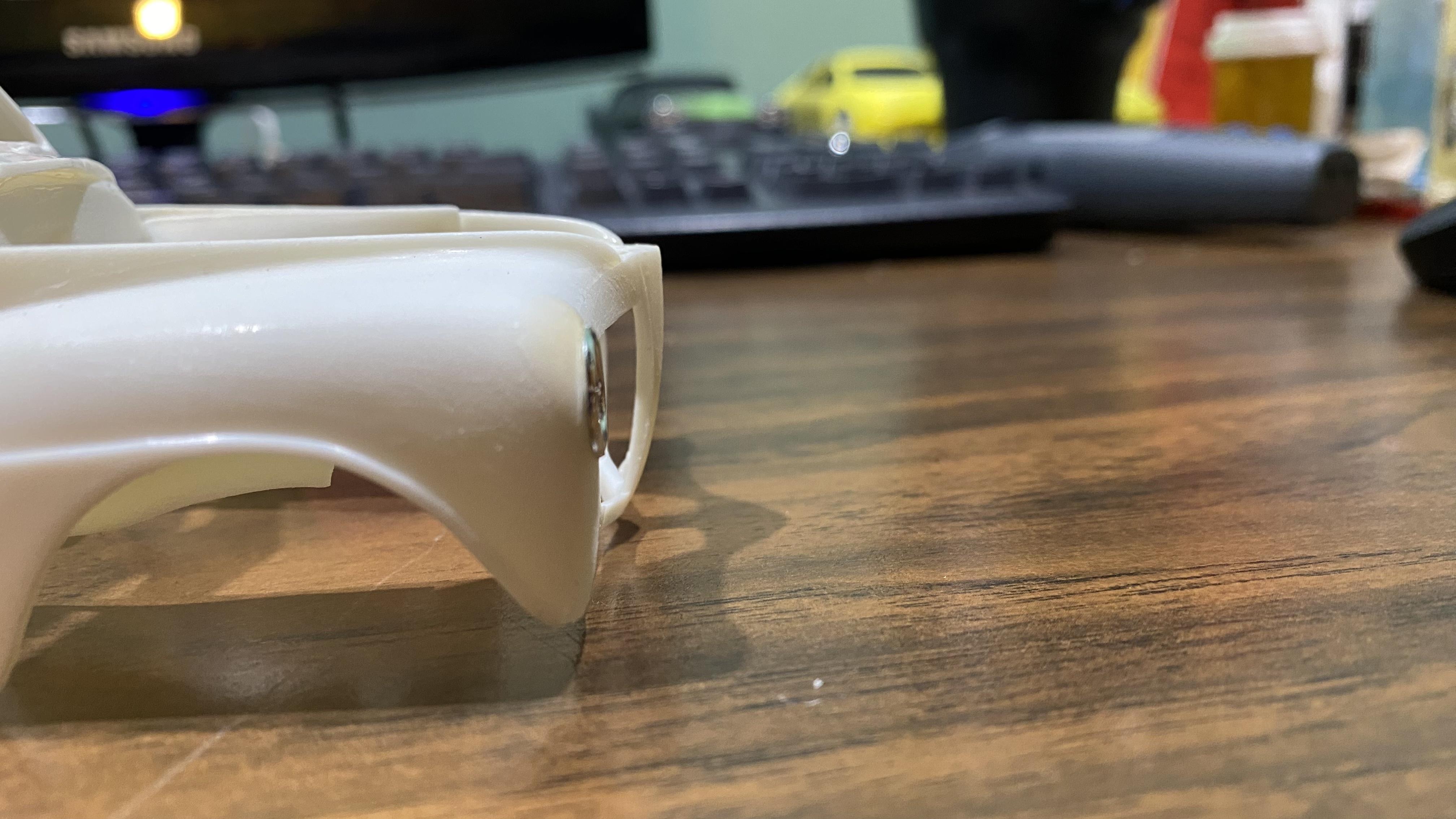

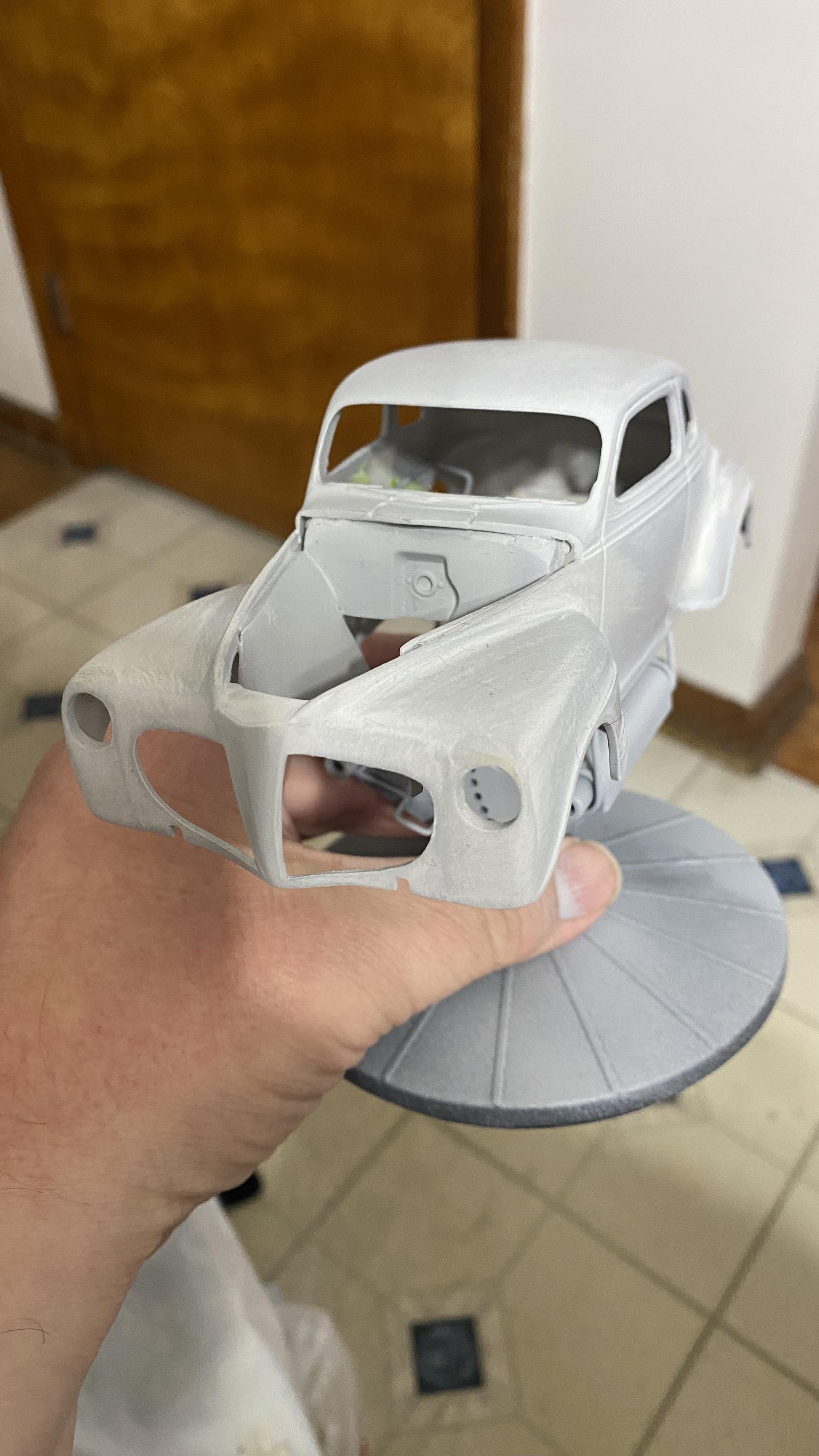

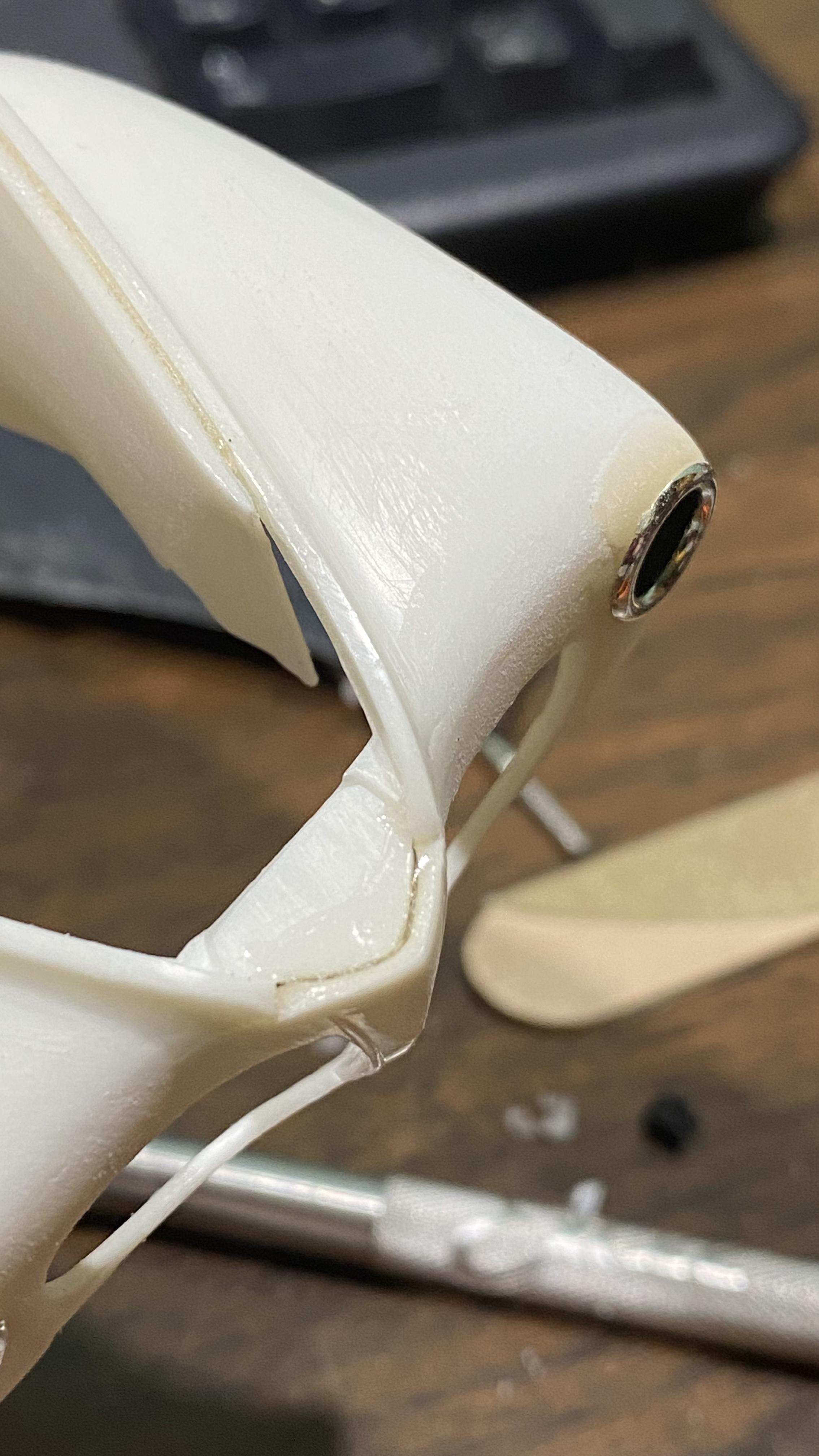

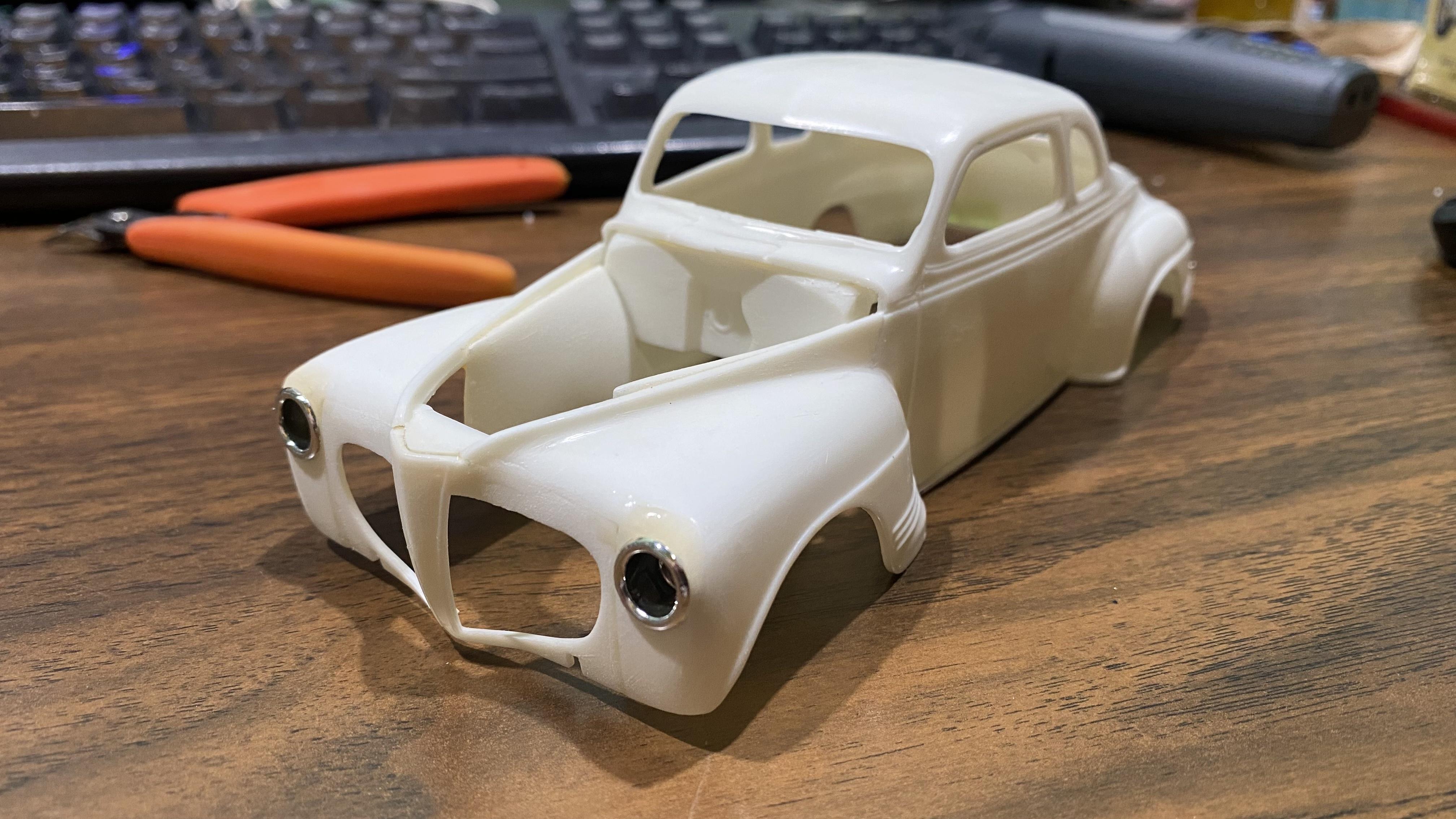

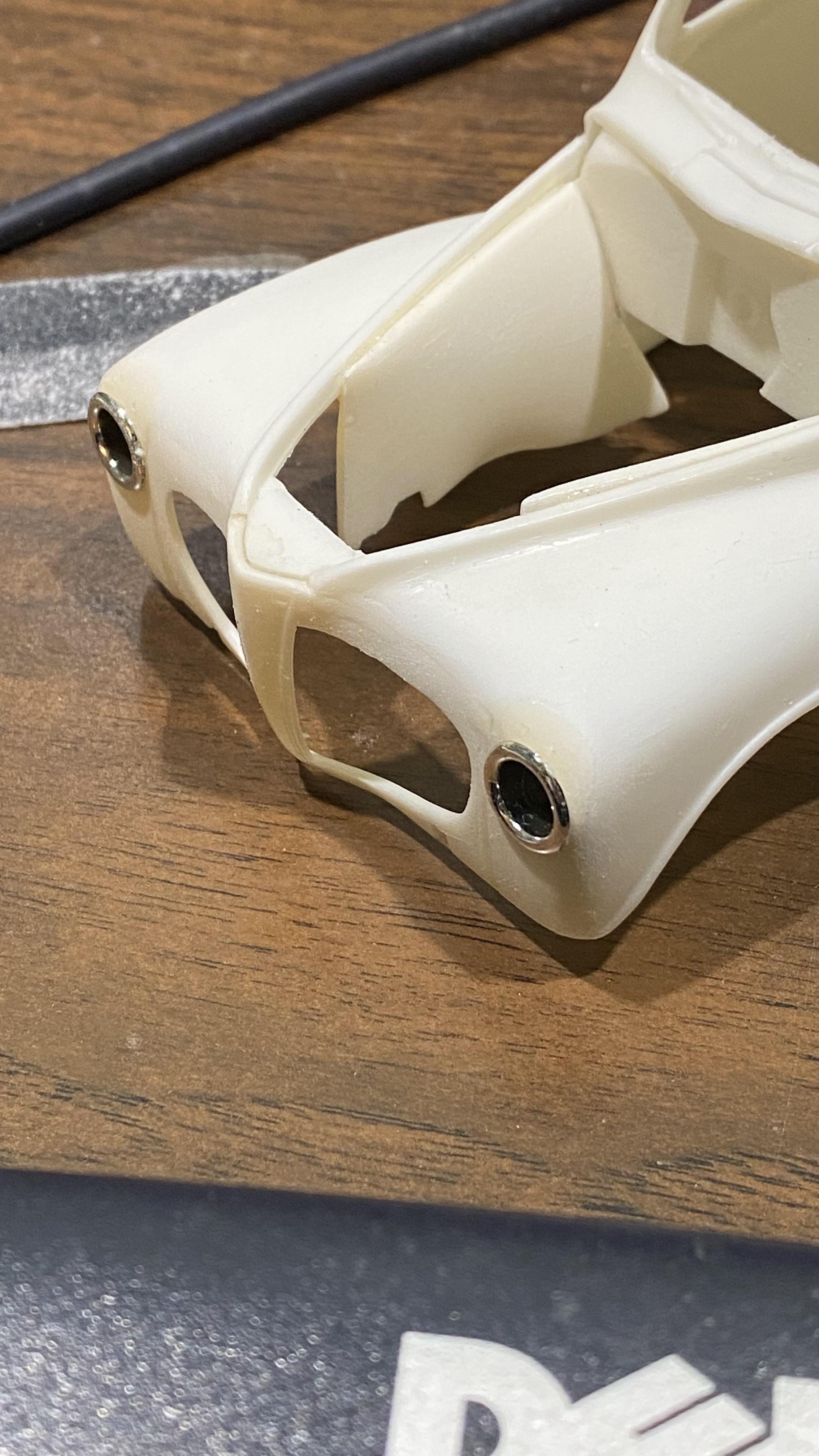

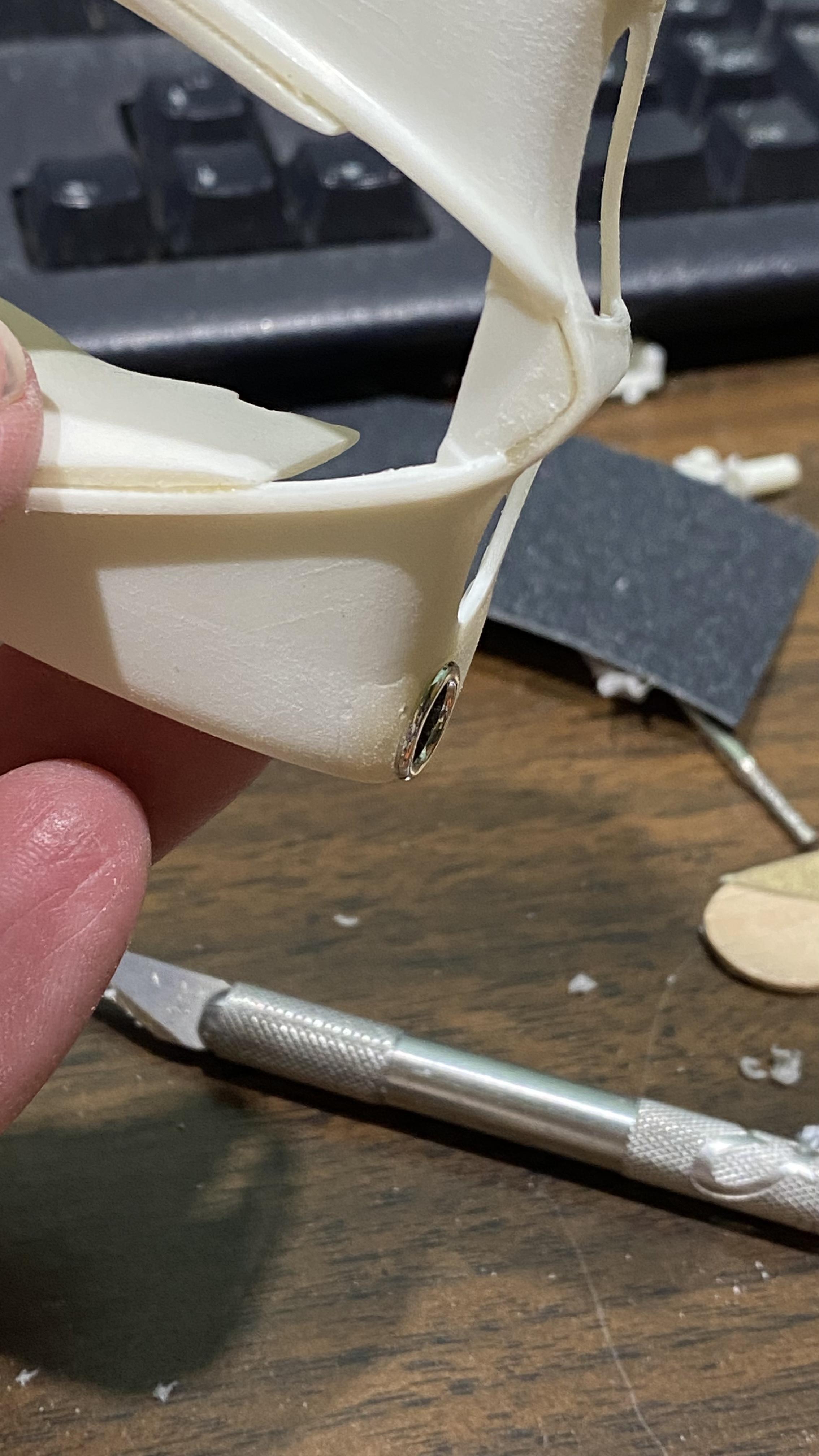

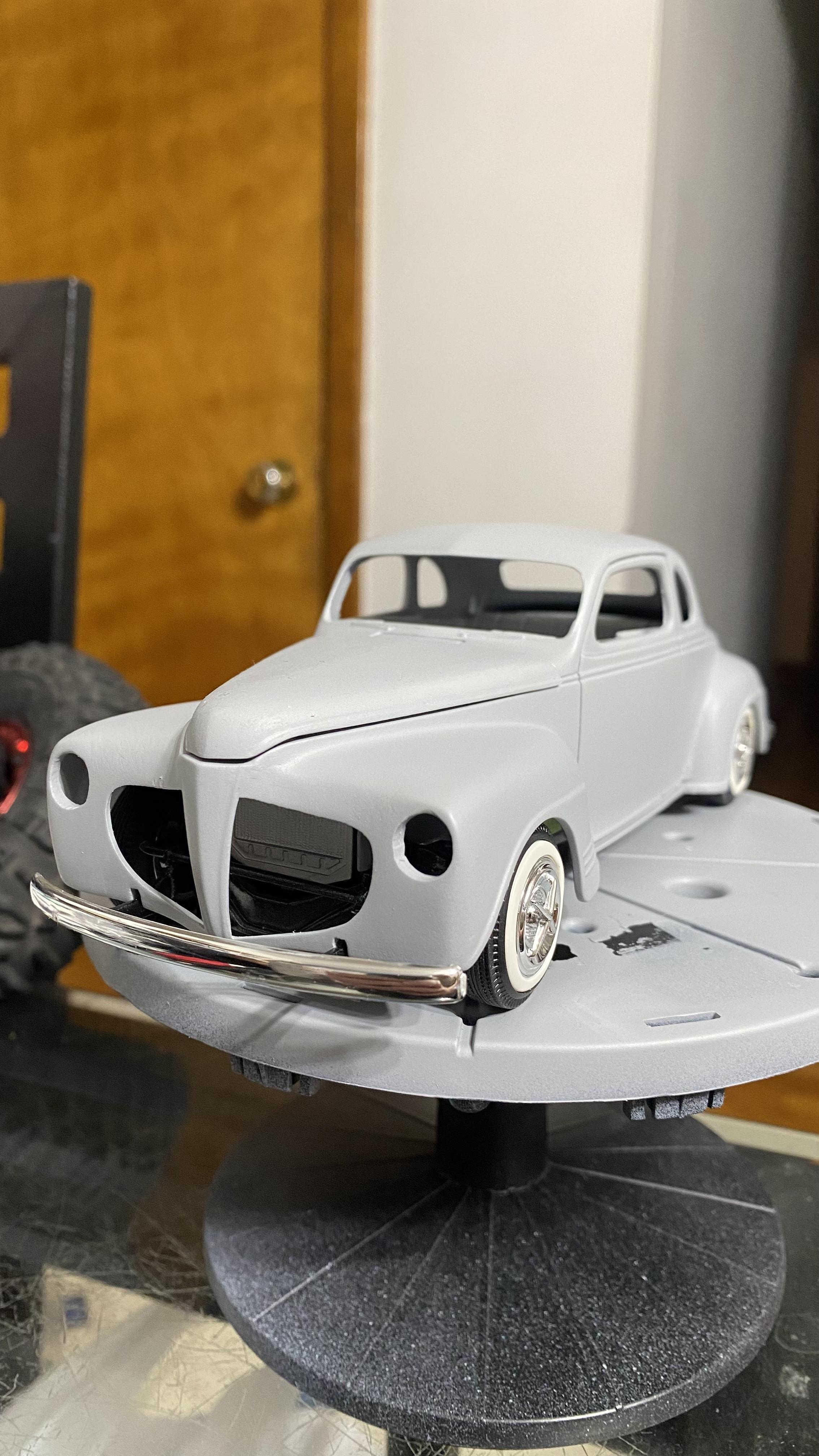

Before I did the above, I attached the smoothed fender liners and firewall in place and started trying out the Frenched headlight buckets from AMT’s ‘49 Merc, which I liked the look of!
getting those liners and the firewall to fit was such a pain, I did reinforce the joints on the backside with more of that Bondic UV Resin as well as fill in that gap in the with it too though!
I also tried the mold in that valance pan that goes over the rear bumper and modify the trunk at the bottom, but that did not work out well, so……more on that later……A00E81C5-548A-461D-A015-EFE66A8657B3.thumb.jpeg.df2a5f09adbfd1fe3b13518e2c0ba6e8.jpeg
I started filling in around the top edges of the fenders with Bondic to get them so the chromed lip of the Merc headlight trim rings would flush up against them, though I’m still tweaking that.
FCA38765-0E5B-43F1-9E88-170D4A66D498.thumb.jpeg.f7c6234a94d2309ea0b60f485d1199da.jpegF58FE0D1-D227-495F-9DDC-CF5D012F10D7.thumb.jpeg.e876c06a890111bfc4363b669581acaa.jpeg5D4918E6-204A-49E0-9E77-CFDA7F2FC7D4.thumb.jpeg.cdfa545a1670858fcf897140f93909e0.jpeg9C022301-4BF3-475B-983F-C9475BF35486.thumb.jpeg.68646df5871d7783249d53e70889bc64.jpeg

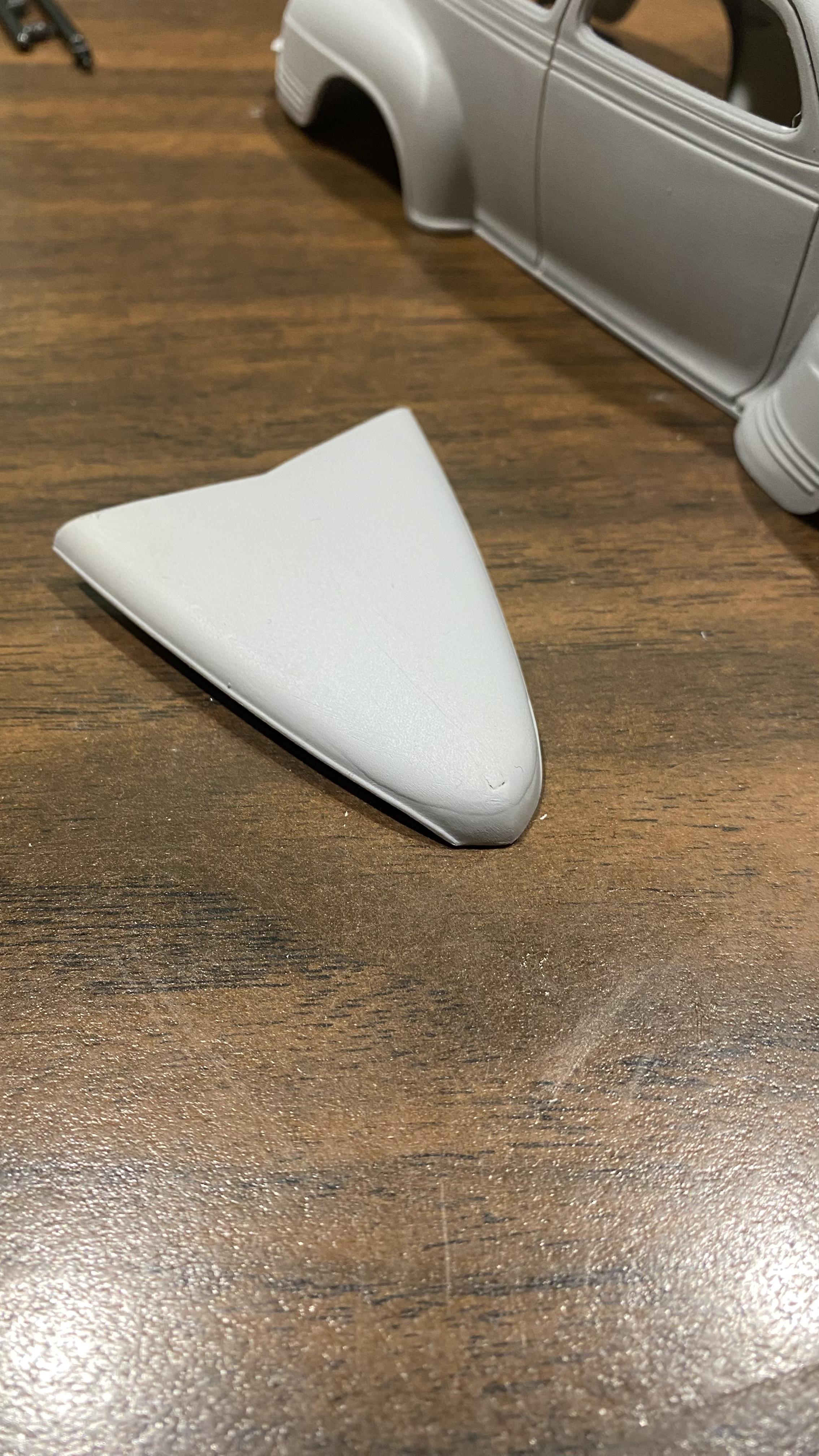

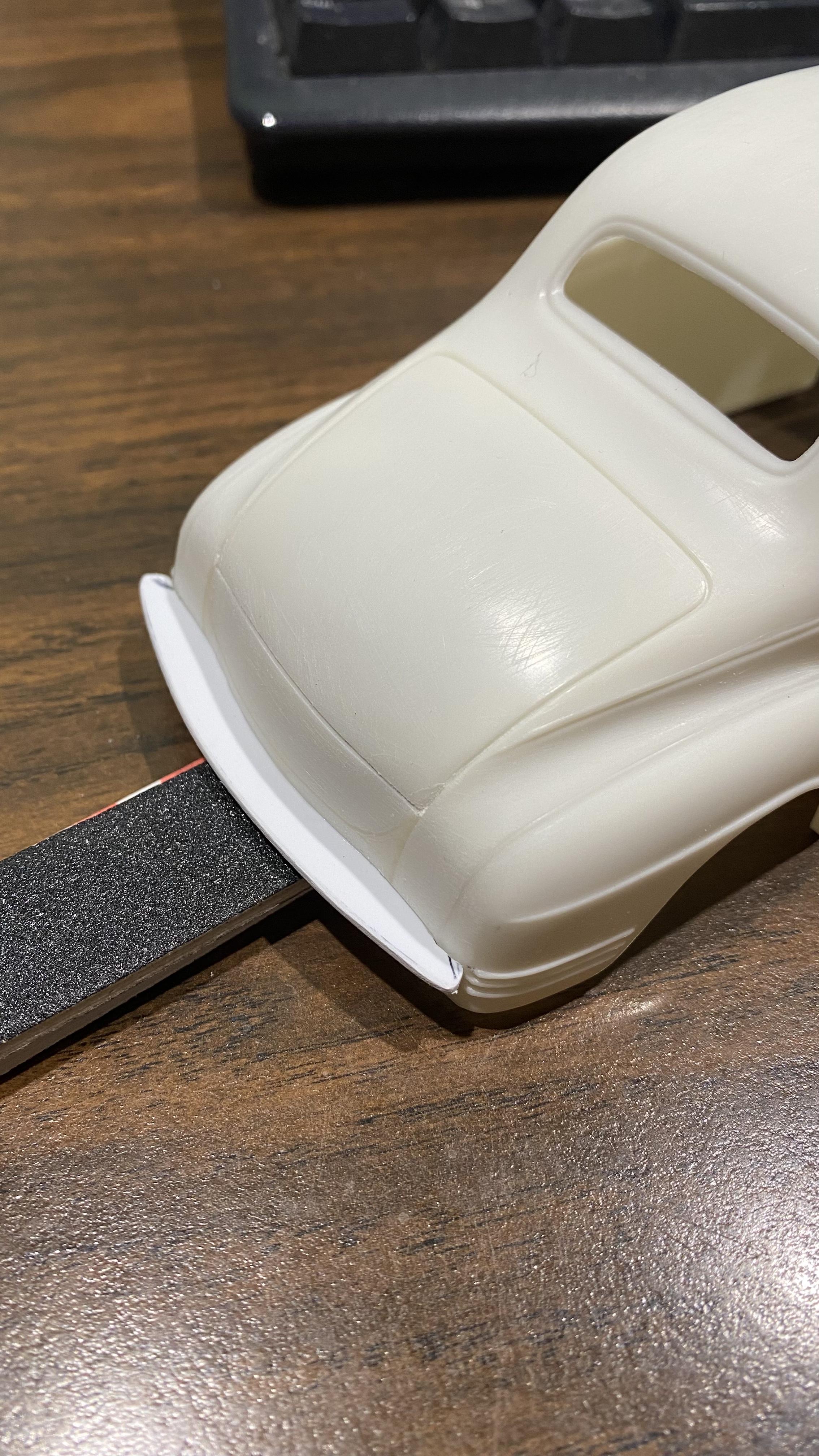

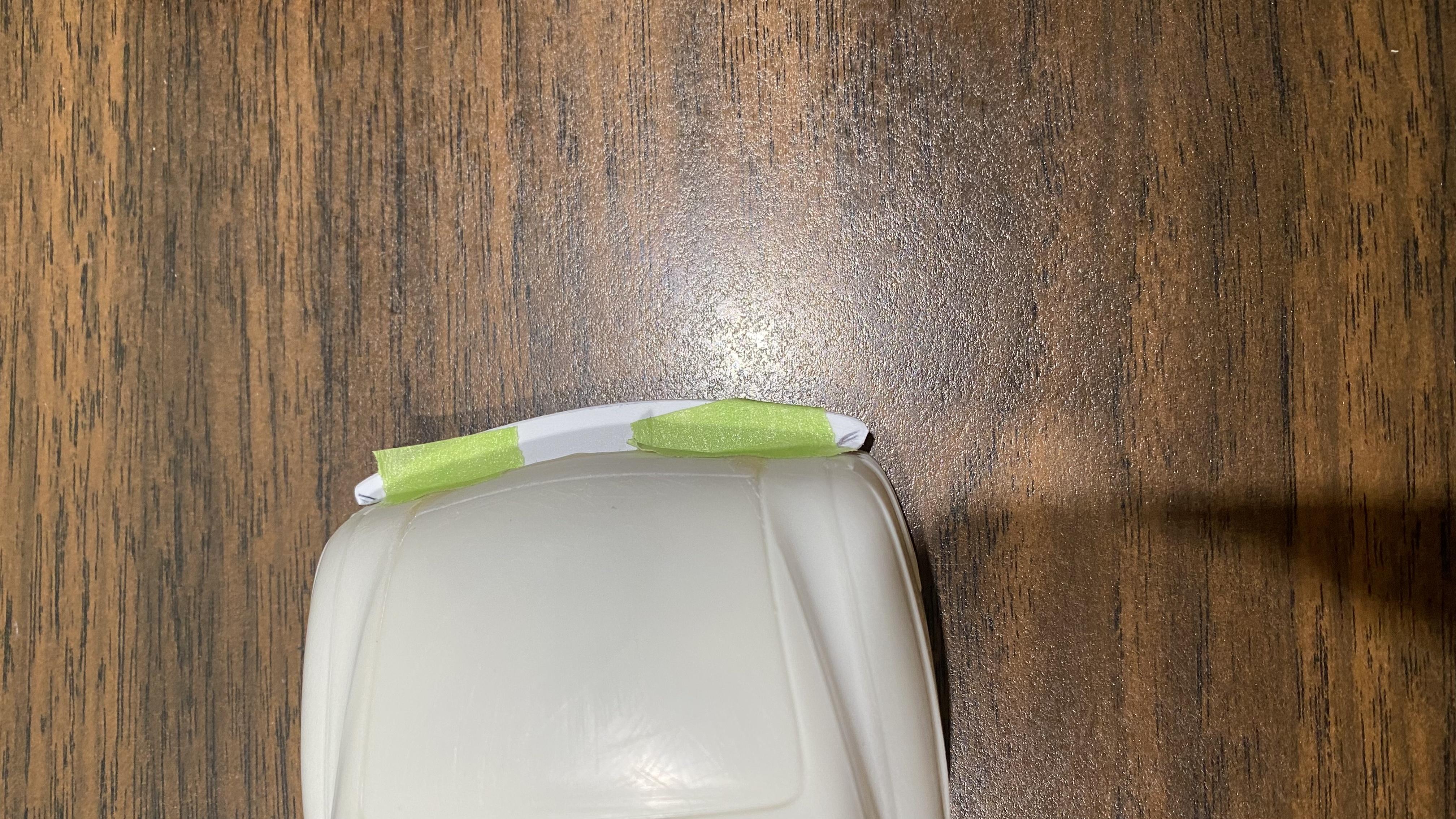

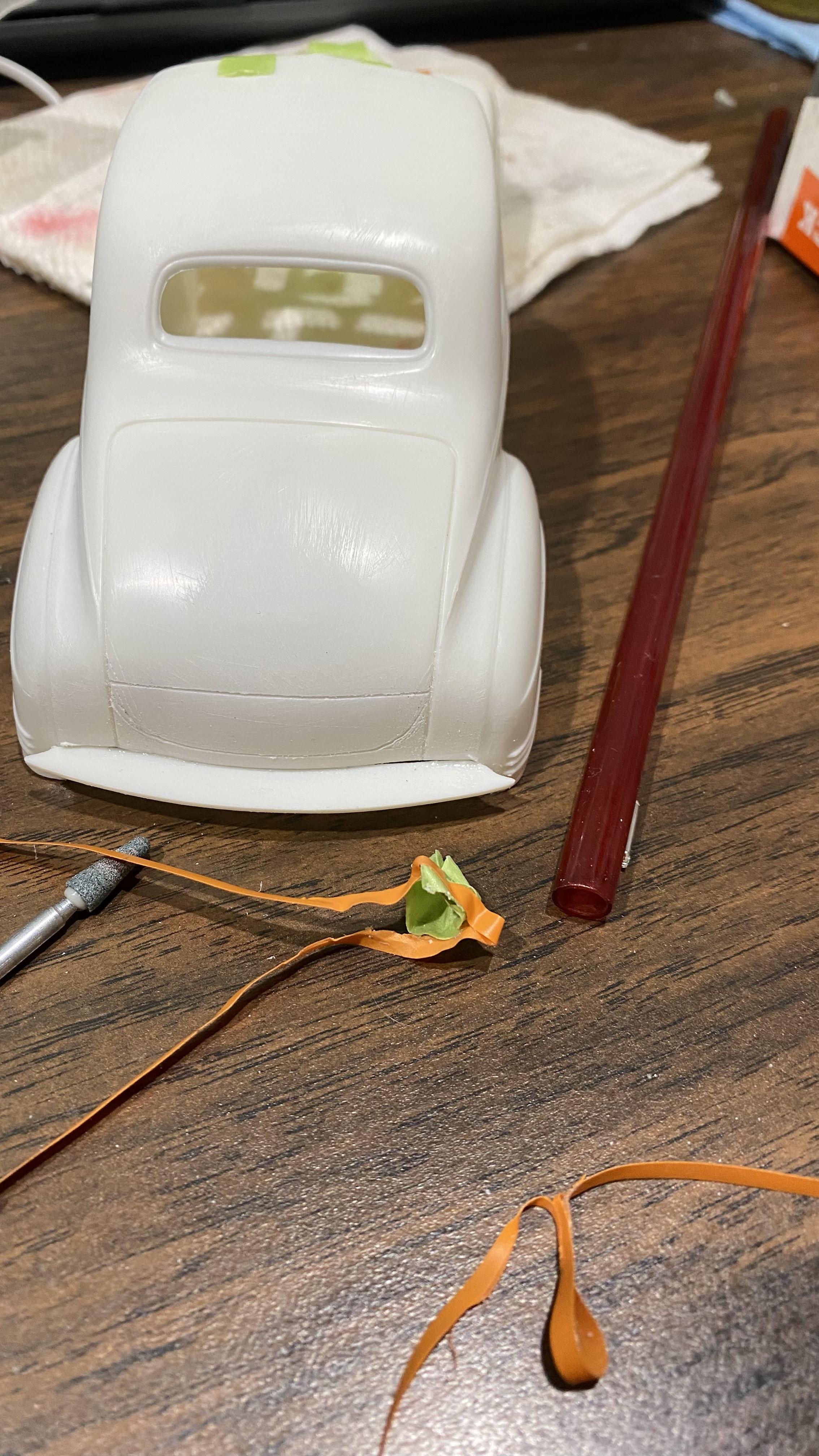

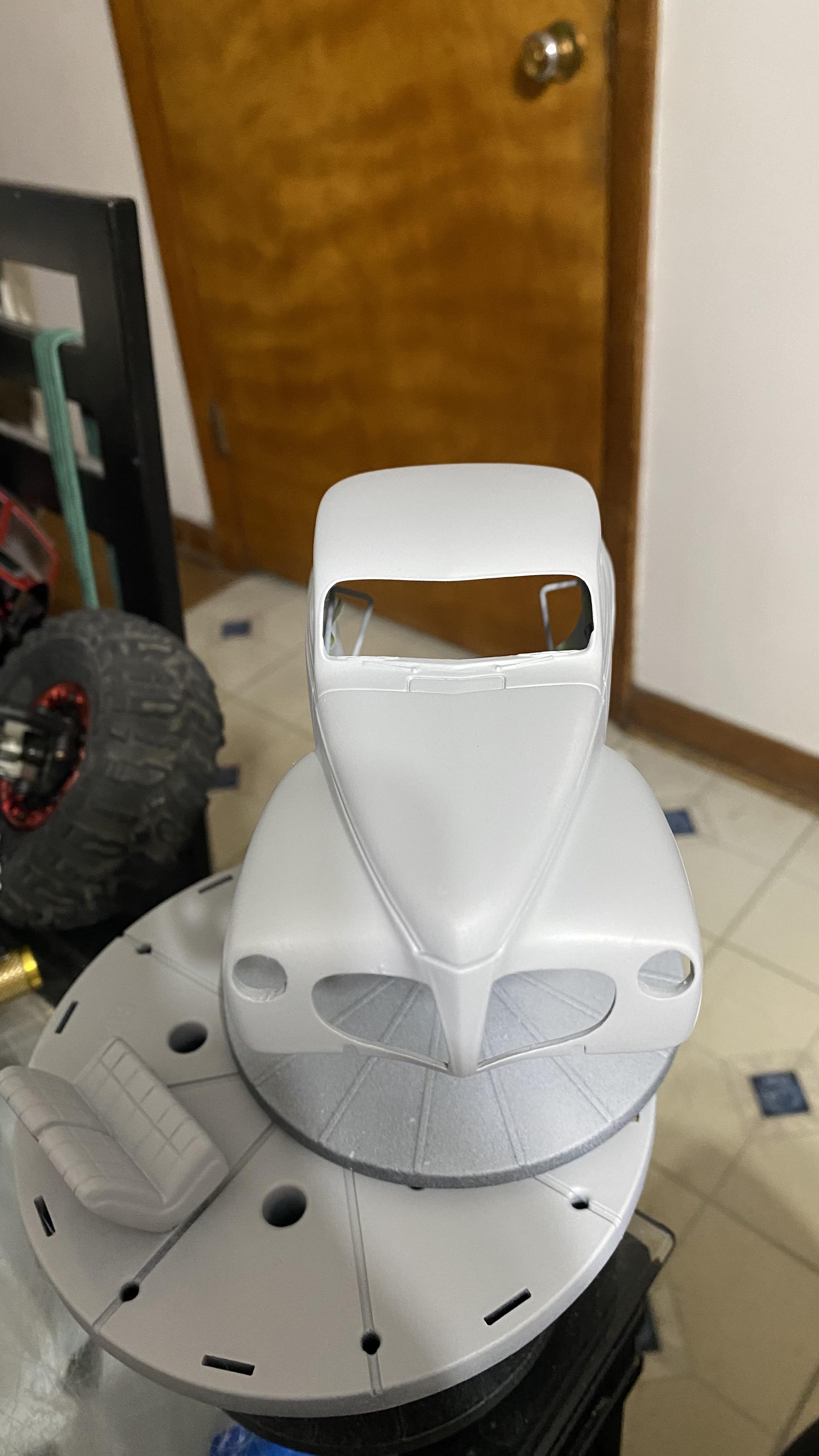

Now…..for that rear valance, I made a new one from .060 styrene that will be molded in once the front body work for the headlights is done.
So here is where the body is as of right now.
8C2CC634-C8A2-40E1-A4C5-46589AFB64D5.thumb.jpeg.90426dac83137c775b0e7bc2db2e98a8.jpeg9118FEFC-A71E-46BD-9553-252547145D68.thumb.jpeg.6a114d4811ccee7f9d5690714c658304.jpeg

Did a little more work on the car after work tonight!  Got the resin on the fenders shaped about right to match the headlights and the lines for the trunk filled in and the valance cemented in place. Forgot to mention that I removed the vent windows and frames on the doors too!

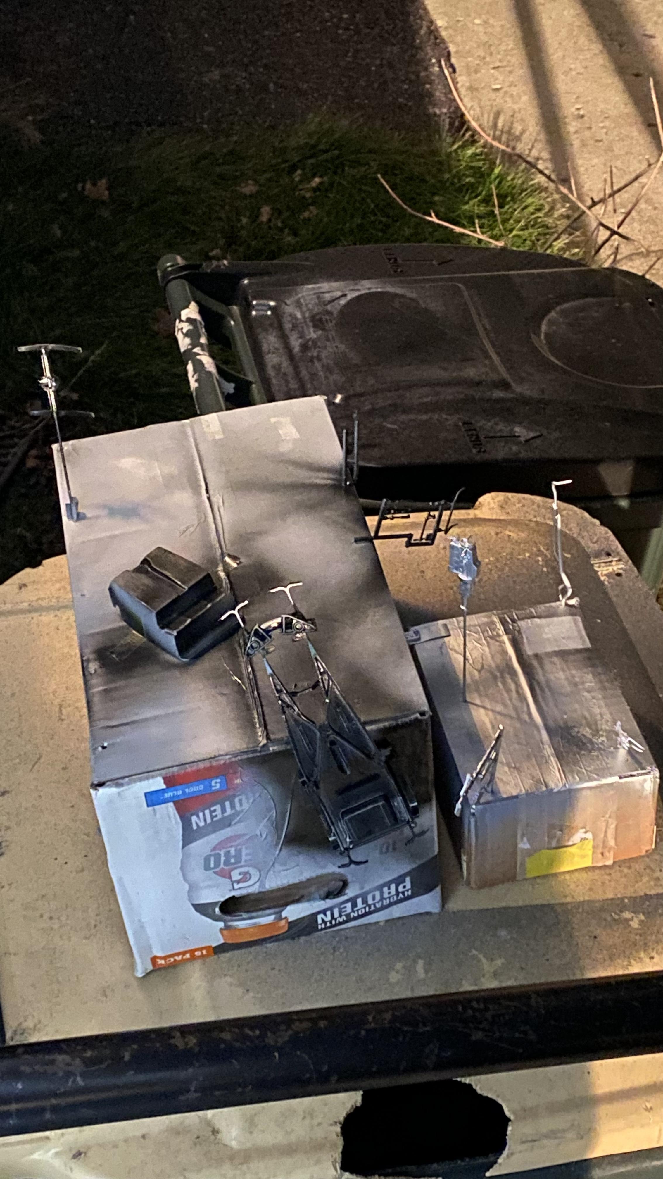

I do have the chassis, suspension, and engine/transmission already in paint, just difficult to tell since I had to shoot it in the dark, both paint and pics wise. The chassis, suspension, steering and drive shaft are all Testors’ Blazing Black Metallic while the engine and trans assembly will be all Krylon Chrome Silver with black accents.

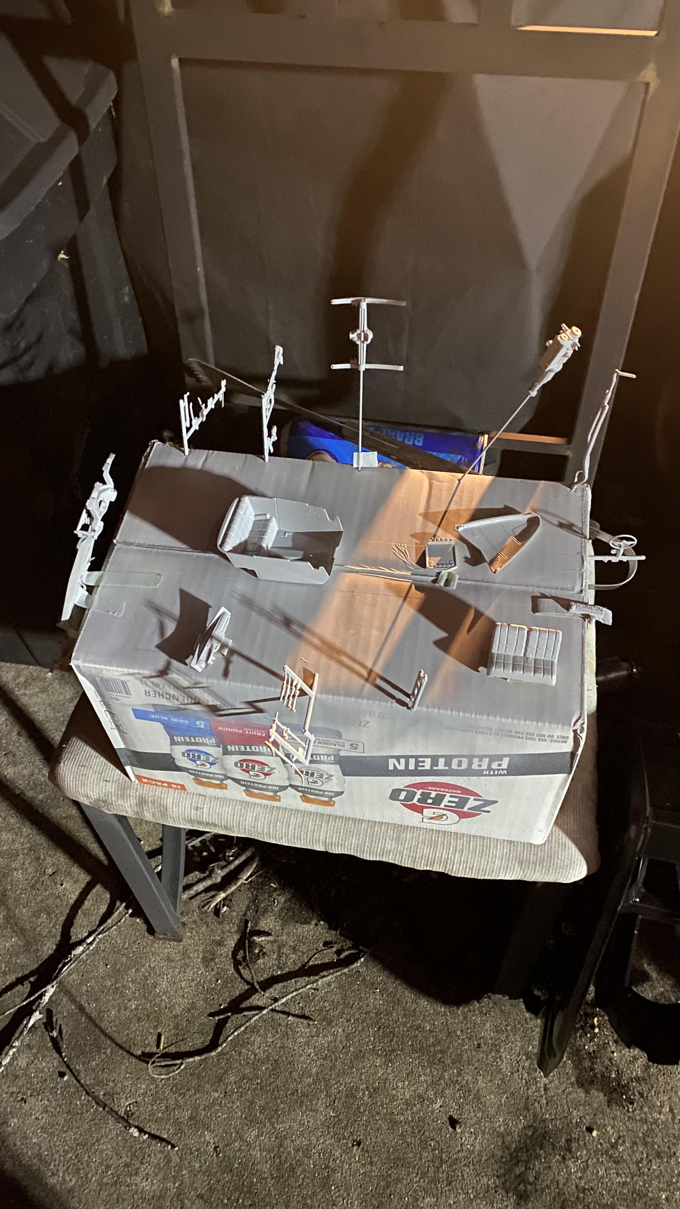

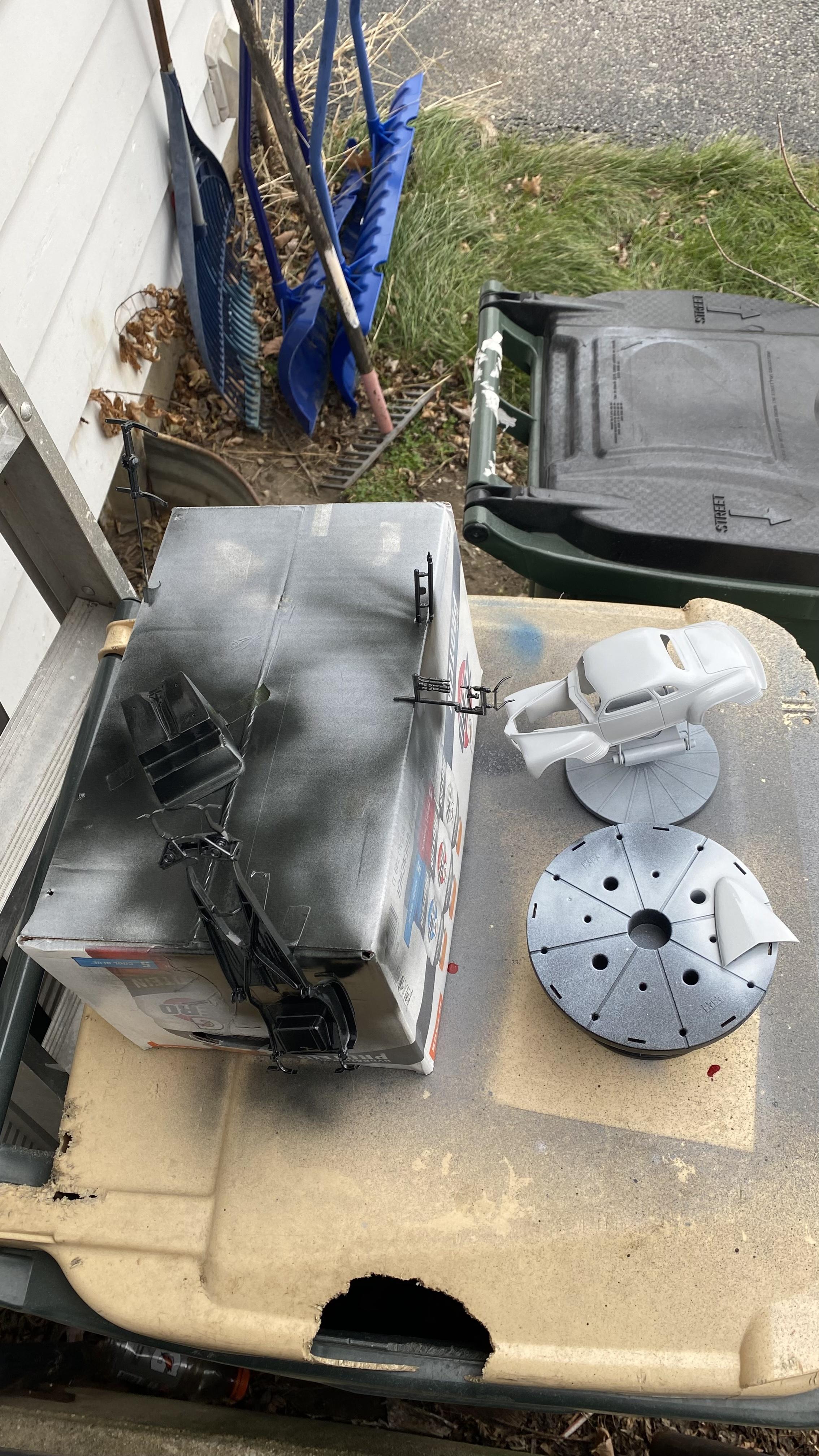

Shot the primer when I went on lunch today and touched up the black as well, spraying metallic black outside and in the dark with just a house side wasn’t the greatest idea…….oops.2688EEB3-D134-4D33-8889-CFF8CDBF6F6D.thumb.jpeg.84da00aa123065b483d09b766d8620d5.jpeg
I will at least have an idea where I need to do more body work once I’m done working for the day.

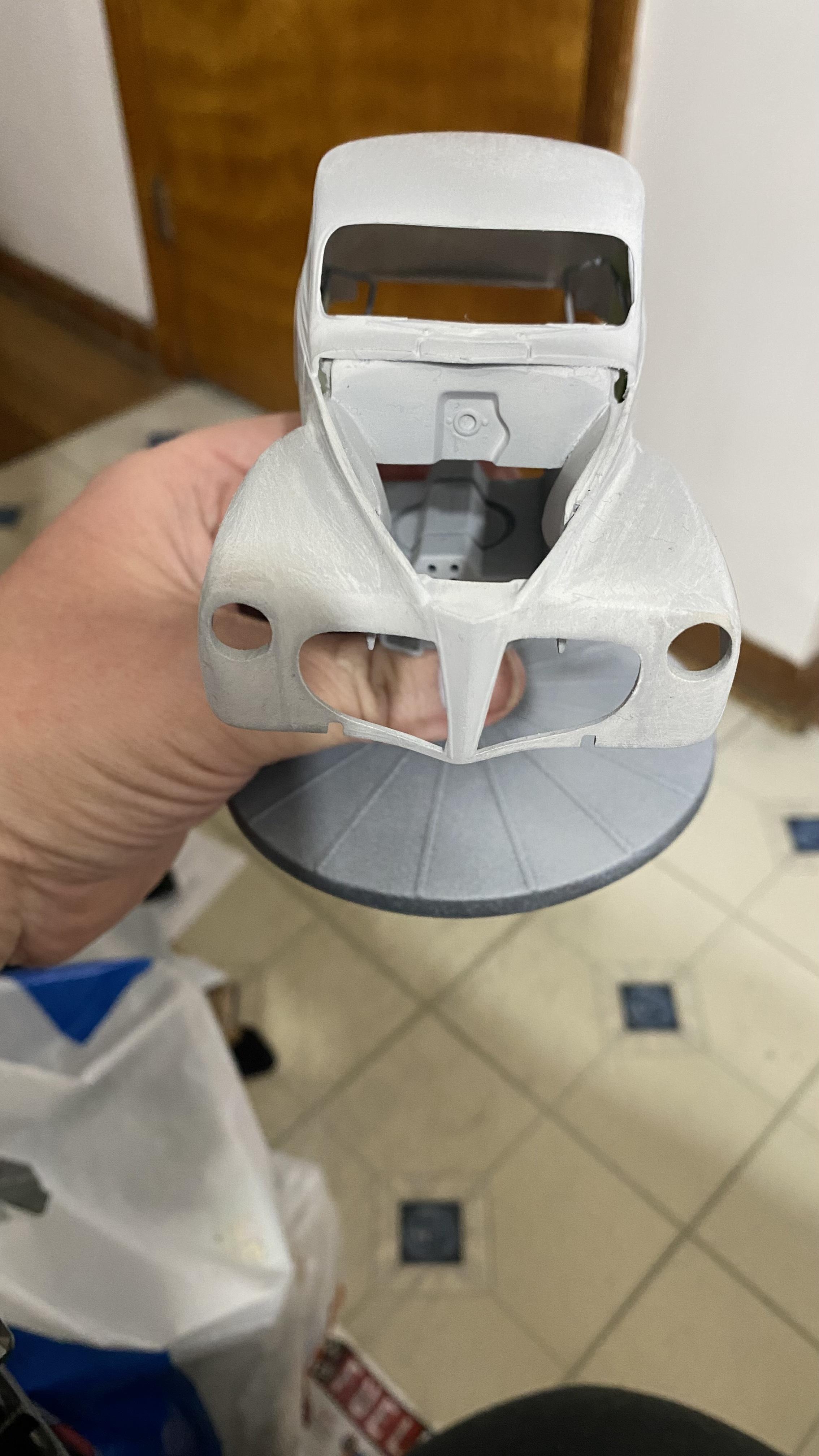

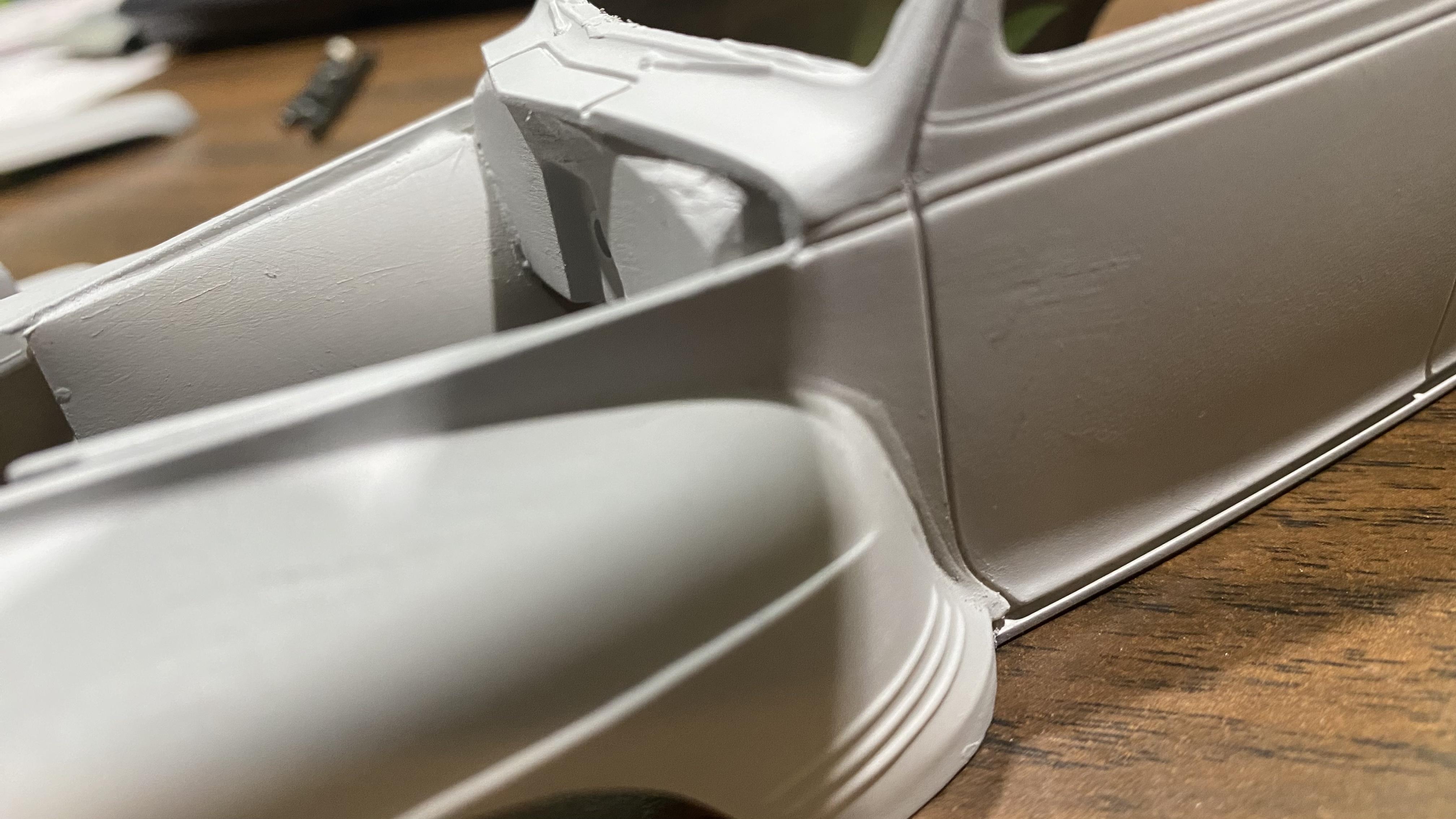

Ok, getting into the body work now that I can see the bodywork I’ve done in the primer and know where to work.

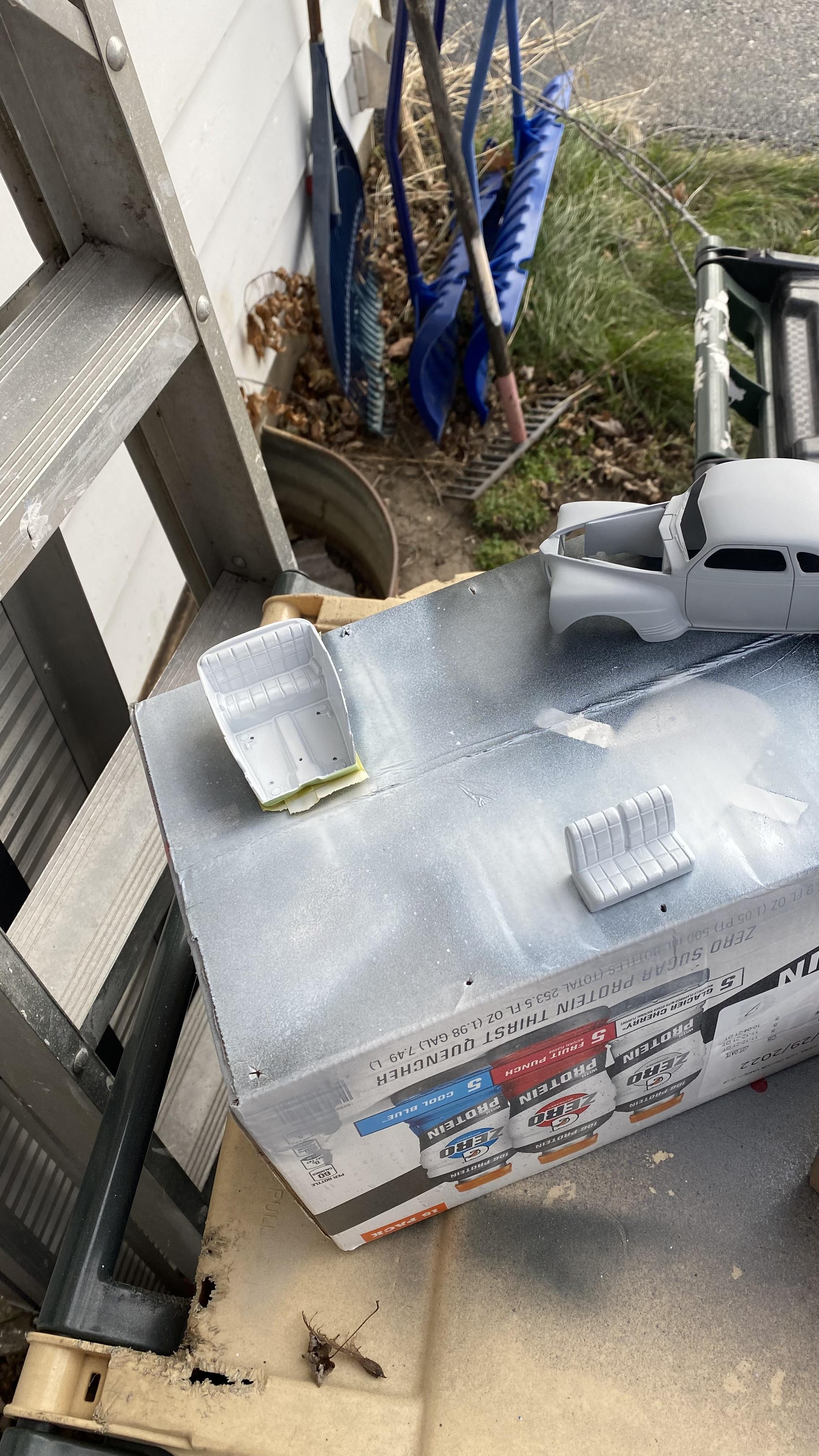

Then here’s the interior tub and front seat in primer……..sorta

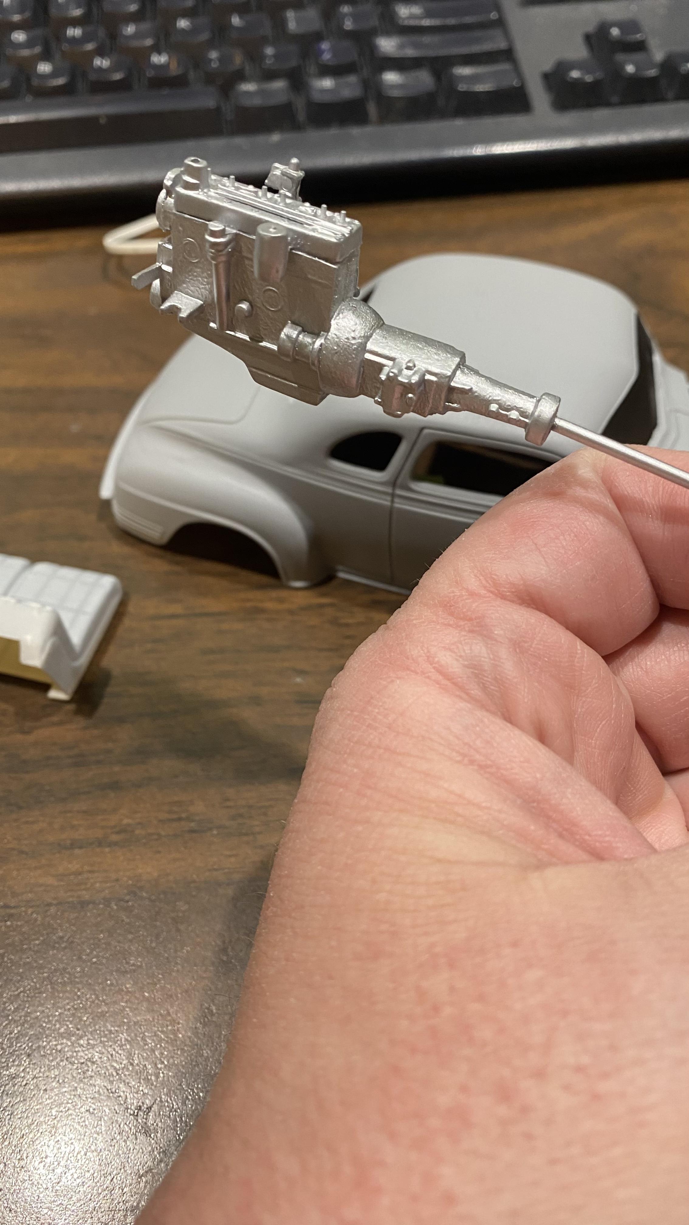

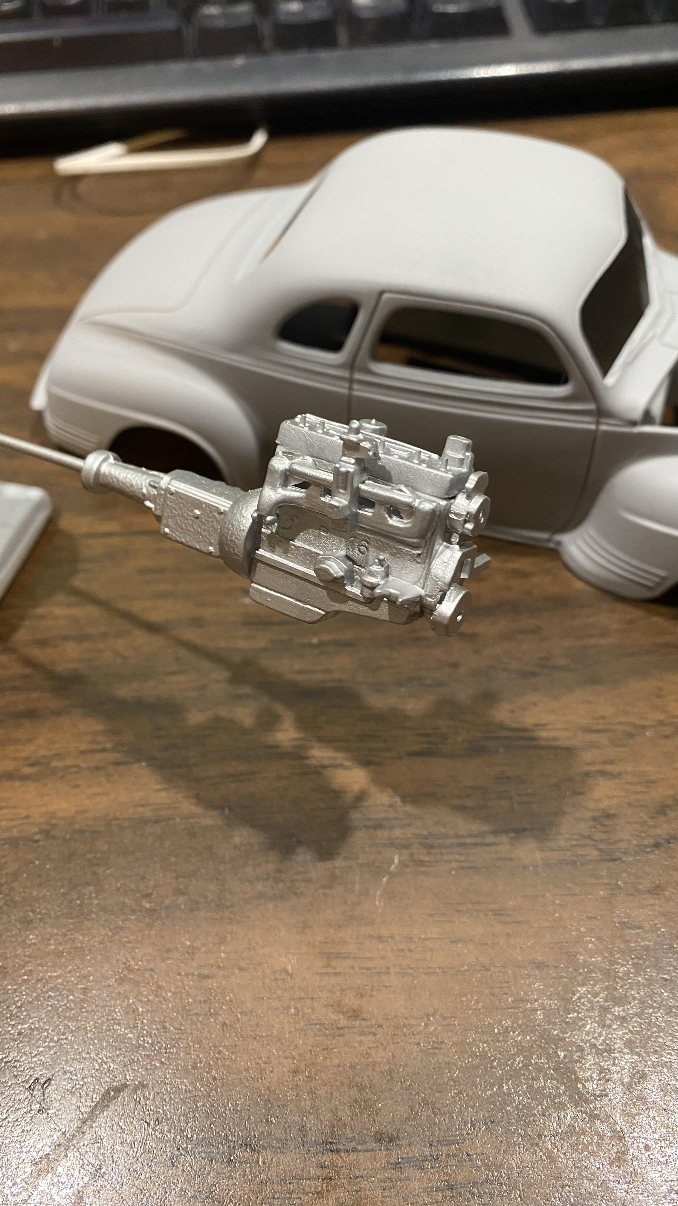

still need to do some painting, but here’s the engine so far!

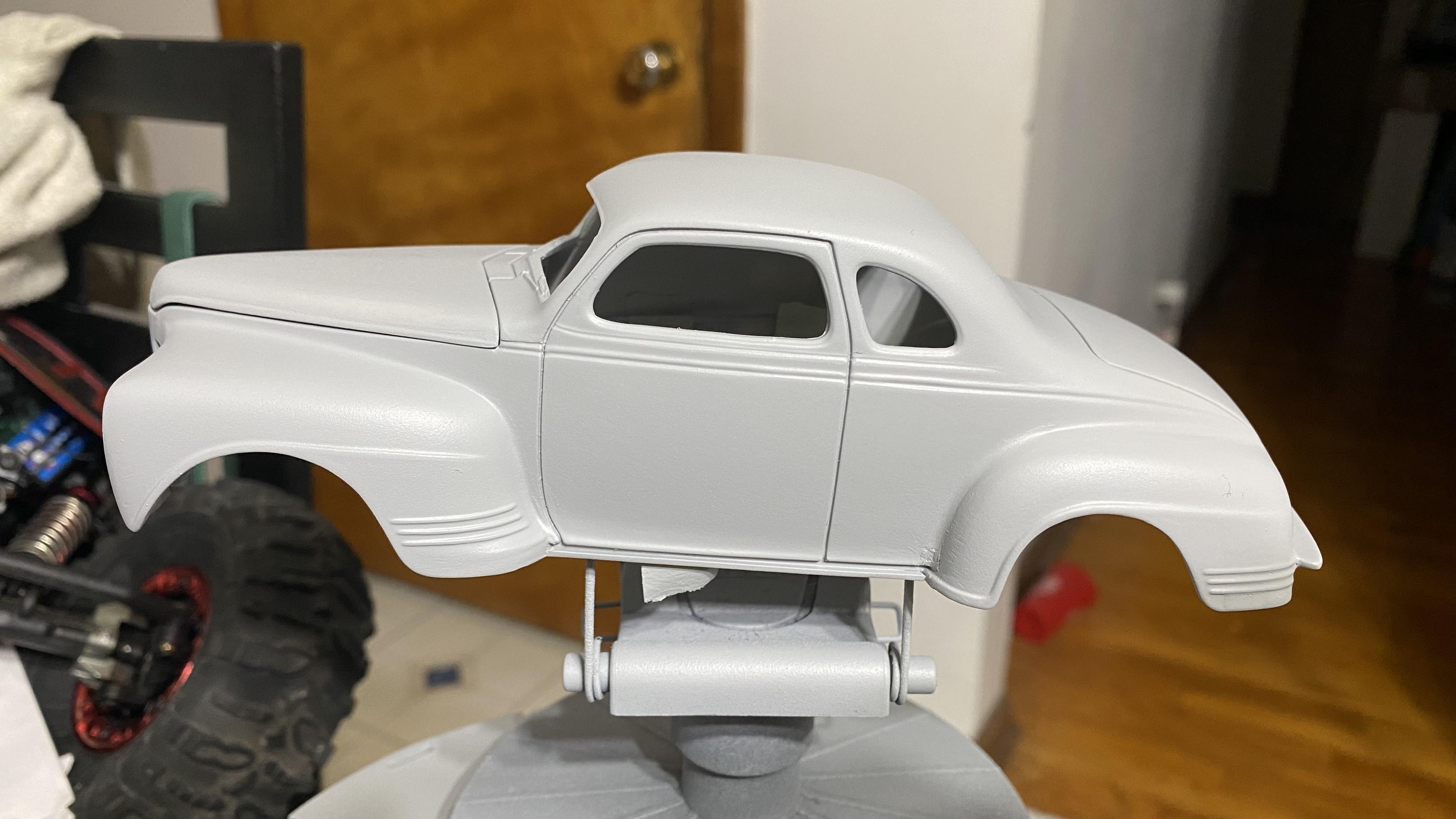

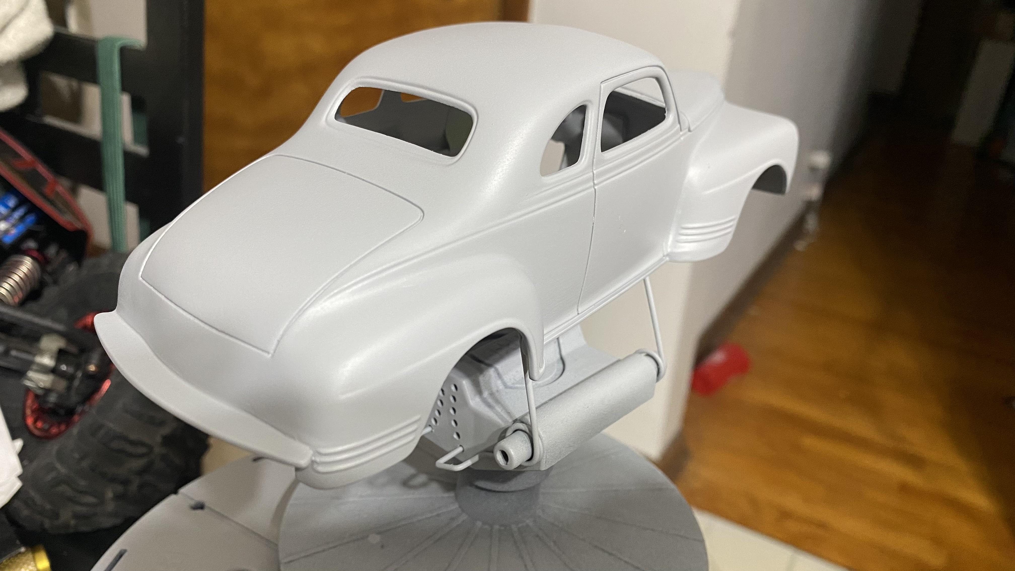

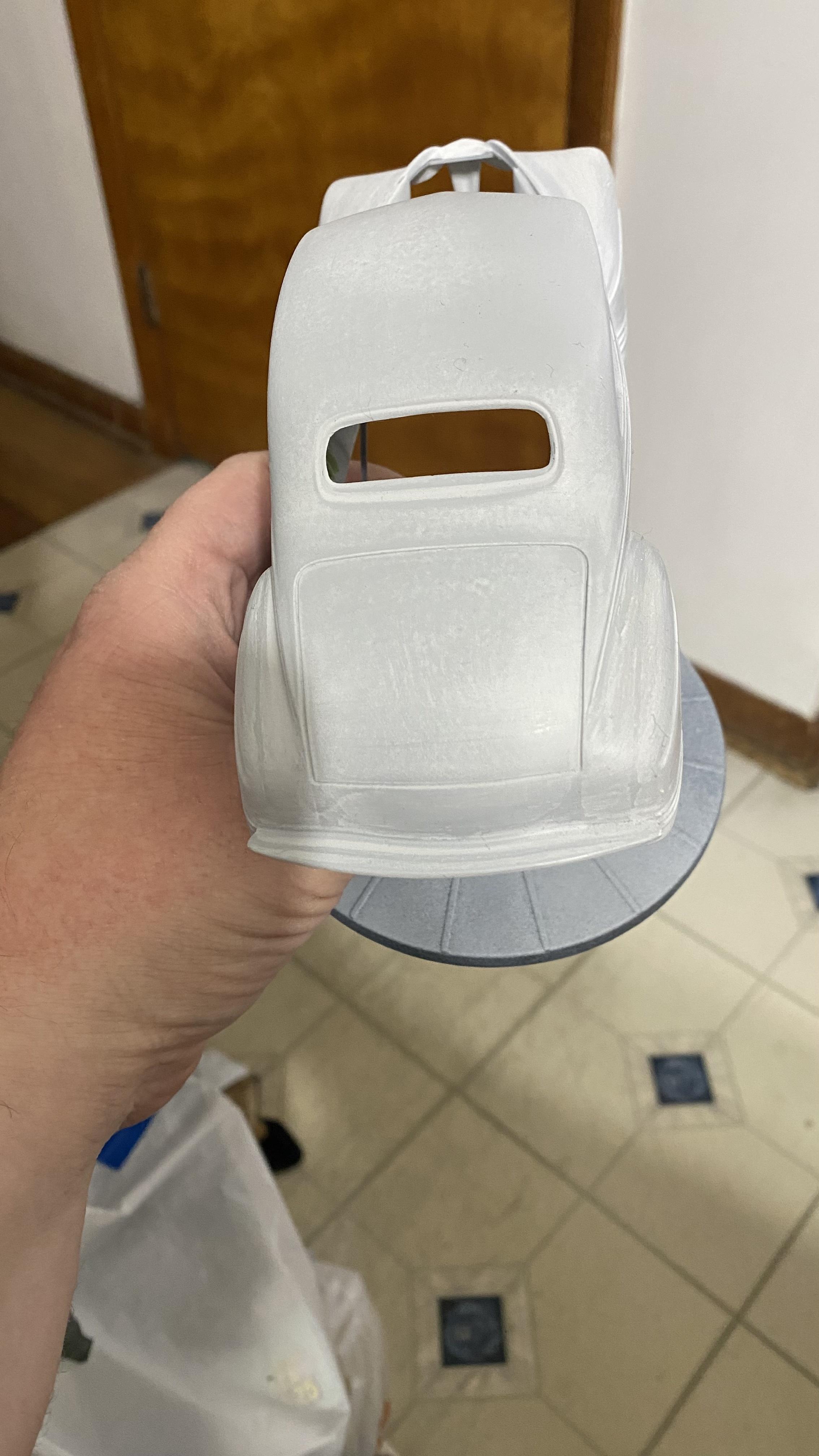

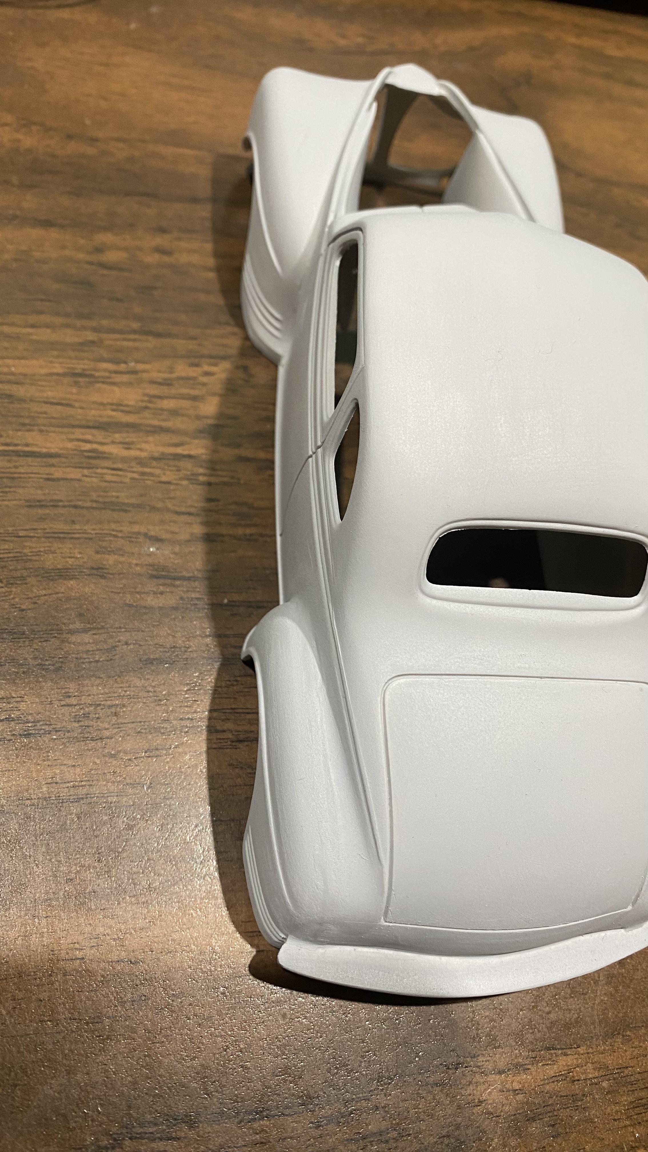

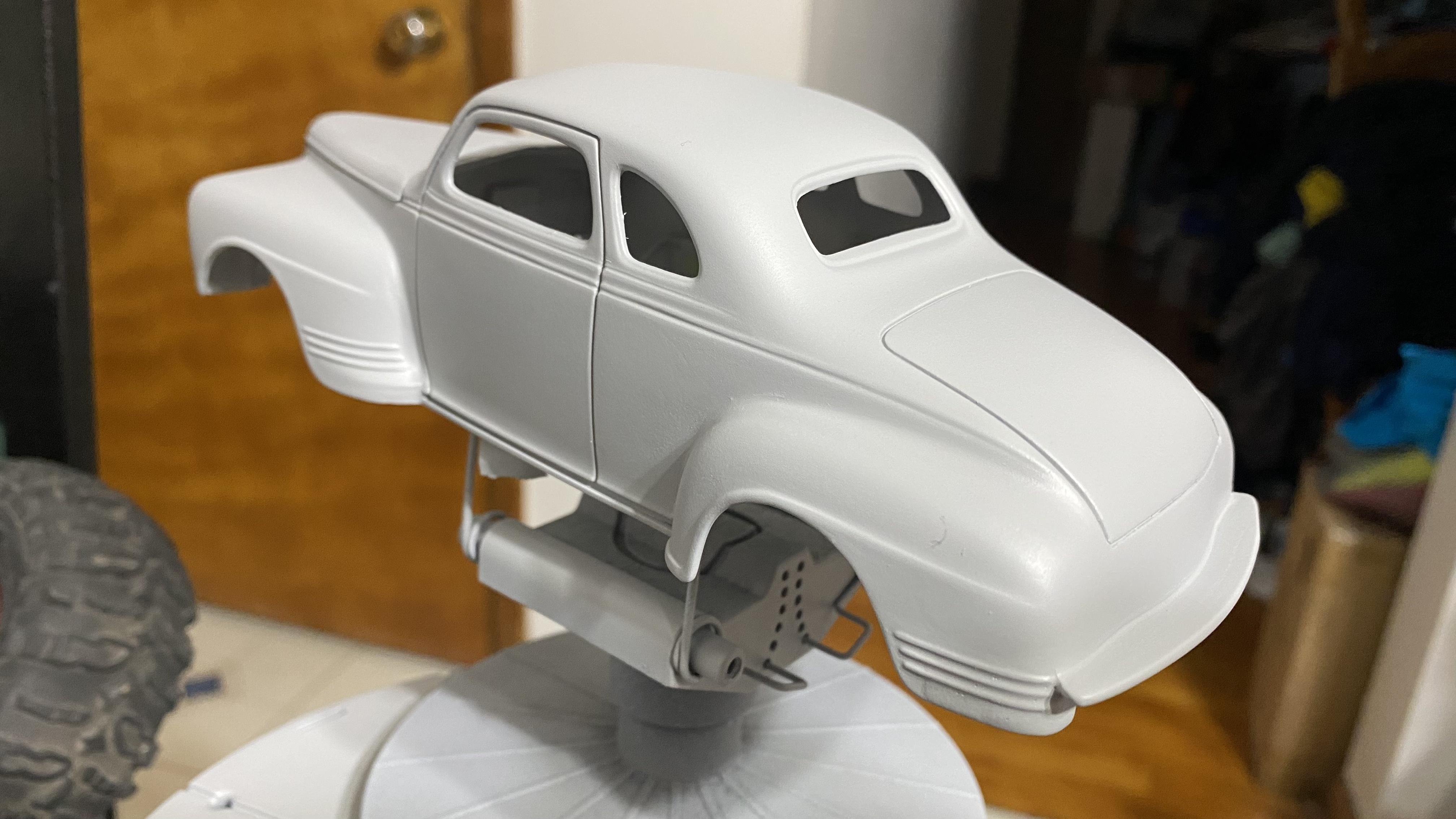

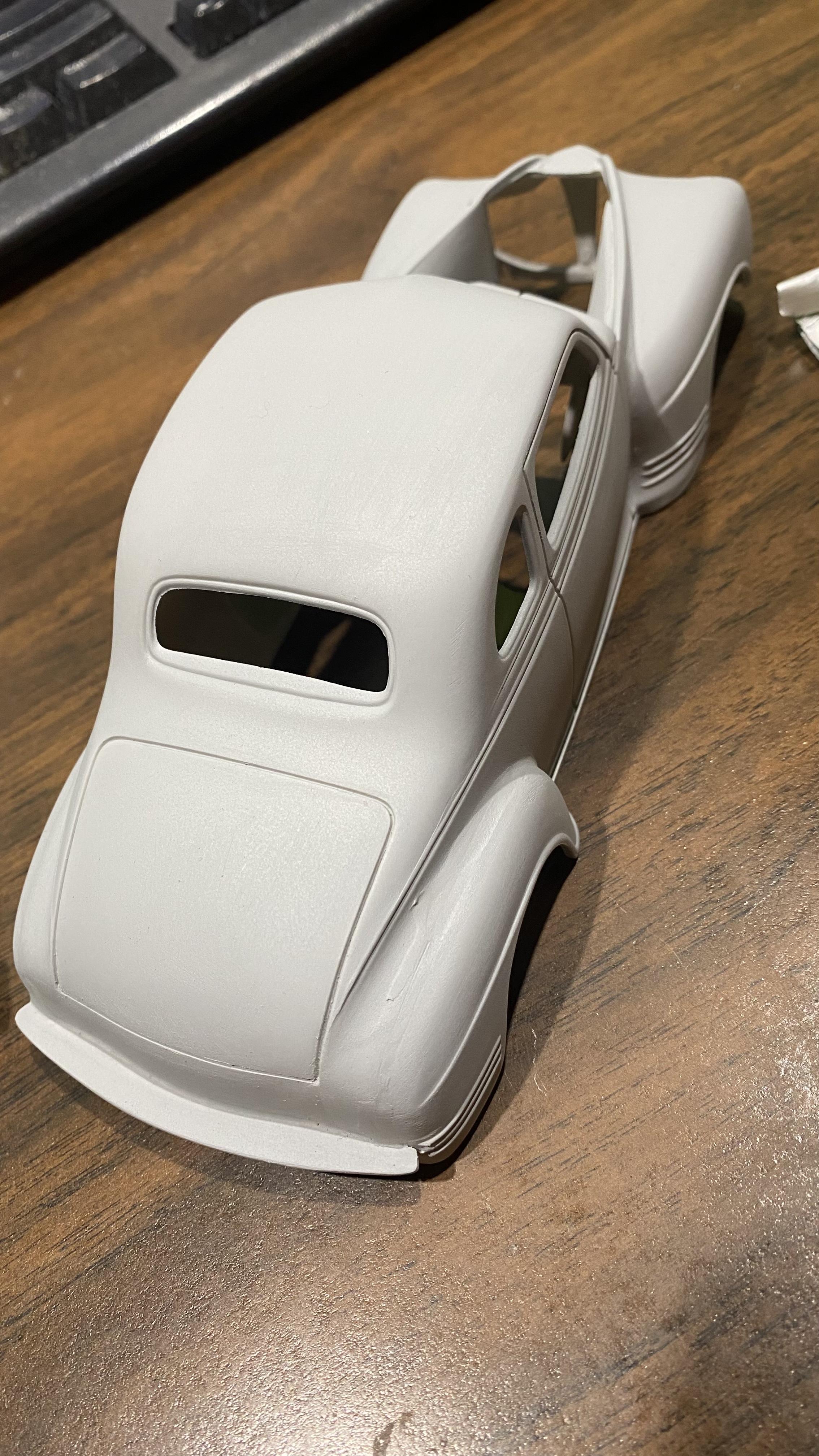

Body came out pretty good, gotta just clean up the filler primer and seal prime before the color and clear coats.

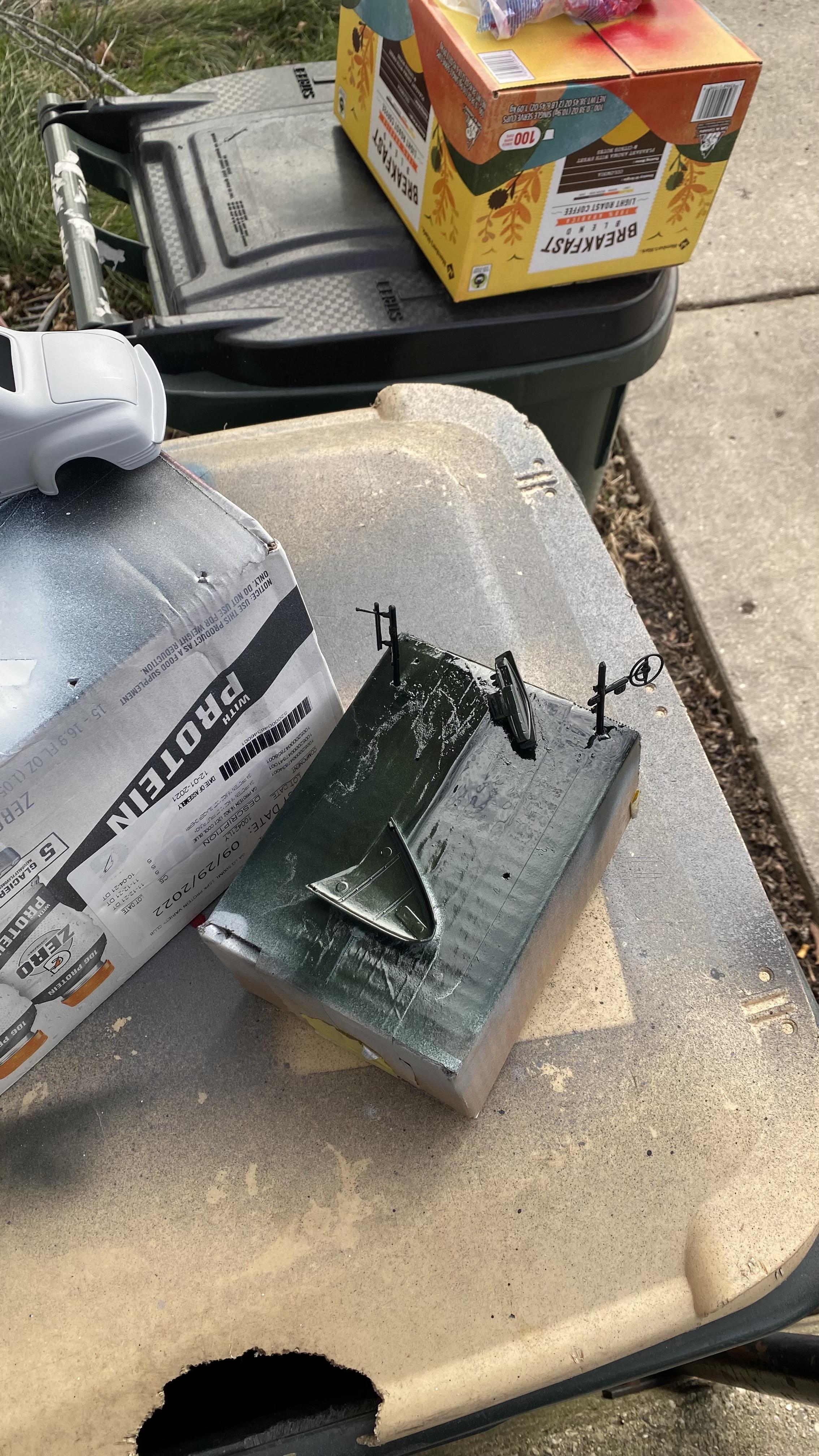

and then here’s the chassis and suspension in Blazing Black as well as the front bench seat.
