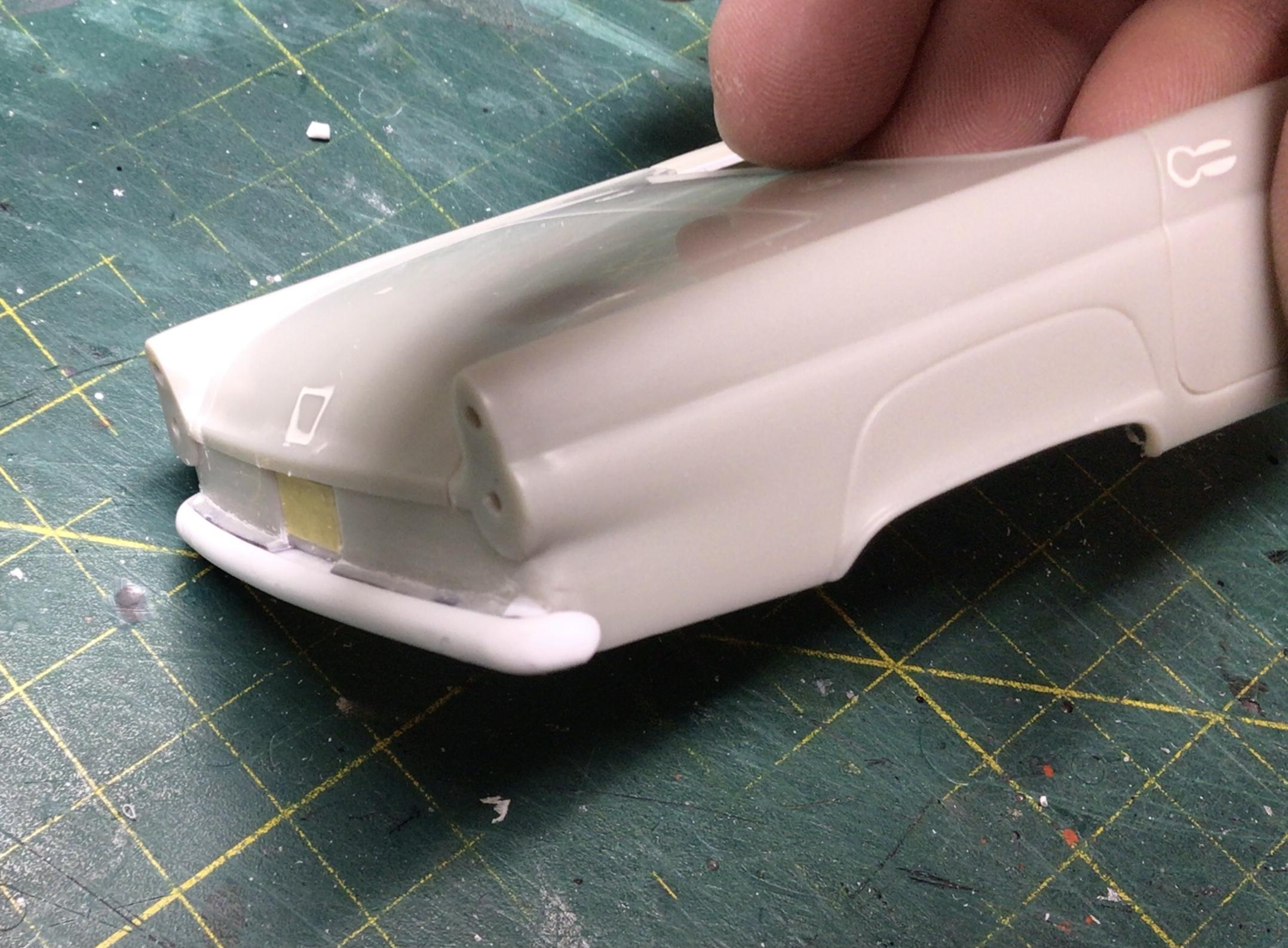

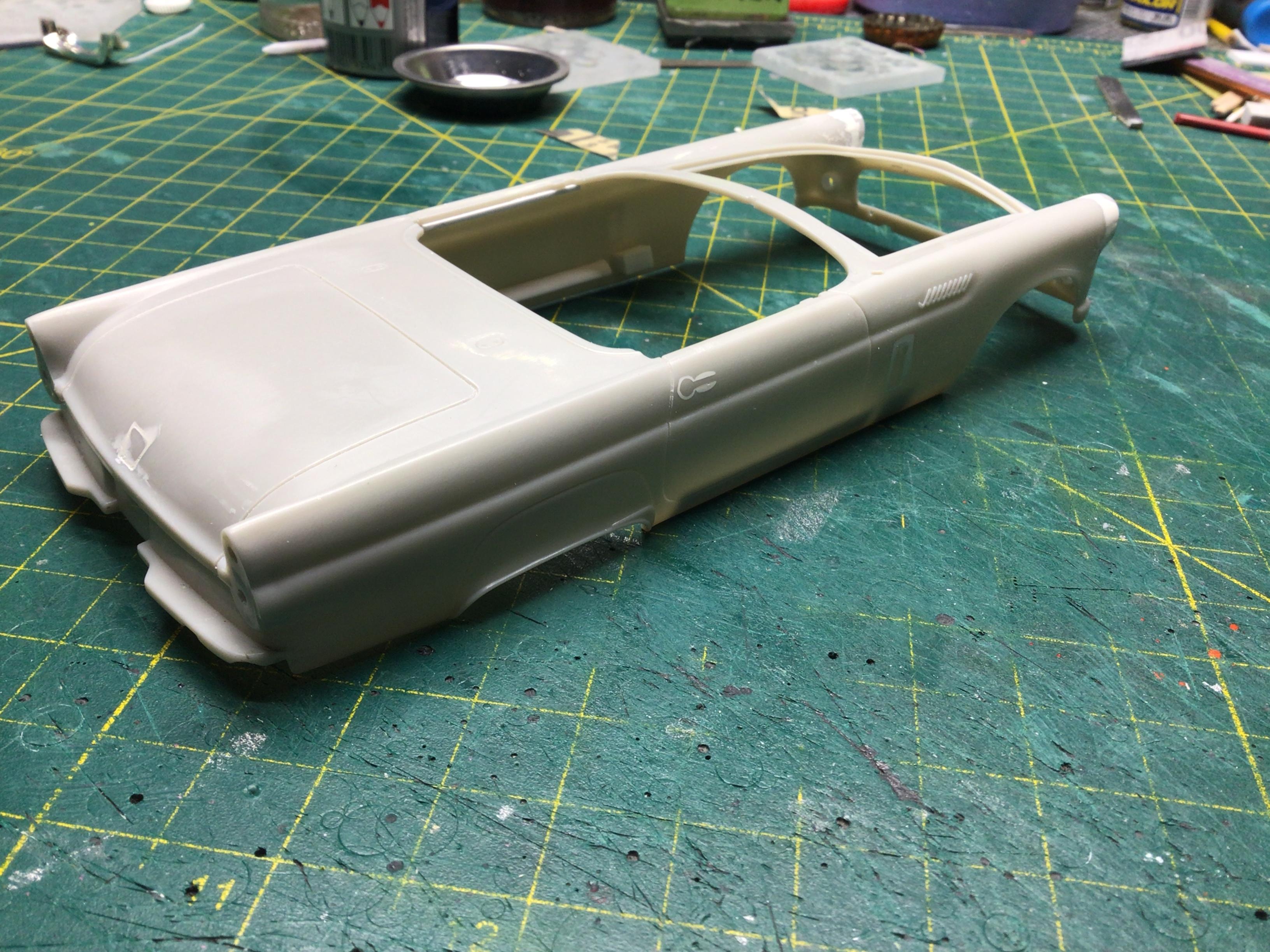

Thanks John. And thanks Dave for posting that beautiful piece of artwork!😬 I was going to leave the body mostly stock…..but now I am trying to emulate that beauty.🤪 I have shaved the door handles and script, and filled in all the creases. I haven’t decided whether to remove the fender skirts yet?🤔

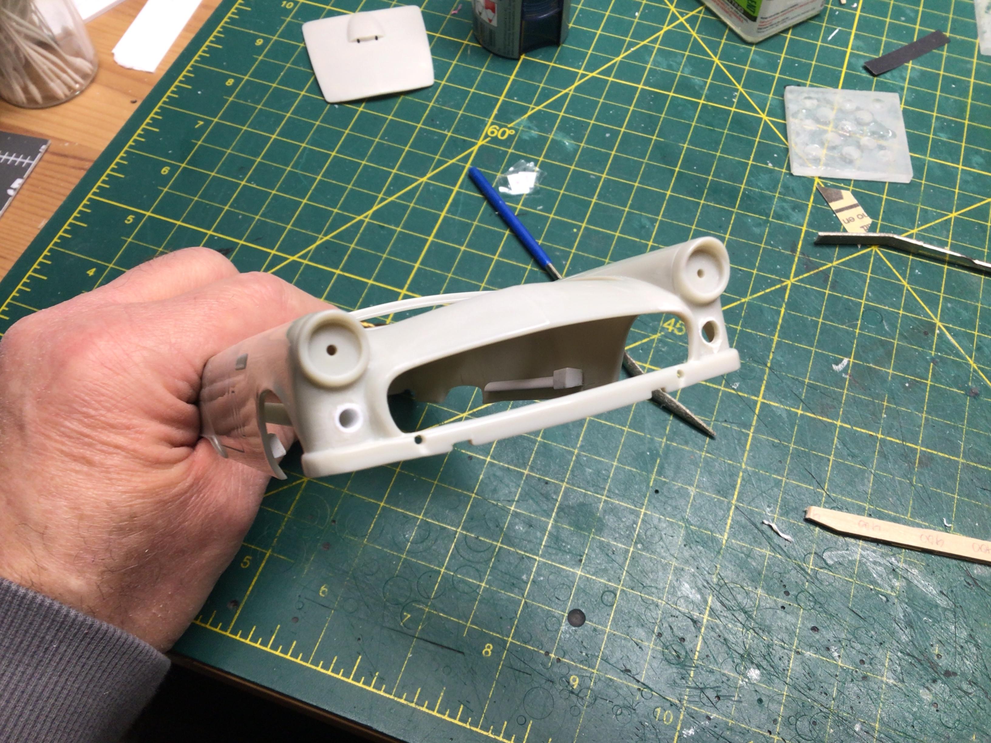

I decided to more or less french the front turn signals.

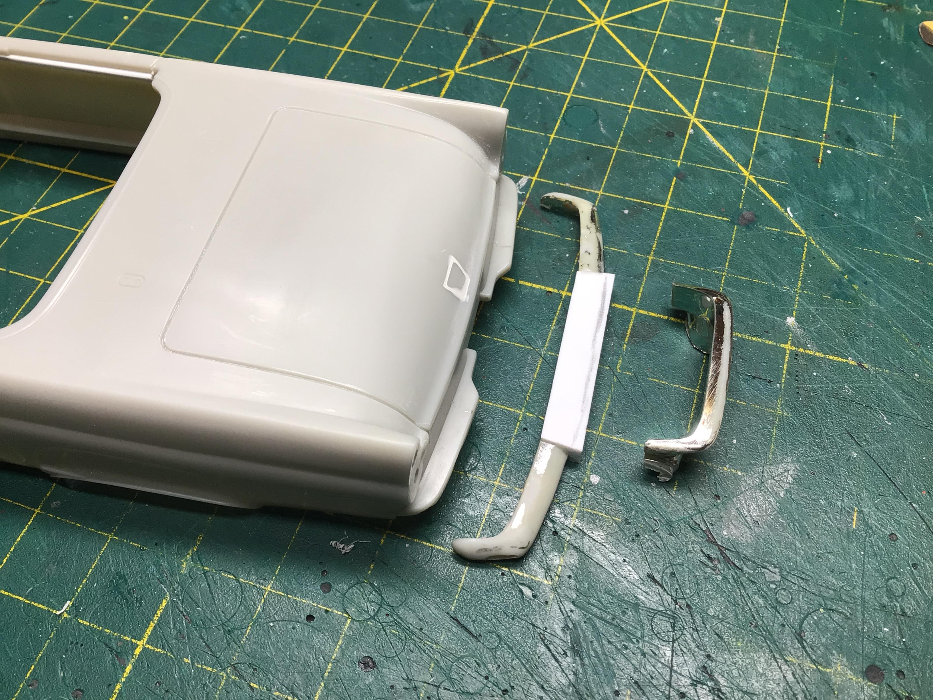

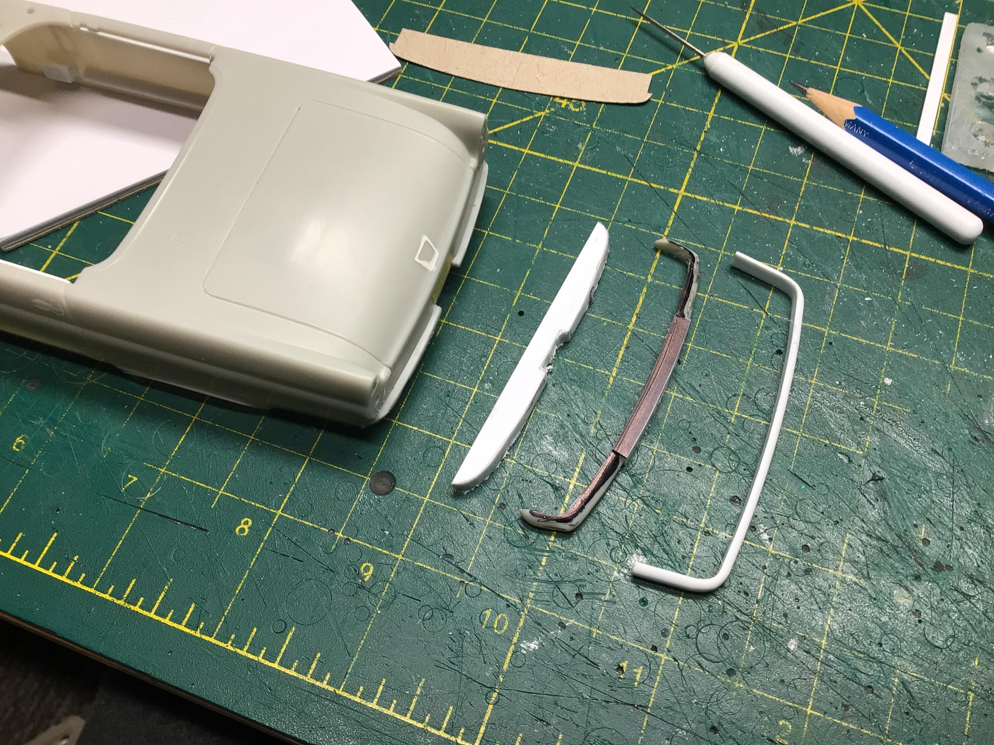

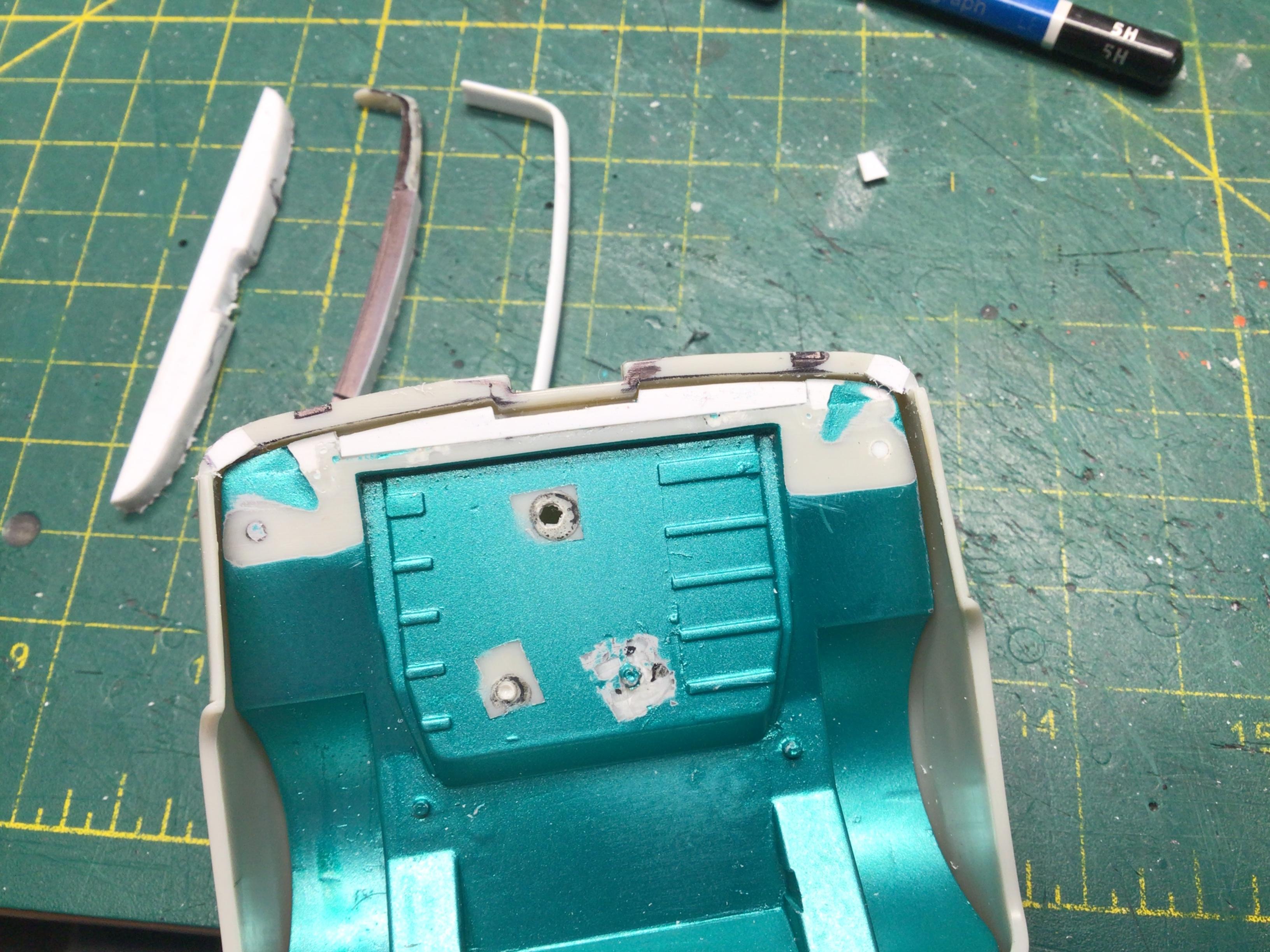

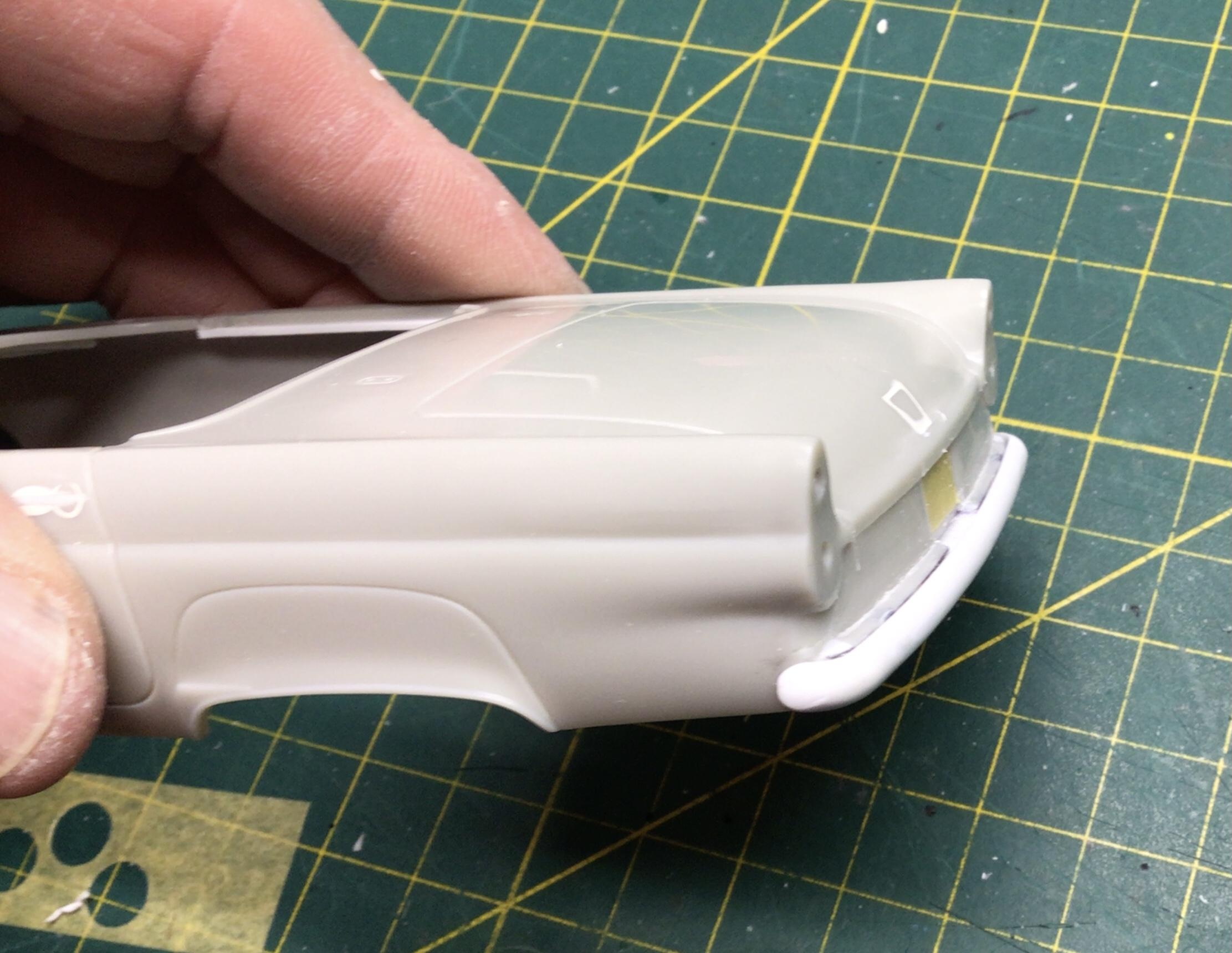

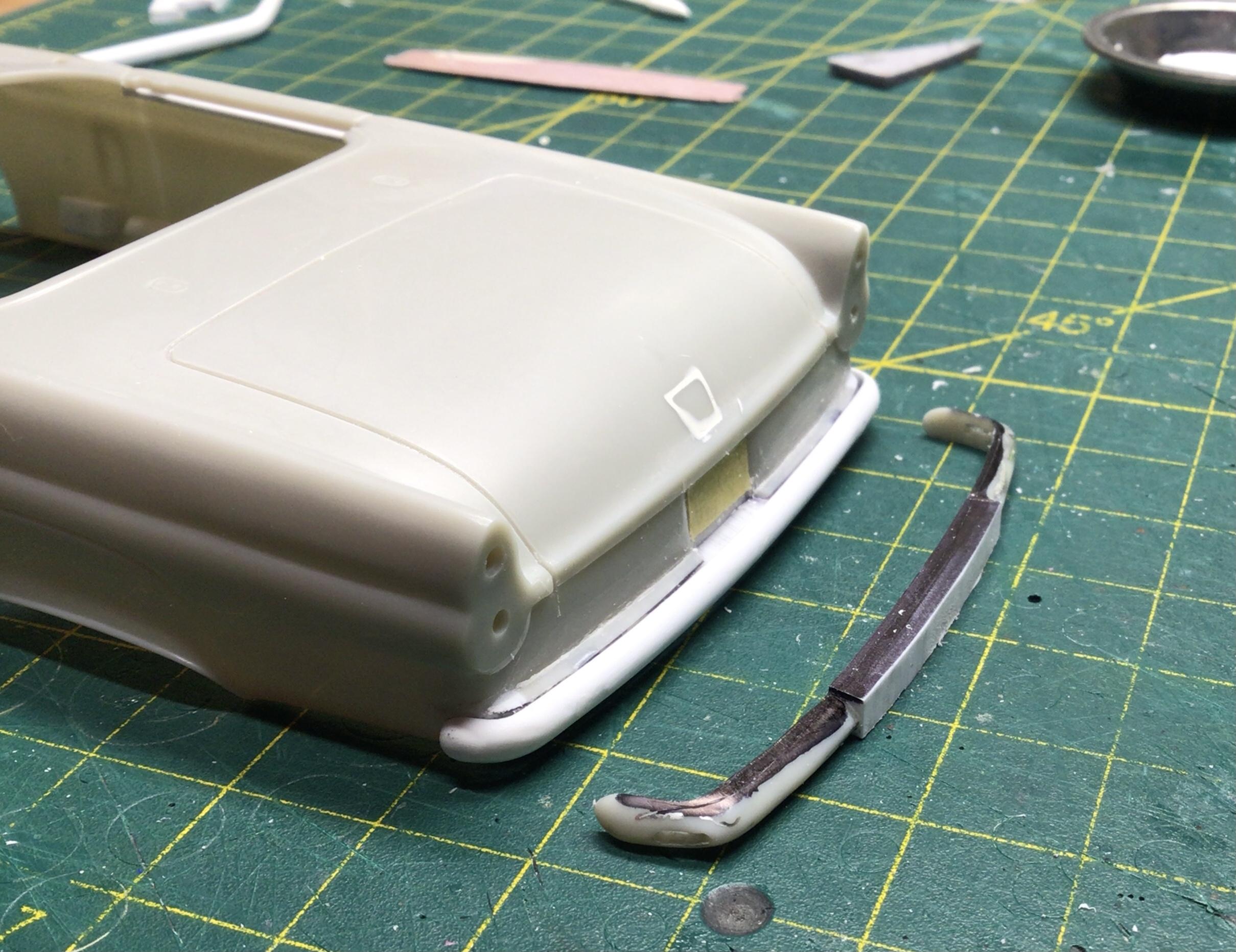

Now I am removing the continental spare and started to fix the bumper….but I will likely wind up making a complete bumper from 0.156” half round?
I want to lower the bumper just a tad and need to add a roll pan underneath, so this is where I’m at. A bit of filing and shaping to be done now.😎
Edited by NOBLNG

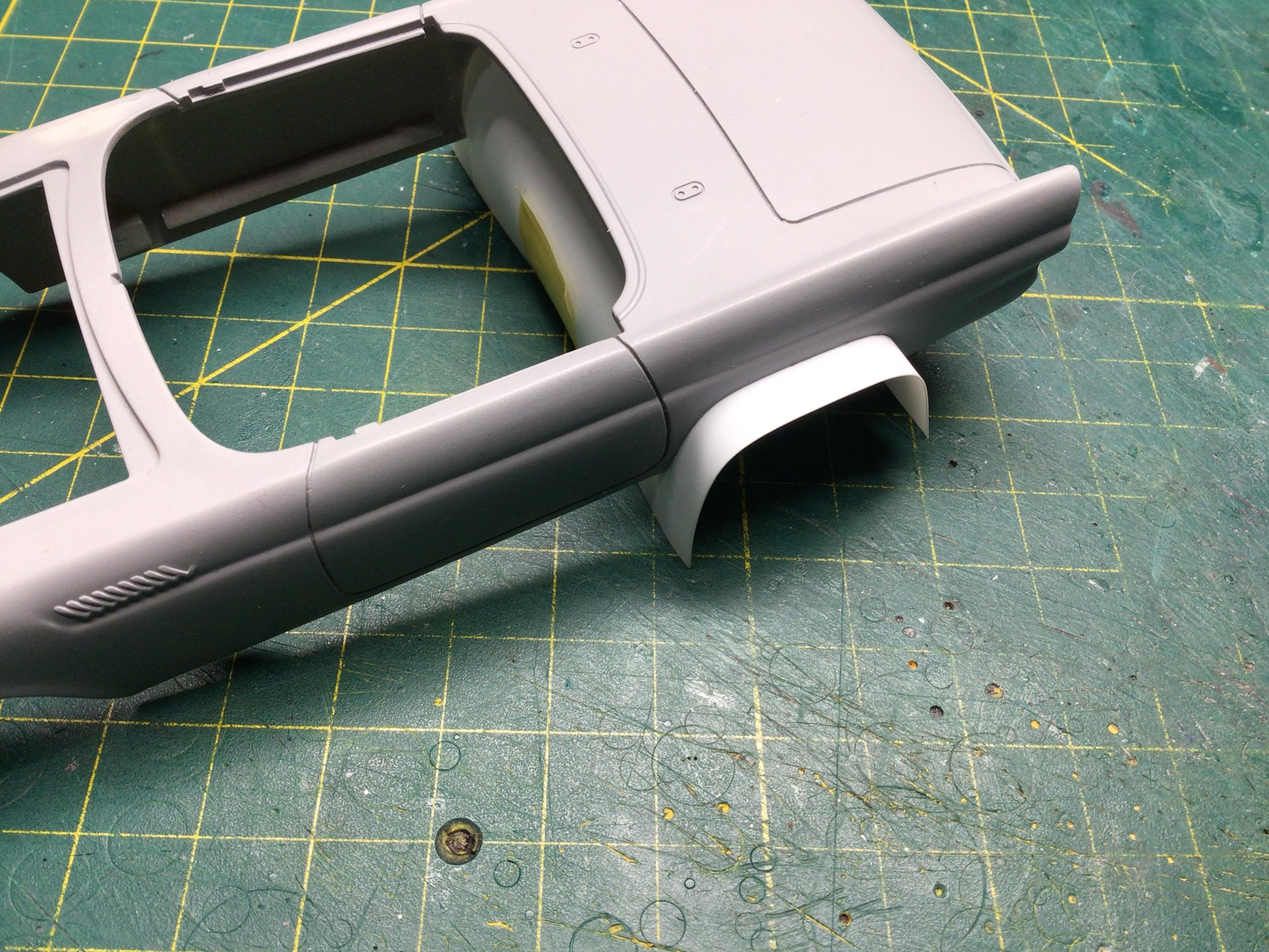

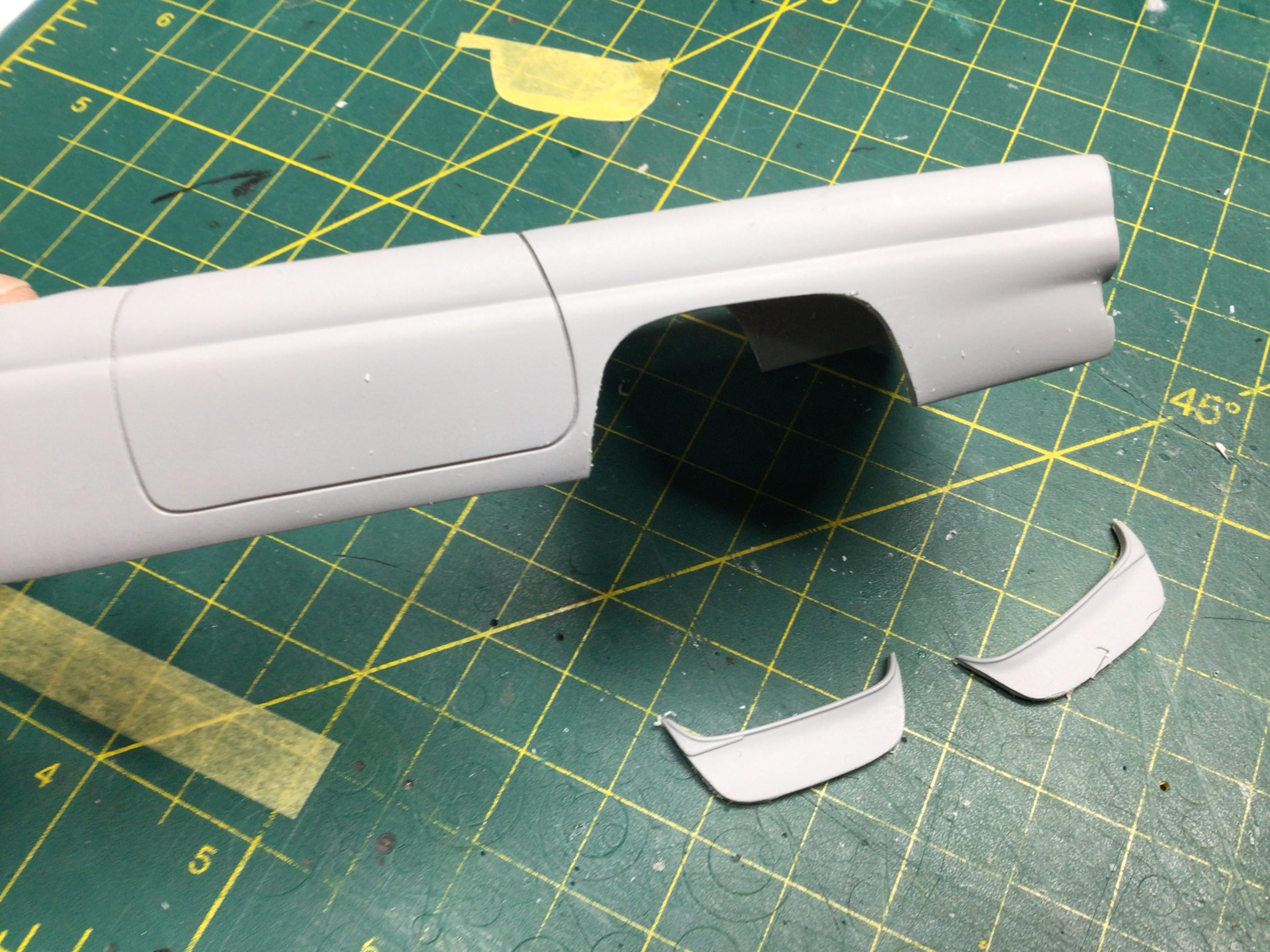

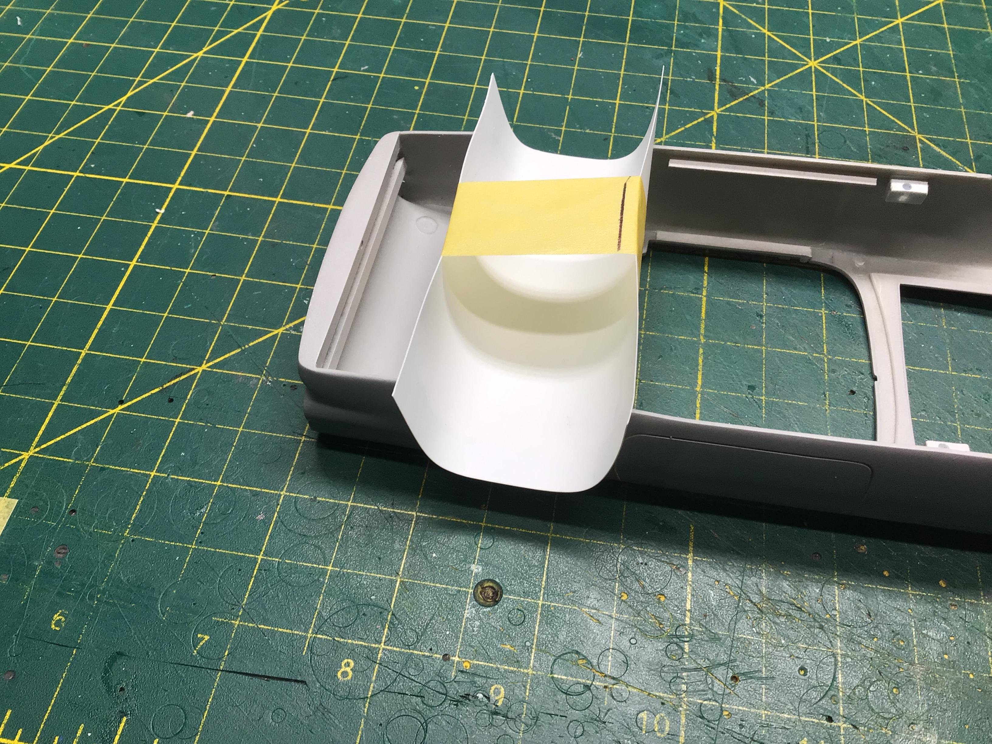

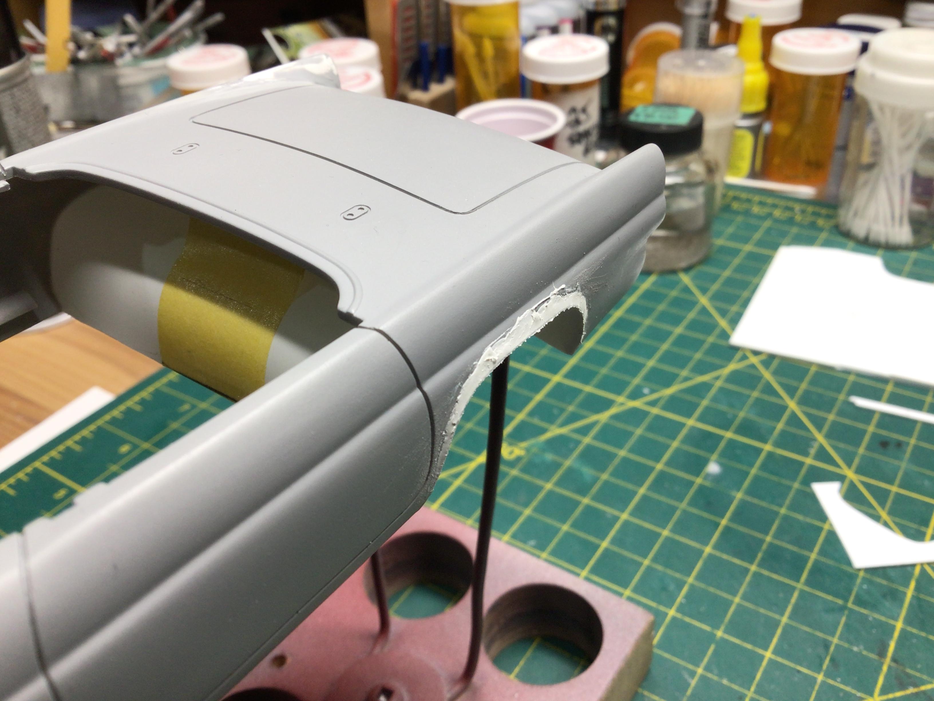

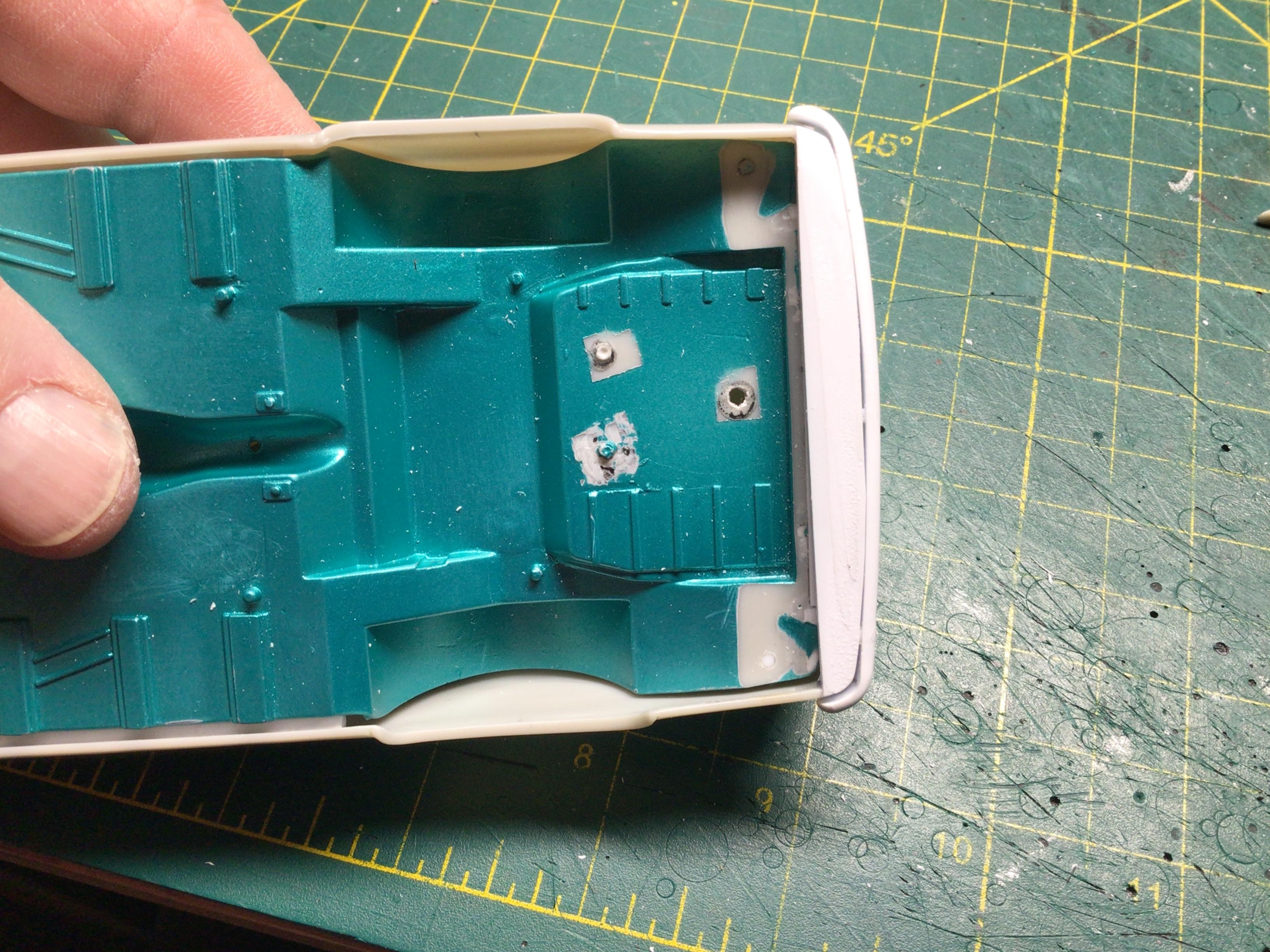

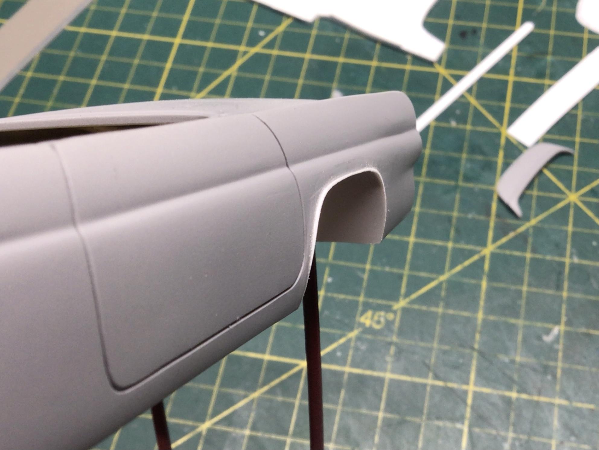

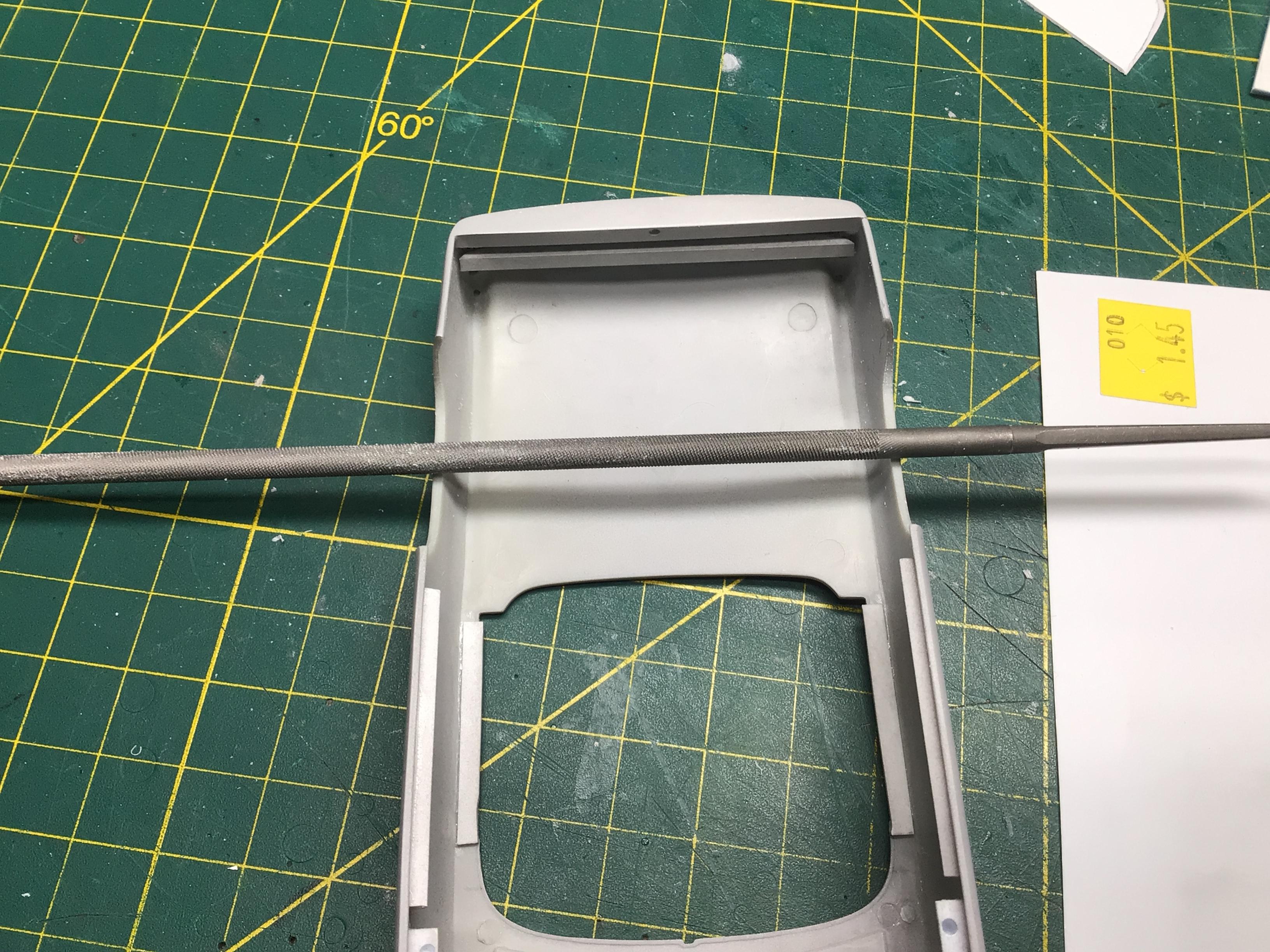

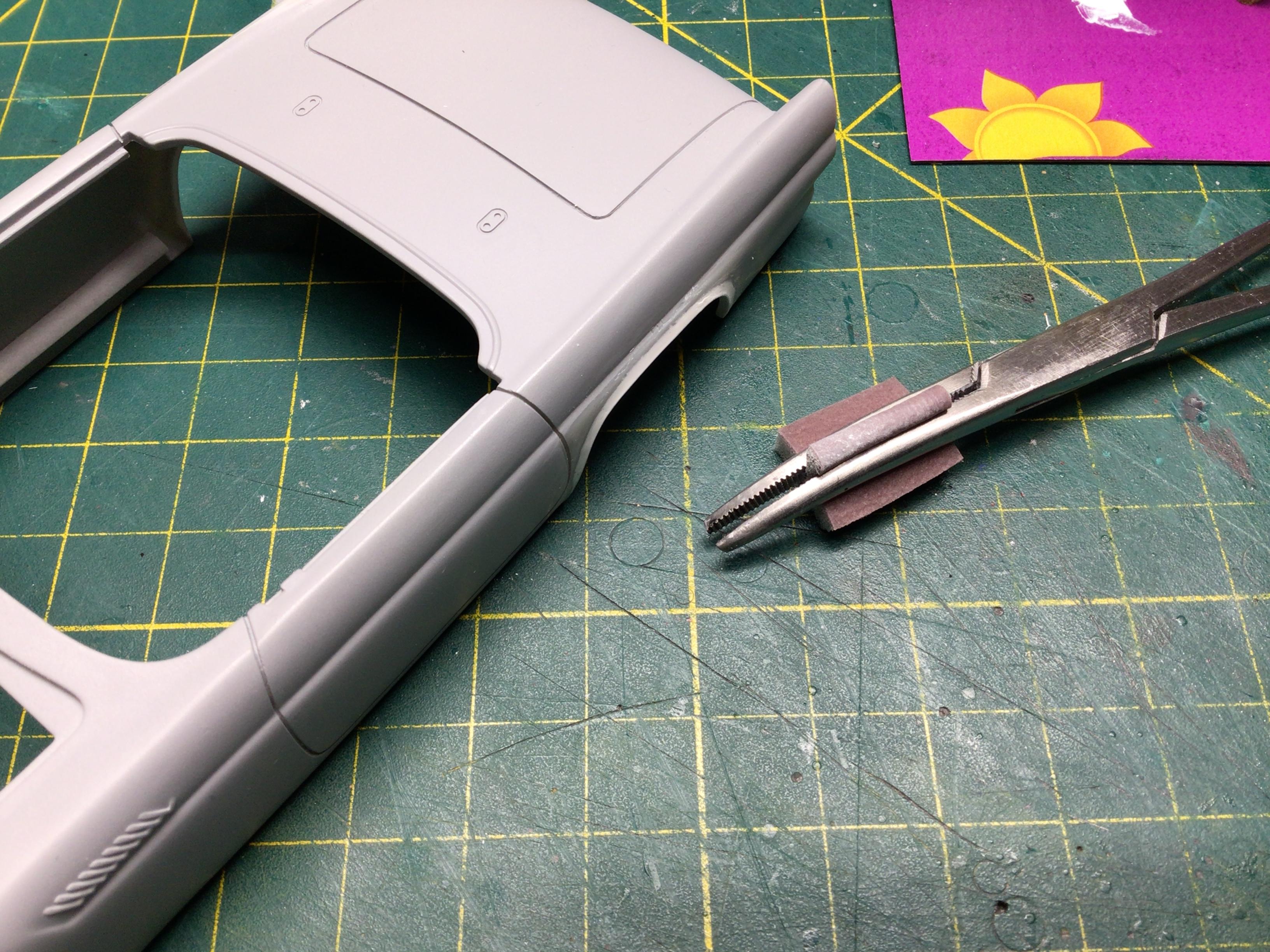

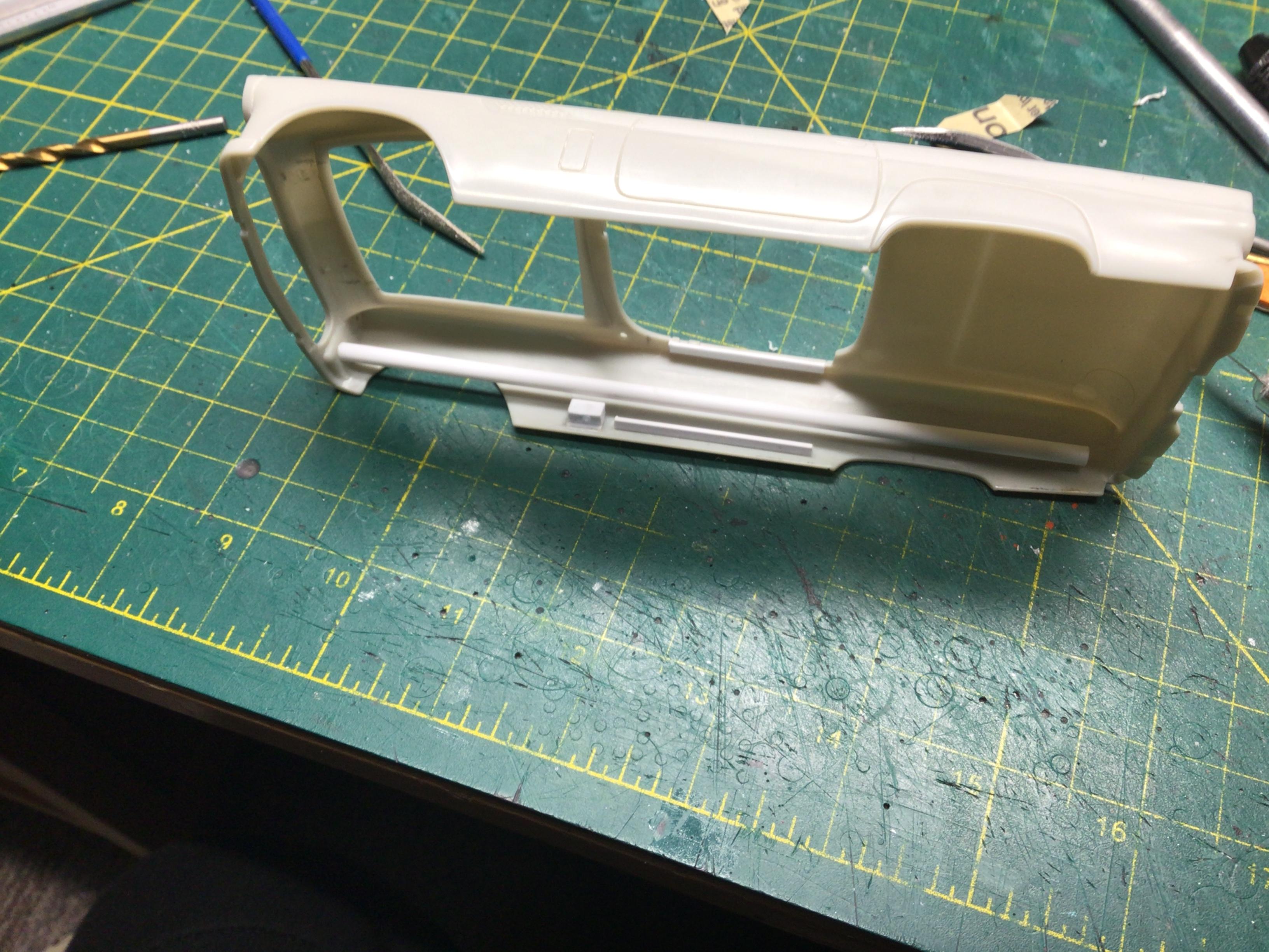

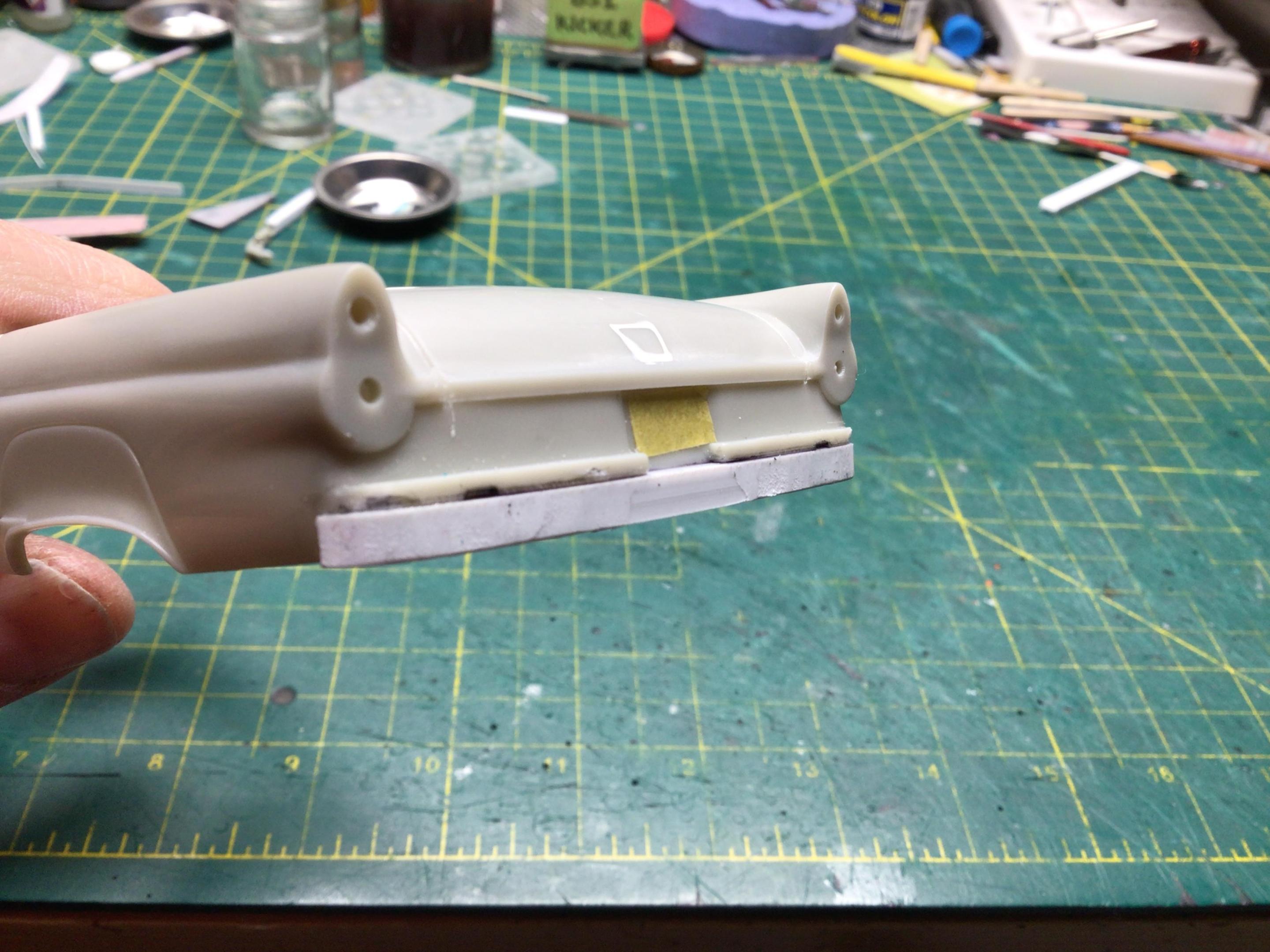

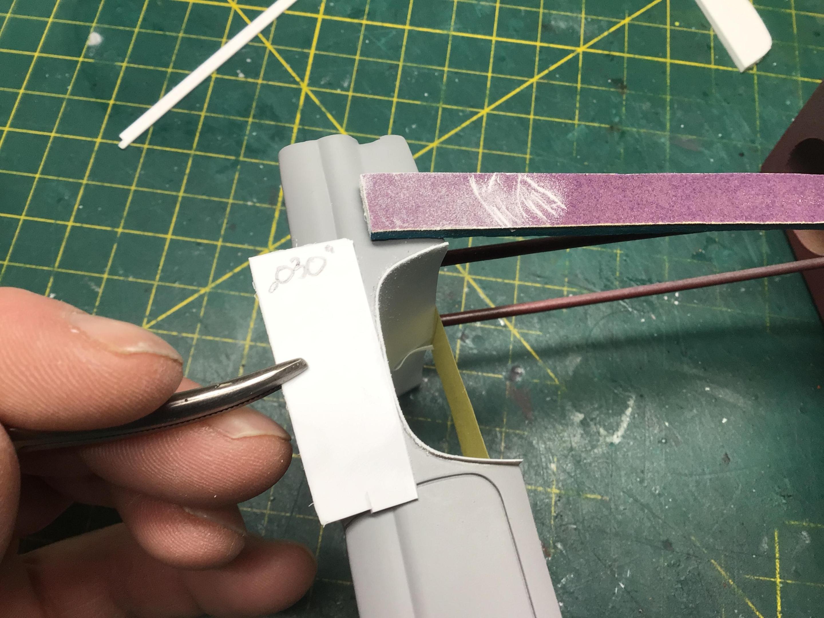

I’ve been tinkering with this one a bit, and decided to remove the fender skirts. I didn’t like the raw fender openings though and felt that they needed a flare to match the front. At first I traced the opening and tried cutting some flares from sheet stock…but It wasn’t working out.😕 Then I came up with this idea. I glued a half round “tube” of .010” styrene sheet across the rear fender openings. Then I completed both flares on the outside before cutting away the excess in the center. The pics explain it better I think.🙂
Edited by NOBLNG

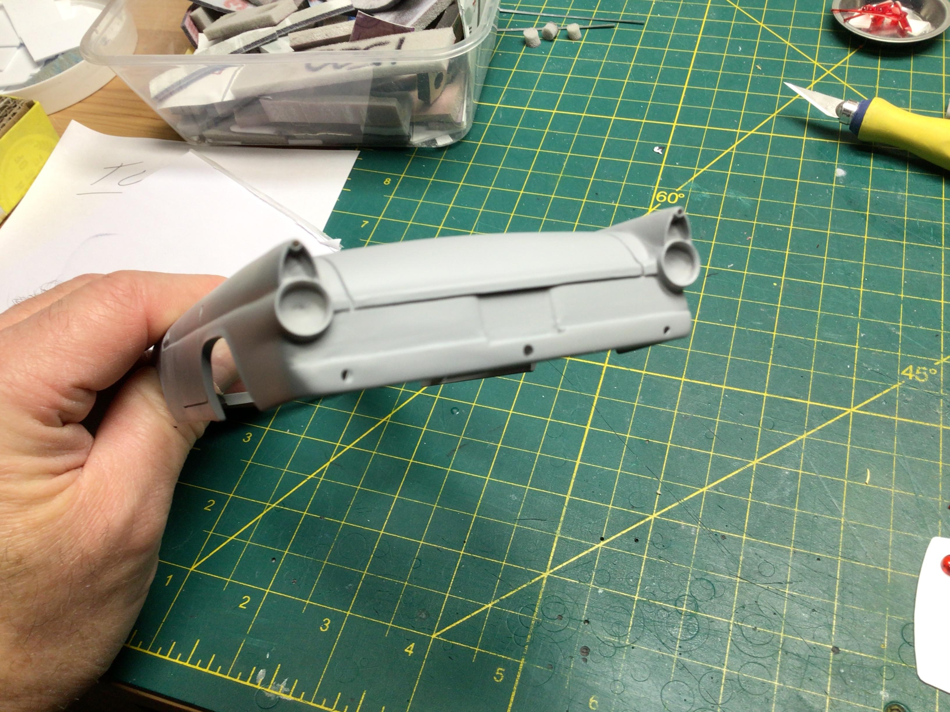

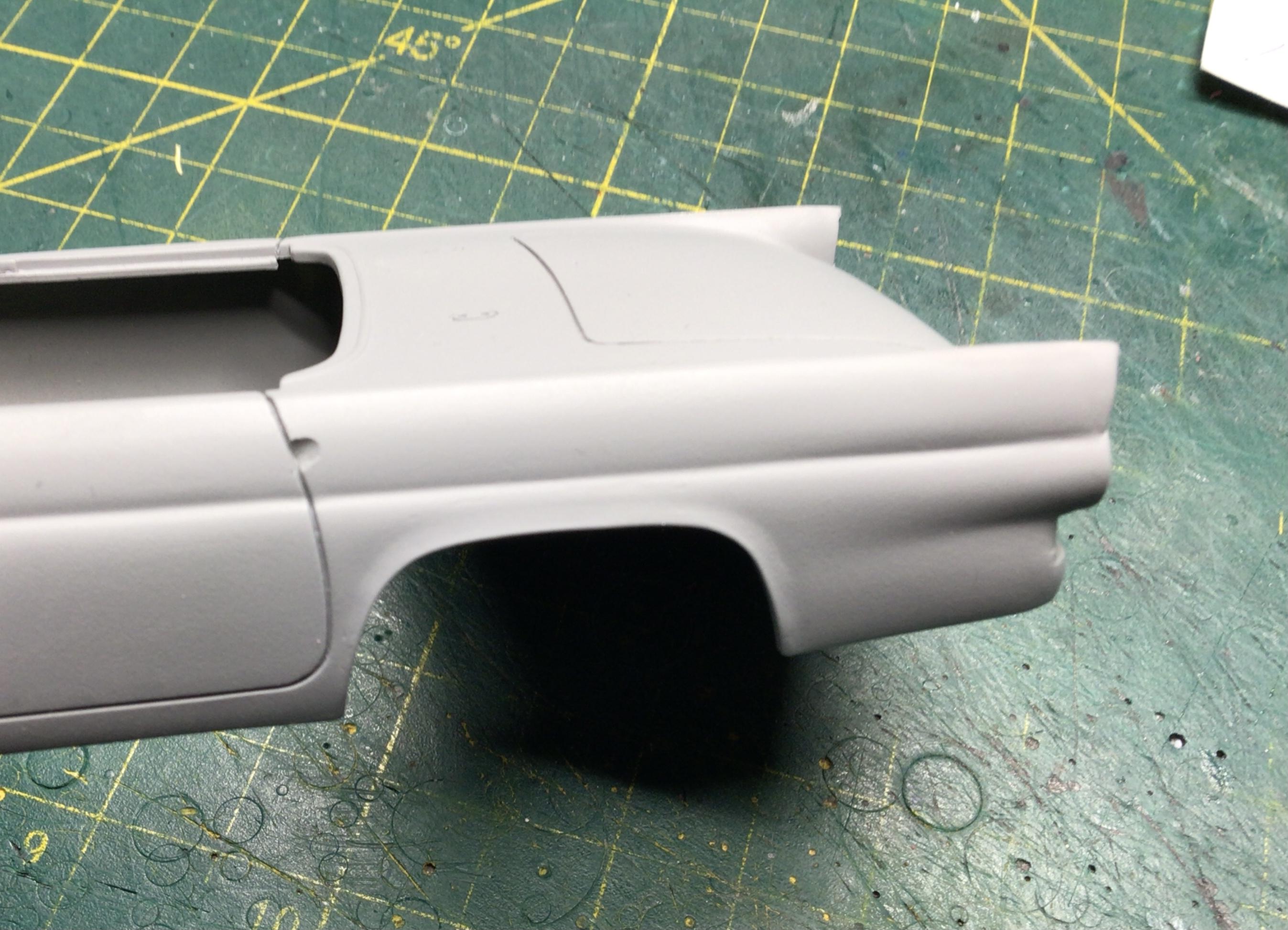

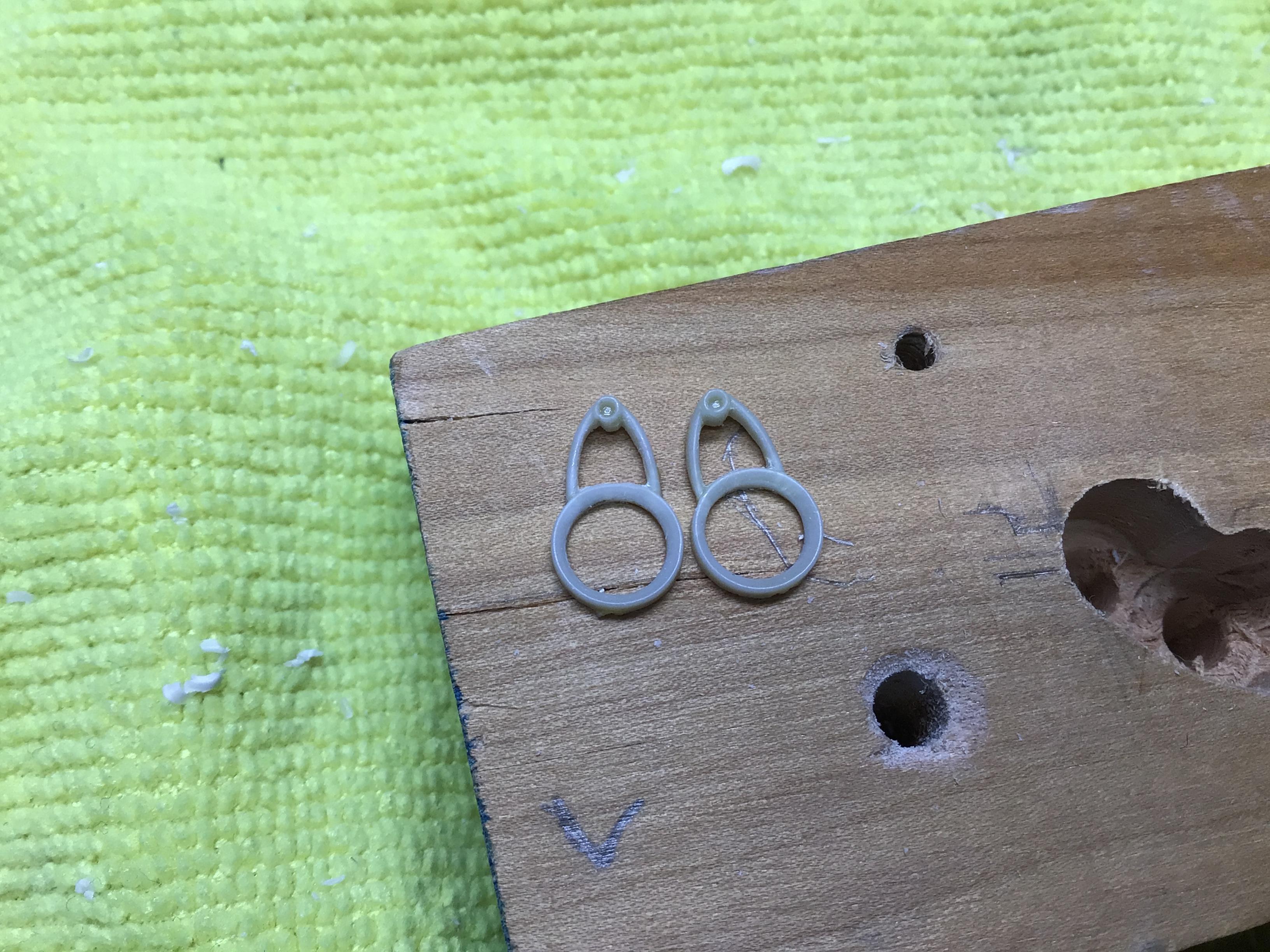

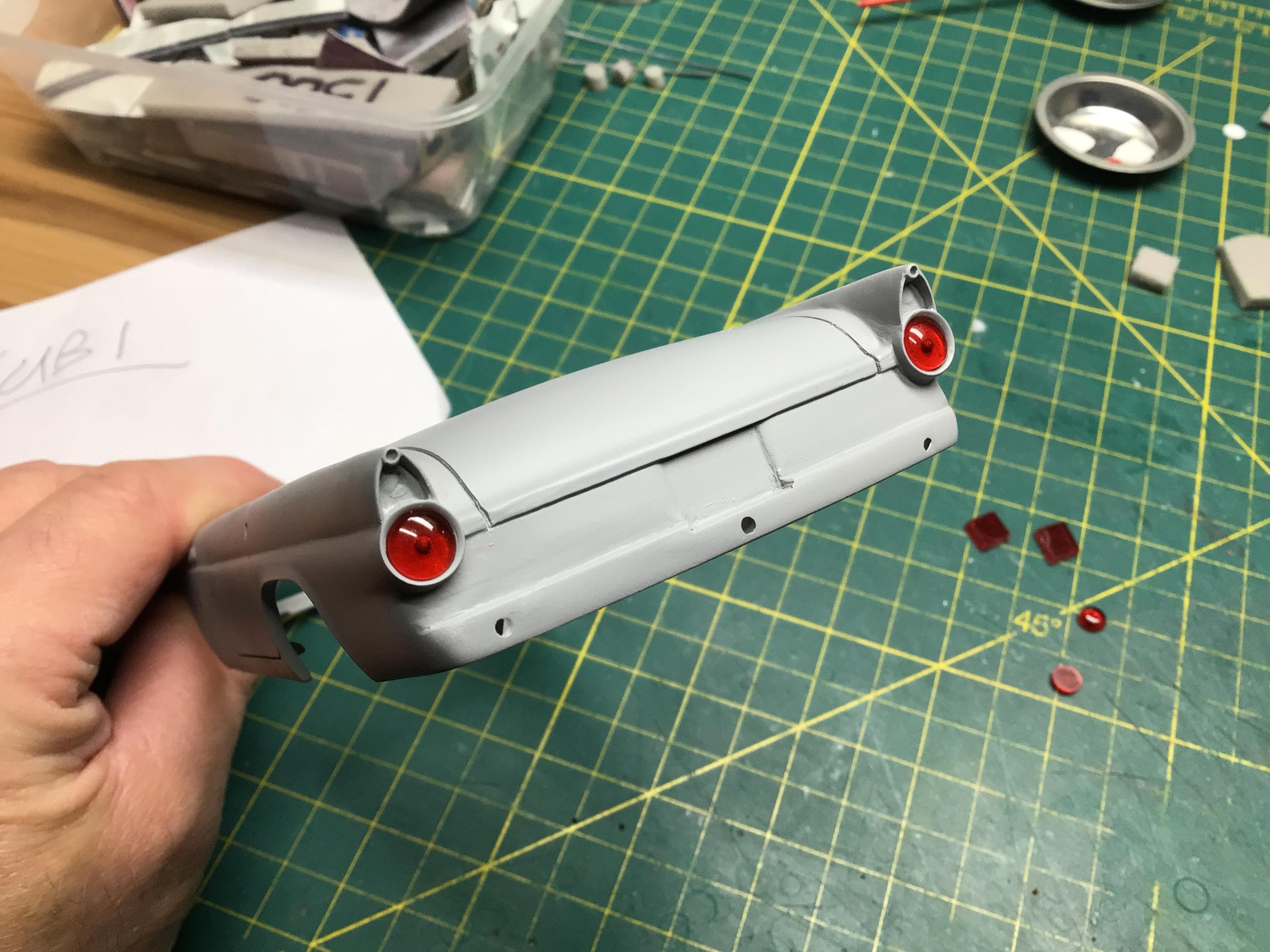

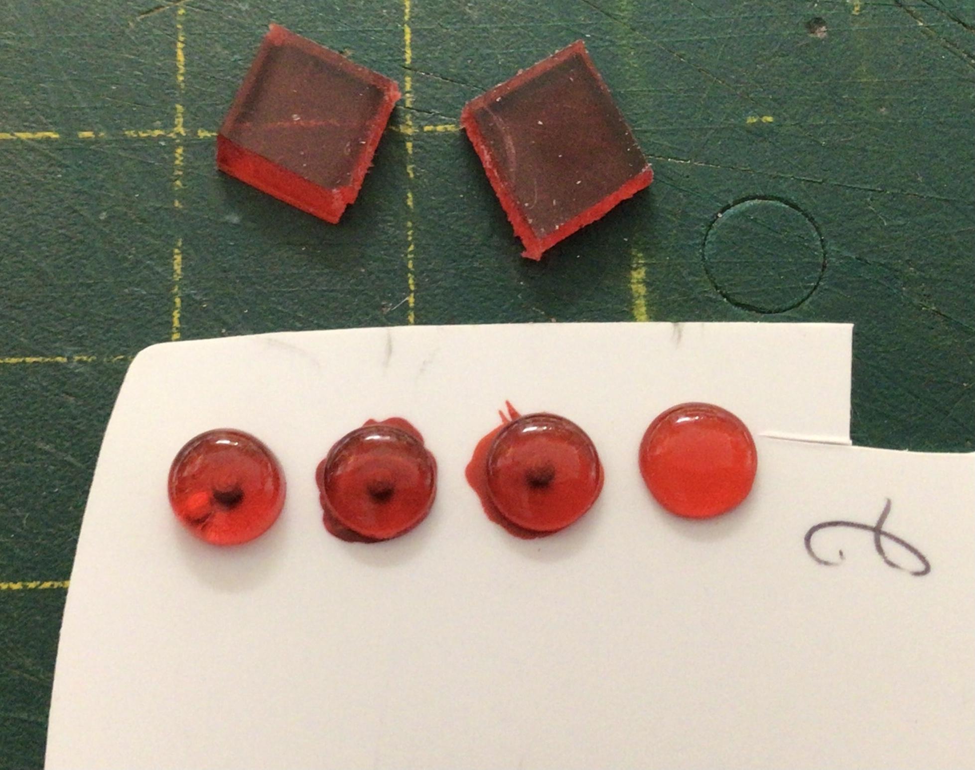

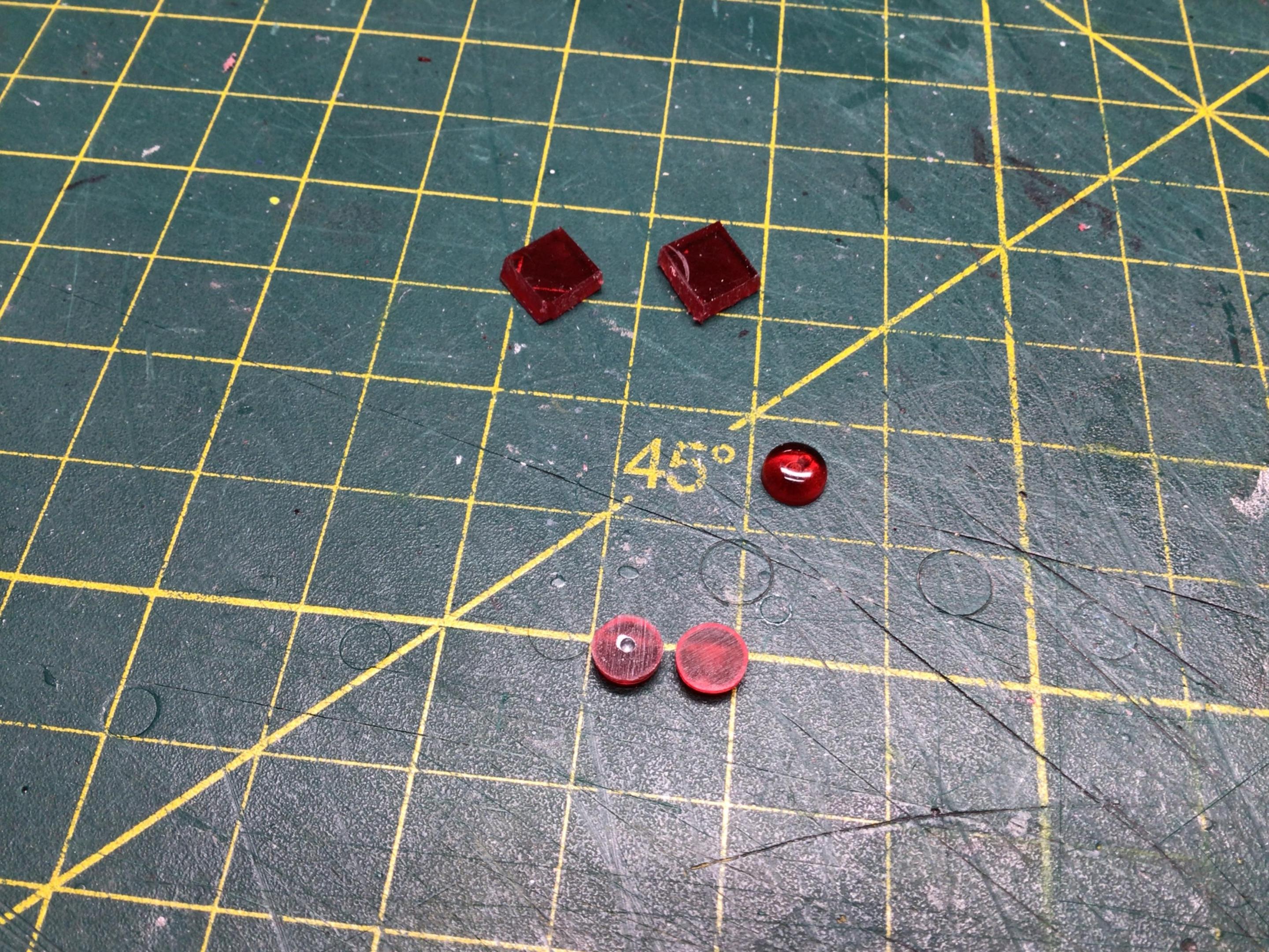

I also stripped the rear taillight bezels, drilled them out, and molded them into the fenders. Then I made some new lens from a busted taillight I found somewhere.🤪 They are a bit too transparent, so I will eventually “glue” them in place with some dark red paint I think.🧐 The backup light lens I plan to make from a water bottle cap.🤔
Edited by NOBLNG
  • Like 3

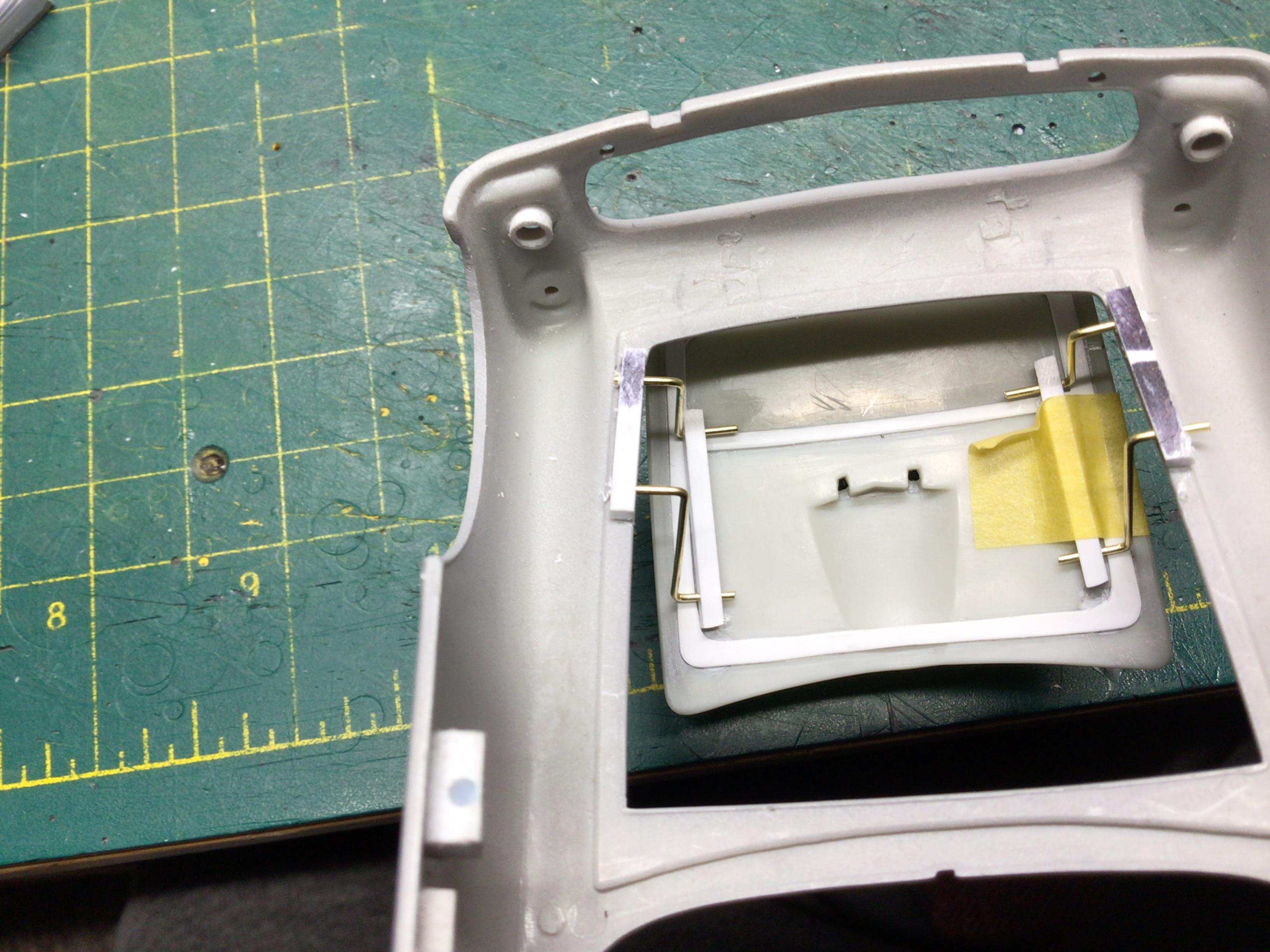

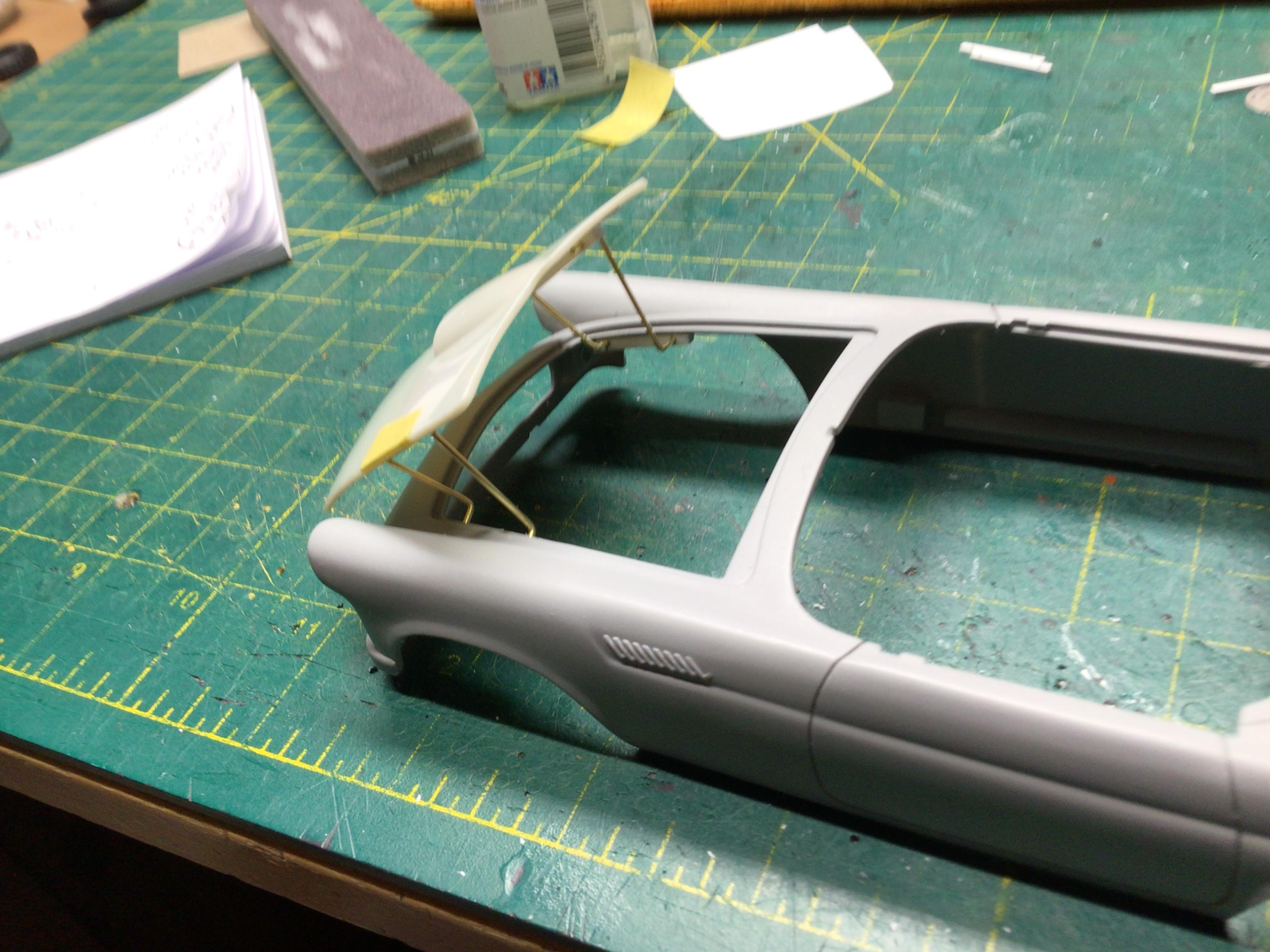

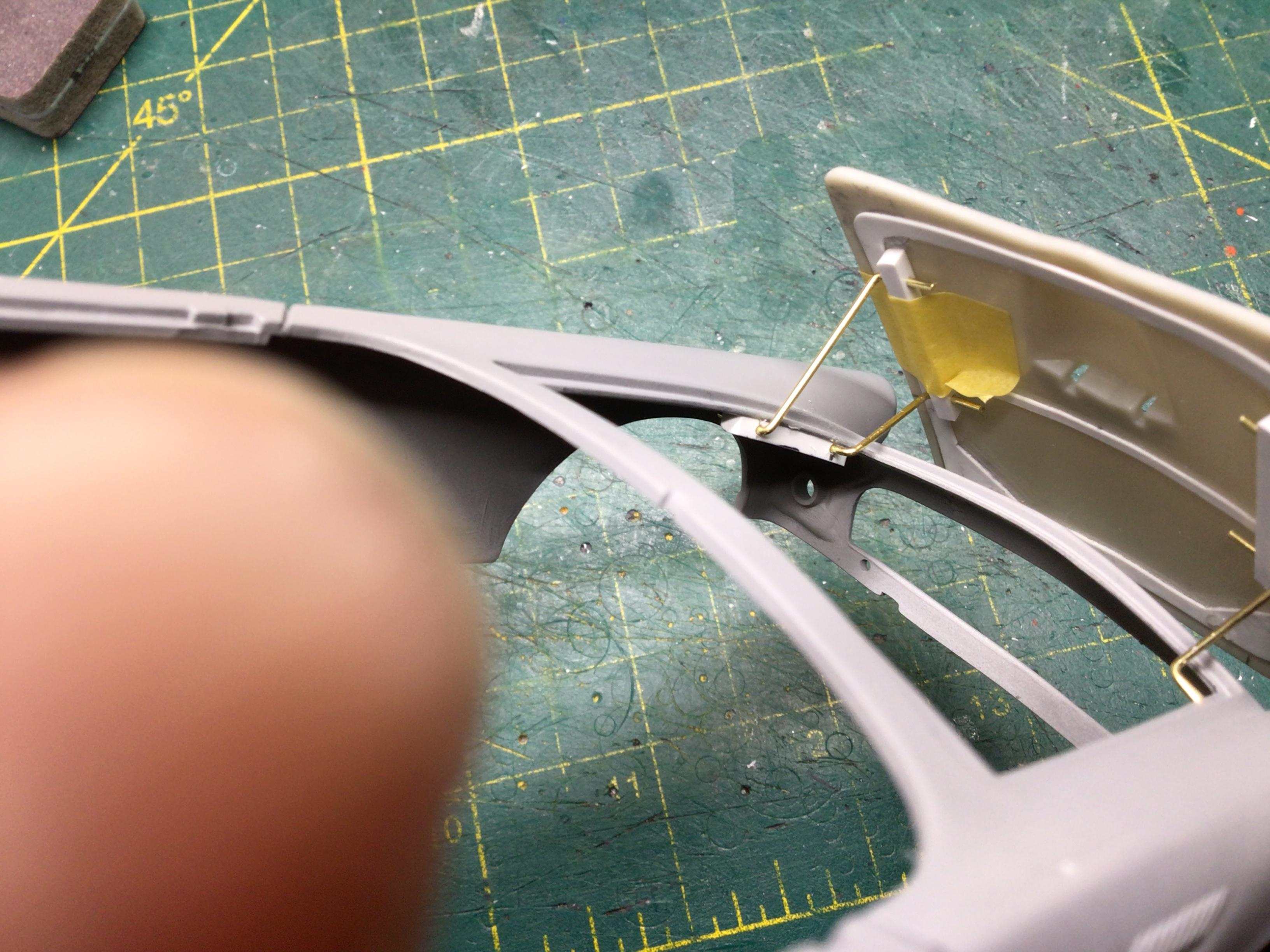

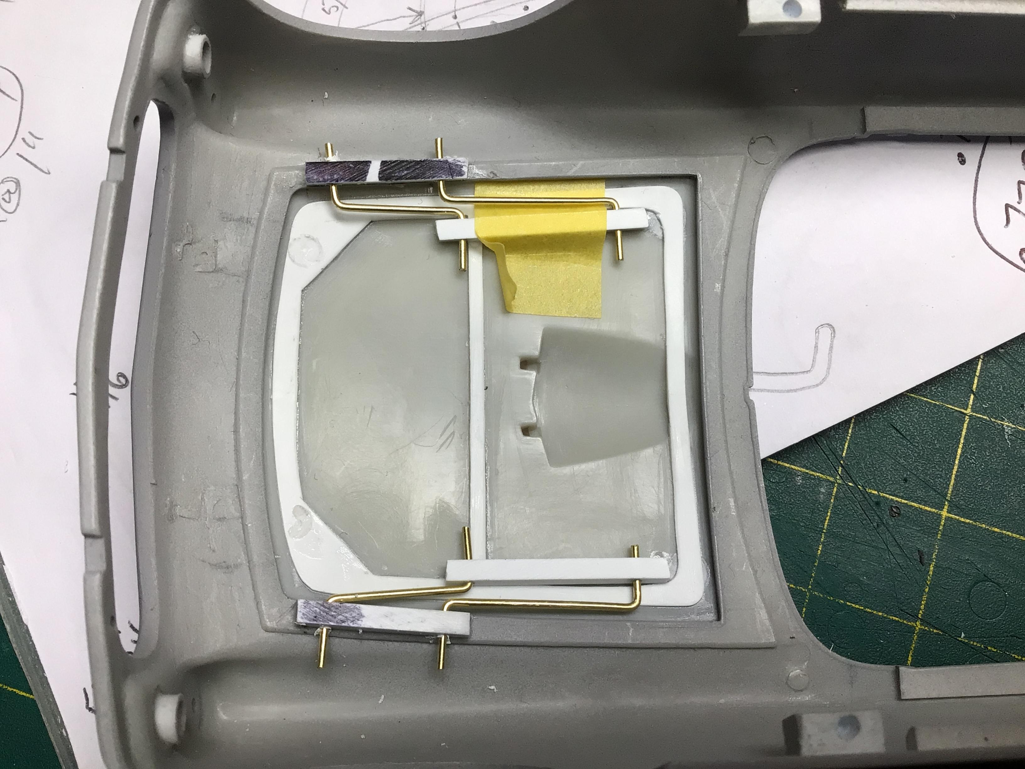

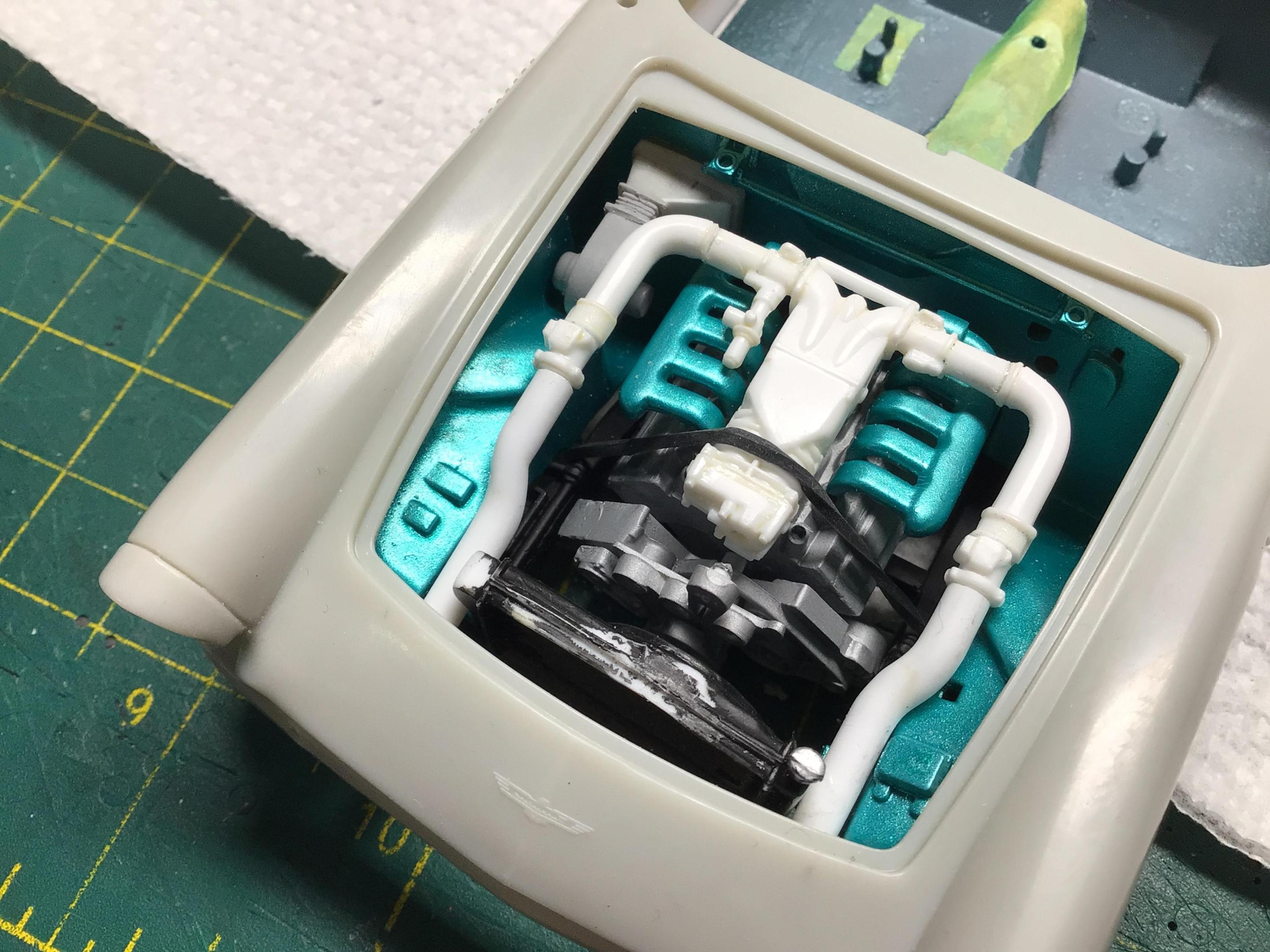

I‘ve also been toying with hood hinges. I’d like to do a set similar to what I saw on Rod’s ‘55 Chevy at the last club meeting.🙂 I realize that the pivot points will need to be parallel, and this whole apparatus would need to be downsized a fair bit, but I’m not sure even then if I have enough free space under the hood once the engine is back in place.🧐  I’ll keep playing with it between other projects…thanks for lookin’!🤪
Edit: If anyone has pics of this type of hinge setup or links to a tutorial…please post ‘em up. Thx!🙂
Edited by NOBLNG
  • Like 1

7 minutes ago, Slotto said:
Nice engineering on that hood hinge!
Thanks, but they don’t actually work properly as they are.🥴 I first need to build a better set… then determine if I even have space for them underhood.
