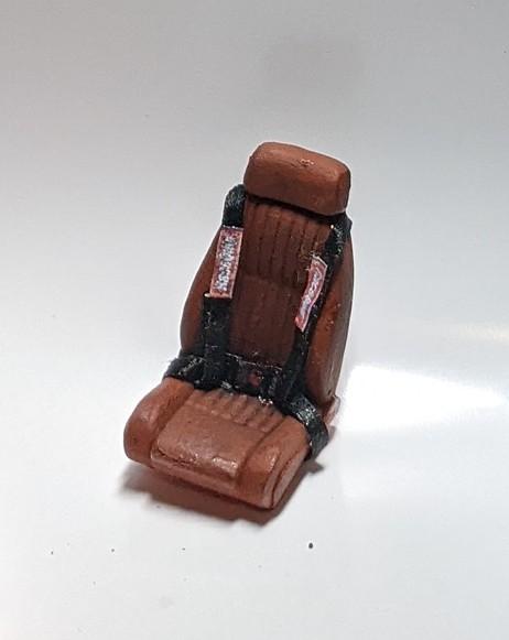

Beans Posted January 21, 2023 Posted January 21, 2023 It fits!! (With some minor modifications) And driver's seat is pretty much done. 2

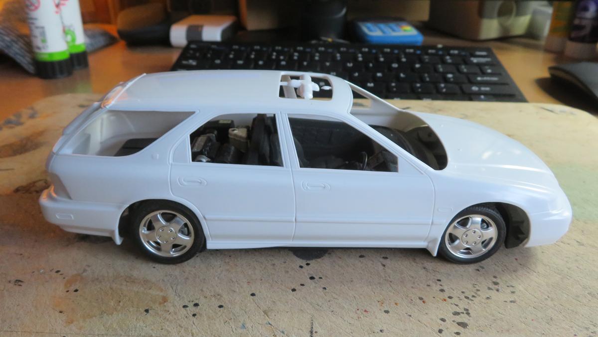

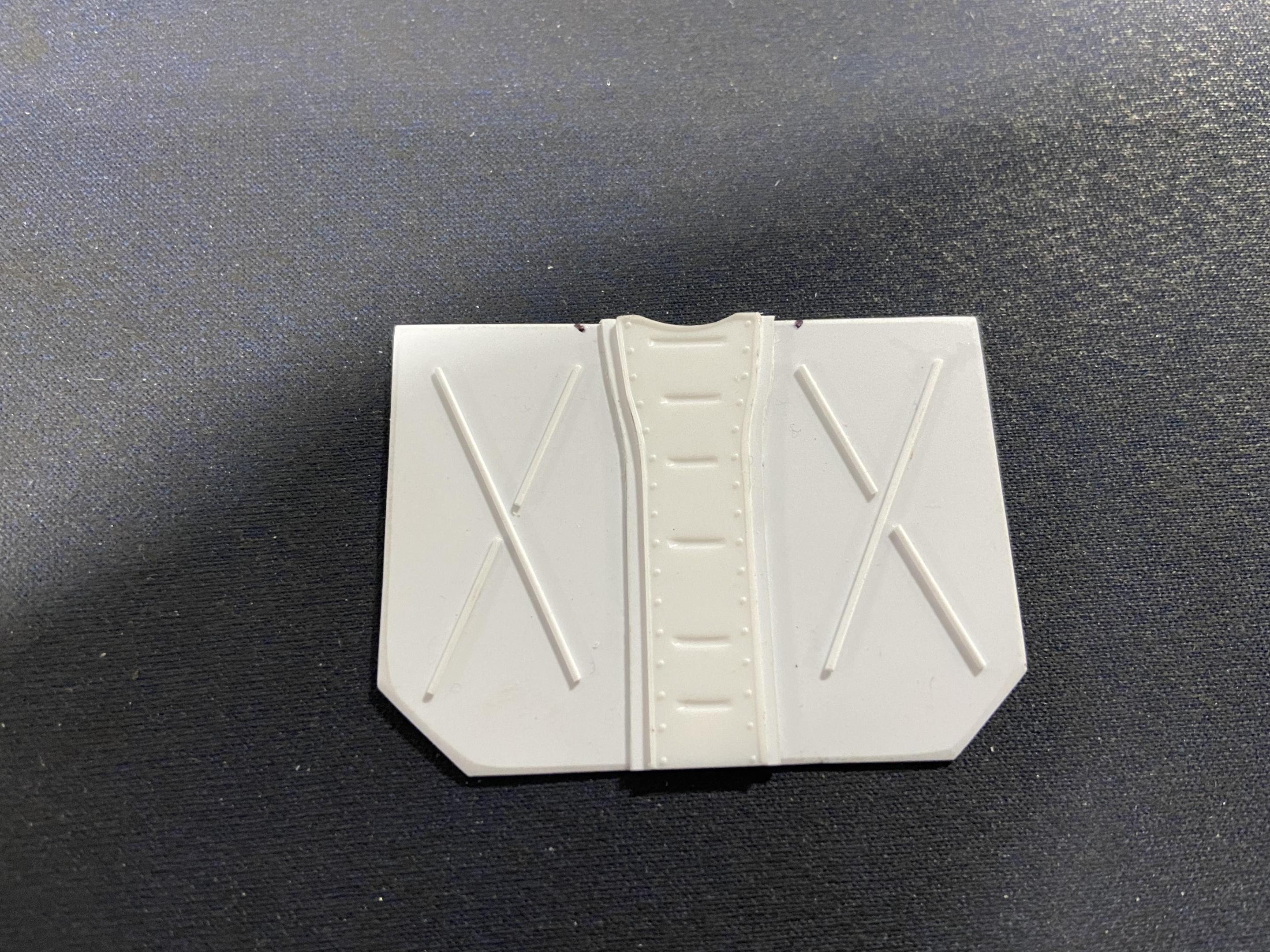

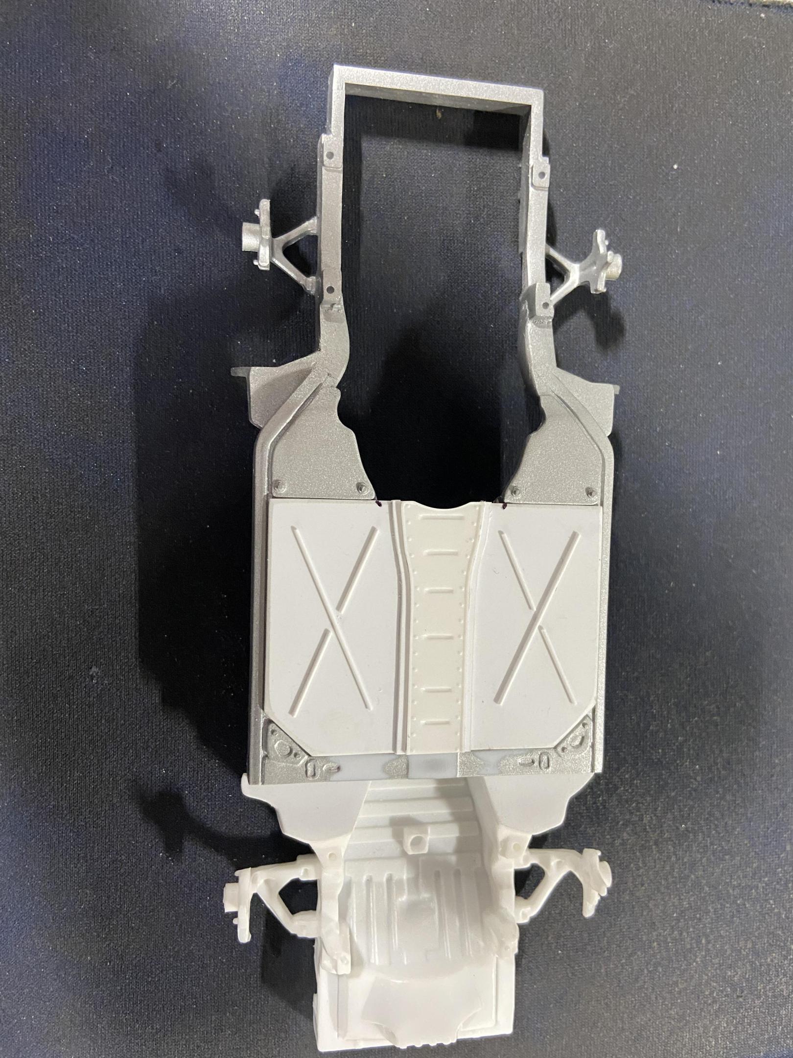

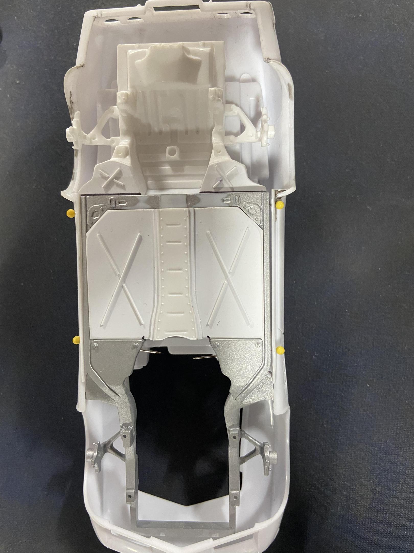

Spottedlaurel Posted January 22, 2023 Posted January 22, 2023 Great to see some progress being made on other builds. Wouldn't say I've started mine, but have done some useful planning this morning...... Working out how best to convert the Accord Wagon to take the NSX's mid-engine set-up. Helpfully I have the standard Tamiya NSX that I built back in the '90s to work things out, so I don't have to mock-up the new floorpan too much. Grey one is from NSX, black the Accord's. Online sources suggest a difference of 7.3" (185mm) between the two, which equates to just under 8mm at 1:24. Using the assembled car I measured similar. I had been looking to graft the Accord's front floorpan onto the NSX's rear end, but it looks simpler to stretch the NSX. I'll make the cut where marked above, which should be easy to recreate with a bit of sheet styrene. I also need to trim off the sides, then the width is just right to slot under the Accord. The floorpan stretch as I propose will bring the interior and dashboard forwards to the right place relative to the windshield: The gap between seat backs and engine will open up a bit, but that's no problem and it will give room for me to create some sort of enclosure. I think I'll use the NSX interior base, plus the LHD dashboard option which Tamiya helpfully include, but with the sides removed and replaced by those from the Accord (on the front doors at least). I have a rollcage from a Tamiya R32 Skyline racer which I'll use, the width and windshield rake are about right. That might donate some appropriate seats too. If it fits like this with no work then I think I should be fine. I really don't want to get into bodywork modifications, and the NSX suspension is giving it a suitably low ride height so I don't have to hack around the delicately detailed components. The most I might do is cut some small vents into the rear doors, below the rubbing strip. The NSX is fairly modest in that regard with a front-mounted radiator, so it doesn't need big vents. My version of the Accord doesn't have any bodykit options, but with it sitting so low I don't think it needs them and I prefer the low-key standard look, I might just add some form of splitter under the front bumper. Haven't yet worked out colour or wheel choices. Perhaps a dark metallic blue or green, something quite subtle. Wheel choice will be down to whatever suits the NSX brakes and suspension without too much modification. I suppose I could keep the standard NSX rims for an easy life, but I usually like to swap them. I've got one more current WIP to finish before I fully launch into this, but it's good to have something to start thinking about when I'm away from the bench. 5

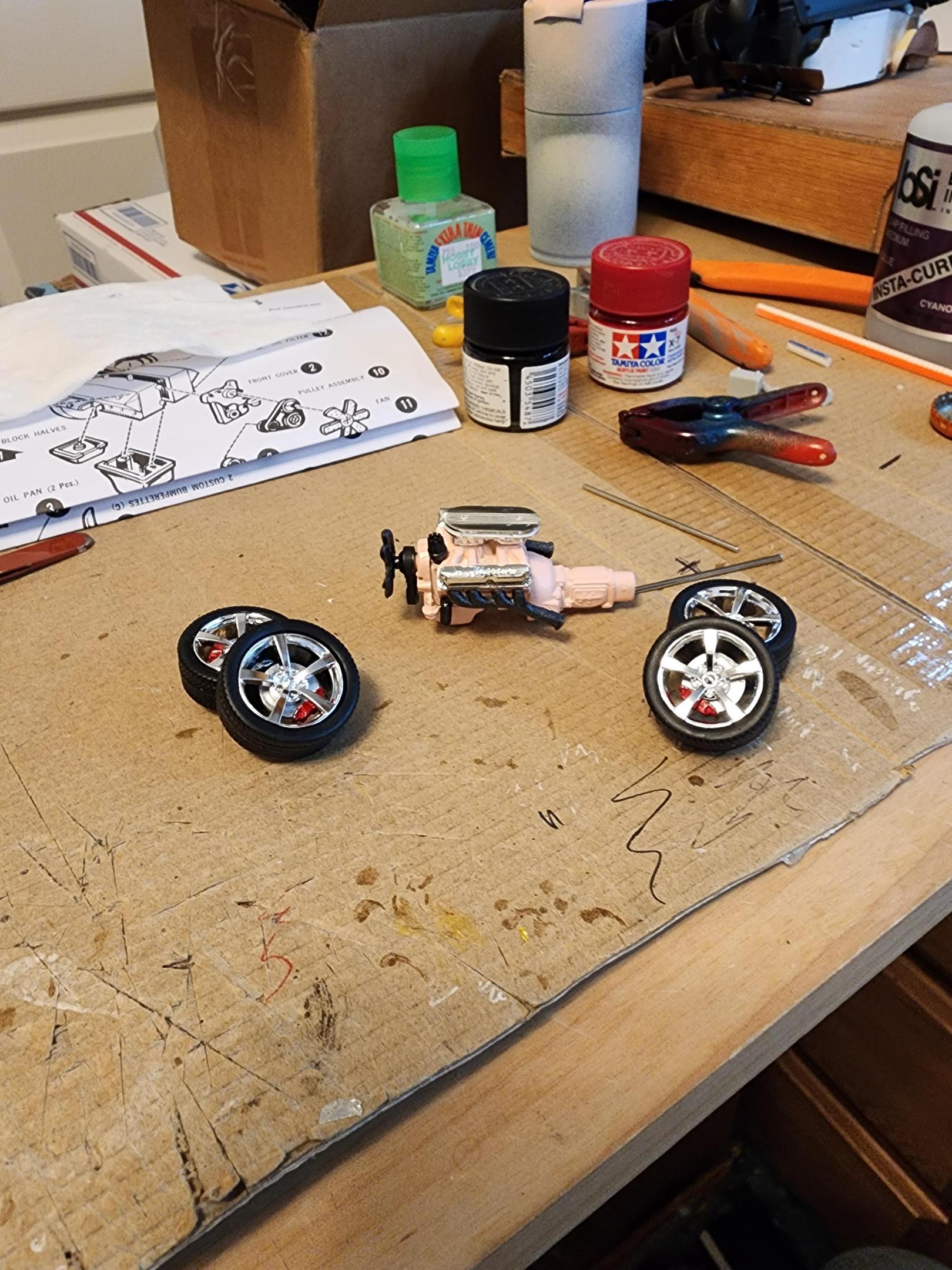

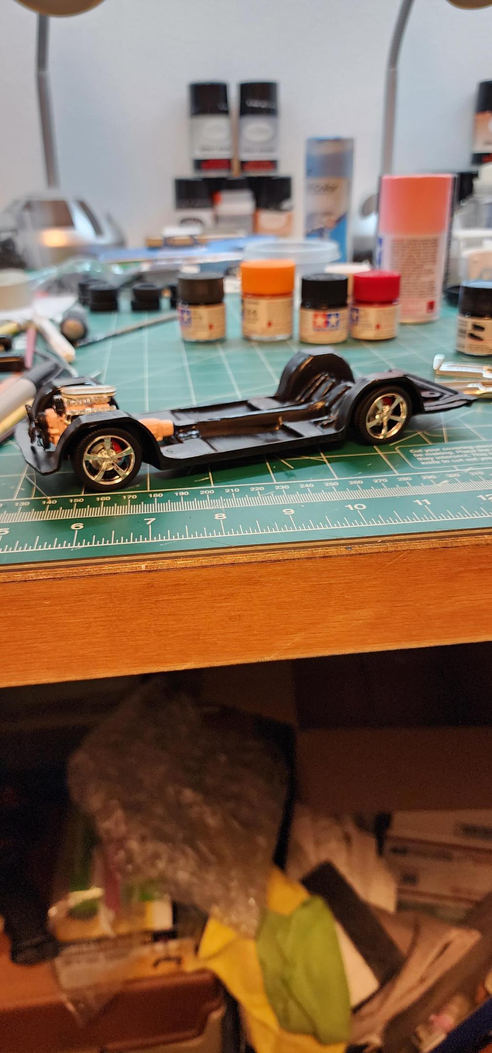

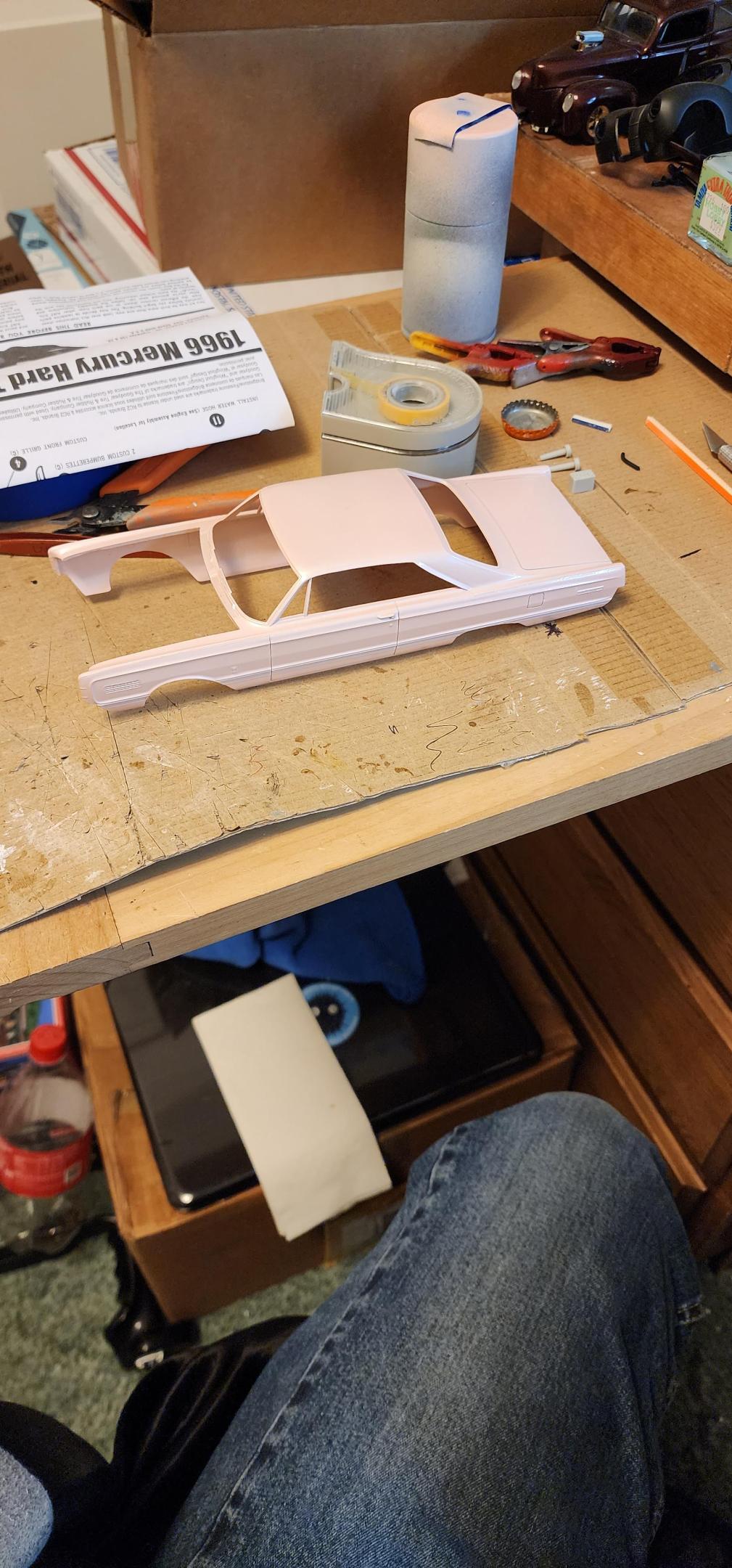

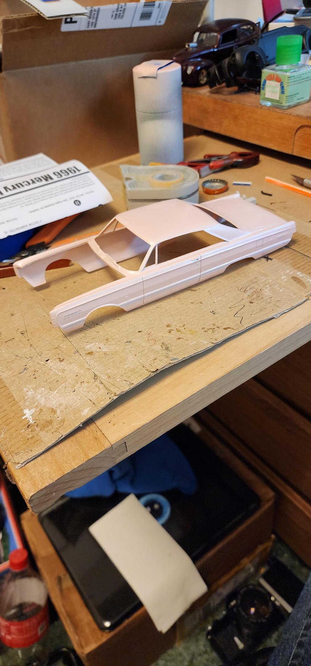

Sam I Am Posted January 29, 2023 Posted January 29, 2023 There is some great building going on, that's for sure. First posts, and I am building it as a 24hr build. Engine and wheels are assembled. Body is in the paint booth. Chassis plate is in the dehydrator. 2

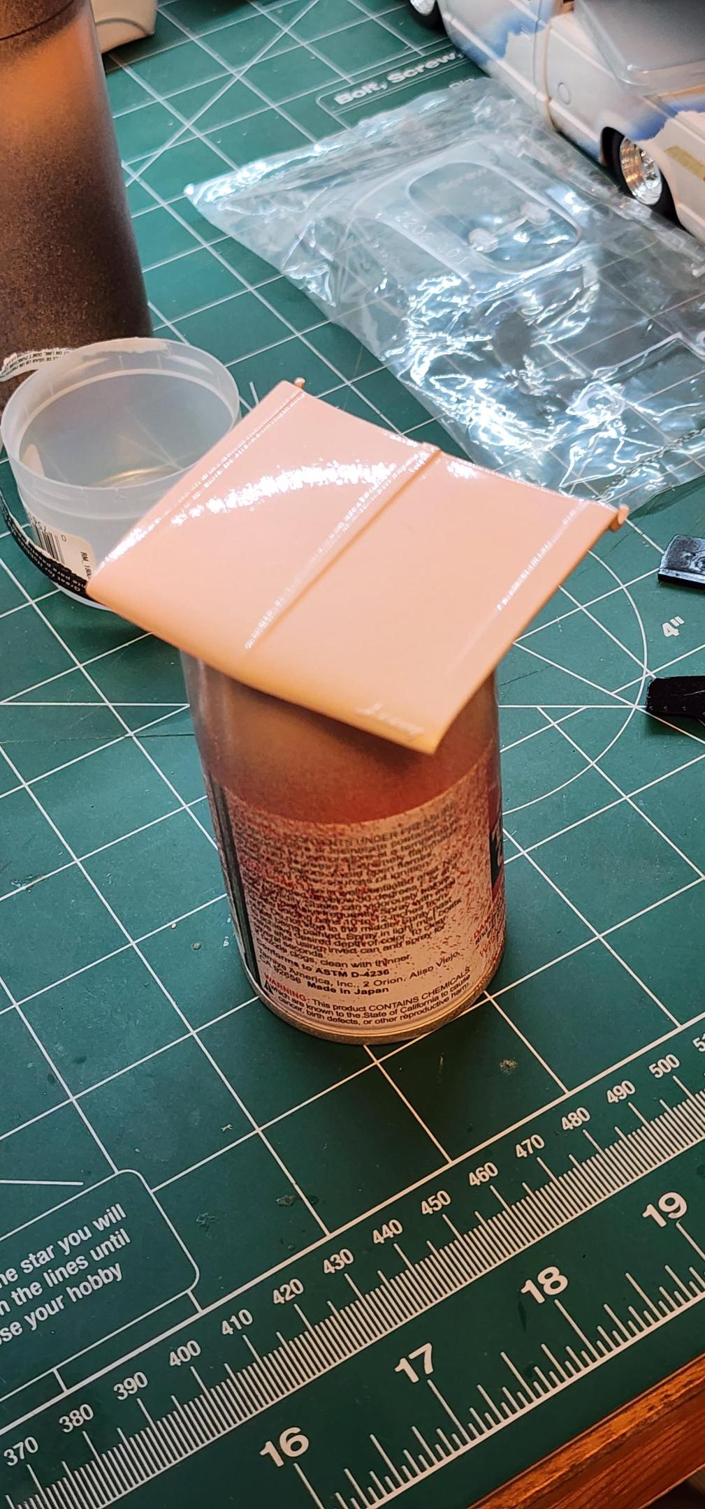

Sam I Am Posted January 29, 2023 Posted January 29, 2023 (edited) I find that pink is difficult to take pictures of. This is the best so far. Tamiya pink with testors white lightning on top. Chassis completed also Edited January 29, 2023 by Sam I Am 1

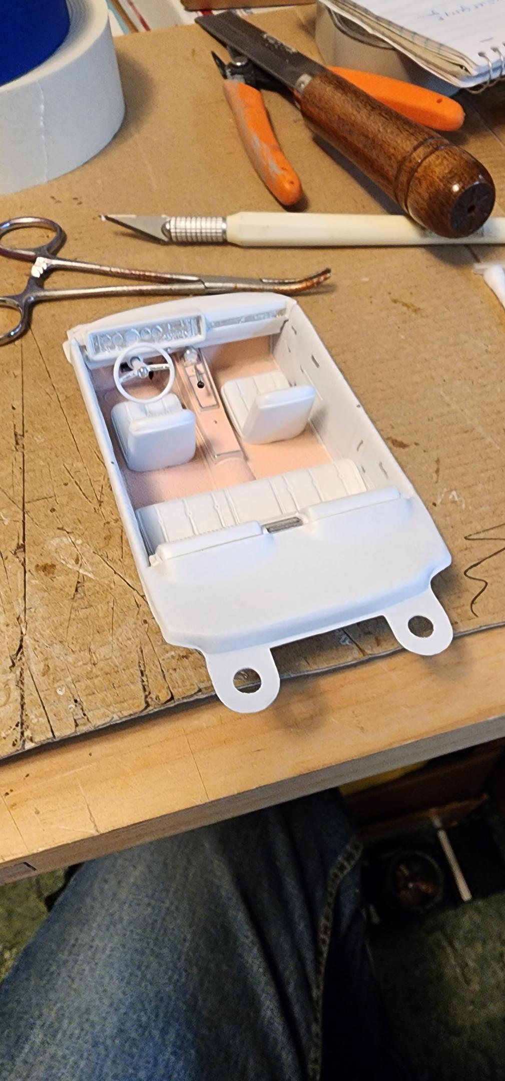

Sam I Am Posted January 29, 2023 Posted January 29, 2023 I grabbed a few hours sleep, then finished up the interior. 1

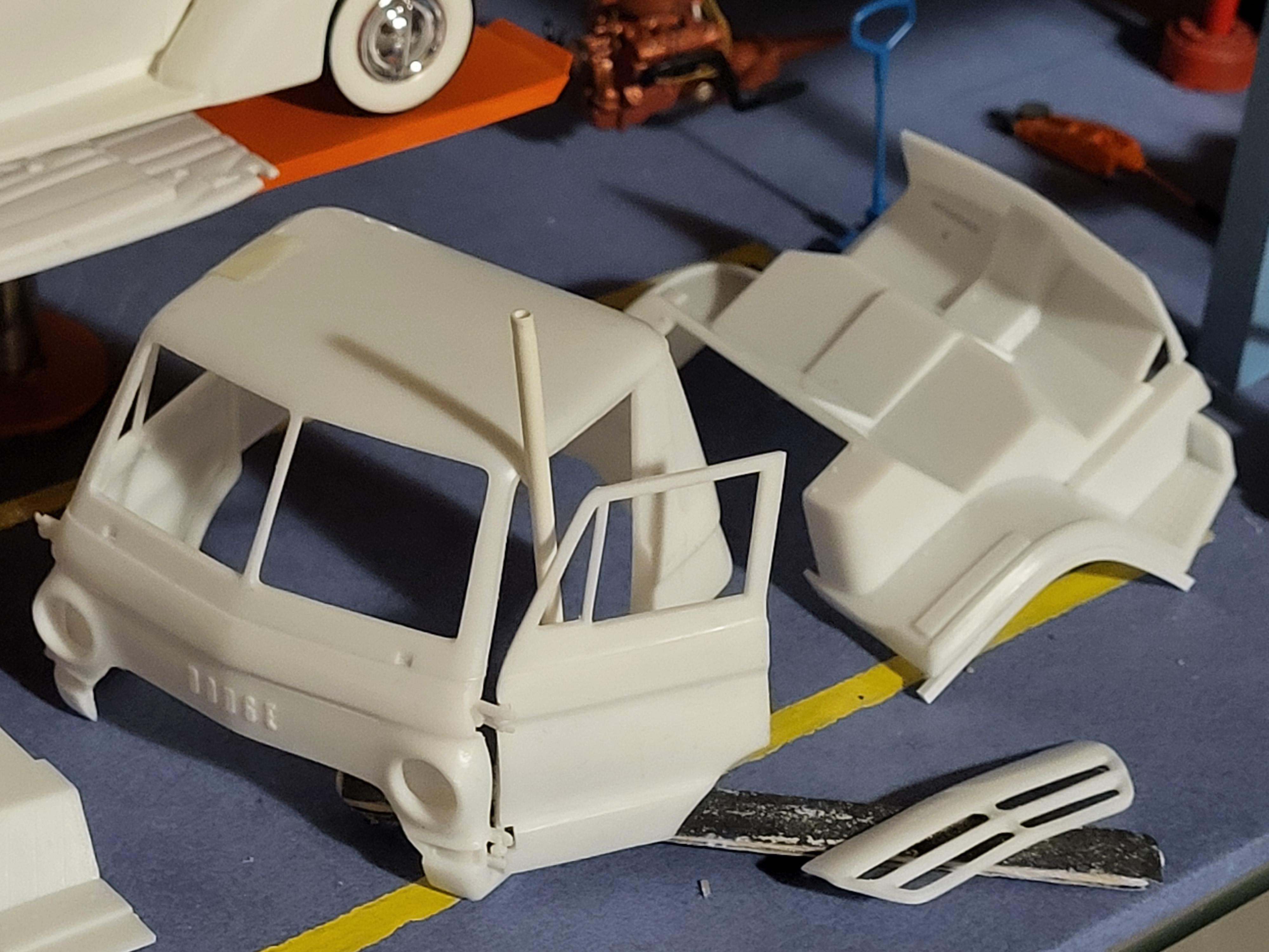

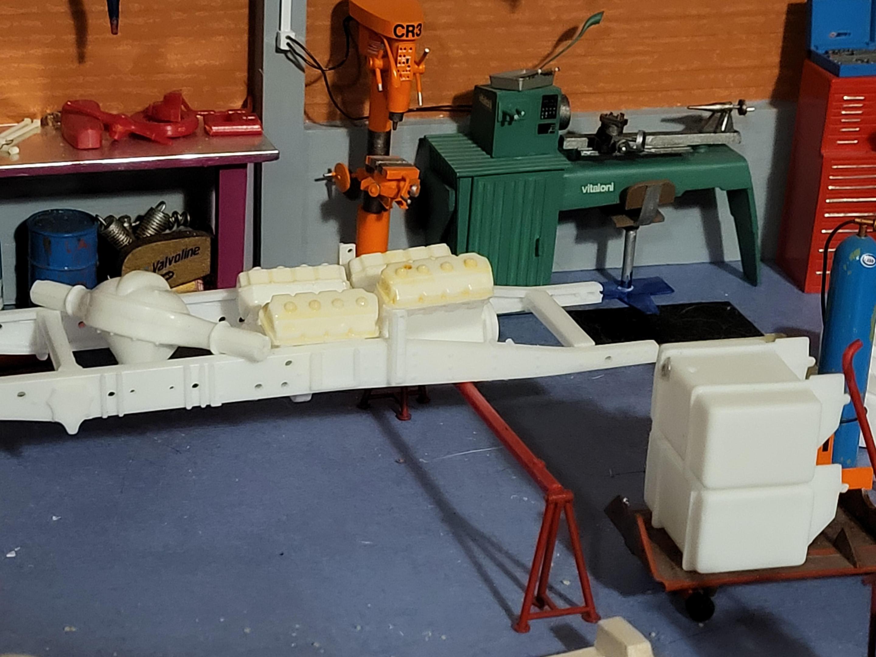

vekasiini Posted January 29, 2023 Posted January 29, 2023 January of L-xxx. I have once built a Linderg L-700. I didn't remember how much work there is in fitting doors, for example. The cleaning of the parts has started and some parts have been glued. The idea is to build a car as it would have been in 1970. With the "original" V12 engine that Mopar should have made. The frame needs to be lengthened, safety and fuel tanks need to be increased. We will continue in February 2

53gmc Posted January 30, 2023 Posted January 30, 2023 On 1/29/2023 at 5:54 PM, vekasiini said: January of L-xxx. I have once built a Linderg L-700. I didn't remember how much work there is in fitting doors, for example. The cleaning of the parts has started and some parts have been glued. The idea is to build a car as it would have been in 1970. With the "original" V12 engine that Mopar should have made. The frame needs to be lengthened, safety and fuel tanks need to be increased. We will continue in February Expand The doors suck on those for sure, my kit was missing some hinge parts so i just glued them shut 1
