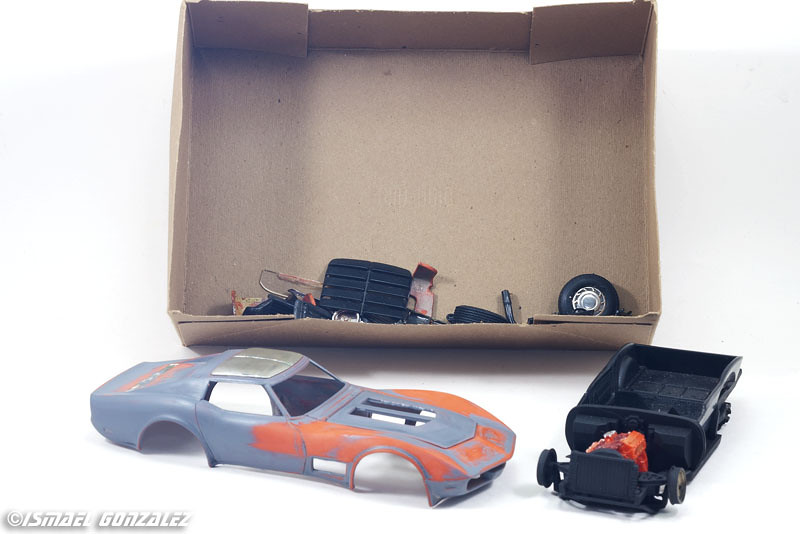

ismaelg Posted January 15, 2023 Share Posted January 15, 2023 Hello, First of all: This is all #Plowboy's (Roger Hayes) fault! His drop dead gorgeous California Street 'Vette hit me like a freight train! What a beauty! Check his Vette in this link: http://www.modelcarsmag.com/forums/topic/175154-california-street-vette/ I am mostly a factory stock (and documented replica in the case of race or historical vehicles) modeler. I've done customs, but it is not usually my main subject. Roger's California Street 'Vette inspired me to dig out mine. The back story is that I got this model (and a few others) already built from my High School Art teacher, well over 30 years ago. I graduated HS in '86 and it was shortly after that. To this day, he is a very good friend and one of the main responsibles of me been a Corvette guy. I learned more about Corvettes from him than drawing and painting 🤣 I remember quickly tearing this model apart and with no plan I started fooling around with it. I destroyed the roof louvers by filling them with putty. No idea what I was thinking. Longest shot: anybody has a spare roof louver for this car? Eventually it went back into the box until this week. All major components are there. The original wheels, tires and mirrors are missing which is no big deal. The engine is pretty crude and so is the hood underside. I'll most likely keep the engine in place but glue the hood shut. I thought of adding a modern LS engine but those are 1/25 running on the smaller end and this car is 1/24 running on the larger end. The LS looks really small in there. Anyways, this car is all about the looks. It will take some fixing but the plan is to keep the original look, except for the roof of course. Door handles and key locks are lost. The body needs some massaging but this will be a slow fun project. Color? It will be blue. What shade of blue? I'll get back to you... Thanks, Ismael 2 Quote Link to comment Share on other sites More sharing options...

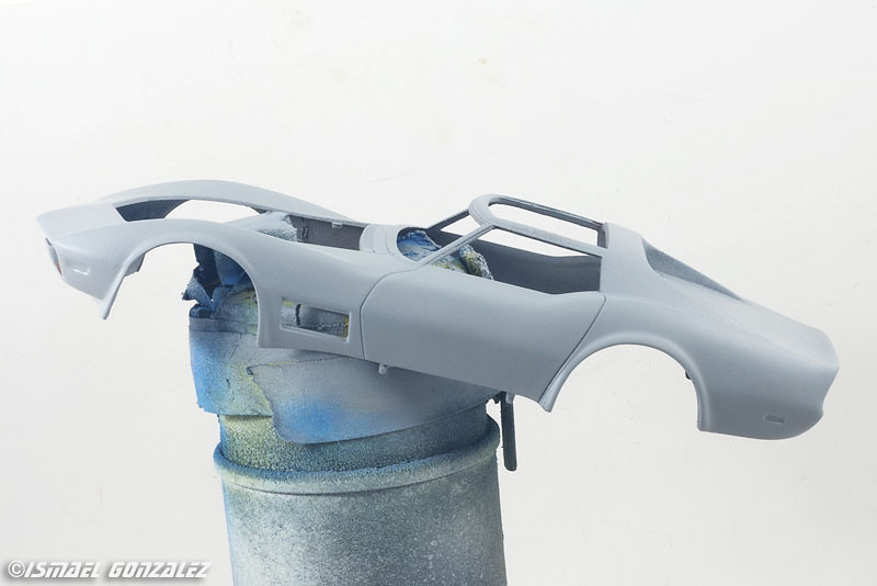

ismaelg Posted January 16, 2023 Author Share Posted January 16, 2023 Hello, Had to do considerable bodywork to get it ready for that milestone of first coat of primer. Multiple repairs, re-scribing, eliminating the ghost door handle and lock, etc. Still a lot of work ahead. The hood will be next. Thanks, Ismael 2 Quote Link to comment Share on other sites More sharing options...

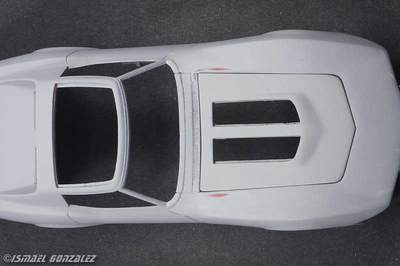

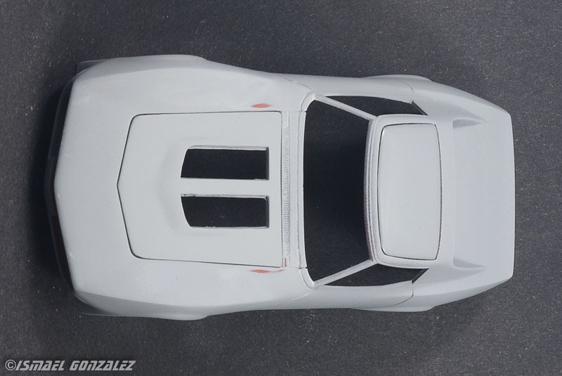

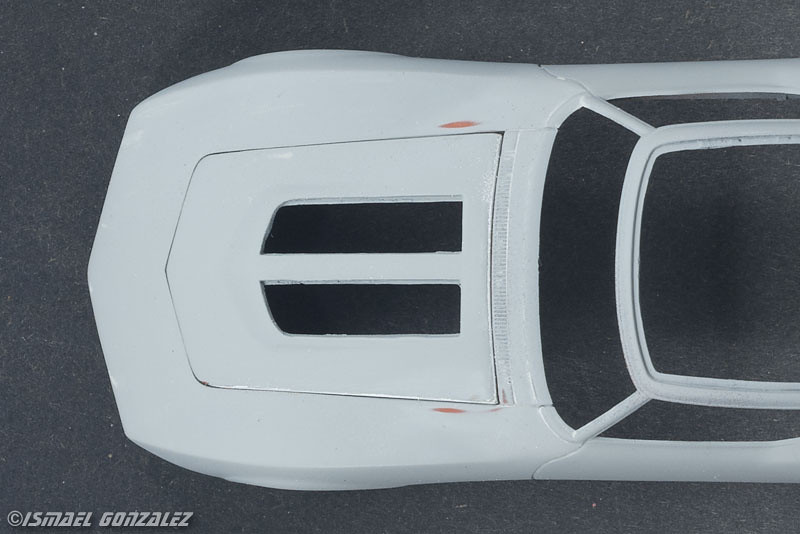

ismaelg Posted January 17, 2023 Author Share Posted January 17, 2023 Hello, Working on the hood. This was already mostly built when I got it. The hood fit showed that it may have been over-enthusiastically sanded. The top corners of the hood were considerably lower than the fenders and the overall hood gaps were bigger than I wanted. Added material to the corners and carefully feathered it. You don't really notice it but it now sits level with the fenders. You can see it is now a bit "thicker" at the corners. For the gaps, I added a small strip of material to the perimeter Which intentionally won't fit. So I can carefully sand it down until it fits properly. Once satisfied with the fit, a little putty to blend the extensions, Sanding and another coat of primer reveal we are moving in the right direction. Thanks, Ismael 2 Quote Link to comment Share on other sites More sharing options...

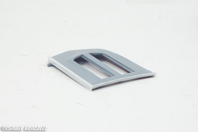

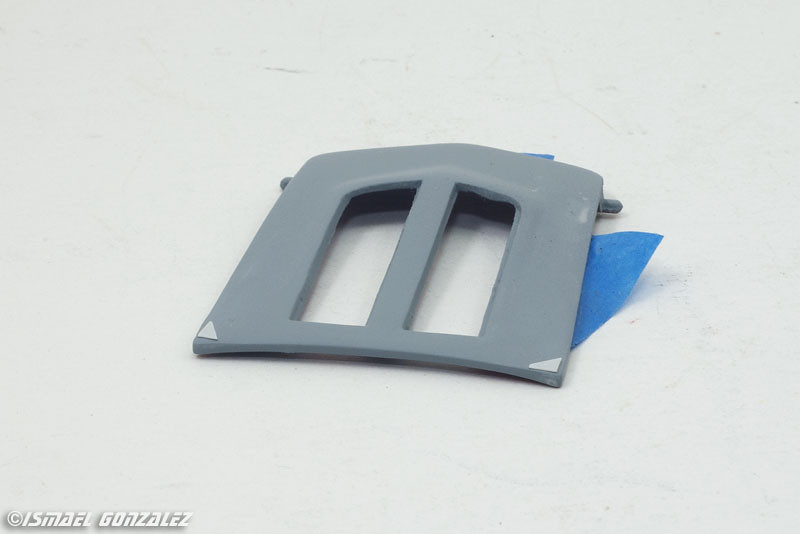

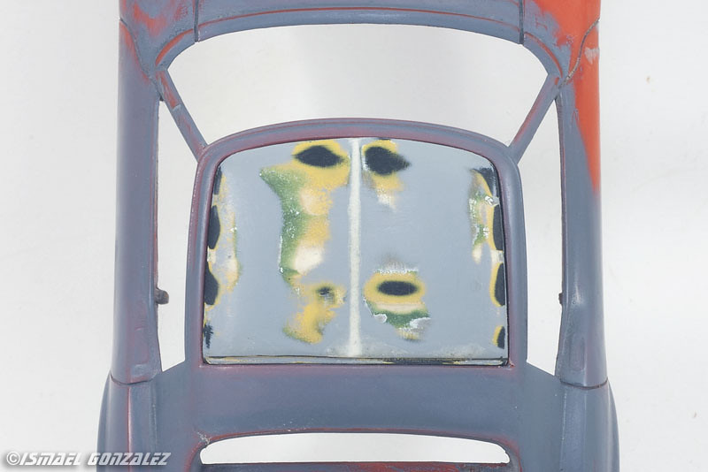

ismaelg Posted February 4, 2023 Author Share Posted February 4, 2023 Hello, Thanks to a fellow forum member I was able to get another louvered roof! Wohoo! THANK YOU! The original roof was filled with putty probably over 30 years ago. I salvaged it and made a solid roof so I'll have 2 roofs for the car. Thanks, Ismael 3 Quote Link to comment Share on other sites More sharing options...

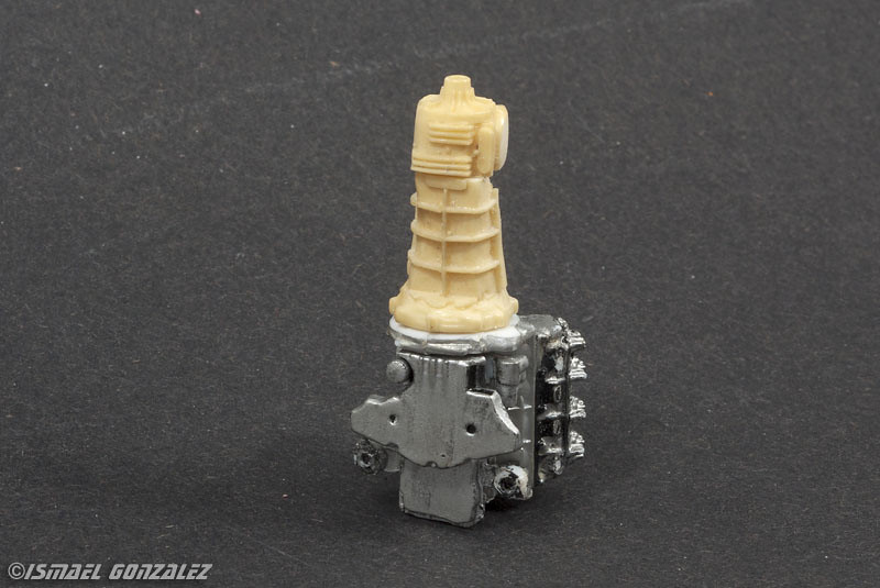

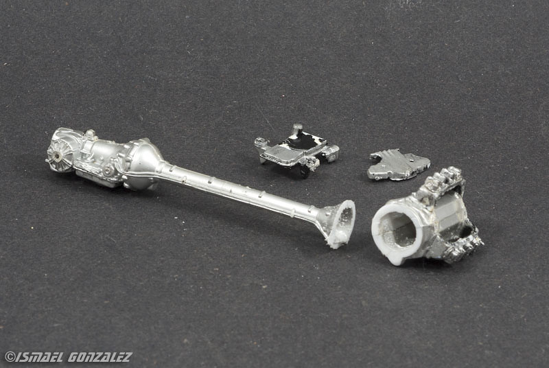

ismaelg Posted February 14, 2023 Author Share Posted February 14, 2023 Hello, Bear with me for a second. This model will have the hood glued shut. The reason is the hood is overly thick and lacks any details underside. The engine compartment on these models is very primitive. BUT! (There's always a but) That doesn't mean it can't have an engine bottom. After all, this hobby is about deceptive lying. From the beginning, I envisioned this build as a modern resto-mod. An LS swap is an obvious choice. However, the spare LS I have is from a C5 Corvette which has the transmission in the back. You may not remember it, but about 20+ years ago I scratchbuilt a proper Borg Warner T56 manual transmission for a 2000 FRC (Fixed Roof Coupe) Corvette and casted it myself in resin. I even sold a few copies. Fast forward almost 23 years later, I still have this reject that was not properly formed on the top. Out came the hacksaw. Separated the tranny from the differential, buthchred the diff and flipped it 90 degrees... Then took the spare LS1 engine powertrain from a builtup I was given years ago. Same maniac hacksaw... and you have the basis for a LS1 - T56 manual combo for a C3 Corvette! Just like in a 1:1, I'm working on engine mounts to fit to the chassis. This is 1/25 and the car is 1/24 but should still look good from underneath. Thanks, Ismael Quote Link to comment Share on other sites More sharing options...
