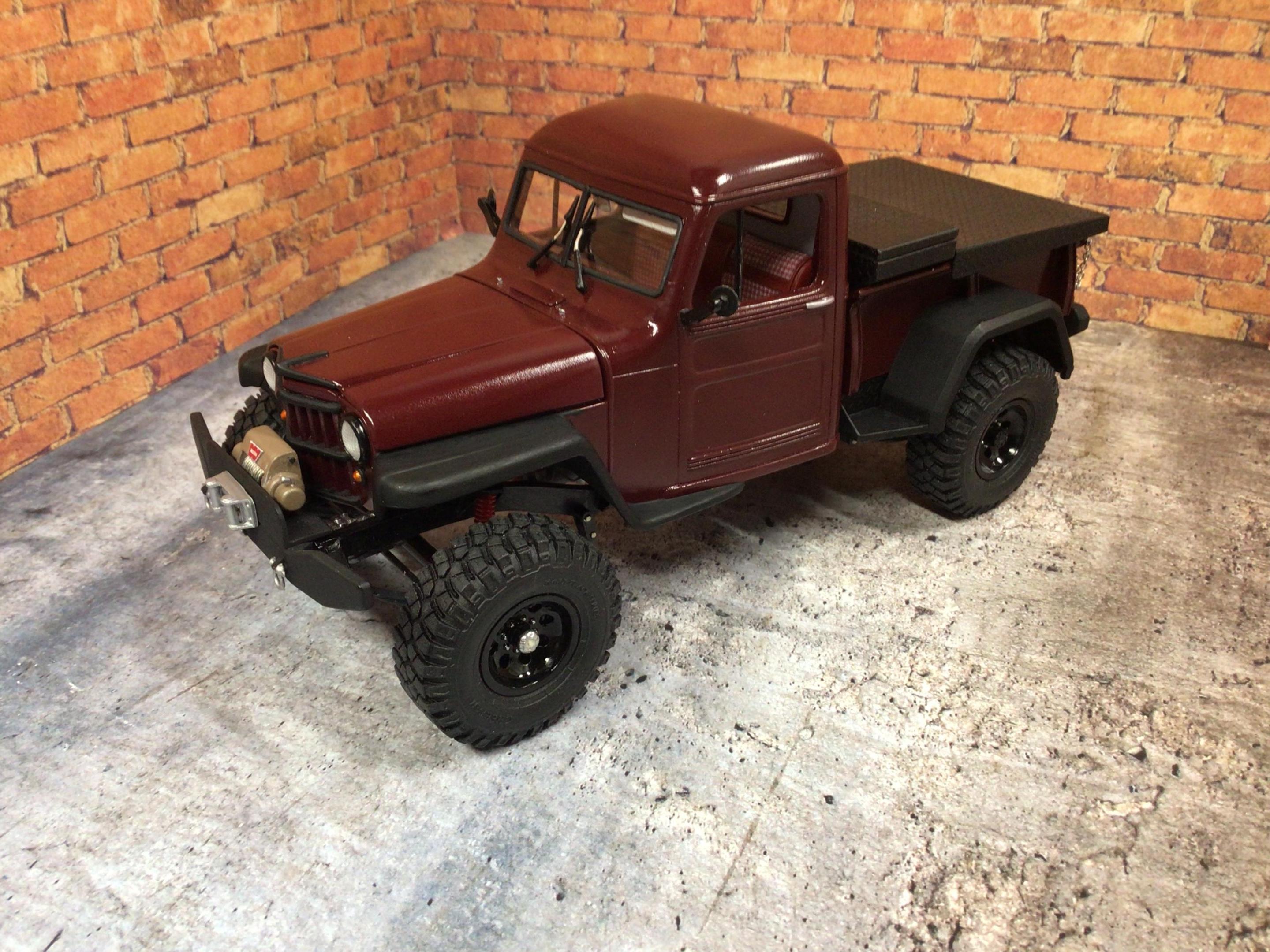

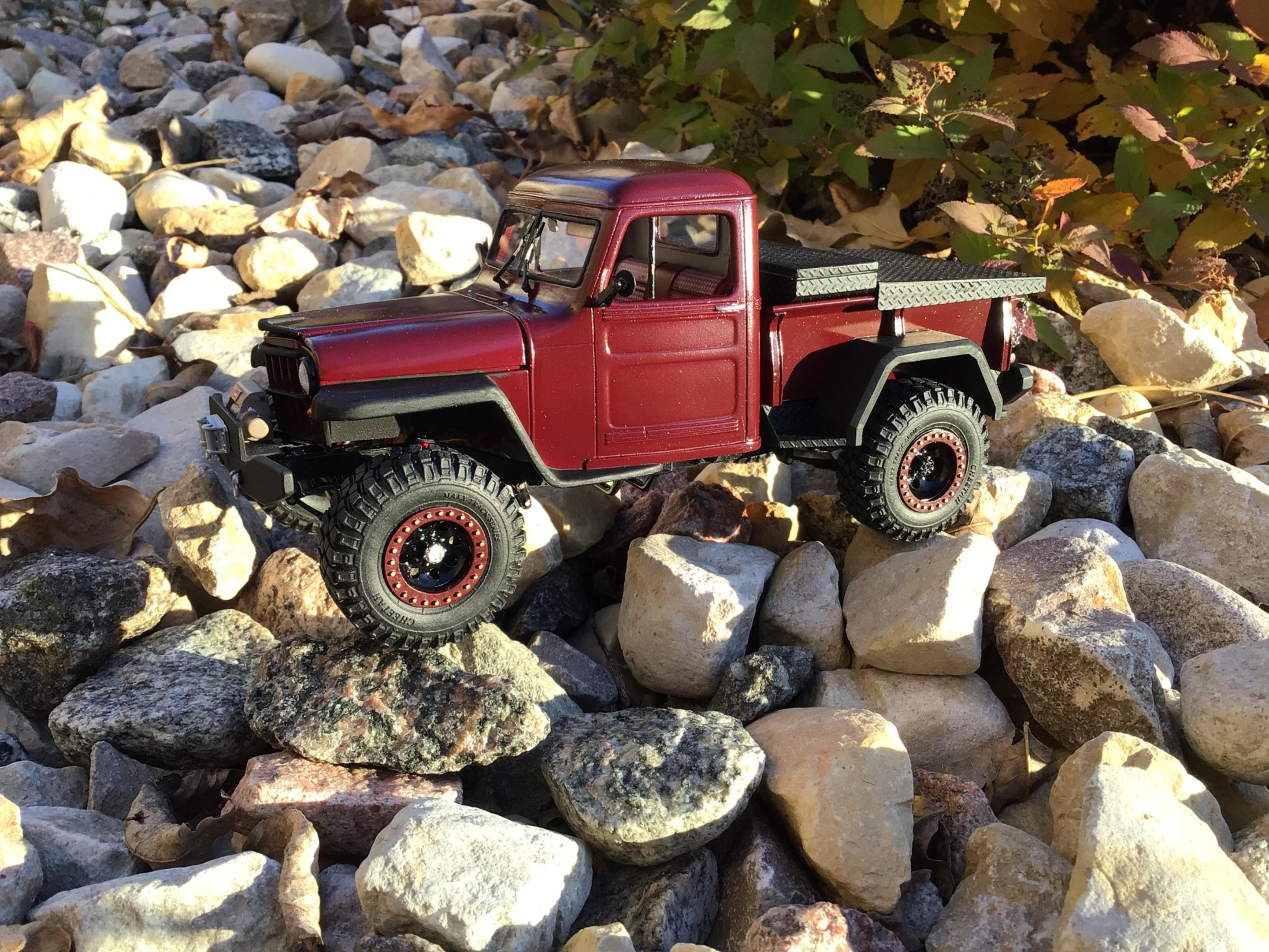

NOBLNG Posted January 28, 2023 Posted January 28, 2023 (edited) 1 hour ago, Jim B said: Constantly have this issue with Tamiya gloss, not with flat though. I think it needs a couple light mist coats, then heavier coats can follow. I never had that problem putting it over Tamiya primer. Here is the TS-11 on my Willys pickup. Edited January 28, 2023 by NOBLNG 1
Jim B Posted January 28, 2023 Author Posted January 28, 2023 Those are definitely less purple. They really look nice.

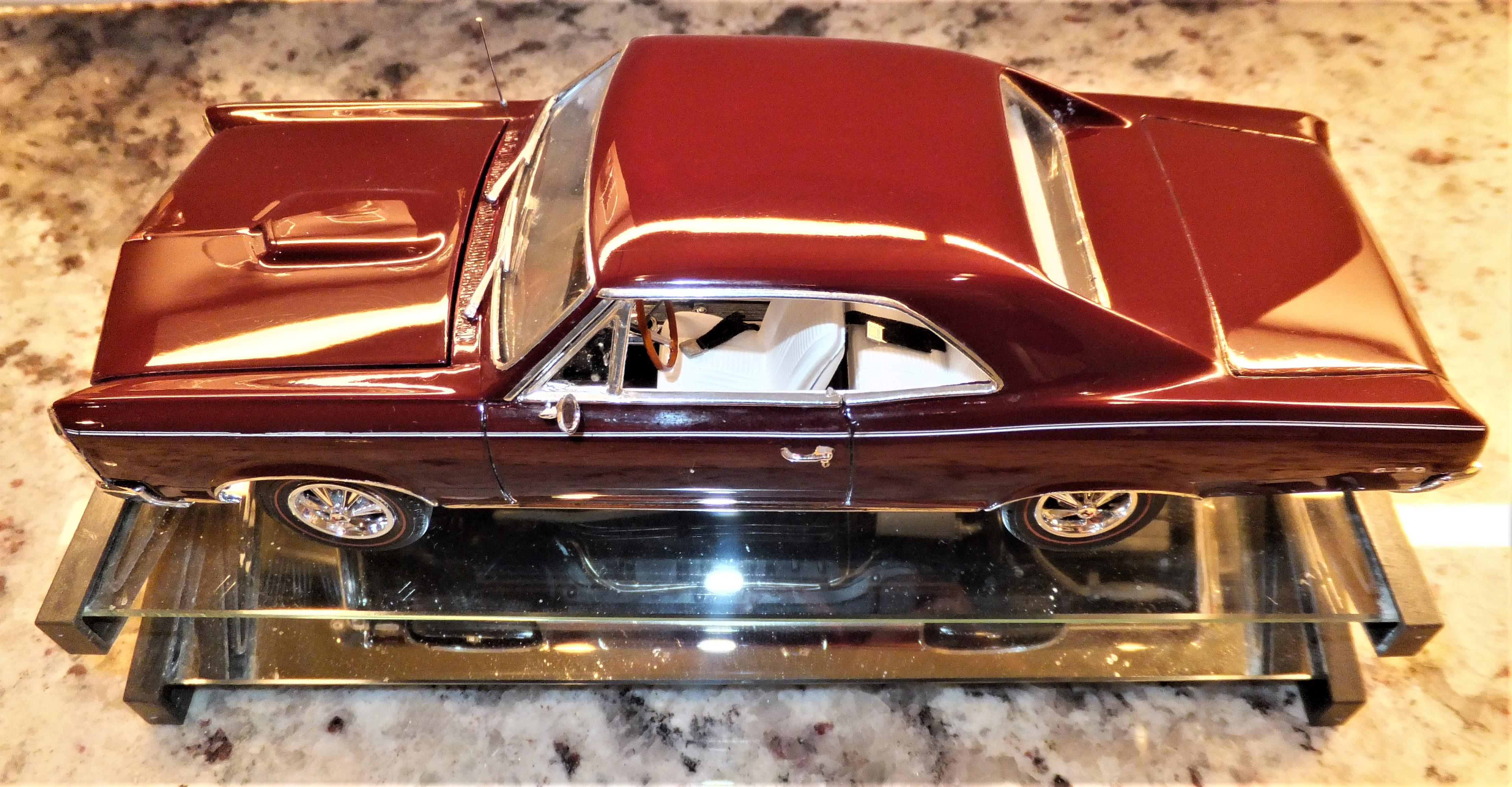

Cool Hand Posted January 29, 2023 Posted January 29, 2023 (edited) Looks like the paint can hasnt been shaken enough. Polished TS-11 over black surfacer. Edited January 29, 2023 by Cool Hand

TransAmMike Posted February 5, 2023 Posted February 5, 2023 (edited) On 1/28/2023 at 8:19 PM, Cool Hand said: Looks like the paint can hasnt been shaken enough. Polished TS-11 over black surfacer. Wow Luke, that is one beautiful paint job. When you say "surfacer" are you referring to Mr. Hobby surfacer and if so, which one. Thanks, Mike Edited February 5, 2023 by TransAmMike
KWT Posted February 5, 2023 Posted February 5, 2023 On 1/28/2023 at 8:19 PM, Cool Hand said: Looks like the paint can hasnt been shaken enough. Polished TS-11 over black surfacer. HoLy... wow...
