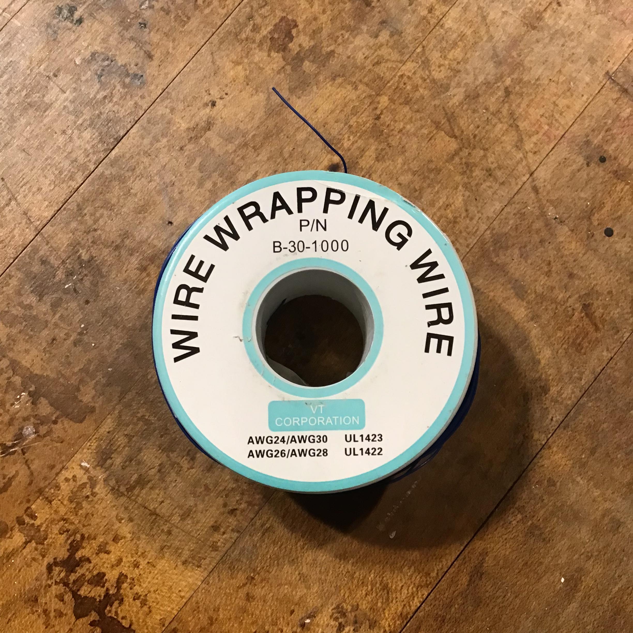

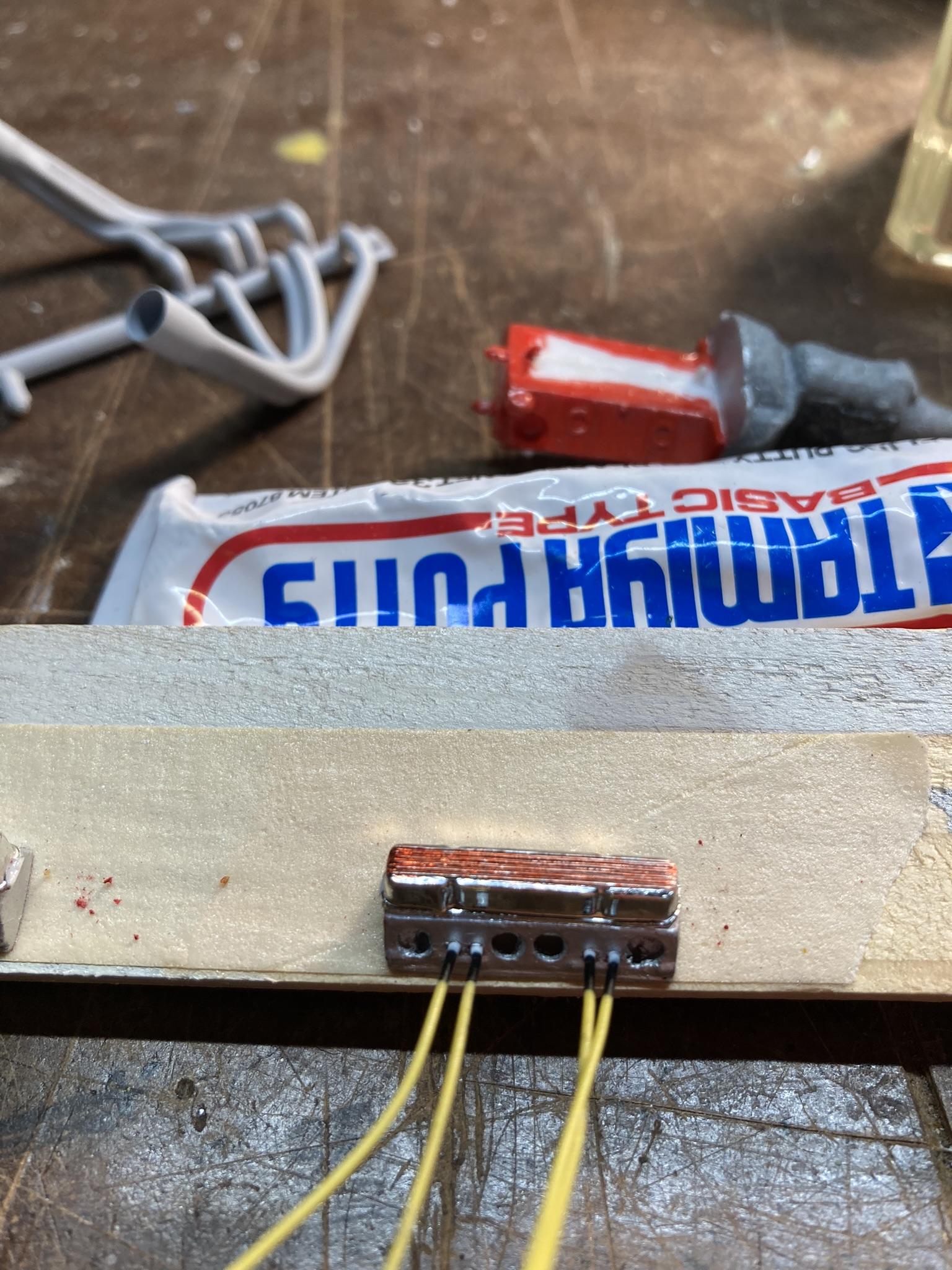

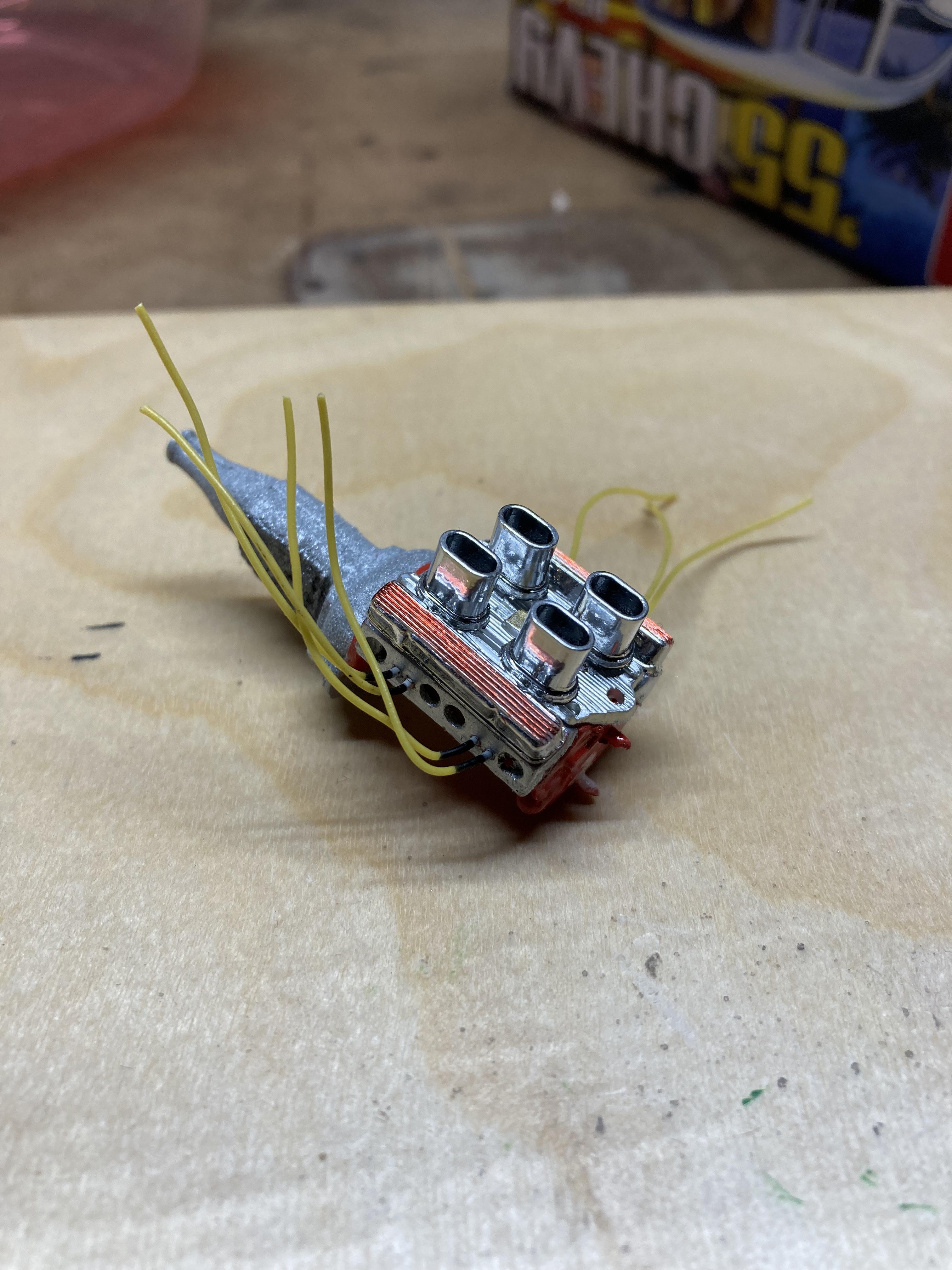

Rick L Posted March 5, 2023 Posted March 5, 2023 Thought I’d try something different to get a spark plug and wire setup. I first dipped the wire into a bottle of flat black lacquer. You can add thickness by adding multiple dips after the previous coat dries. The next step was a dip in gloss white lacquer making sure the black exposed were all the same length. Next I drilled out the heads and pushed the wire through making sure the white exposed was the same length. Then bent the wire inside the head over, added a drop of CA and a quick spray of water to kick it quickly. I used lacquer paint because it can hold up to a little bend when I install the wires into the distributor. 1

Rick L Posted March 7, 2023 Author Posted March 7, 2023 9 hours ago, Chevy II said: Neat idea, what wire are you using? I found this on ebay. It measures .02 dia. which would be 1/2 in real scale but I don’t think it’s too glaring on the model.
