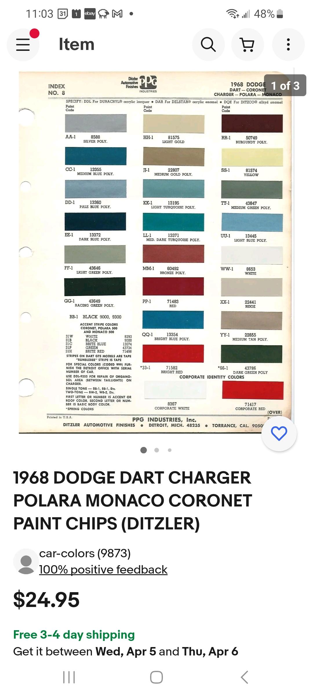

I'm looking for a spray bomb match to either of Dodge's 68  FF-1 Light green poly or TT- Medium green Poly. Something in Testors or Tamiya line preferably. Anybody know of anything?

Scale Finishes has those colours 60s Dodge (scalefinishes.com)
MCW MCW Finishes
I've never used either manufacturer's offering, so I can't personally attest to the quality, etc.  Like you, I employ Tamiya aerosols (at least 97% of the time) -- too bad that the paint chips are such poor representations of the actual colours.
Here's the direct link to Tamiya USA's site's aerosol paints Shop / Tamiya USA
MCW MCW Finishes
I can vouch for both MCW and Scale Finishes!!
Both produce EXCELLENT acrylic lacquers, and some enamels as well.
But, unfortunately, I don’t think either one offers paint in spray cans anymore.
But, I might be wrong, so check out their websites.
If they do still offer spray cans, they come at quite a price!
Let’s just say that for the price of 4 or 5 cans, you could buy a nice airbrush, and then your paint searches would be over! ?
