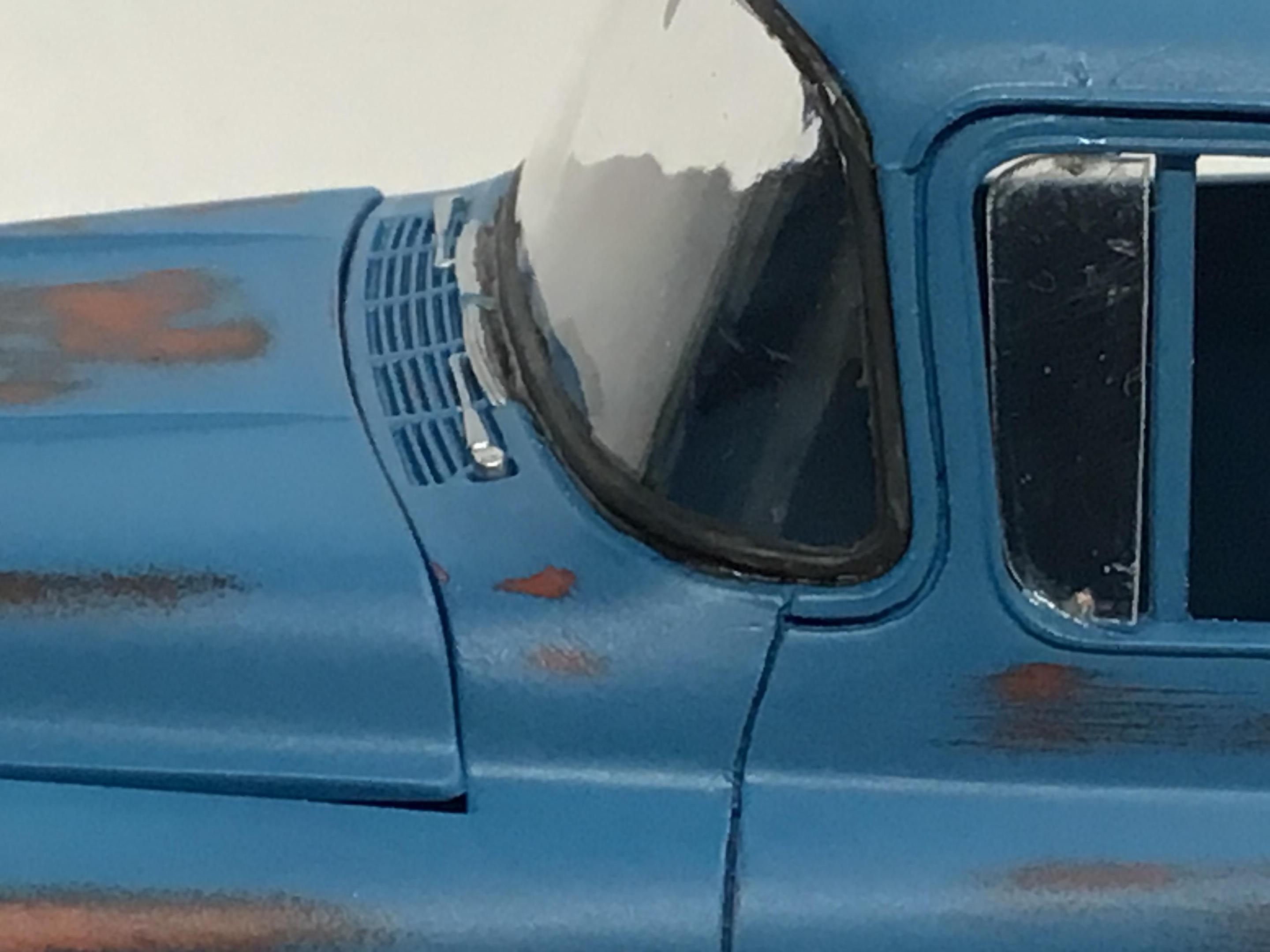

Dpate Posted April 5 Share Posted April 5 I use this set up quite a bit and get fantastic results. The light weathering carrier removes any extra glue no problem. Quote Link to comment Share on other sites More sharing options...
