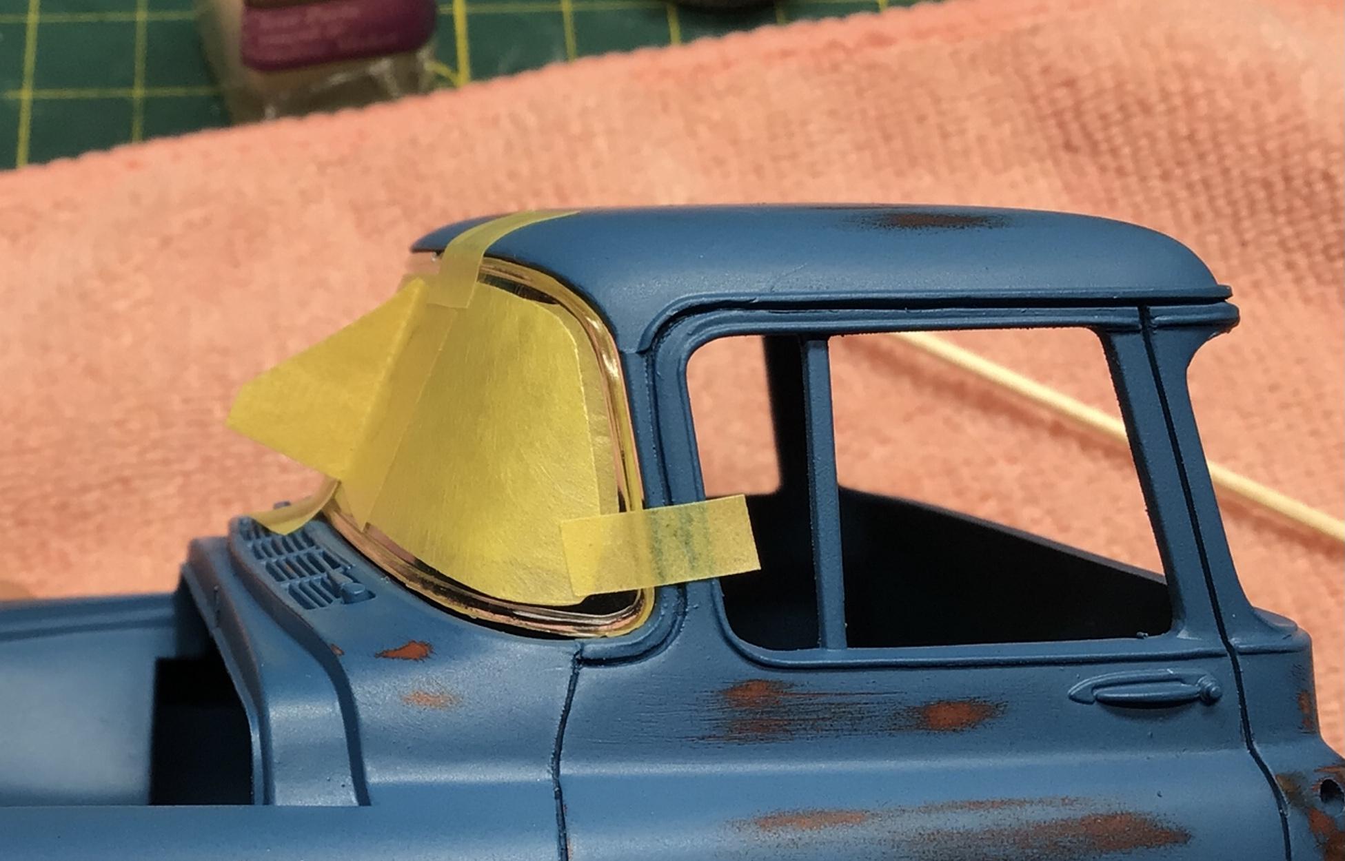

StevenGuthmiller Posted April 5, 2023 Posted April 5, 2023 I don't want to call it "the best", but I've found that clear 2-part epoxy works better than anything else that I've tried, and once it's dry, that glass ain't goin' nowhere! I'll usually tape the glass in position in several places around the perimeter, and then apply glue to the open areas with a tooth pick. Once the glue has set hard, I'll remove the tape and apply more glue to the areas that were covered by the tape. I don't like thin glues, or ones with "capillary" capabilities, because I don't want the glue, "capillary-ing" all over the place, and, well, we all know how well some kit glass fits, so I find that a thicker glue works better for me. Steve 3
