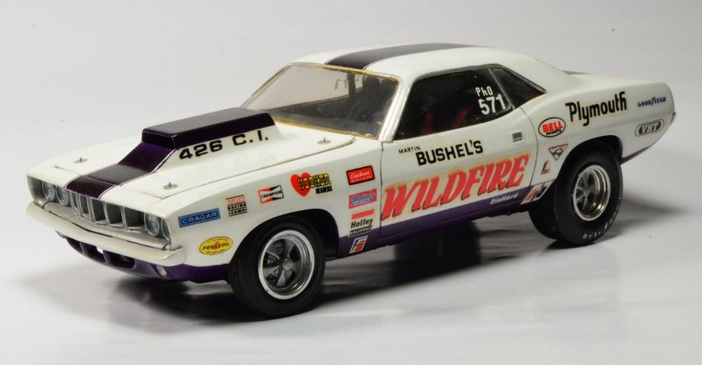

Straightliner59 Posted July 1, 2023 Posted July 1, 2023 I painted this in about 1986 or so. I don't remember the manufacturer, but the paint was called "Bright White Tint". It had a blue tint, to it, to combat yellowing. It was clear coated with Floquil Crystal Cote. You can see yellowing of the epoxy I used to install the windshield, and of some of the decal adhesive, but the white is as white as ever.

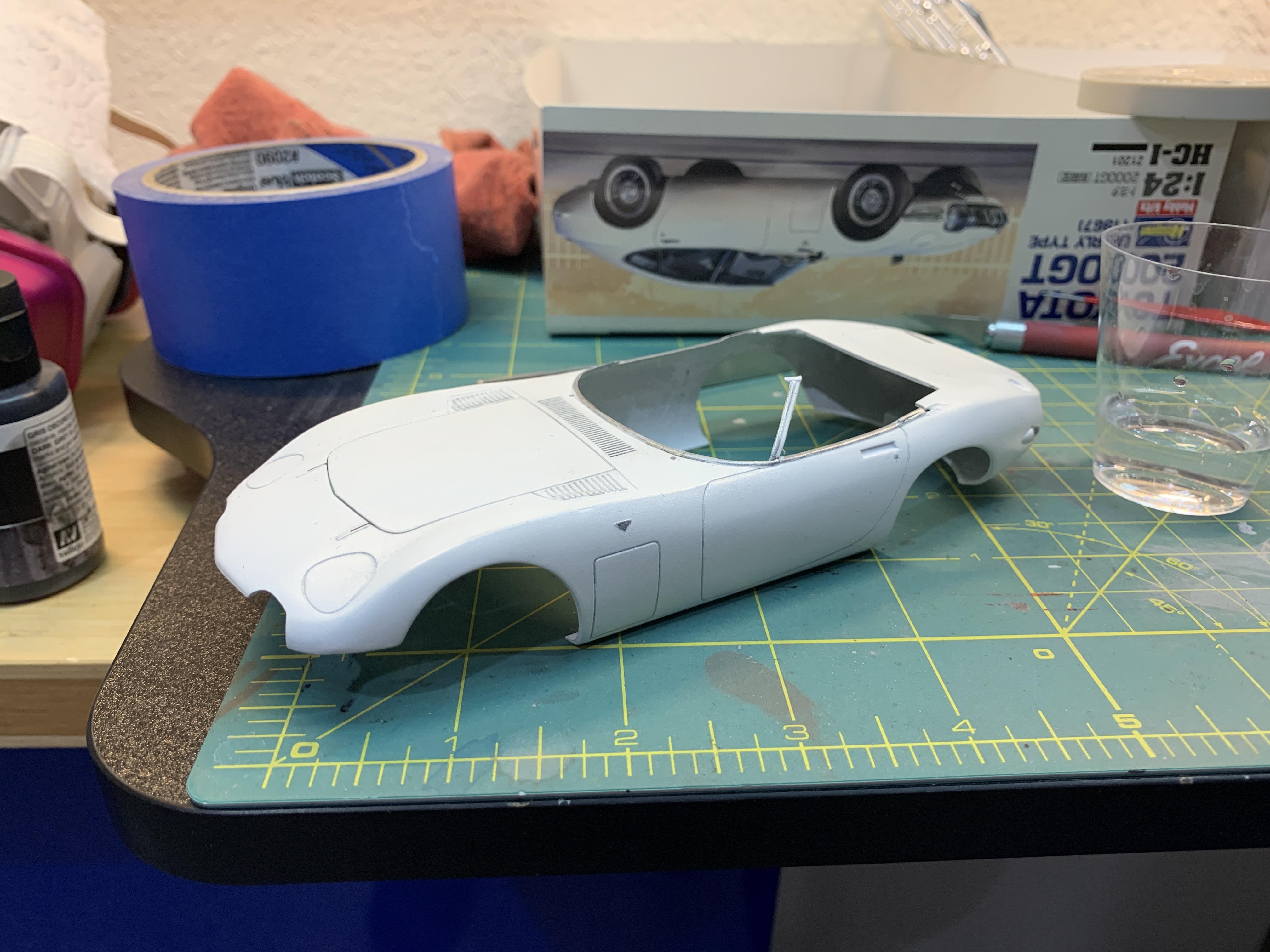

Sonorandog Posted July 25, 2023 Author Posted July 25, 2023 I appreciate all of the great advice. Using all my newfound knowledge I put down a pretty good white paint job. Then the clear coat did not go so well. I used Createx paint and clear. I was very happy with the paint and wish I would have taken a picture to share, Instead I thought I would wait until after the clear and show off a great paint job. The results are acceptable, mainly because this has been in process for over a year. At some point I have to finish it.
