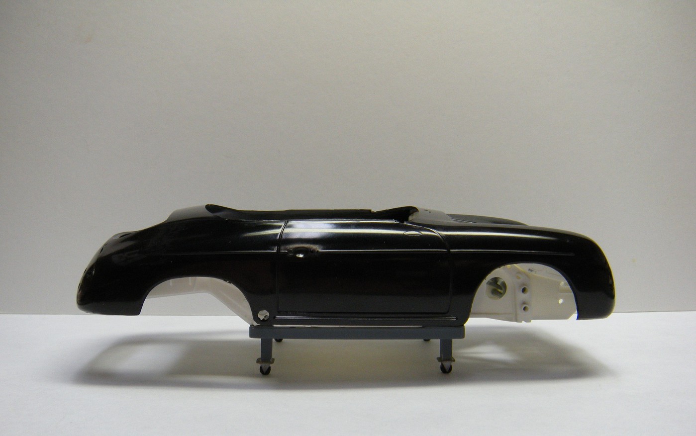

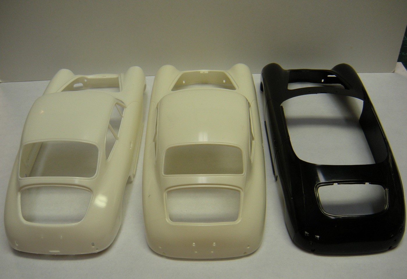

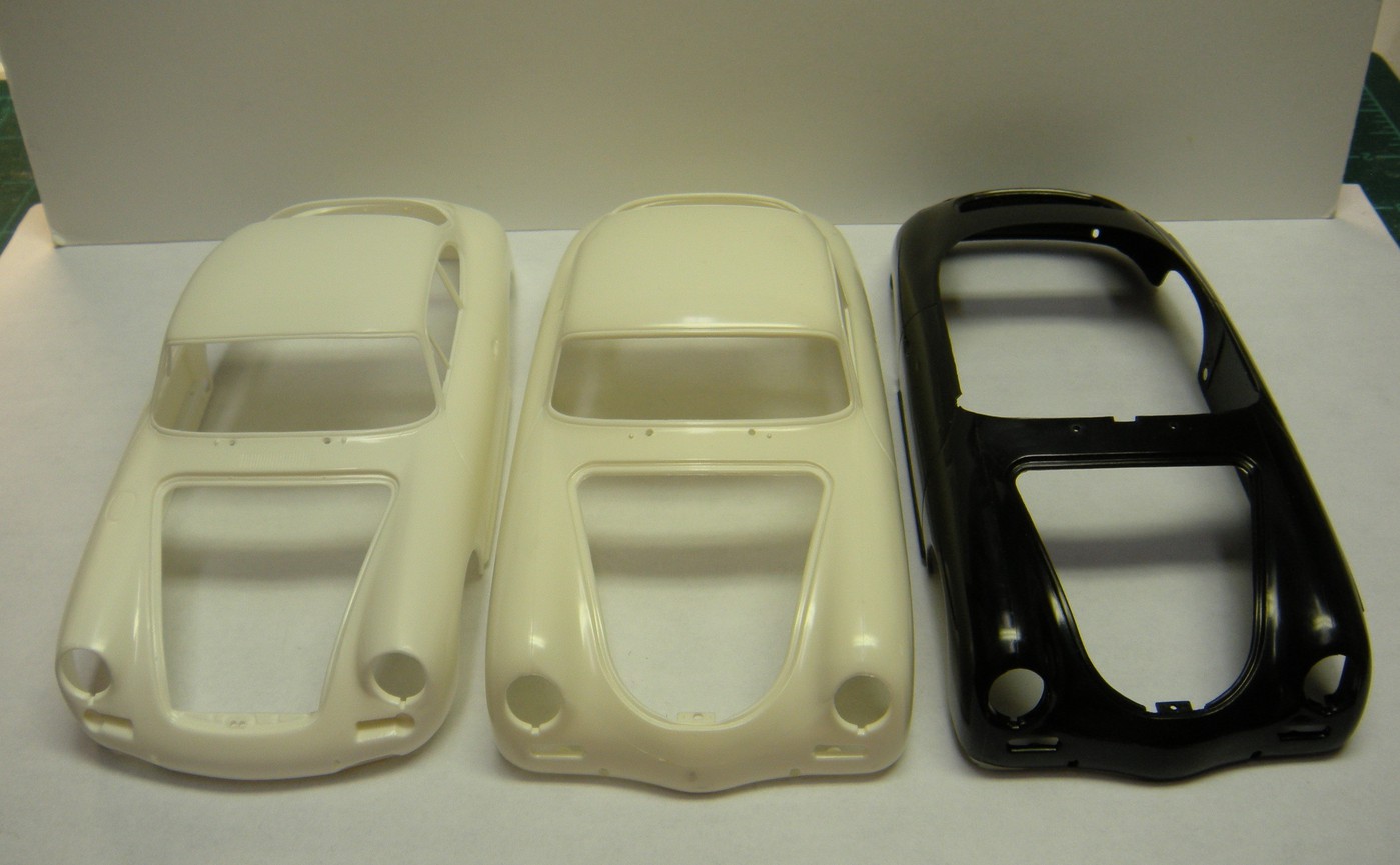

afx Posted July 31, 2023 Author Posted July 31, 2023 (edited) Appreciate the interest gentlemen. Fujimi offers a 356 Convertible but I don't have that in the stash. I do have: 356A Speedster - black body 356A Coupe - center 356B/C Coupe - left Some of the distinguishing features that identify a 356A from a 356B/C peaked nose in the font valance smaller hood and engine cover, different shape as well smaller glass openings in the greenhouse There is very little outwardly difference between a 356B and a 356C, that's why Fujimi offered the kit as a B/C 356A Speedster: 356A Coupe: 356B/C Coupe: Edited August 1, 2023 by afx 1

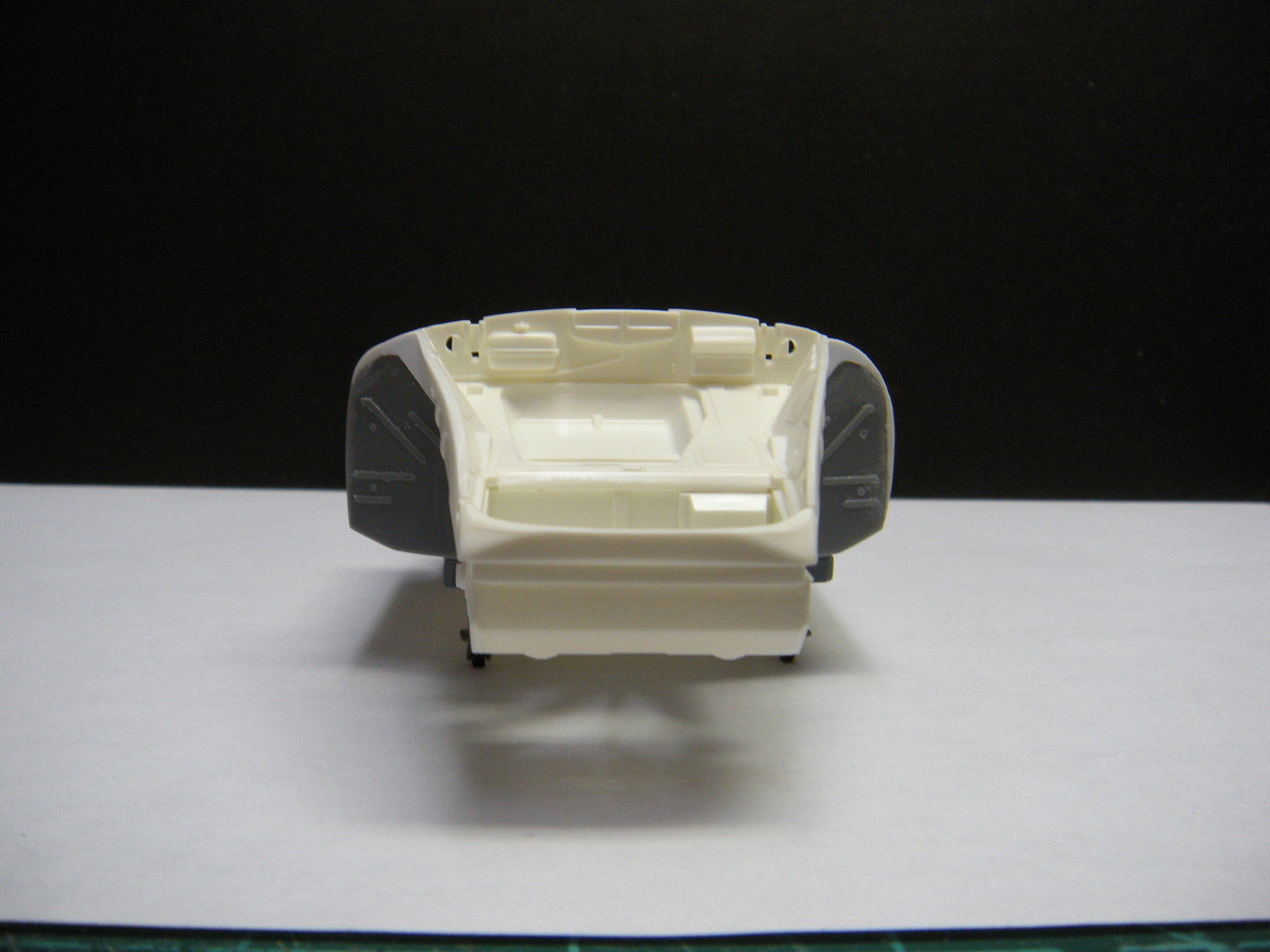

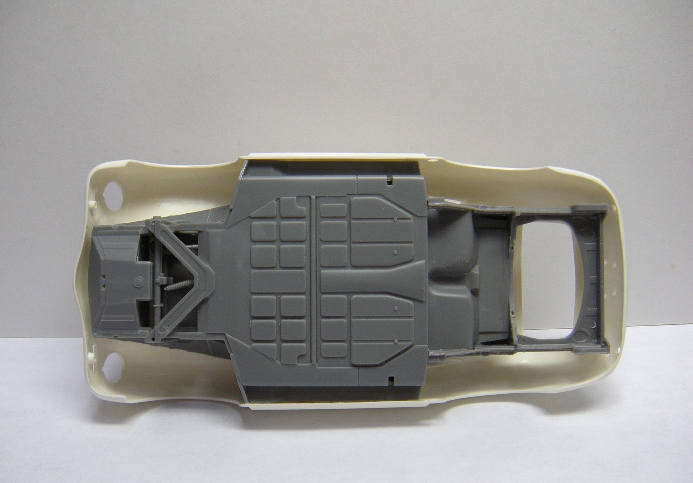

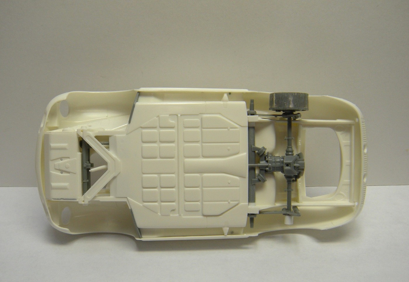

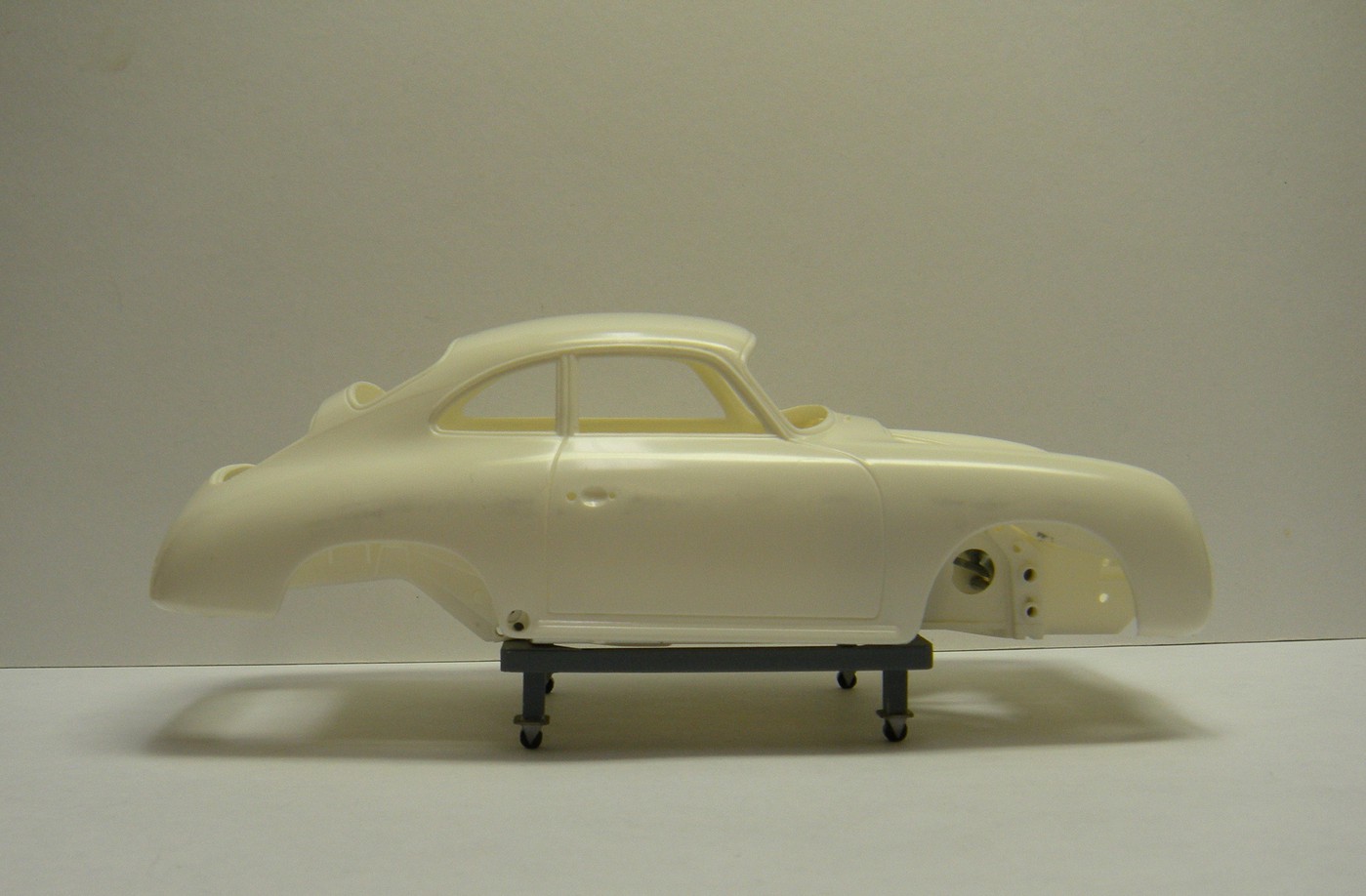

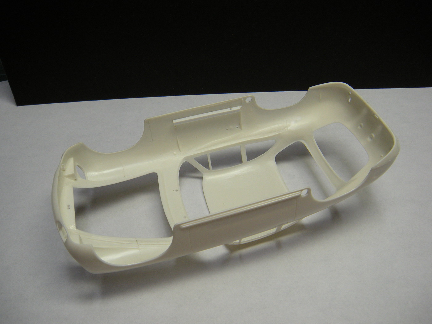

afx Posted August 1, 2023 Author Posted August 1, 2023 (edited) Both the 356 and the 911 are unibody construction. On the 911 the chassis pan, boot and engine bay are all painted body color, on the 356 these areas are all black so I made the decision to build up the chassis and paint it as an assembly - hope that works out. The kit's front inner fenders leave significant gaps - I fabricated additional panels and added material to help close these gaps. I test fit fastidiously and need the chassis pan to be locked into position. To achieve this I added a cleat along the sill inside the body. And an alignment pin (made form a bit of wire) in the chassis pan. Locked in horizontally and vertically. Edited August 1, 2023 by afx 3

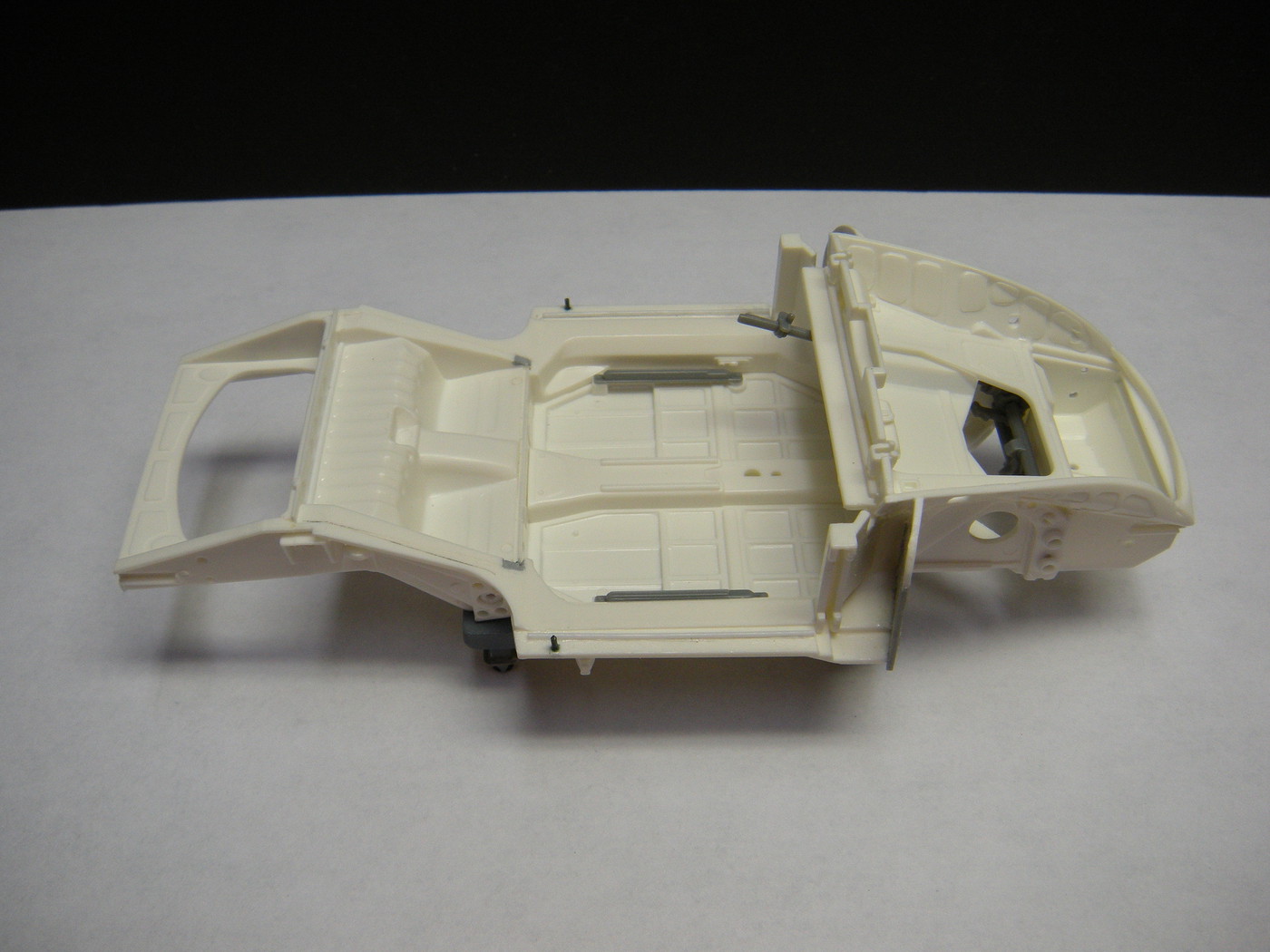

afx Posted August 1, 2023 Author Posted August 1, 2023 (edited) Note in the photo above I also I modified the rear torsion bar tube so that it can be installed in the chassis (as Porsche did) prior to installing the rear suspension. I also blended in the jack points to remove the kit seam. Edited August 1, 2023 by afx

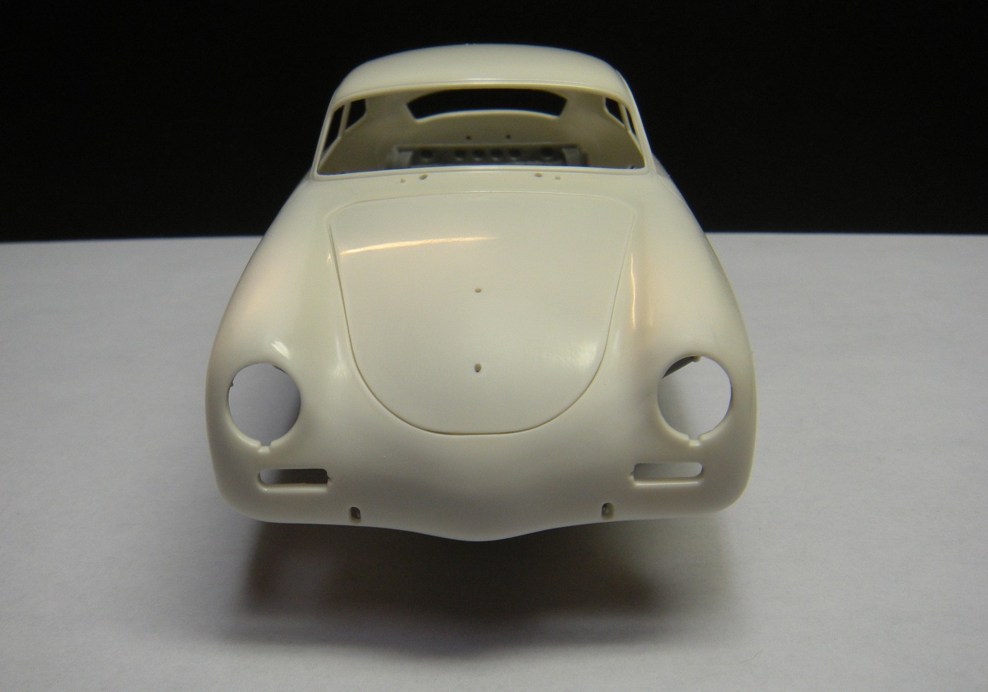

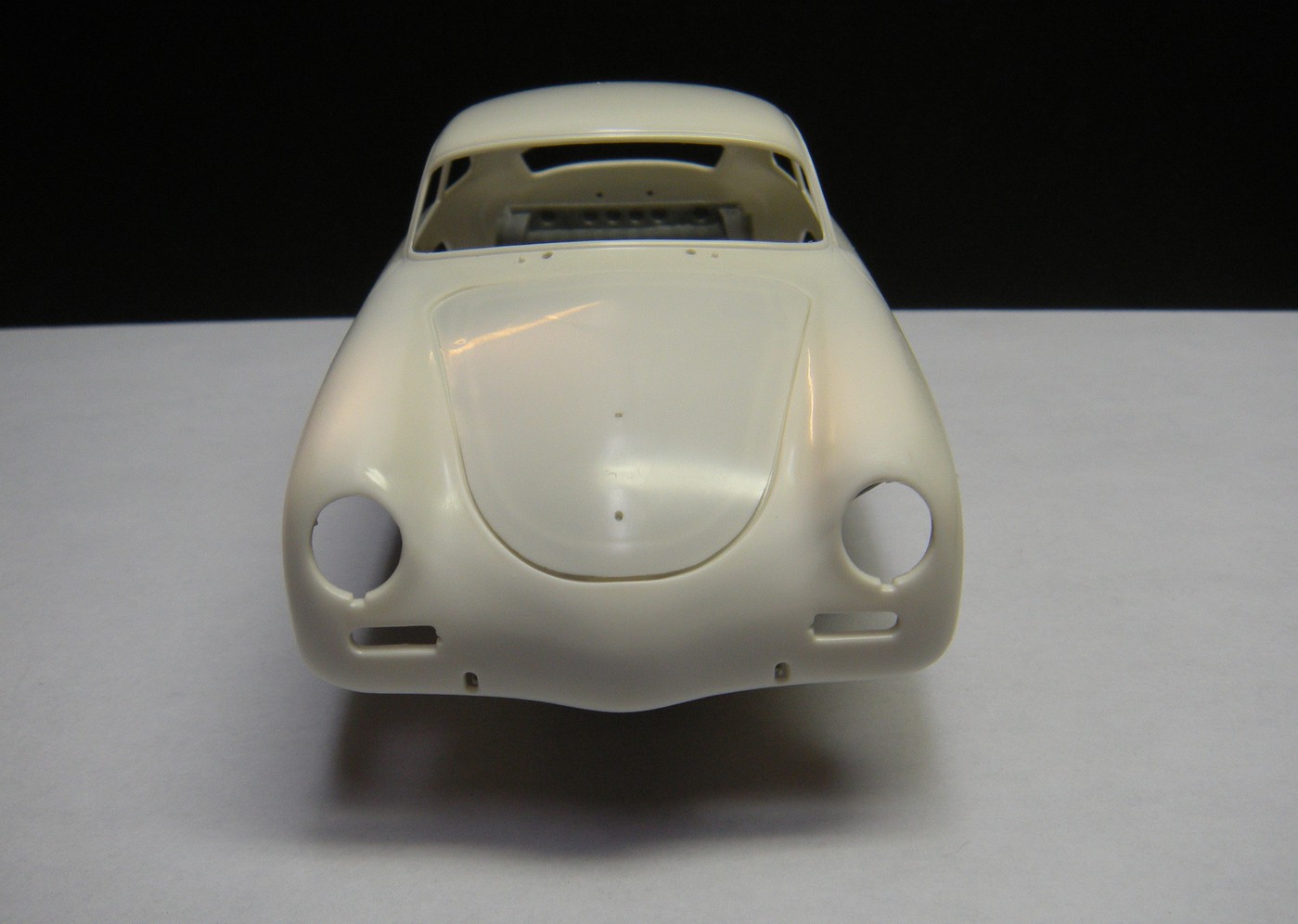

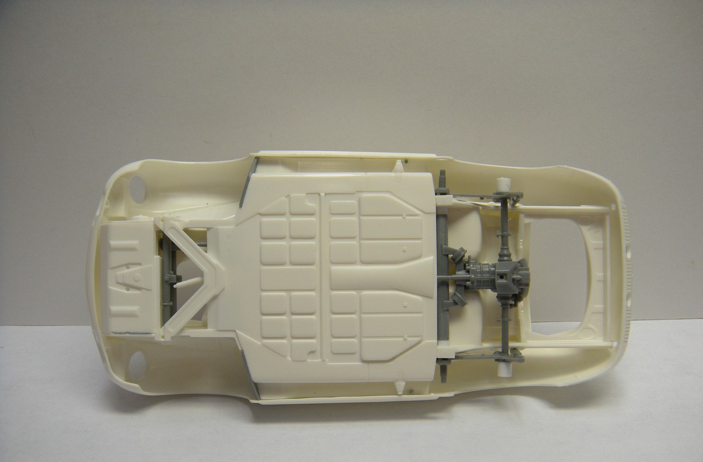

afx Posted August 3, 2023 Author Posted August 3, 2023 (edited) While I am at this I thought I would build up the 356A chassis as well. To Fujimi's credit they have include different parts to represent the difference in the chassis. The transmission mount on the torsion bar tube is different as well as you will see once I have it installed on the A chassis. 356A 356B The 356A hood is molded paper thin, out of the box the nose of the hood stuck up in the air. I was able to gently bend it to make the curve fit but was not confident it would retain the correct shape, in addition the fit was sloppy. I hade a spare 356B hood from a kit the US Mail managed to crush the body on. Surprisingly with a little reshaping I was able to make the B hood to fit the A body. Edited August 3, 2023 by afx
