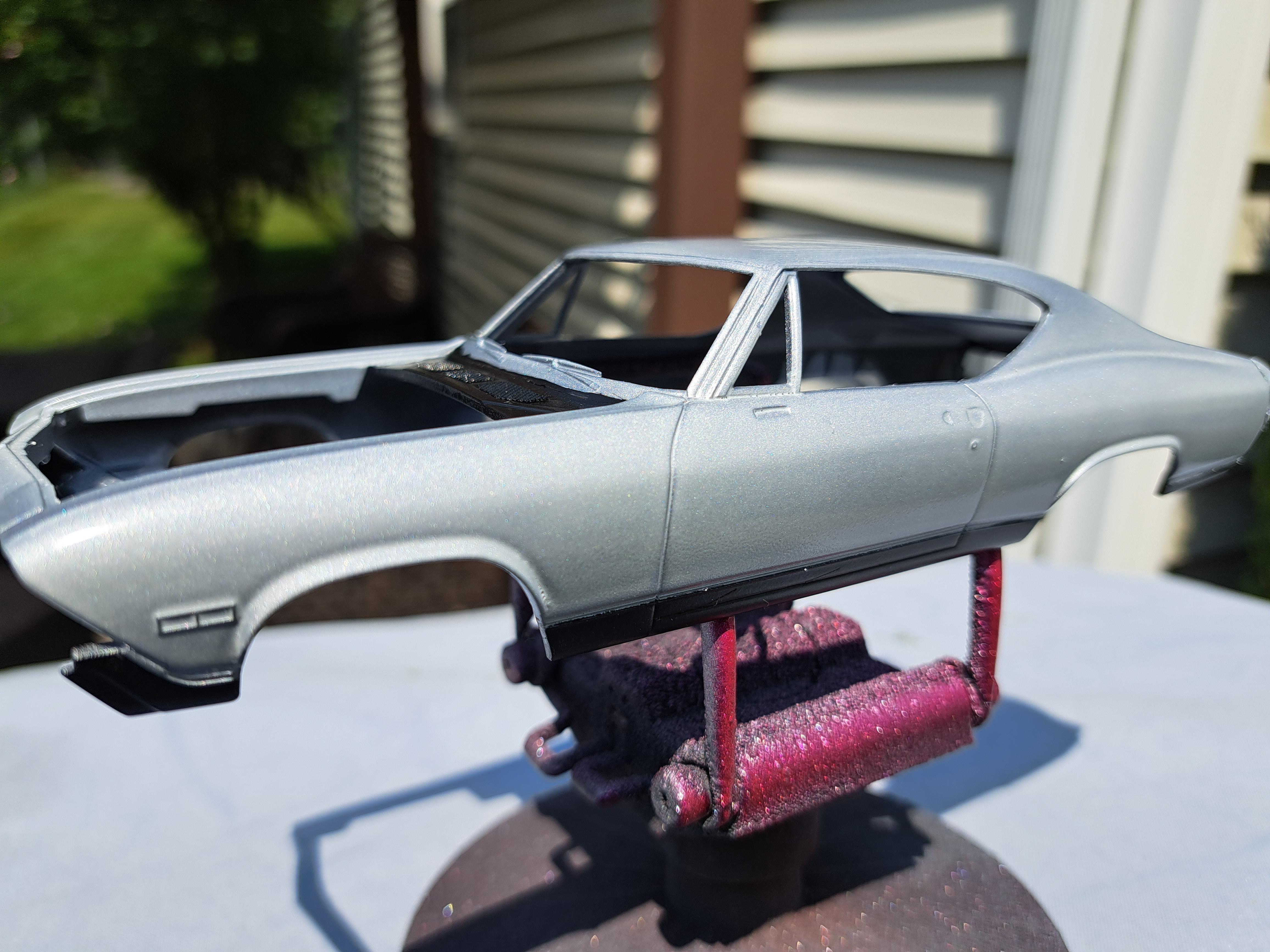

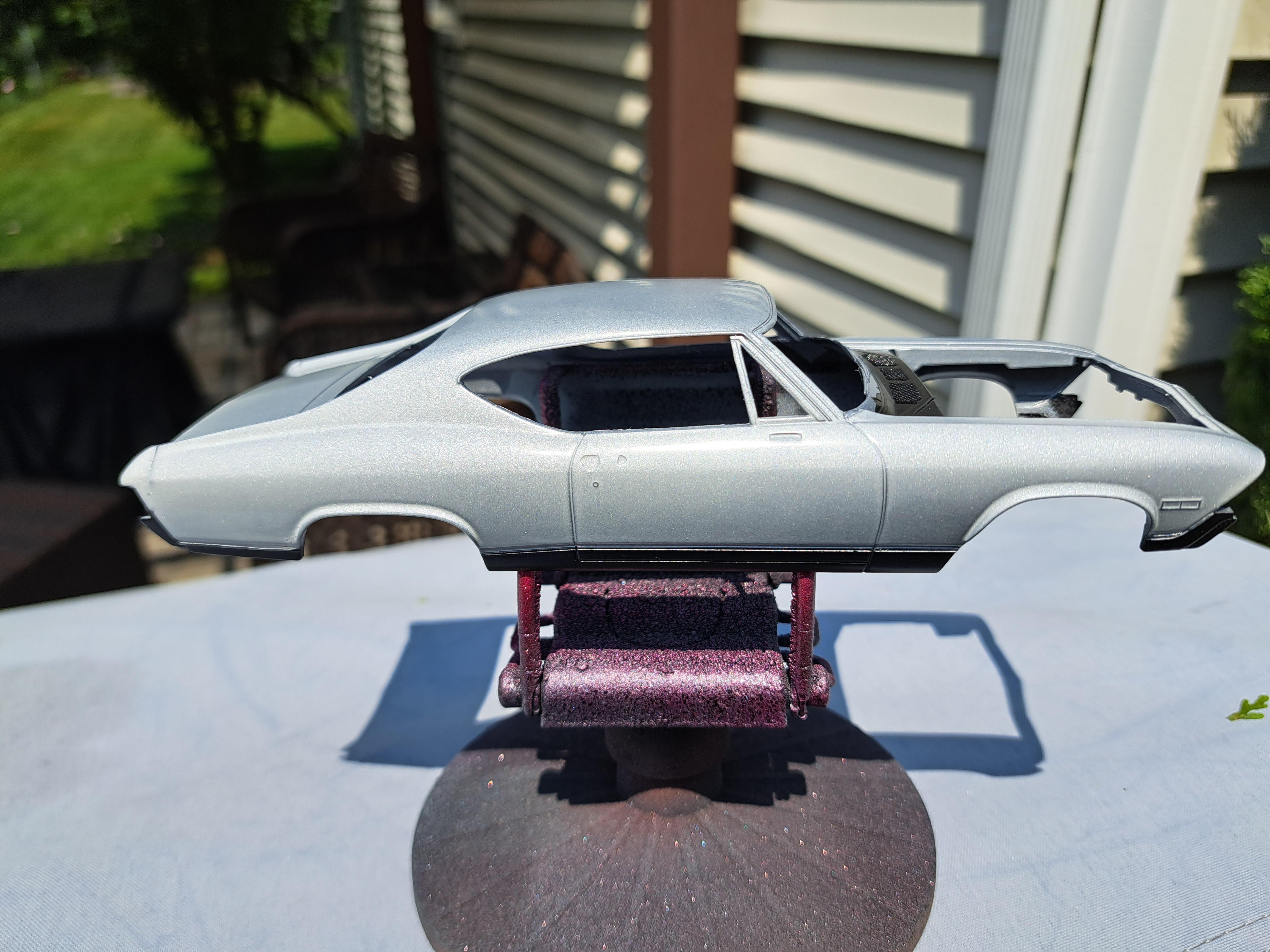

This chevelle has 3 coats of white lighting over dark gray duplicolor dark gray. After the first coat, it took on a silvery blue color. After the 2nd two it looks as you see. Not quite full white, but looks pretty good. As I'm sure you know, with a dark base and a very light top coat, you gotta ensure all the panel match in hue. The pics were taken outside to help bring out the pearl. Hope this helps.20230809_133542.thumb.jpg.6aac3881cb291d14e92b762628d5d67c.jpg20230809_133532.thumb.jpg.90203dfd3cef2b7ba9dbc42b07615c18.jpg

If you want white pearl then you will need white primer or a white base coat under it. If you don't have white under it you will get a color cast from what is under it. This sometimes might be wanted, like I might use rose gold for instance. But if you want white you need white under the pearl finish in my experience.
