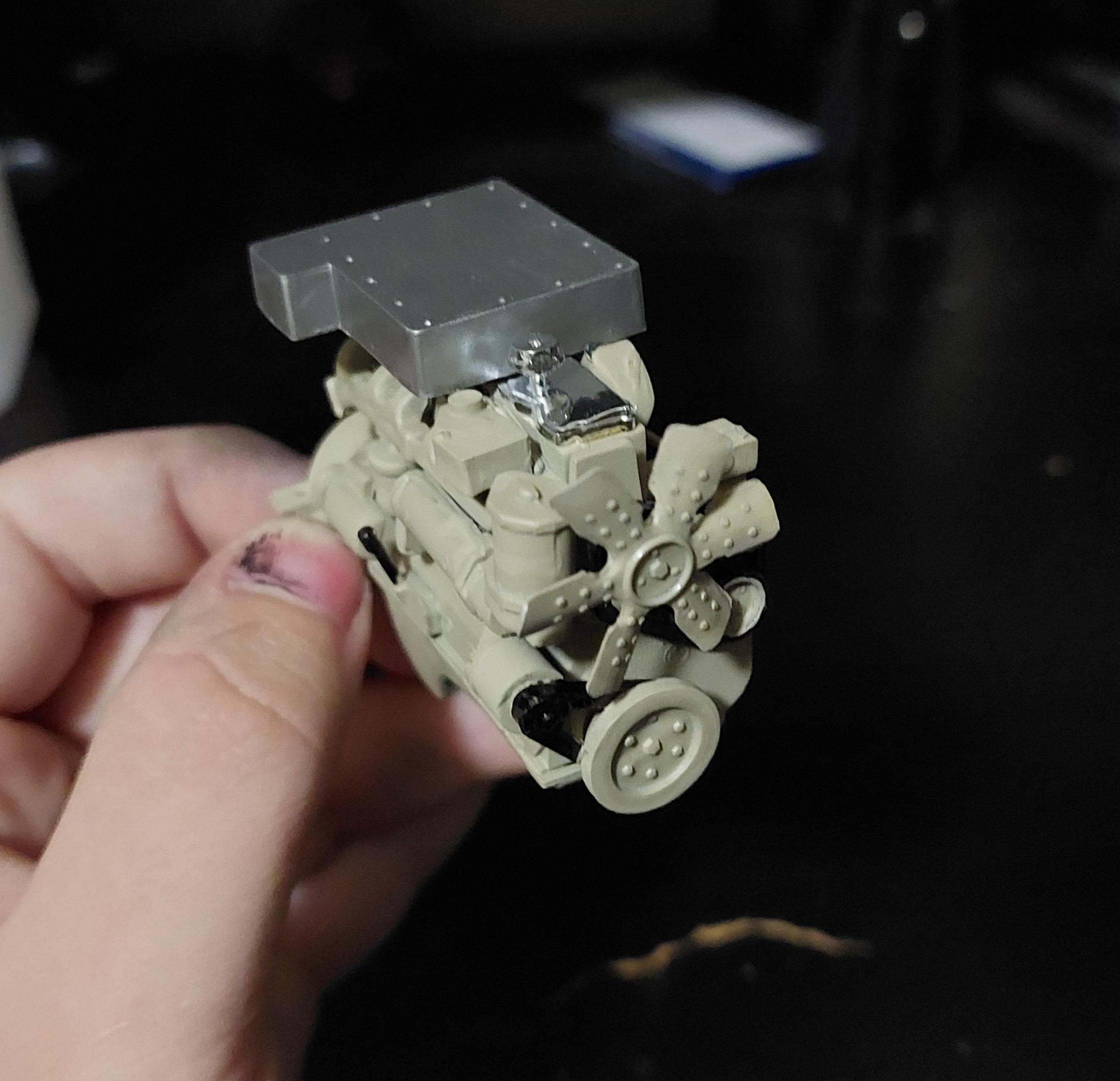

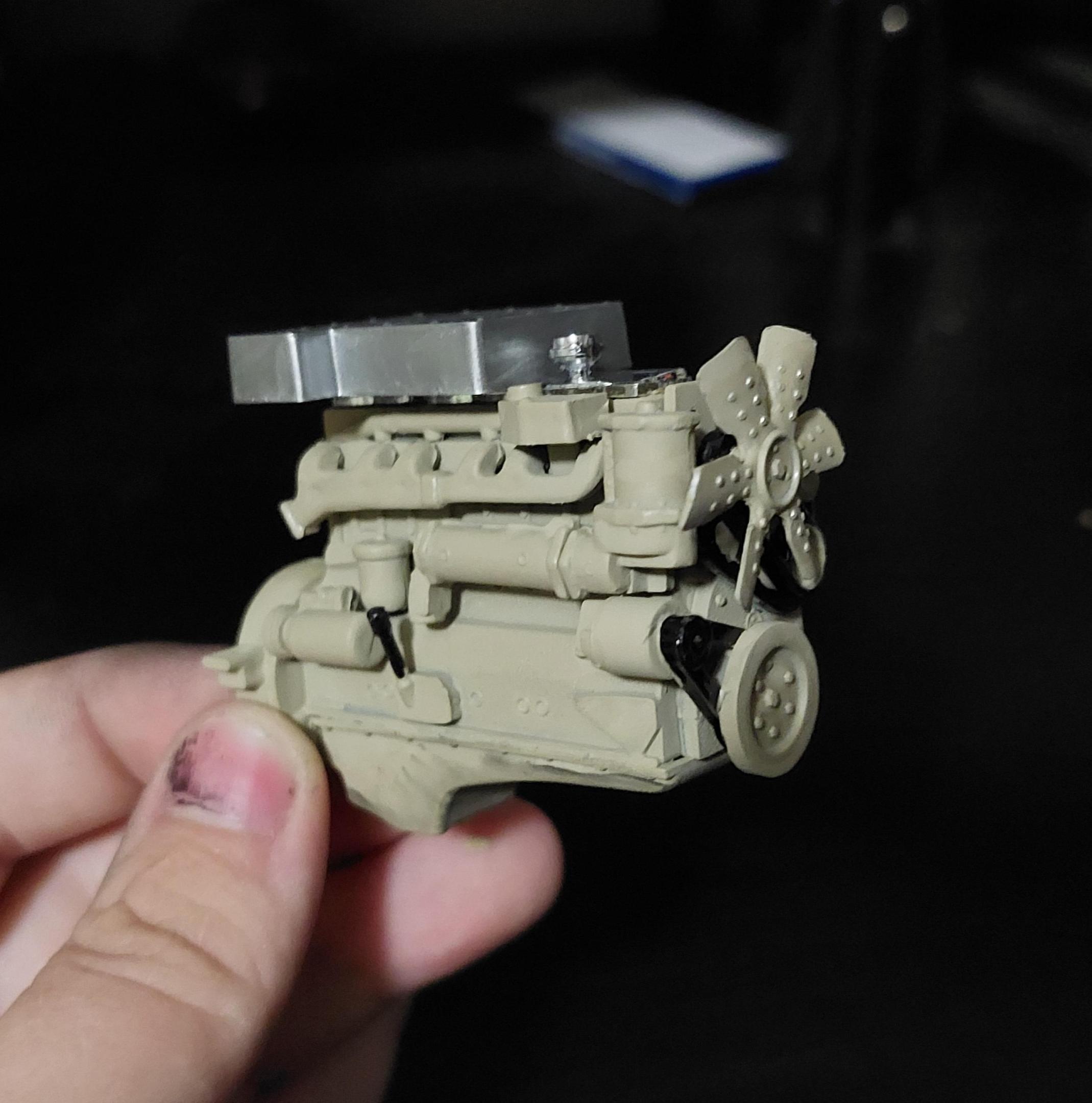

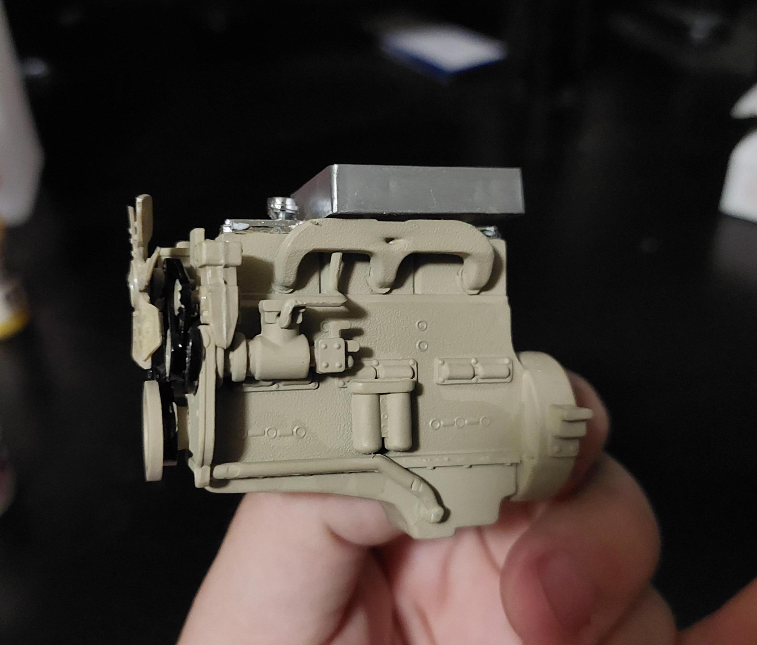

Devyn Posted August 22 Author Share Posted August 22 Starting right off I already began on the engine today and I'm pretty proud of it. Black primer and carefully sprayed Tamiya Buff to not get a complete tan and show those shadows, and also getting that dark muted tan that the Cummins NHC engines I've found are. Also dabbled with some light grey wash/panel liner to further the shadows on those smaller details I also experimented with some colors. The testors metallic red ran dark so I experimented with some undercoats and found yellow to bring out the best of the red shade. Unfortunately I don't have that result pictured 1 Quote Link to comment Share on other sites More sharing options...
Rockford Posted August 22 Share Posted August 22 I DO like a Cummins. Well done with it. 1 Quote Link to comment Share on other sites More sharing options...

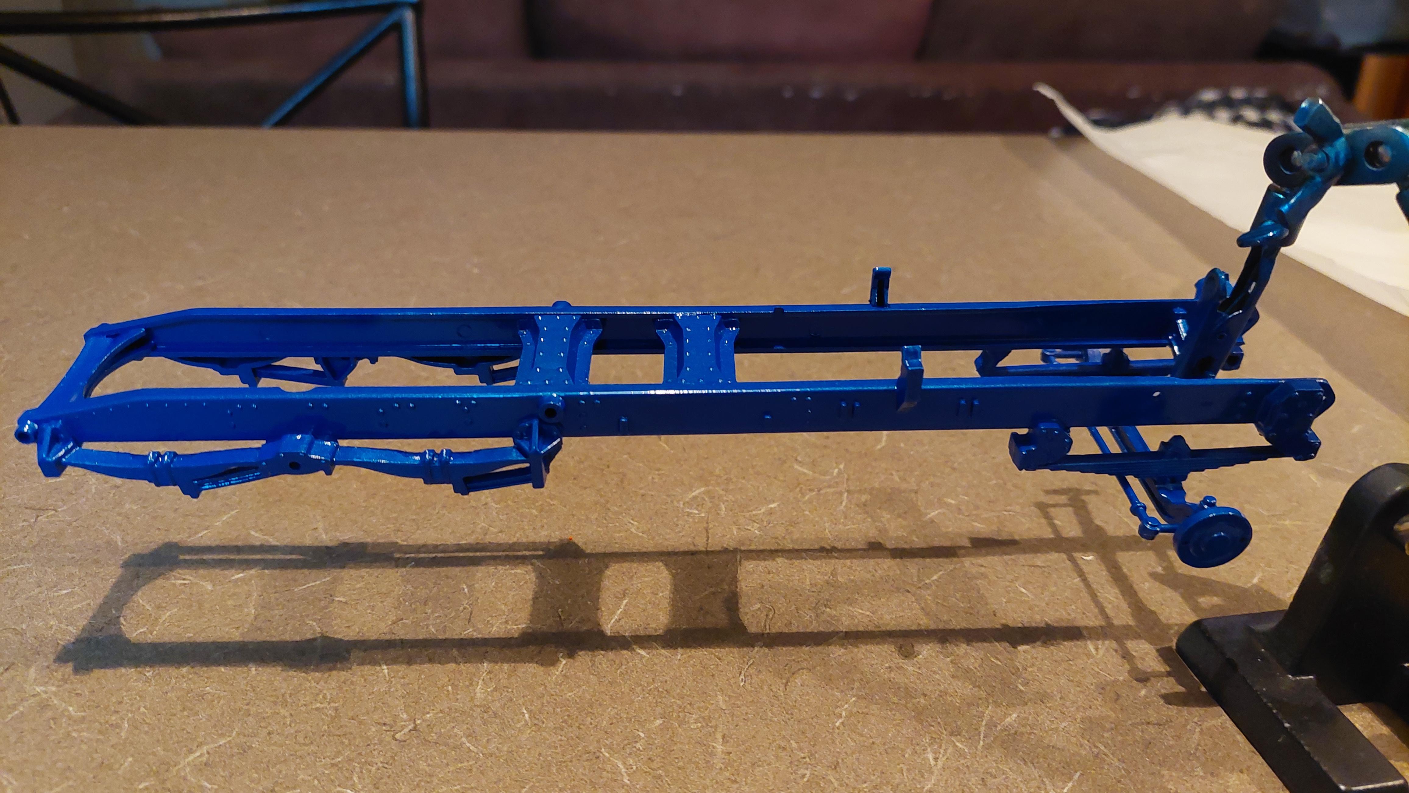

Devyn Posted August 25 Author Share Posted August 25 Small update while I'm waiting on the majority of my supplies to come in the mail. I glued together the frame, and to add some mass to the blue section of the truck that somehow become his whole lower legs, I included the steering part of this gluing and painting stage. The rear differentials, axles, and gearboxes will be black to emulate the reference picture below. To get the blue I got, I sprayed a bunch of Vallejo blue onto the frame, and then topped it with testors spray enamel metallic blue. It's the best blue I've gotten experimenting with undercoats and different paints. I've also added the transmission to the Cummins and painted it my own mix of steel, test fit a bunch of the cab and interior parts to see where I can place some locate tabs when I glue the cab together, glued together the differentials, and I'm working on gluing together the wheels. At least, the parts I know glue together. I have no idea how to glue the wheels to the frame to ensure they still spin and I also don't know how the engine and transmission are supposed to attach to the frame. If anyone could help show me how those work that would be amazing. I'm still debating how I want the cab to work. I have a full interior color scheme planned, I just have a bunch of ideas for the stripe. I don't know if I should go straight like the toy, or do a cool 45° upward like in the truck below. Anyways, off to a new weekend of modeling Quote Link to comment Share on other sites More sharing options...

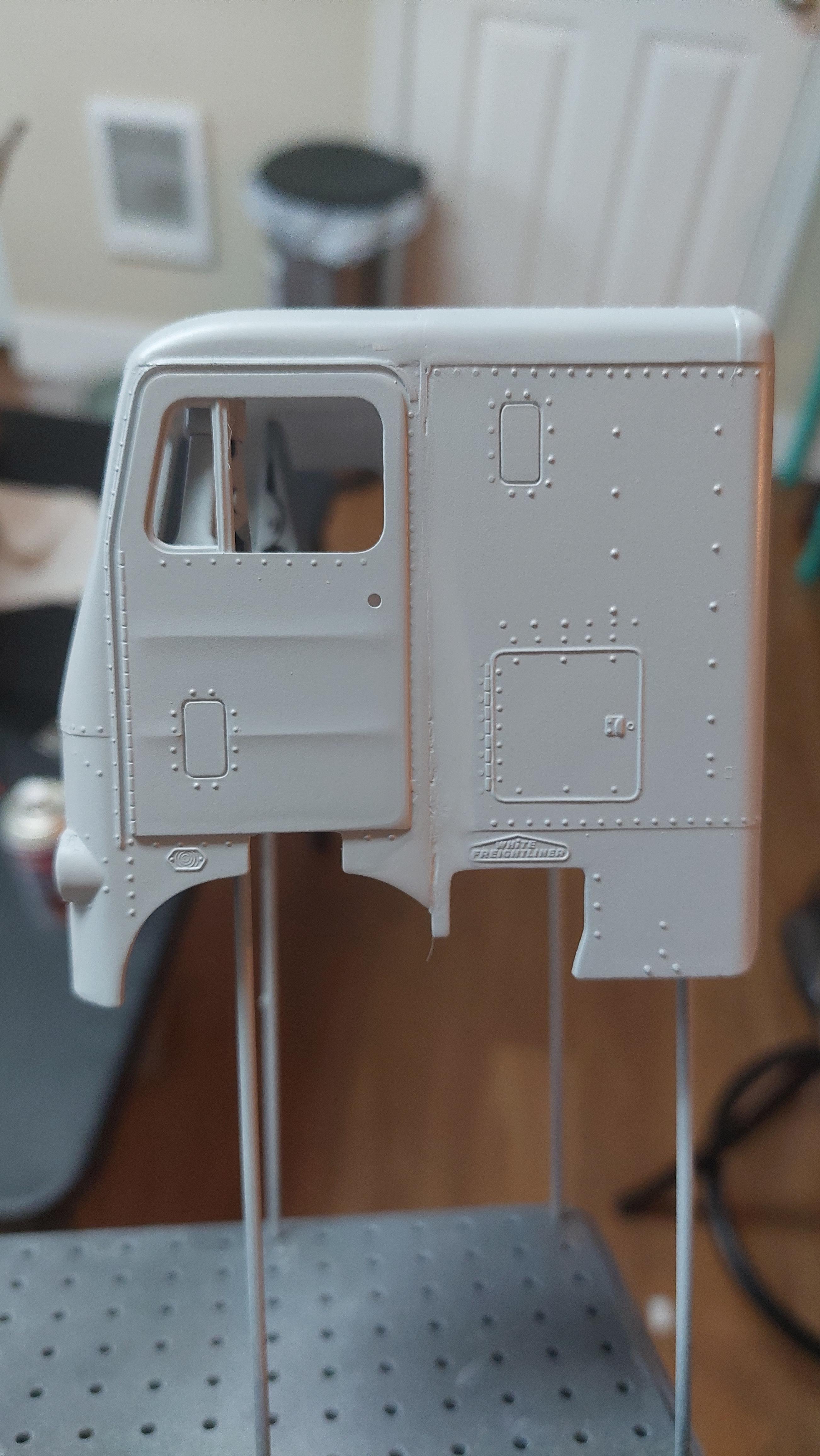

Devyn Posted August 28 Author Share Posted August 28 Fighting for my life with this seamline but I'm probably gonna have to call it before I lose any more detail. Bought some archer transfers for the rivets but I don't know what I'm gonna do about that center line down the top of the cab and the tiny "White-Freightliner" logo near the steps 1 Quote Link to comment Share on other sites More sharing options...
Rockford Posted August 28 Share Posted August 28 The notorious Freightliner joint! I don't envy you that job. I'm sure you'll sort it. 1 Quote Link to comment Share on other sites More sharing options...
Devyn Posted August 28 Author Share Posted August 28 15 minutes ago, Rockford said: The notorious Freightliner joint! I don't envy you that job. I'm sure you'll sort it. I did a little bit more sanding but I'll have to call it good. I'm hoping all the chrome pieces, a lot of chrome trim, and the slightly thick metallic red will distract from it Quote Link to comment Share on other sites More sharing options...
Muncie Posted August 28 Share Posted August 28 I saw the real truck at Freightliner in the Daimler Truck lobby a couple of months ago. Certain things I wouldn't worry about on this build, it's looking good. The AMT Freightliner COE is a kit that goes back to the early 1970's and has its problems. The truck that you are building is based on a Freightliner COE from the 1990's so there are some differences (like the doors and fewer rivets) just in the basic cab. People won't be looking at the details on the cab, probably best to remove the emblem and marker light on the cab skirt, smooth as many rivets as you want and make the seams disappear. The cool part will be all of the Transformer/Optimus Prime pieces that you build on the chassis. Looking forward to this one! 1 Quote Link to comment Share on other sites More sharing options...
Devyn Posted August 28 Author Share Posted August 28 1 minute ago, Muncie said: I saw the real truck at Freightliner in the Daimler Truck lobby a couple of months ago. Certain things I wouldn't worry about on this build, it's looking good. The AMT Freightliner COE is a kit that goes back to the early 1970's and has its problems. The truck that you are building is based on a Freightliner COE from the 1990's so there are some differences (like the doors and fewer rivets) just in the basic cab. People won't be looking at the details on the cab, probably best to remove the emblem and marker light on the cab skirt, smooth as many rivets as you want and make the seams disappear. The cool part will be all of the Transformer/Optimus Prime pieces that you build on the chassis. Looking forward to this one! This brings some ease to mind. Thank you. One sides logo looks fine but the other doesn't so I'll probably sand one away and try to keep the other (I'm a fan of it). I have archer transfers coming so any rivets are no worry. And I can bring back door panel trim with a touch of silver or chrome. The only thing uniquely Optimus going into this is the logos. Trying to go for realism. Paints and plastic for the trailer came in so maybe I can work on that while I wait on the rivets. Again I really appreciate your input! Quote Link to comment Share on other sites More sharing options...

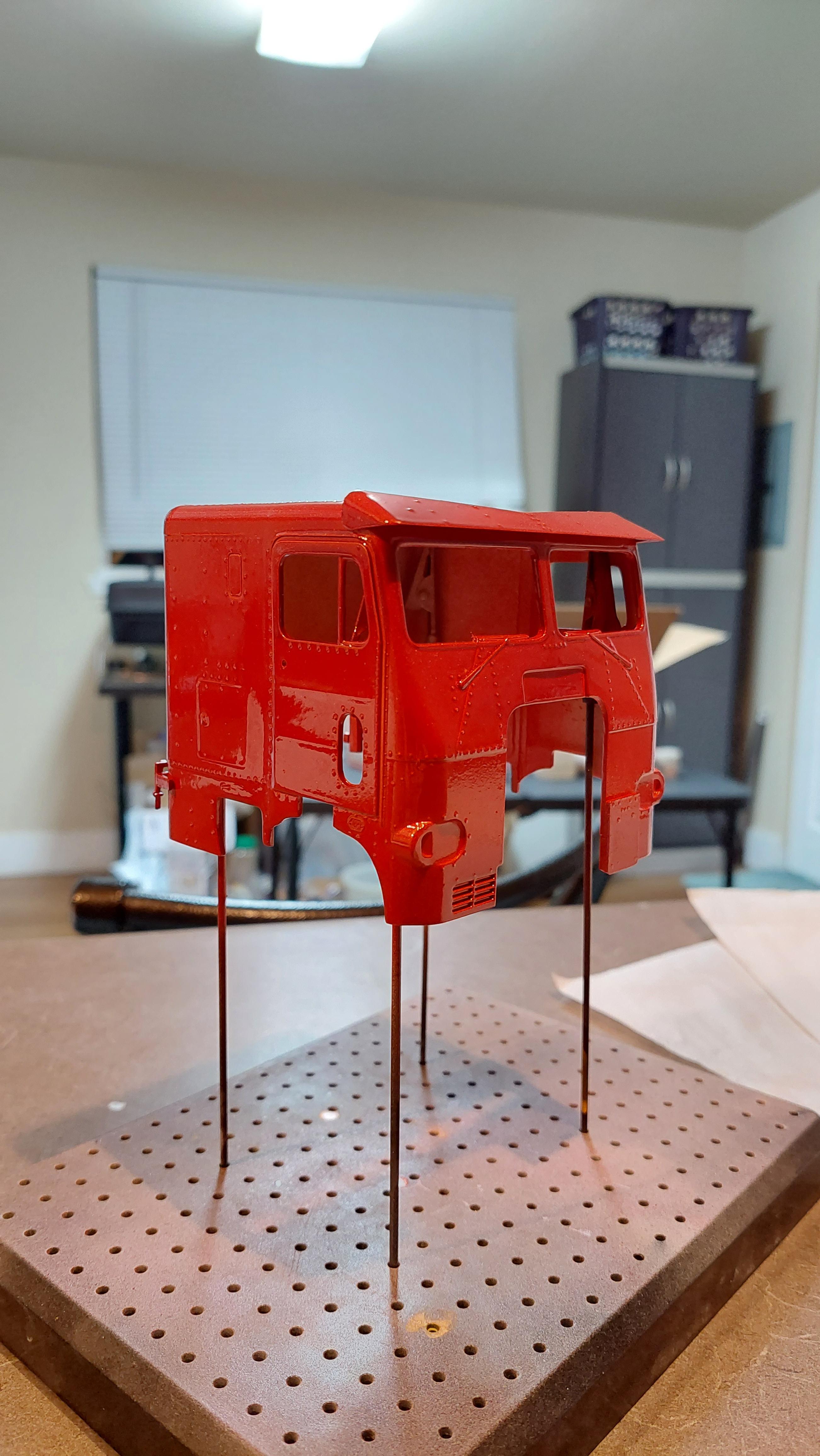

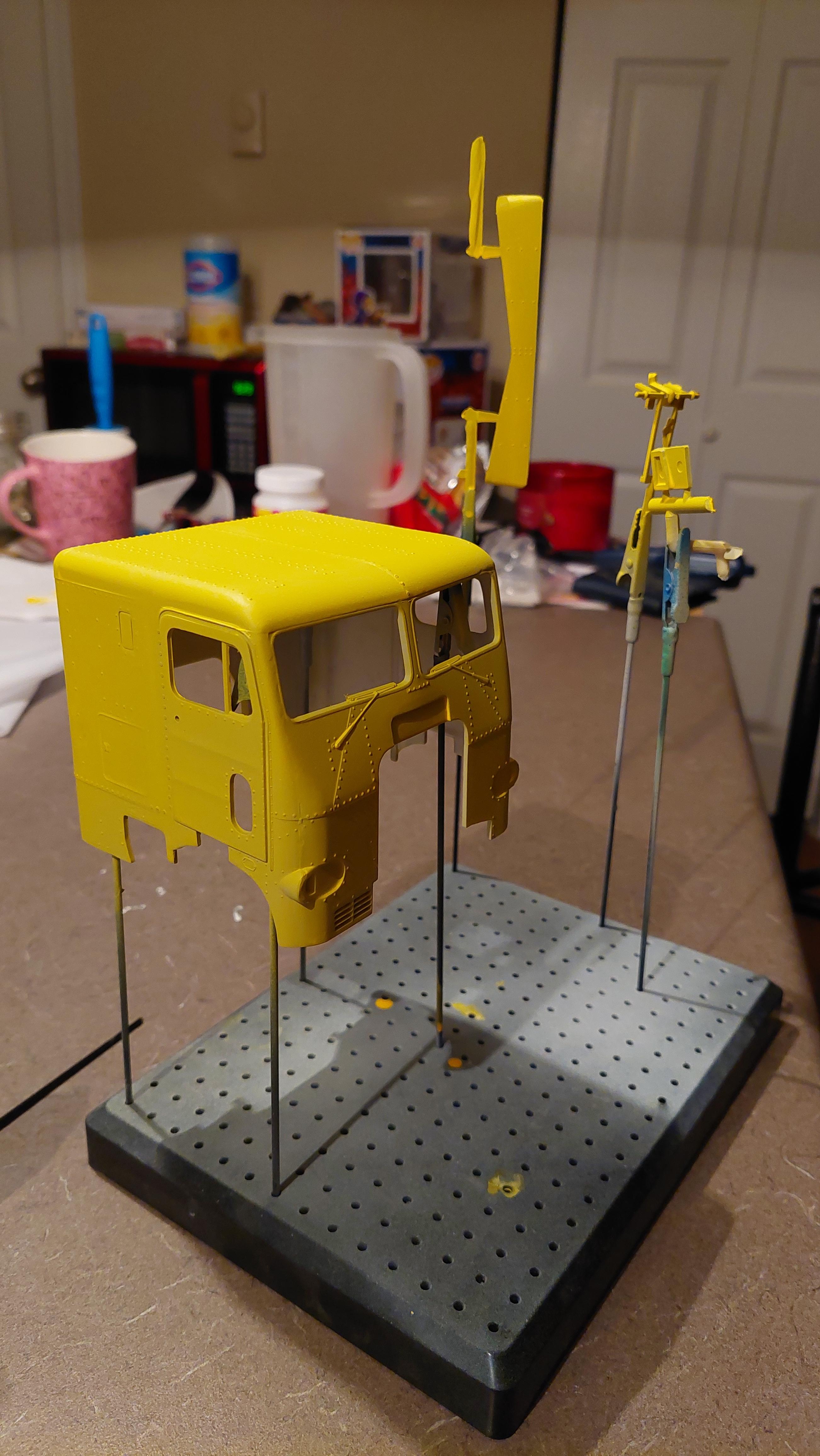

Devyn Posted September 8 Author Share Posted September 8 Alright! Red has been painted. As shown in the pictures below, this was achieved with a base coat of thinned Vallejo yellow (this coat came out a little grainy and it slightly shows in the final product upon close inspection). With testing, this showed to result in the brightest red from the next paint I used: Testors enamel metallic red rattle can. Overall really proud of it and probably wouldn't change a thing. I'll let it sit a bit, gloss coat, sit even longer, then I'll mask off the silver stripe around the cab. After that, it's nothing but gluing! Then I'll move onto the trailer which is both extremely simple and very complex 3 Quote Link to comment Share on other sites More sharing options...
