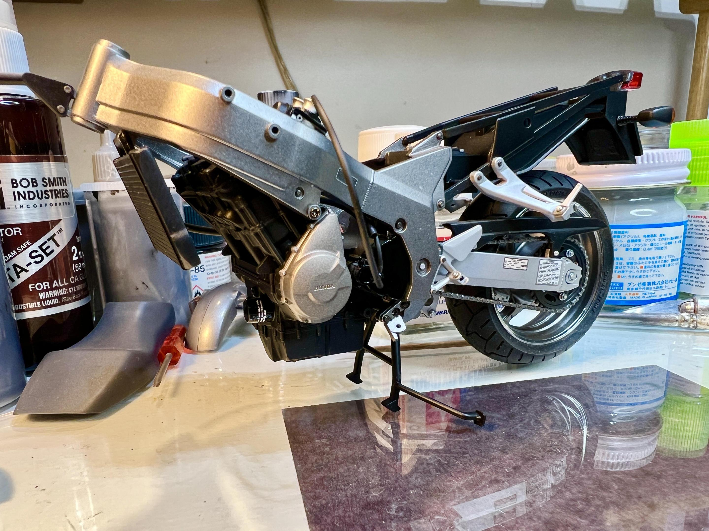

Wolf Posted August 31, 2023 Author Share Posted August 31, 2023 Construction starts with the frame, which makes sense, considering that everything you build after step #1 will attach to the frame. It's here that I encountered my first deviation from the kit instruction colour call outs. Tamiya says the bike is offered in Titanium Metallic, Mute Black Metallic, and Candy Muthos Magenta which I'll call Red for simplicity sake. Tamiya's colour call outs are applicable to the Titanium and Mute Black schemes but not the Red despite the fact that Tamiya gives you decal options for all three schemes. An internet search provided me with the colour photos of the bike in the Red scheme but it was up to me to decide exactly which colours I'd use so some custom colour mixing was going to be in order. As so many components that attach to the basic frame are different colours creative masking was also required. I suck at painting with a brush other than detail painting so 95% of my paint work is done with the airbrush. The frame is finished with all the colours and decals applied. A lot more creative masking will need to be done as more components are assembled and installed. Now on to the rear suspension, tire and rim, chain assembly, and rear brake caliber. Wolf (who used to ride but now prefers his Mercedes SLK 230) 1 Quote Link to comment Share on other sites More sharing options...

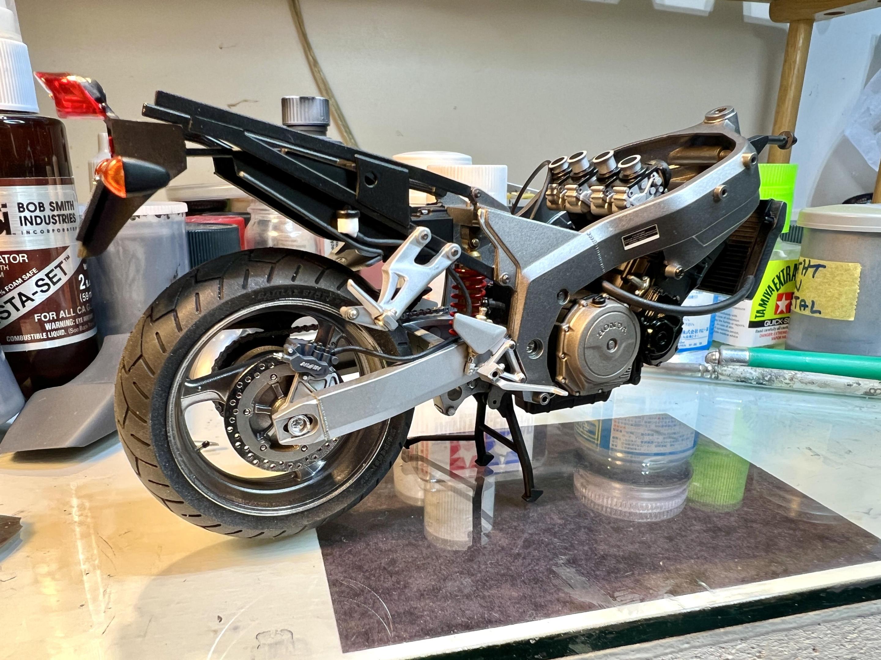

Wolf Posted September 2, 2023 Author Share Posted September 2, 2023 (edited) I made some nice headway on the rear suspension. The rear brake rotor had all the cooling holes drilled out using the molded dimples as a guide. Then the separate components were painted and a top studio brake bleeder valve was added to the rear caliper. These are beautifully machined and even the end is machined open! The rear rim was sprayed with Tamiya's Light Gun Metal lacquer and then the rim was masked off leaving just the outside edge exposed. That was painted Tamiya's Gloss Black lacquer and then Alclad II Polished Aluminum as per the photos I found online. The rest was painted as per the kit colour call outs and then the whole thing assembled. As with the frame, lots of masking was involved, and I'm happy with the results. Cheers, Wolf (who's enjoying being retired!) Edited September 2, 2023 by Wolf 2 Quote Link to comment Share on other sites More sharing options...

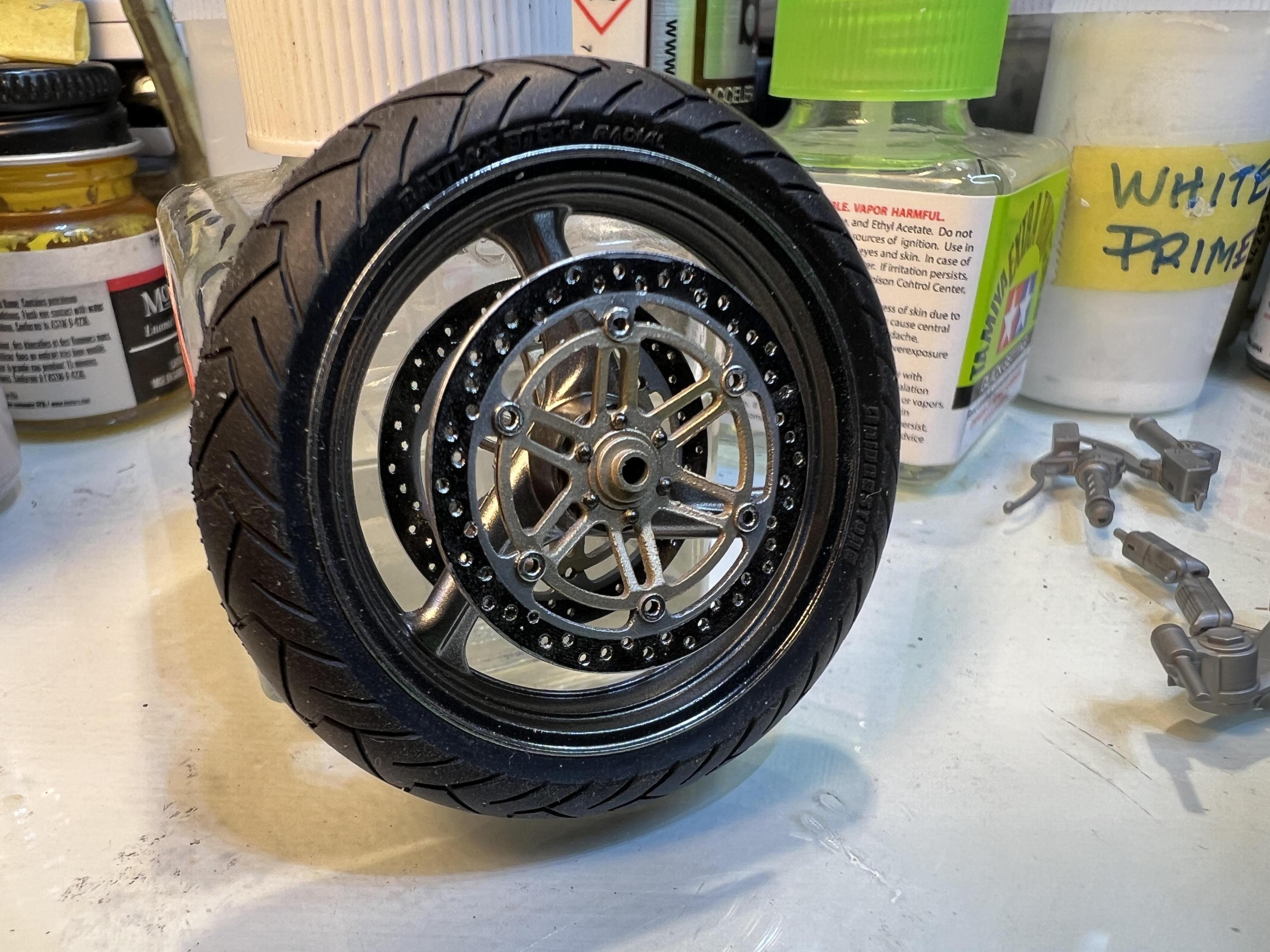

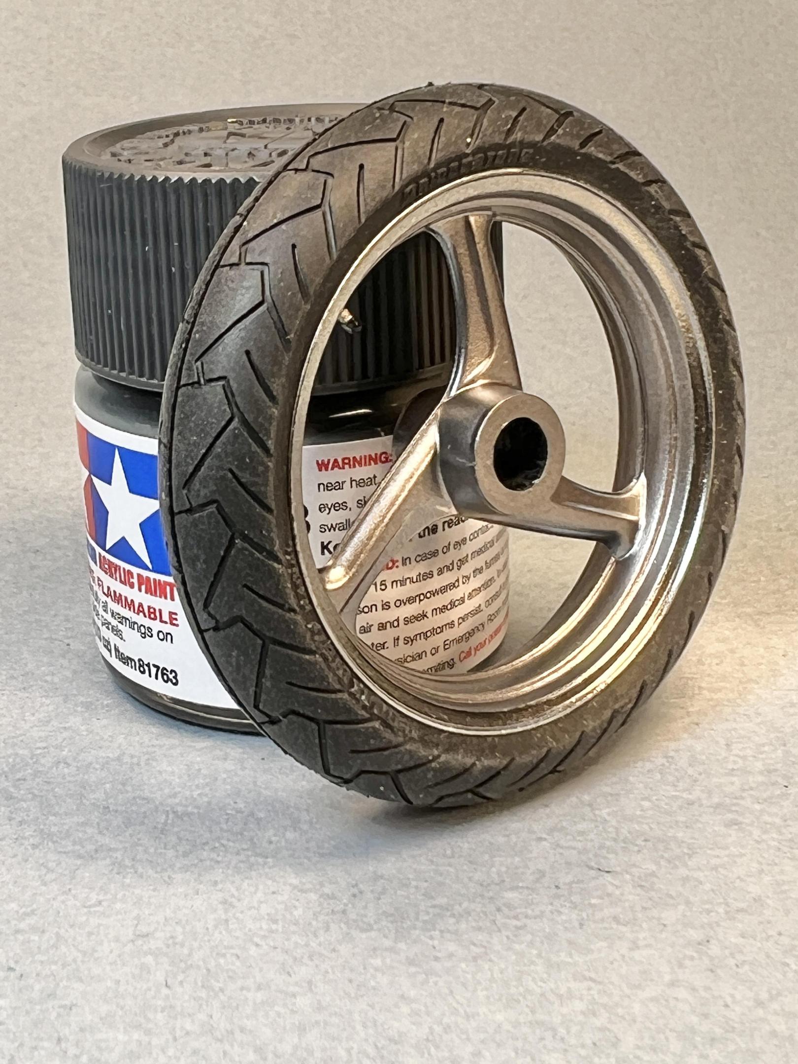

Wolf Posted September 4, 2023 Author Share Posted September 4, 2023 A little out of sequence, if you’re following the instructions but I figured I would do the front wheel right away as well. Painting was done the same as the rear wheel. The brake discs were drilled out and painted as per the online photo I found of the bike in the red colour scheme. Cheers, Wolf (who’s amazed at how much dust attracts to the rubber tires) 1 Quote Link to comment Share on other sites More sharing options...

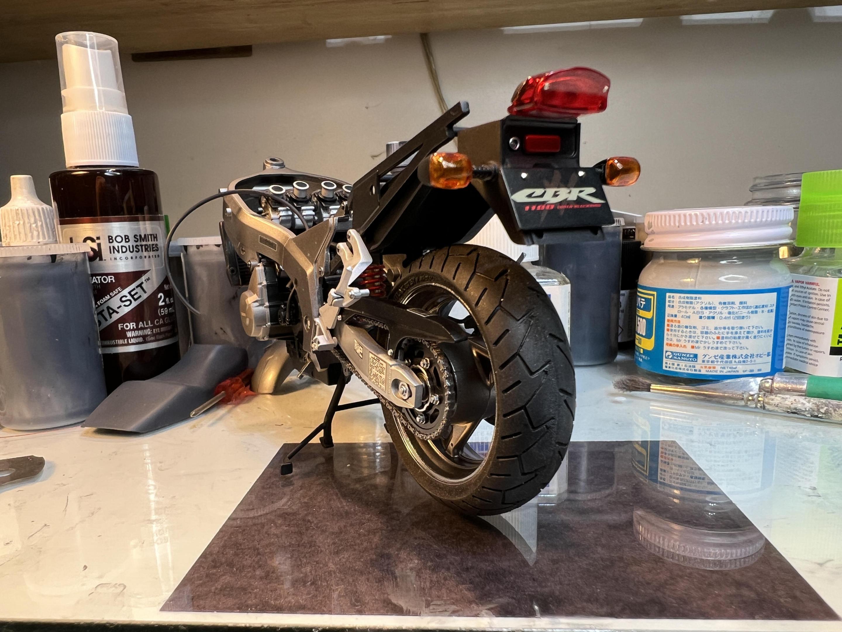

Wolf Posted September 11, 2023 Author Share Posted September 11, 2023 ....and the beat goes on, yeah the beat goes on. Sorry Sonny and Cher...... Just a small update. The tail light lens, turn signal assembly, and licence plate holder are done. Two 0.9mm Top Studio rivets were used as fasteners for the licence plate bracket and two tiny PE screw heads were placed in the dimples on the tail light lens. The screw heads were secured with a drop of future (or whatever it's called now) floor wax. The chrome circular detail next to the red reflector is the lock cylinder for releasing the seat to access the battery. All the lenses come clear so they were sprayed with multiple coats of Tamiya's acrylic clear red and orange. Next step is attaching this and the engine to the frame. Cheers, Wolf Quote Link to comment Share on other sites More sharing options...

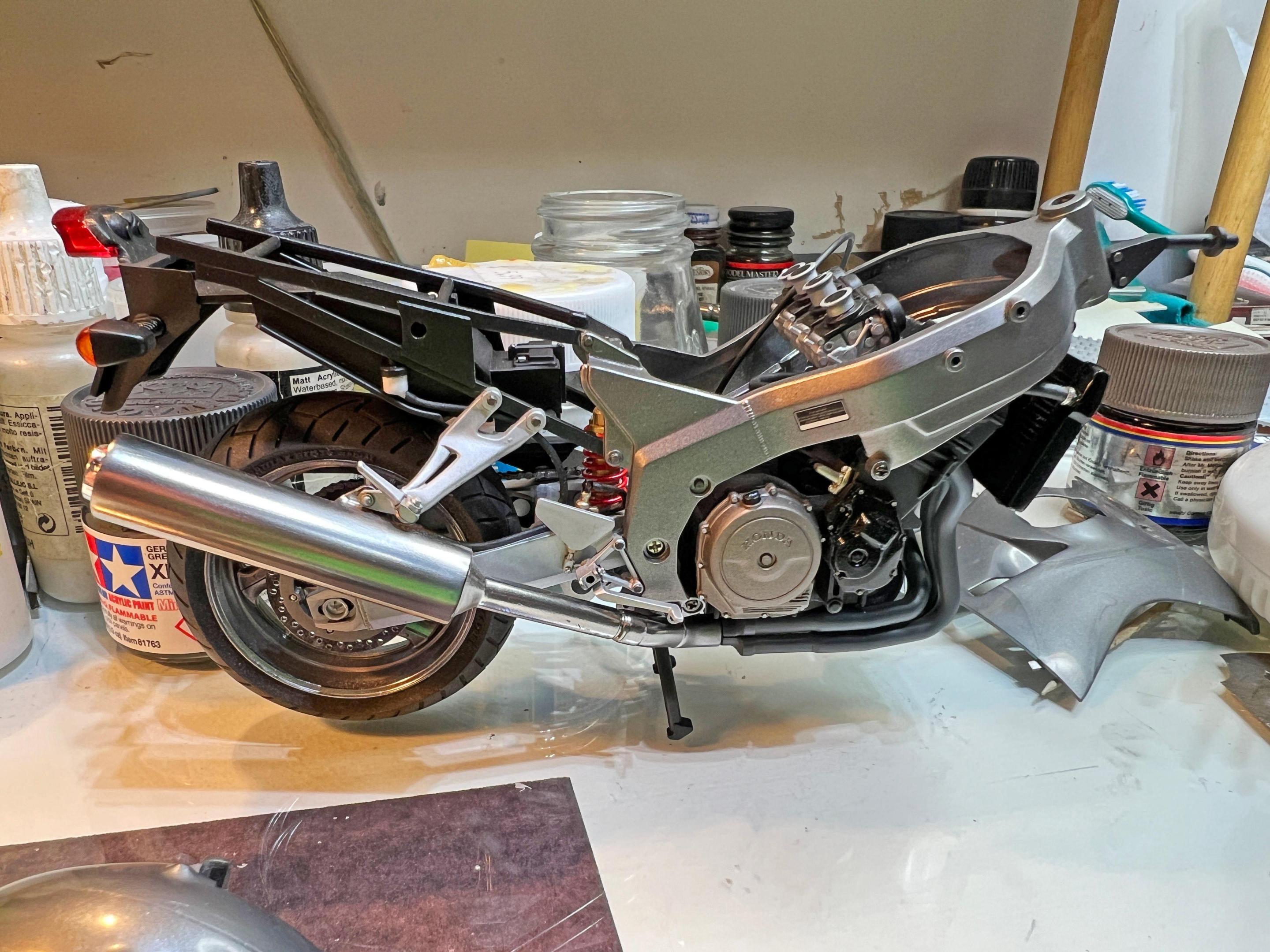

Wolf Posted September 21, 2023 Author Share Posted September 21, 2023 We have exhaust! The exhaust comes on the chrome sprues with the mufflers split lengthwise. Tamiya molded the sprue attachments on the gluing surfaces of the mufflers so that with careful trimming you won't mar the chrome finish. Nonetheless you're still left with a visible seam on top and bottom of the mufflers. To eliminate those I stripped off the chrome, sanded and filled the seam, and then polished the plastic to ensure a perfect finish for Tamiya's gloss black lacquer paint. Once the gloss black had dried I sprayed the mufflers with Alclad II Chrome. It's not as shiny as the kit chrome but it came out quite nice. The only kit chrome remaining on the exhaust is the very end of the mufflers where the exhaust exits. I also assembled the front fork assembly and installed it temporarily just to see how it was going to look. Lots more to do but it's getting' there, eh? Cheers, Wolf (who's wife doesn't like the smell of exhaust in the house) Quote Link to comment Share on other sites More sharing options...
SpikeSchumacher Posted September 21, 2023 Share Posted September 21, 2023 Looks really good Wolf. I actually like the contrast of your painted exhaust with the bit of shiny kit chrome. Adds more visual interest. Keep up the great work! 1 Quote Link to comment Share on other sites More sharing options...
Wolf Posted September 23, 2023 Author Share Posted September 23, 2023 Thank-you Mathias! I was quite pleased with how the exhaust, and particularly the mufflers, turned out. I was concerned I wasn’t going to get the results I was hoping for with the Alclad II Chrome but it turned out quite nice. I liked the contrast between the kit chrome and Alclad II as well. So far, so good. Cheers, Wolf Quote Link to comment Share on other sites More sharing options...

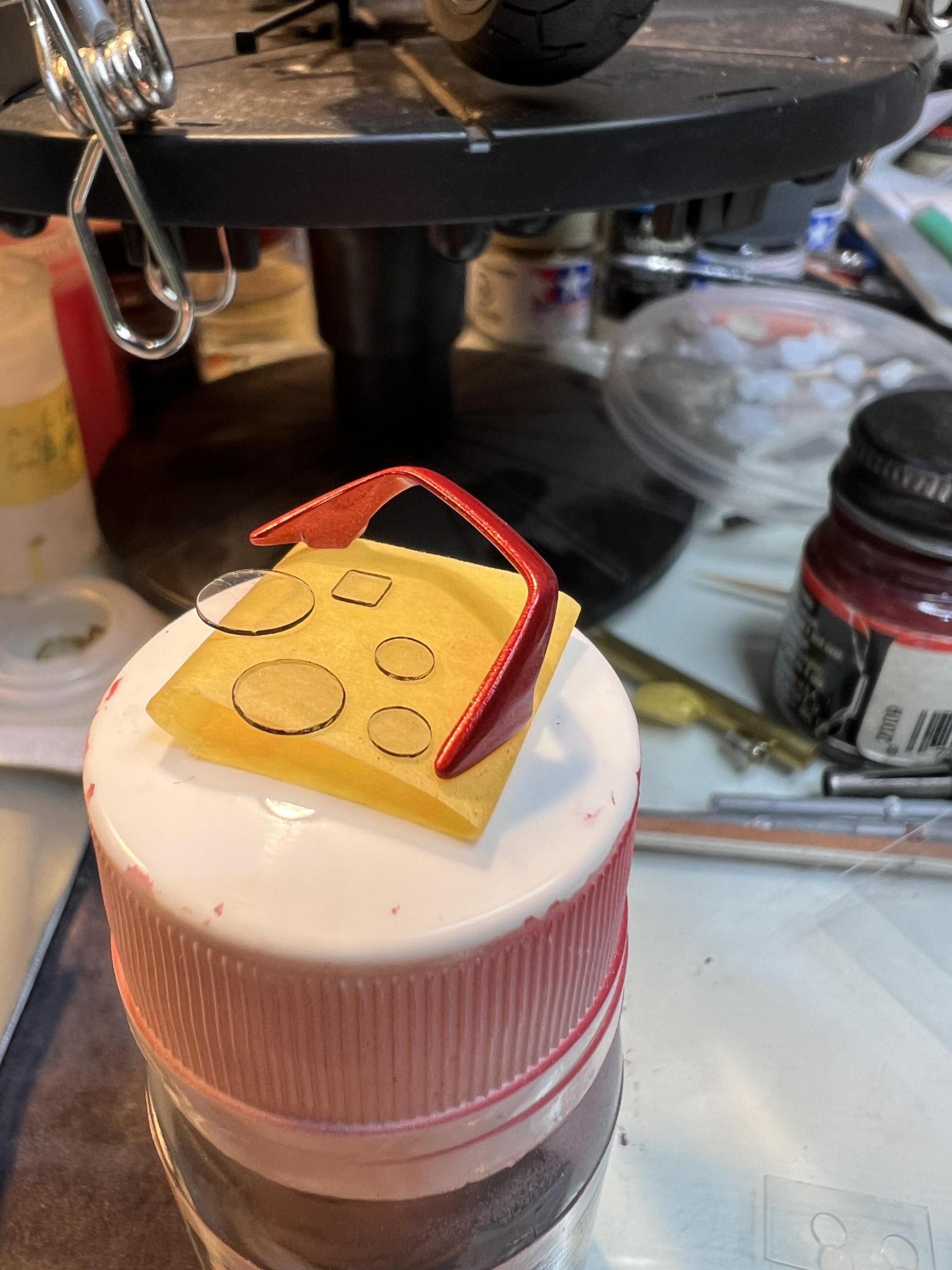

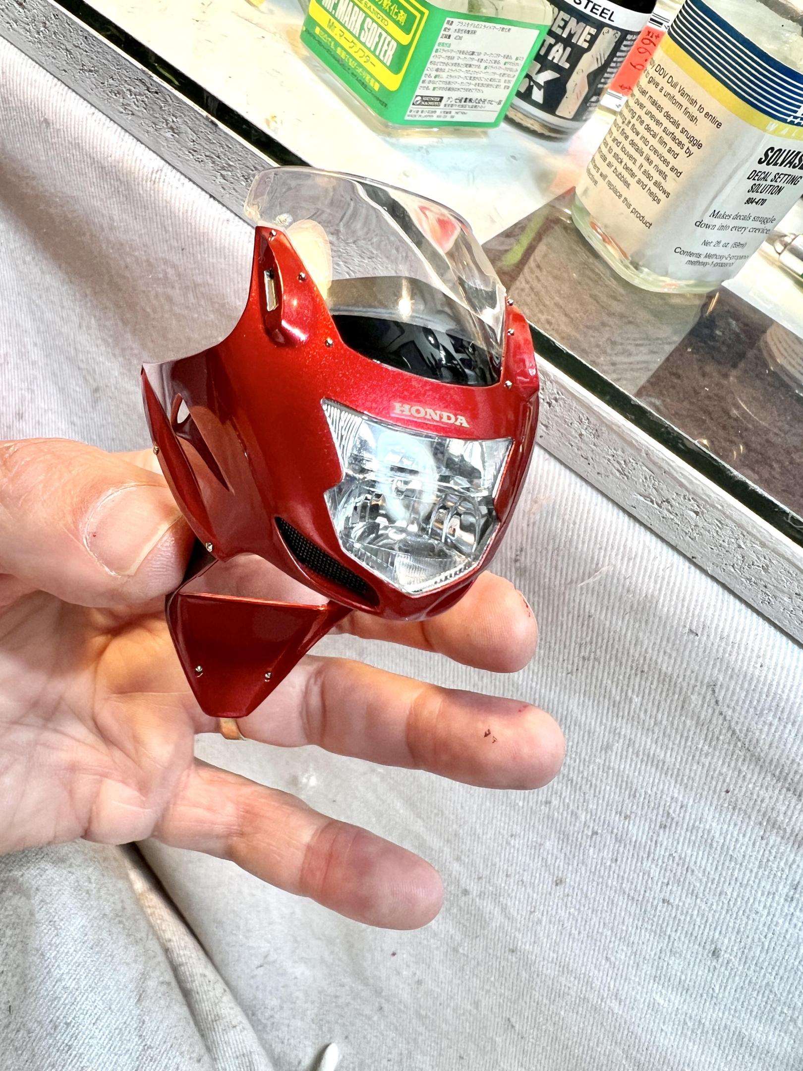

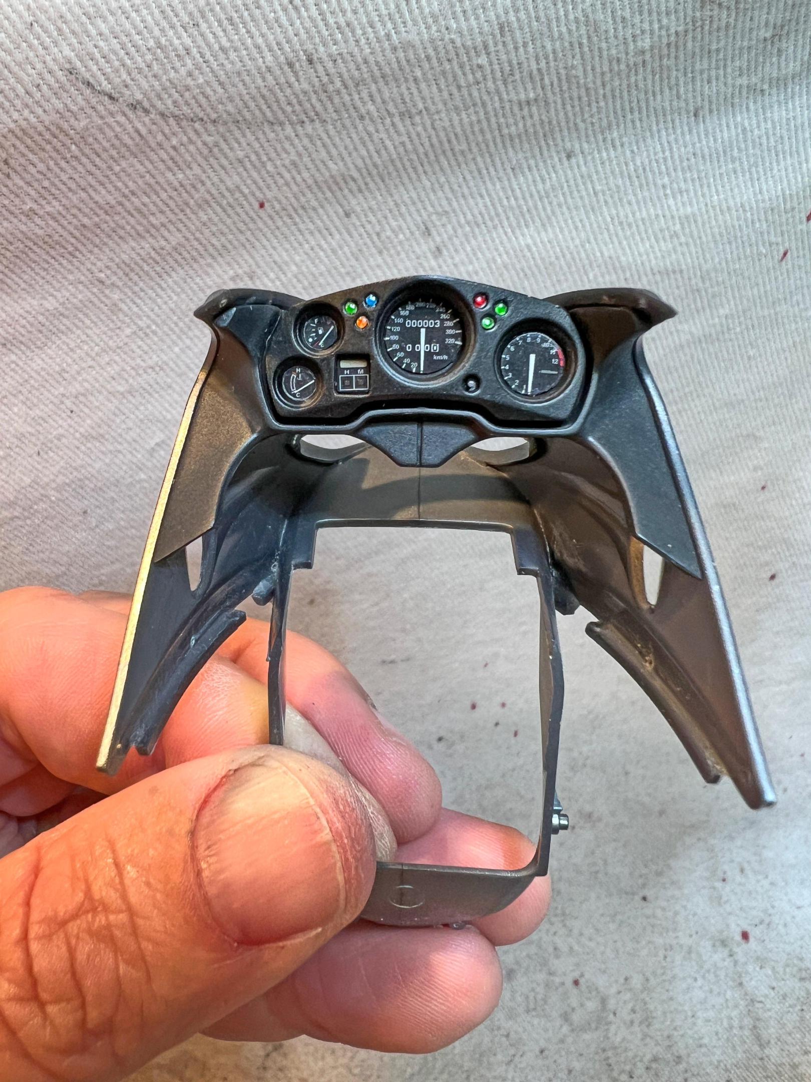

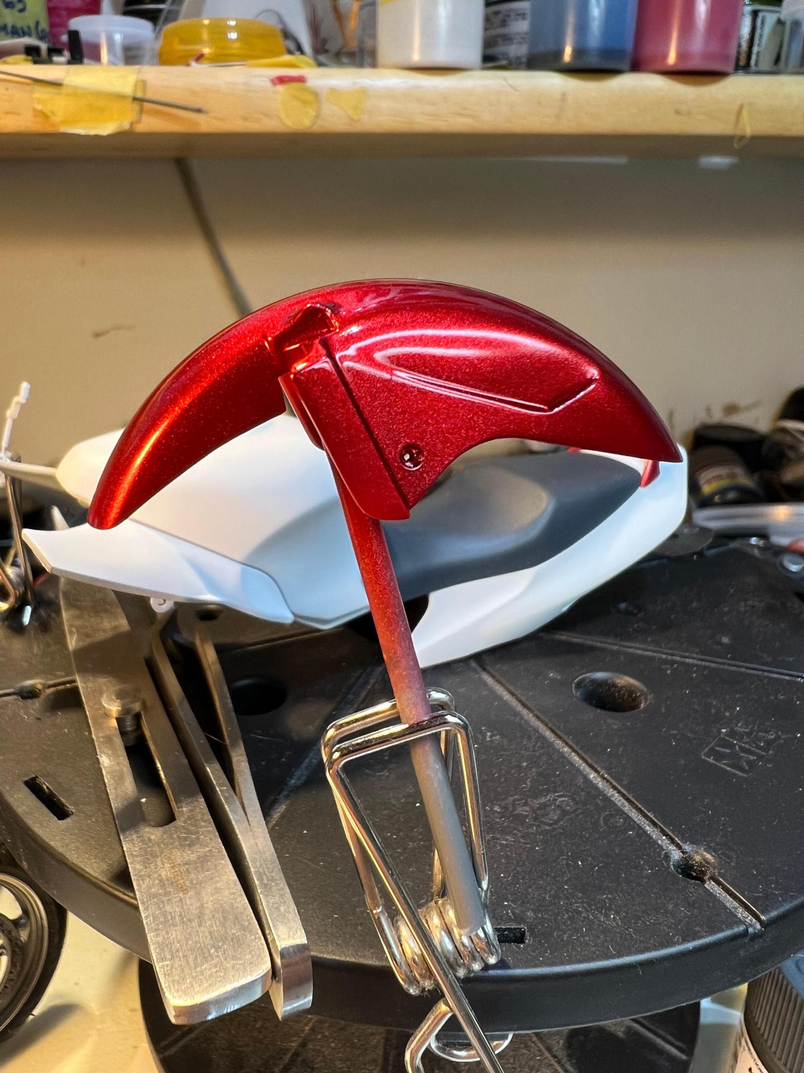

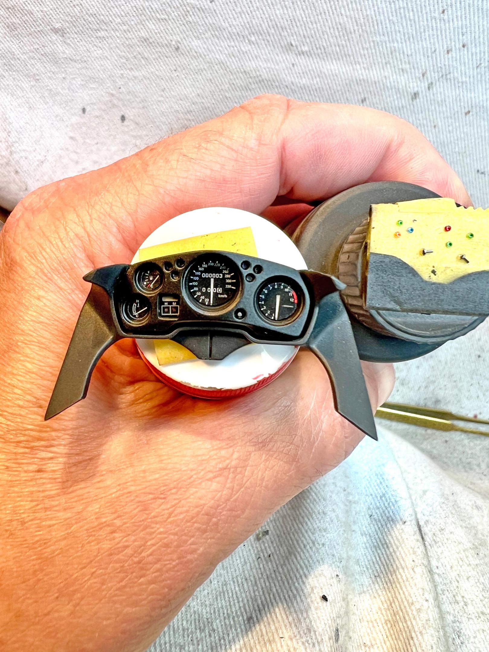

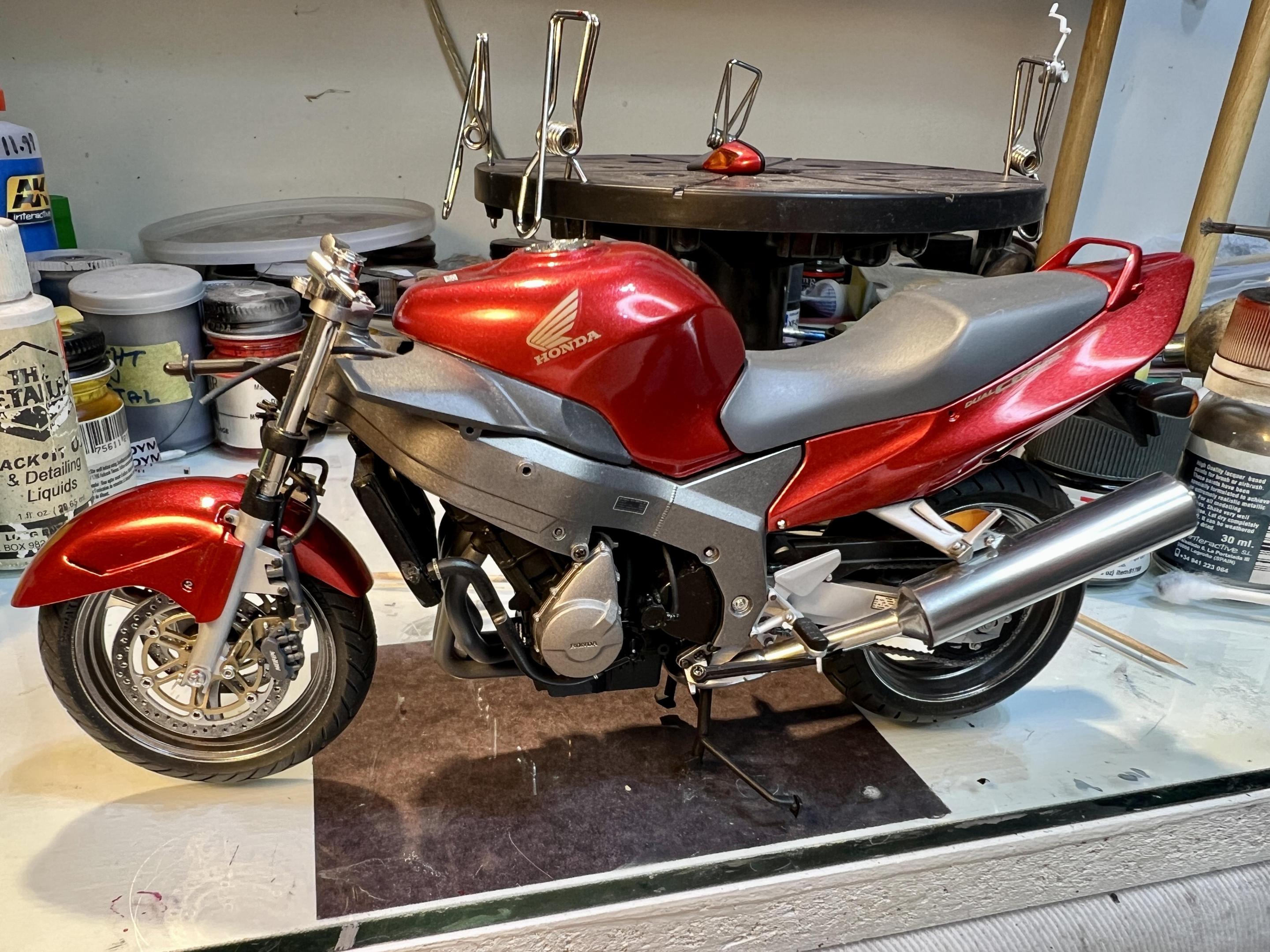

Wolf Posted October 15, 2023 Author Share Posted October 15, 2023 (edited) Things have been moving at the speed of life so it's been a couple of weeks since I posted my last update. This one is a bit bigger as a result. The two halves of the fuel tank cover and rear body cladding assembly were glued together and the seams sanded. They were then painted with Tamiya's white primer and resanded to ensure there were no trace of seams remaining. At the same time I decided to tackle the front fender which needed couple of small modifications. Based on photos found online there are two vents in the front fender that needed opening and also a couple of rivets that need to be added which help secure the front fender in place. Using a small drill bit I chain drilled holes to open up the vents and finished off with an X-Acto knife blade and some sanding. This was easier said than done but in the end I think it was worth the extra effort. I also drilled the holes for the 1.2mm Top Studio rivets I was adding and counter sunk them so the rivets didn't protrude past the fender's outer surface. The fender then got a coat of primer and three nice coats of Tamiya's Pure Red Metallic followed by two coats of Tamiya's TS-13 Clear Gloss. I really like Tamiya's lacquer spray and use it quite a bit, decanted from the spray can, thinned a bit more with lacquer thinner and shot through my airbrush. Next up was the instrument cluster for the bike and it was painted as per the kit instructions. I added the instrument decals and topped them off with clear acetate lenses. The fuel and temperature gauge lenses were punched out with my Waldron Punch and Die set. For the tach and speedo lenses I made punches out of brass tubing. Each lens has it's outer edge blackened with a sharpie before being installed and then secured with Future. The clock/date gauge was a simple square piece with the corners rounded off slightly. Looking at the instrument cluster and comparing it with photos I decided I would add all the various warning lights to the cluster. I punched out tiny lenses with my Waldron Sub-Miniature punch and die set, painted them with the necessary clear colours, backed them with white styrene discs so they wouldn't sit too deep, and locked 'em in place with drops of future. I'm quite happy with the end result. Cheers, Wolf Edited October 15, 2023 by Wolf Quote Link to comment Share on other sites More sharing options...
djmcguire Posted October 16, 2023 Share Posted October 16, 2023 That's some nice work on the fender and especially the instrument cluster with the indicator lights represented... Quote Link to comment Share on other sites More sharing options...
Wolf Posted October 17, 2023 Author Share Posted October 17, 2023 8 hours ago, djmcguire said: That's some nice work on the fender and especially the instrument cluster with the indicator lights represented... Thanks Daniel. Thanks for looking in and leaving a comment. Much appreciated. Cheers, Wolf Quote Link to comment Share on other sites More sharing options...

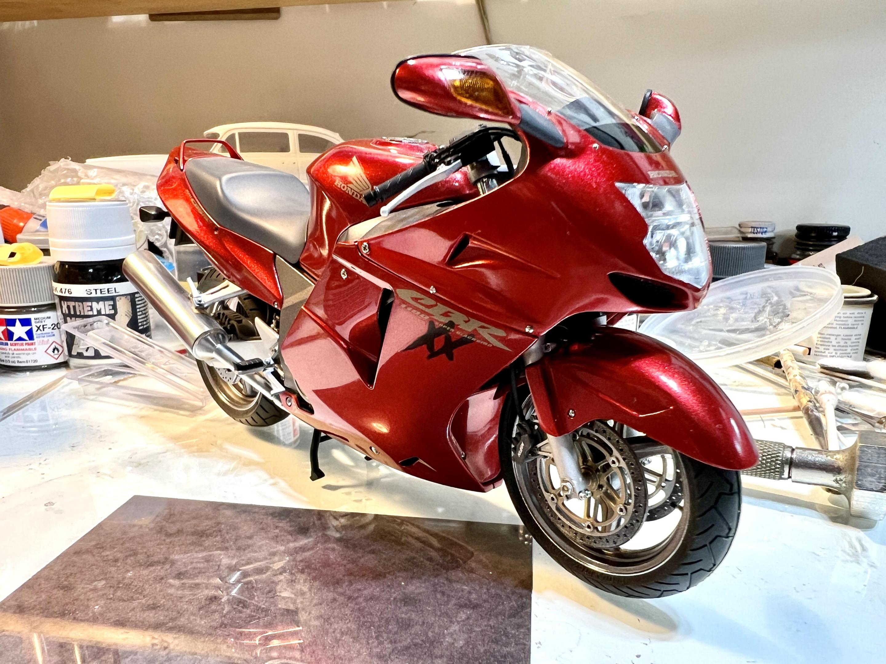

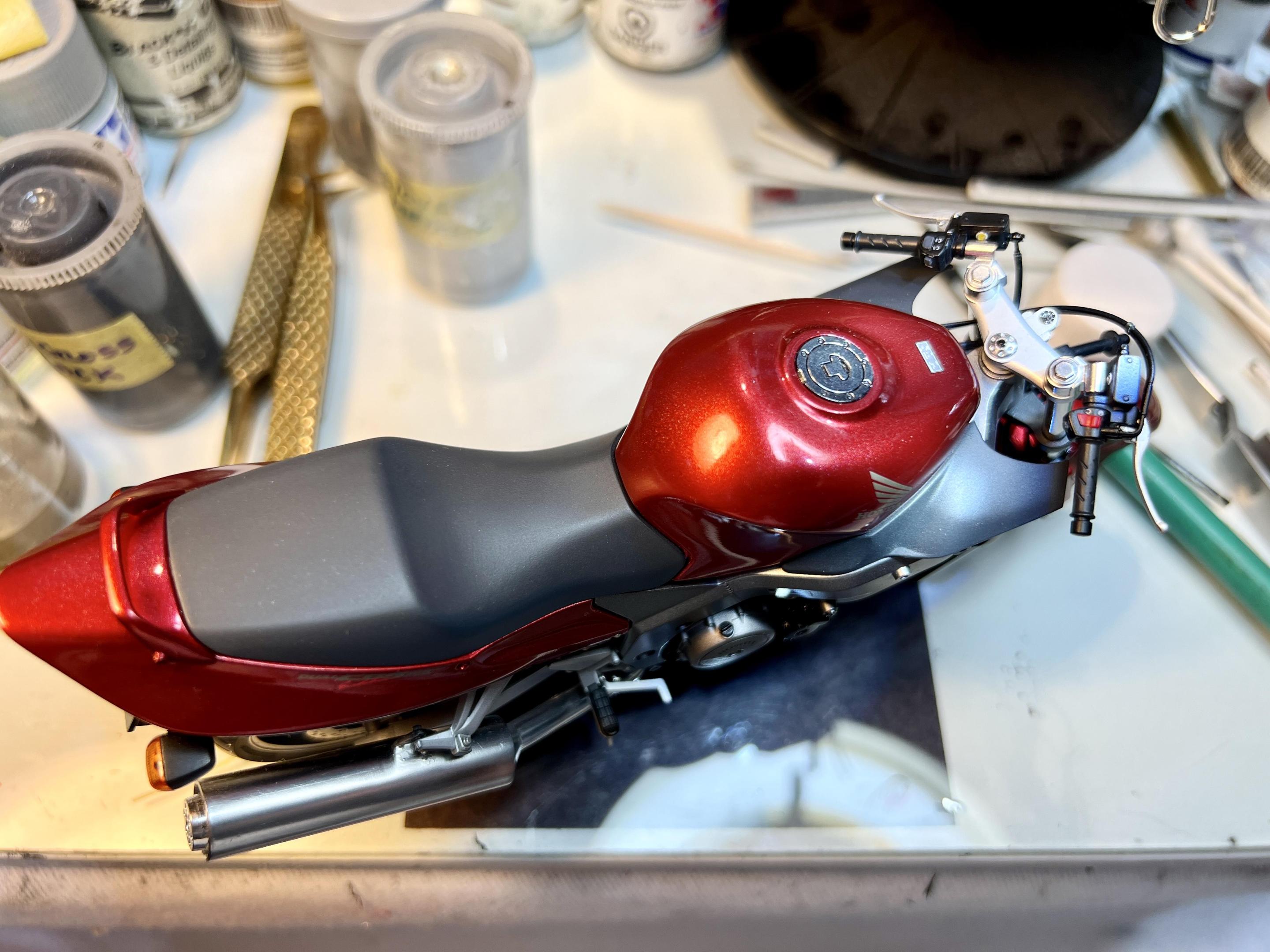

Wolf Posted November 2, 2023 Author Share Posted November 2, 2023 (edited) Almost done with this build. The paint is on all the parts and it’s just a case of scratch building a few small details to finish it off. The red paint is Tamiya’s Pure Metallic Red, and as usual for me, decanted from the spray can and shot through the airbrush. Three coats of red and two coats of Tamiya’s clear gloss. I used tiny bits of decal to add some of the stencils for the various switches on the handle bar controls. I also finished off the front fairing assembly after receiving new clear parts from Tamiya. I always remove large clear parts from their sprues to avoid any stress cracks where they’re attached to the sprues. I placed the windshield and headlight lens in a small ziplock bag and placed them in the kit box. Apparently my Miniature Schnauzer pup decided they were of interest to him so he pulled the ziplock bag out of the box and left it on the floor by my workbench. I found ‘em with my foot. The headlight lens was split down the middle and the windshield had a small crack at the top so new parts were necessary. Thank goodness I was able to get replacements from Tamiya! All the rivets on the fairings were replaced with 0.9 and 1.2mm Top Studio rivets. The lower fairings had the large retainers at the bottom replaced with cast resin ones. I couldn’t find any their size so I took impressions of them and cast replacements. I wasn’t confident that I was going to be able to paint them cleanly as moulded as part of the lower fairings so casting and replacing them as separate pieces seemed the best possible solution for me. Once cast they were sprayed gloss black and then Alclad II polished aluminum and secured with future floor polish. I have to scratch build the four small stations that allows the rider to strap down any carry-on and then she’ll be ready for posting photos “under glass”. Cheers, Wolf (who’s already got Tamiya’s 1/24th Morgan 4/4 waiting in the wings). Edited November 2, 2023 by Wolf Quote Link to comment Share on other sites More sharing options...
