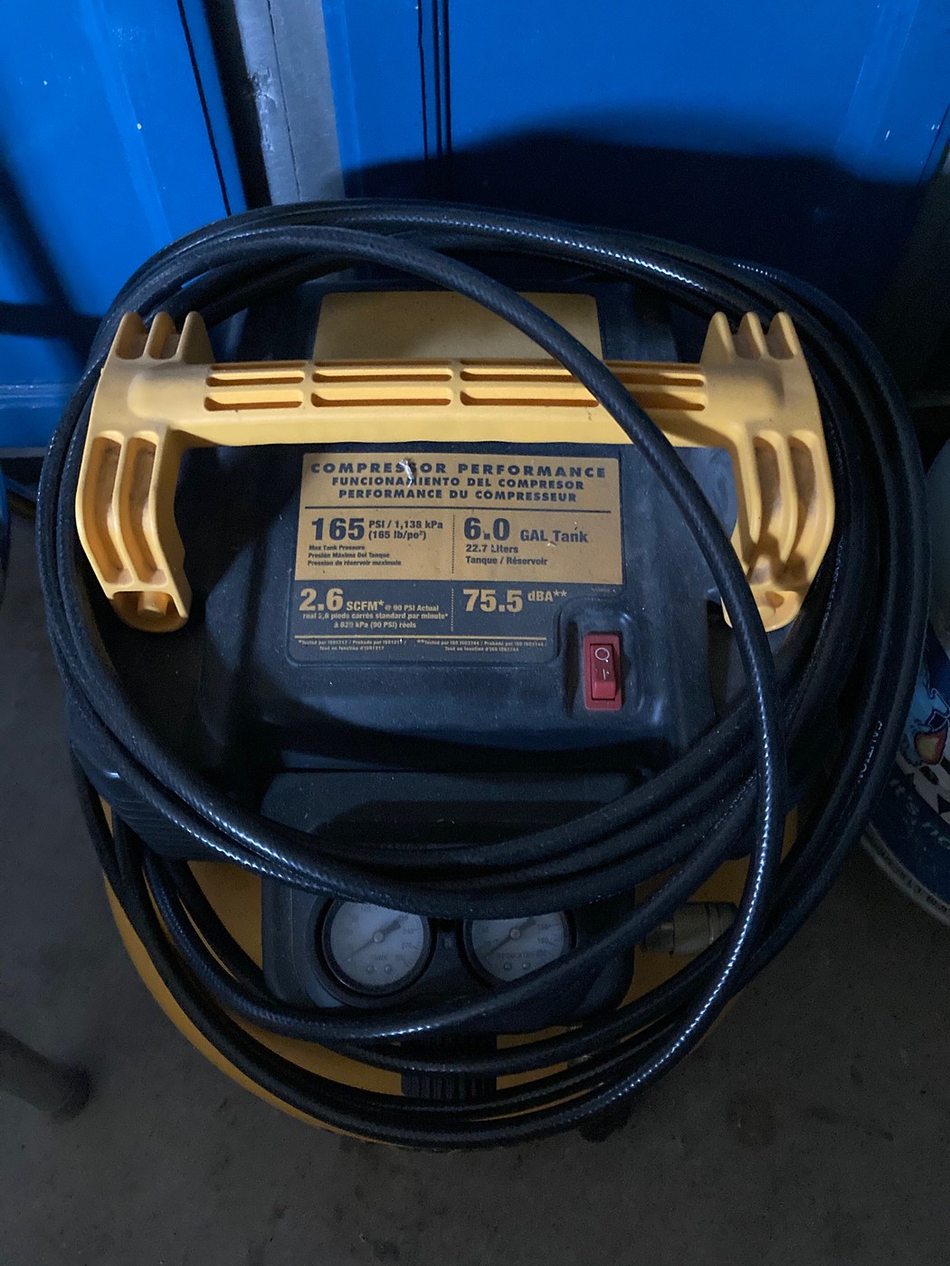

StevenGuthmiller Posted September 12, 2023 Posted September 12, 2023 My opinion? Get a "pancake" compressor. There's no need to spend money on a hobby dedicated compressor. Then you can spray your model in the morning, and fill a tire or operate an air nailer in the afternoon if necessary. With a pancake compressor, you can fill the tank in the garage or outside, and then bring it inside for hours of silent spraying. I have a DeWalt 6 gallon. Steve 1

StevenGuthmiller Posted September 12, 2023 Posted September 12, 2023 2 hours ago, Dave G. said: I use an 8gal 4.5 cfm 135psi portable compressor for various things to include my airbrushing. But that doesn't mean it's for everyone. Some folks simply want reasonably quiet air for airbrushing. I also have a small single cylinder air brush compressor that I use for small jobs, but my point is that if you have any use at all for a compressor for other uses, there’s really no need for a hobby dedicated compressor. A small pancake compressor will do everything that a airbrush compressor will do, and then some. Just makes sense to me to buy one that will cover everything. Steve 1
