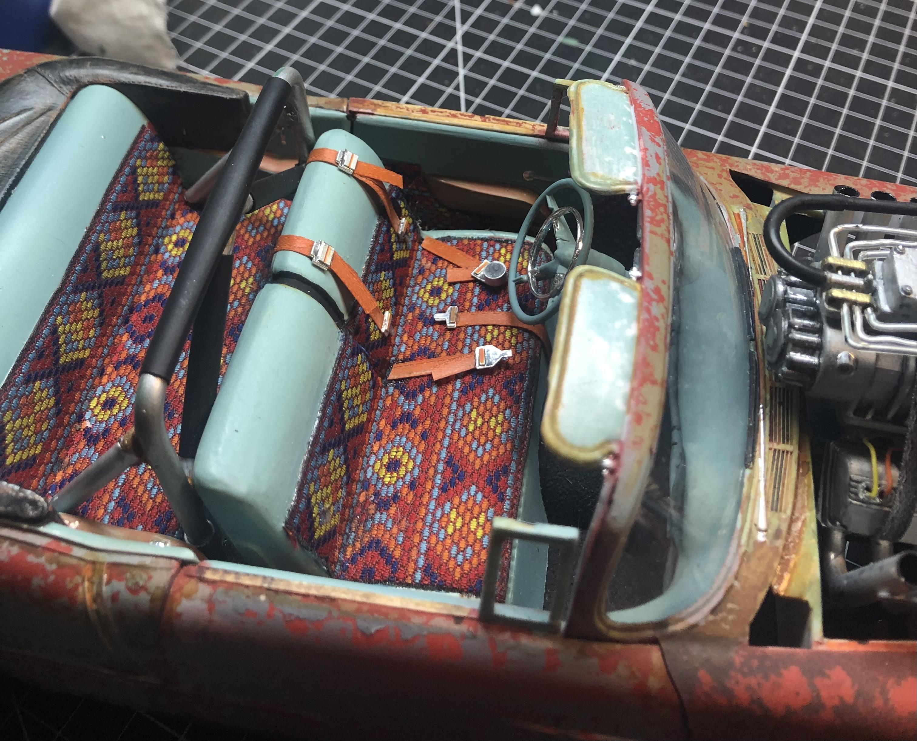

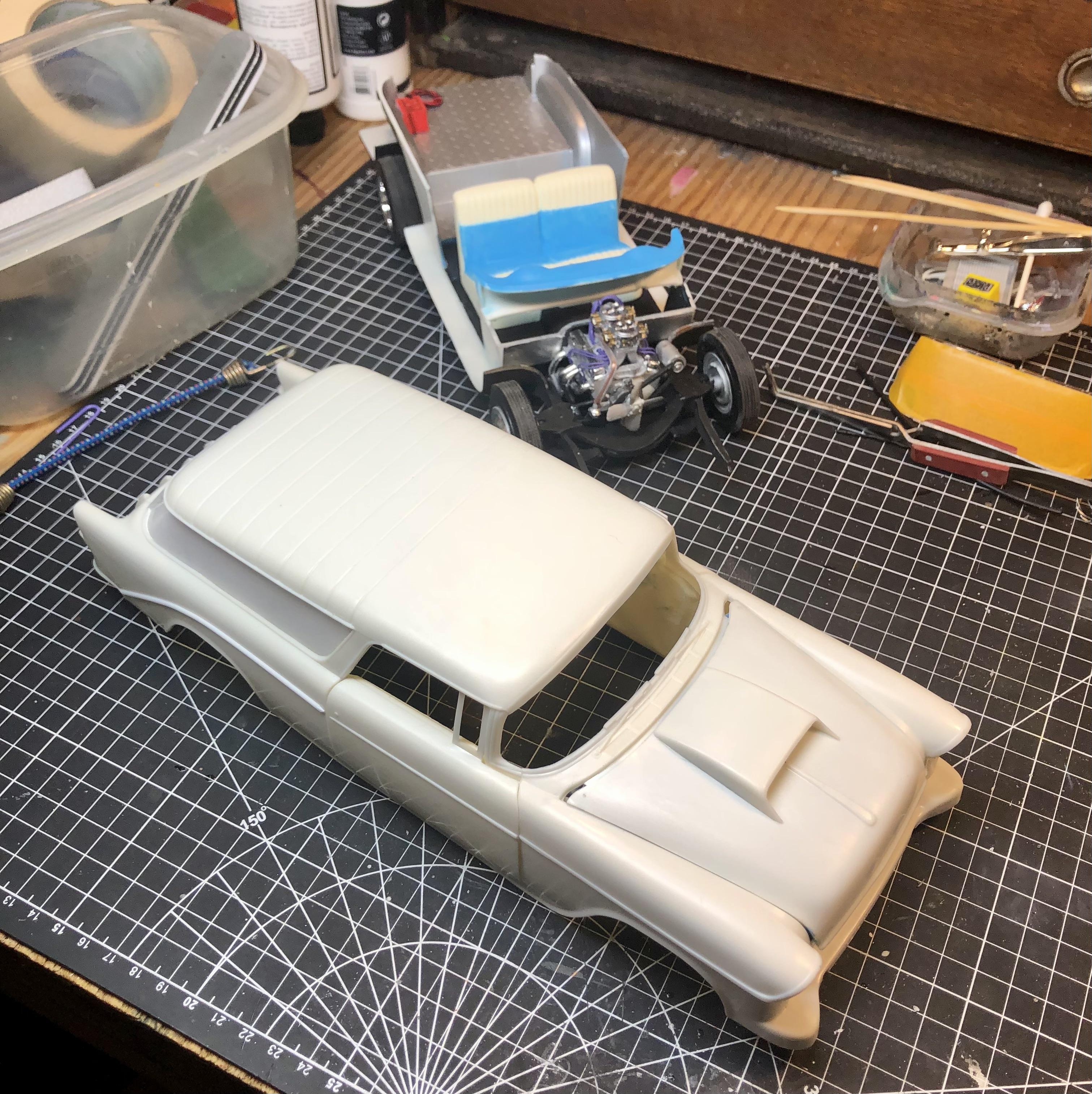

Holeinthehead2 Posted September 21 Share Posted September 21 Well, arrived at the point of paint. Any advise appreciated. I bought a Vallejo surface primer. To start. done one car “normal” and one distressed. 1 Quote Link to comment Share on other sites More sharing options...
Chuckyg1 Posted September 21 Share Posted September 21 That interior is awesome. 1 Quote Link to comment Share on other sites More sharing options...
James2 Posted September 21 Share Posted September 21 Preparation is or friend! Dust free environment and ventilation is key. Take your time and try a test piece first. 1 Quote Link to comment Share on other sites More sharing options...
espo Posted September 21 Share Posted September 21 I agree with Chuckyg1 on your interior. What did you use for the material inserts on the seats? Quote Link to comment Share on other sites More sharing options...
Dave G. Posted September 22 Share Posted September 22 You mentioned Vallejo primer, what will the color coat and top coat paints be ? As to the primer though, not my first choice but since you have it, lightly scuff with micro mesh or similar. Wash the body or wipe down at least, with mineral spirits or similar to get finger prints and other oils off the surface. Blow the body off with just air from your airbrush and apply a coat or two of the primer. Set it aside someplace and dry for 24 hours before proceeding further. Or if you have a dehydrator or paint dryer use that for an hour or two. Note the primer will feel dry to the touch sooner than 24 hours but Vallejo's standard is 24 hours dry time. It may feel dry sooner but hasn't cured through all the way yet. Also fwiw Vallejo paints take well to heat setting. Quote Link to comment Share on other sites More sharing options...
Holeinthehead2 Posted September 22 Author Share Posted September 22 Seat material & seat belts is ribbon from JoAnn Fabrics Quote Link to comment Share on other sites More sharing options...
