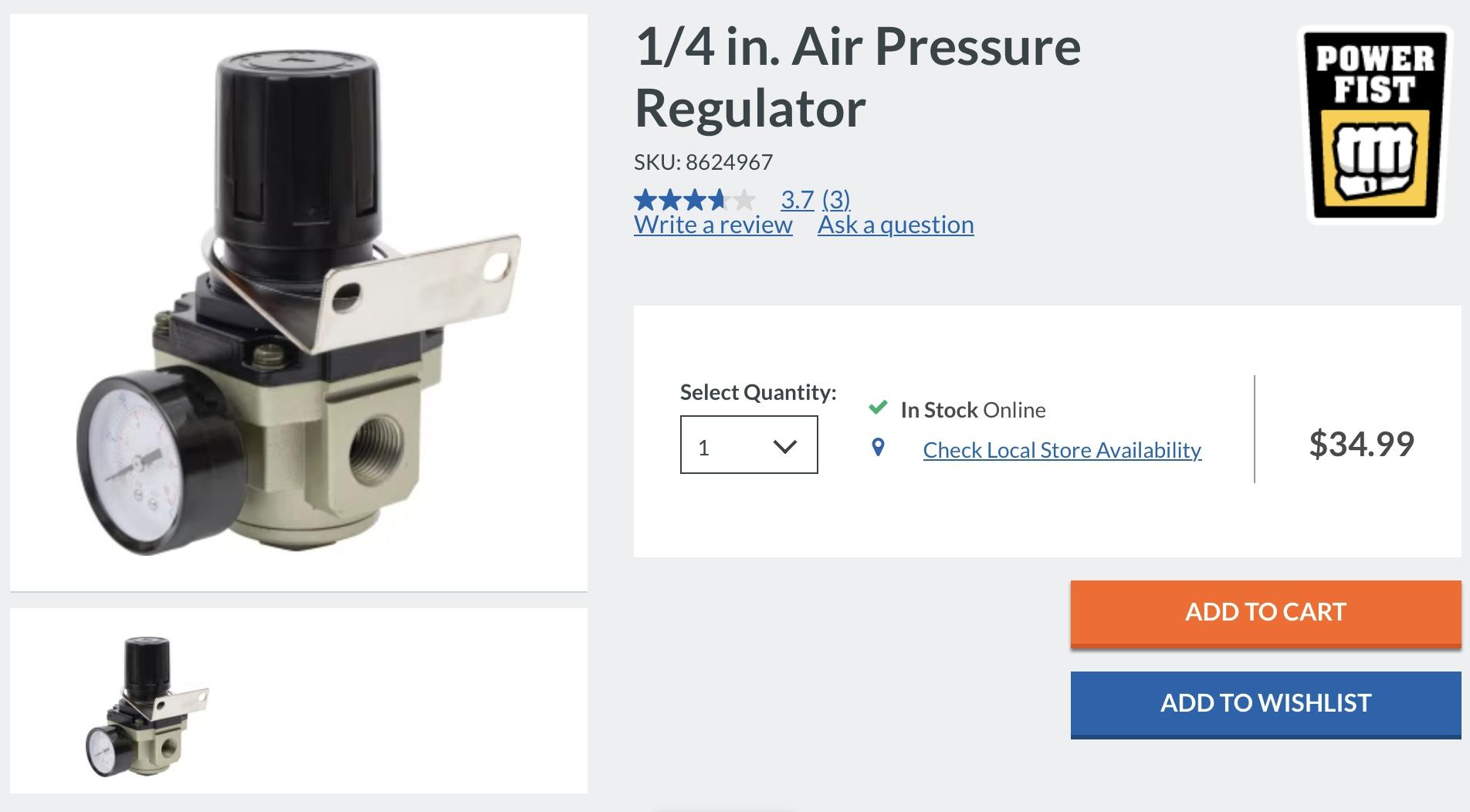

NOBLNG Posted September 25 Share Posted September 25 (edited) I have a huge compressor in my garage. The regulator that I use is just a cheap one from Princes Auto. You could attach something like this near your paint booth and run a hose from your compressor to the regulator inlet. Then an adapter fitting from the regulator outlet to your airbrush hose. Edited September 25 by NOBLNG 1 Quote Link to comment Share on other sites More sharing options...

customline Posted September 27 Author Share Posted September 27 On 9/25/2023 at 8:34 AM, NOBLNG said: I have a huge compressor in my garage. The regulator that I use is just a cheap one from Princes Auto. You could attach something like this near your paint booth and run a hose from your compressor to the regulator inlet. Then an adapter fitting from the regulator outlet to your airbrush hose. Your setup is kinda what I want to do. I have a big loud compressor that I can use and it's probably a lot better than the "airbrush compressor" I have. An external, stand alone, in-line regulator would be great as long as it delivers pressure accurately. The cheap ones all look like they are made by the same manufacturer ( like the one on my cheap "airbrush compressor"). Except the Iwata. But that's 3X the cost, which I'm OK with as long as it does what it's supposed to. When regulating to 15 psig you need accuracy. If a cheap one will perform properly, great. Thanks, Greg. Quote Link to comment Share on other sites More sharing options...
