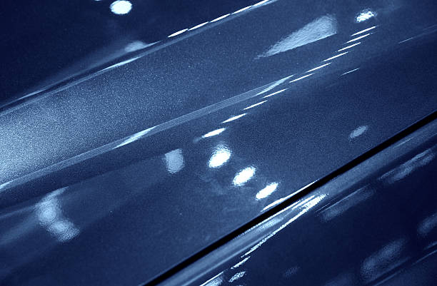

Milo Posted September 27 Author Share Posted September 27 Well, I'm looking for something that will appear on the model like it was a real car. Like I would like the flakes to be 1/25 or 1/24 scale also. Quote Link to comment Share on other sites More sharing options...
Milo Posted September 27 Author Share Posted September 27 This is the paint. I want my model to be to scale to that kind of paint on the real car 1 Quote Link to comment Share on other sites More sharing options...
Dpate Posted September 27 Share Posted September 27 You’re not gonna get that 1:1 color with Tamiya metallic blue. Quote Link to comment Share on other sites More sharing options...
Monty Posted September 27 Share Posted September 27 Maybe Model Master Arctic Blue if you can still find some. 2 Quote Link to comment Share on other sites More sharing options...

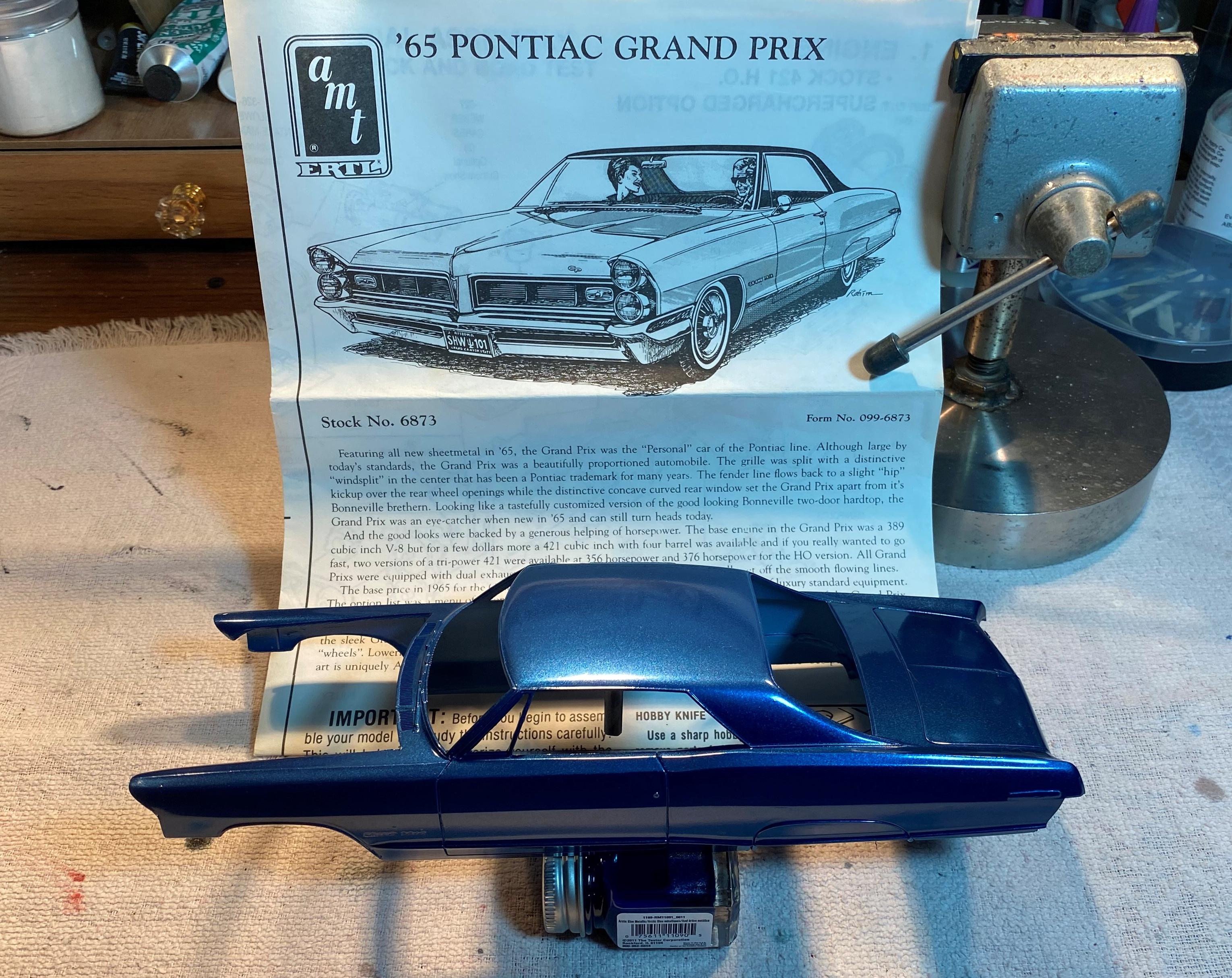

Bills72sj Posted September 27 Share Posted September 27 (edited) This car was painted with Testors bottle enamel thinned with Big Box store lacquer thinner. It is a 50/50 mix of #1106 Arctic Blue Metallic and #1539 Blue Metallic Flake. The Tamiya above is pretty but brighter blue. Edited September 27 by Bills72sj 1 Quote Link to comment Share on other sites More sharing options...
