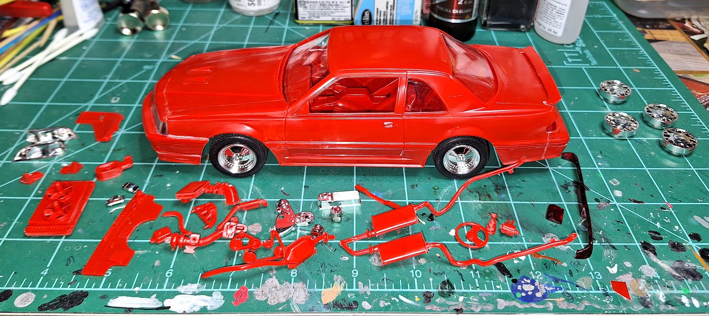

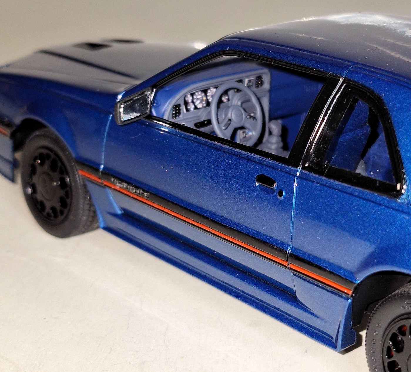

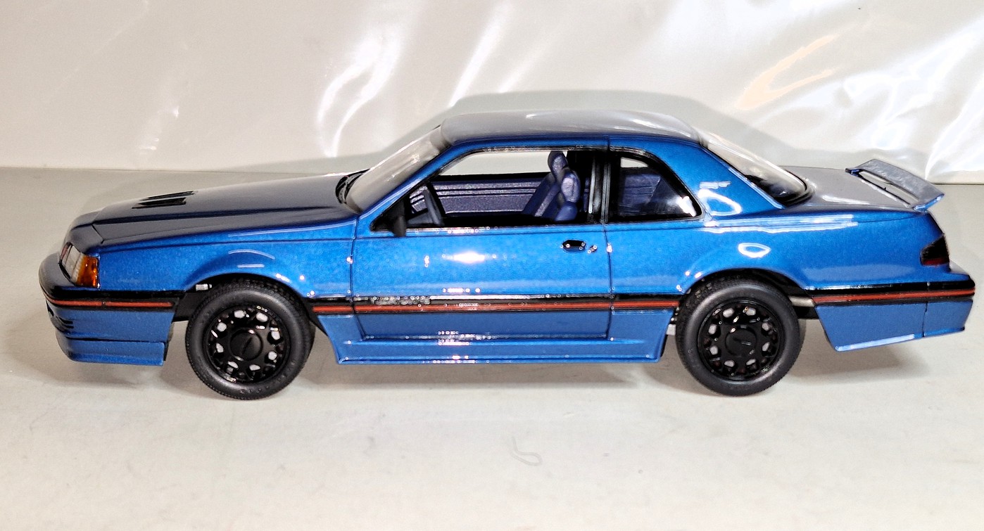

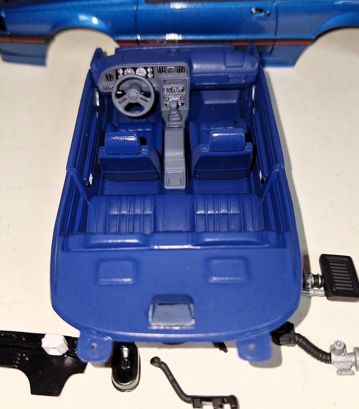

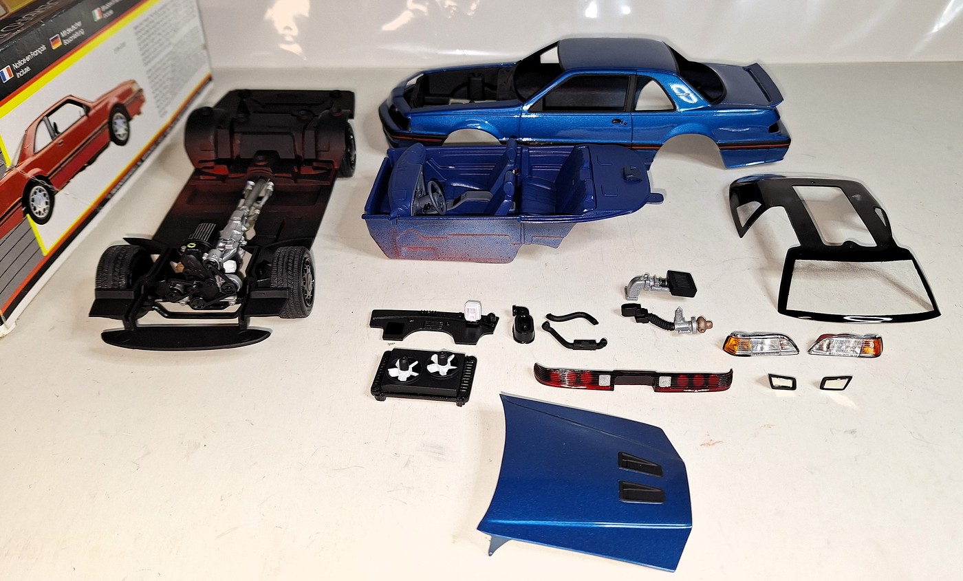

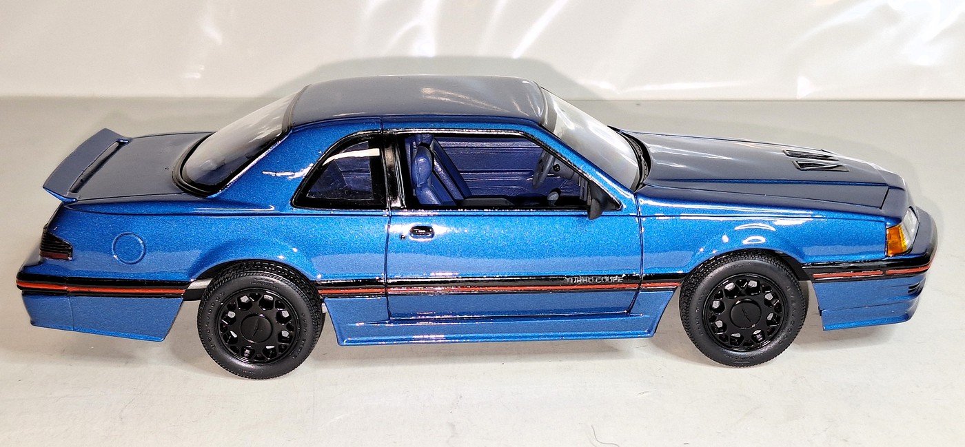

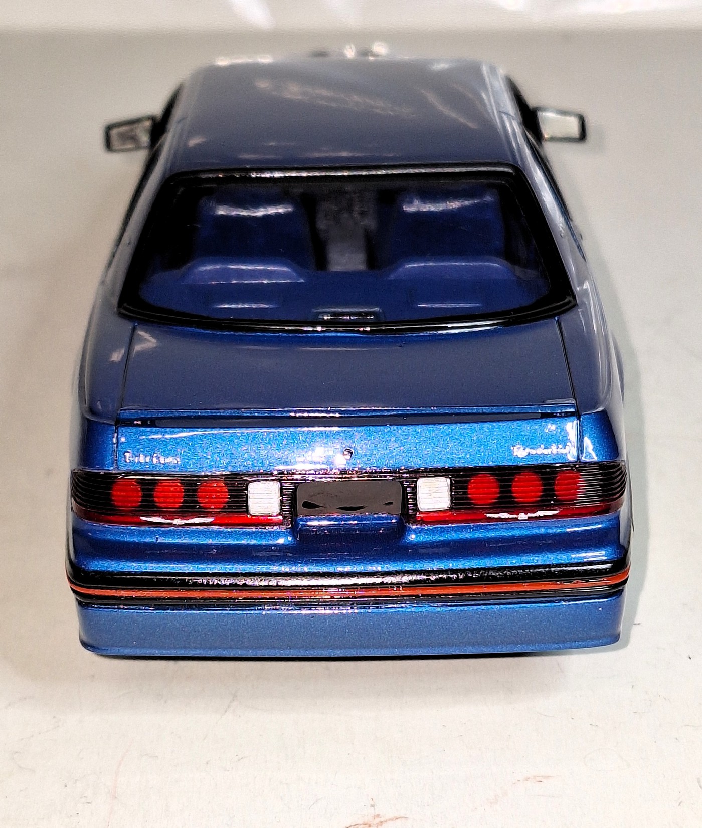

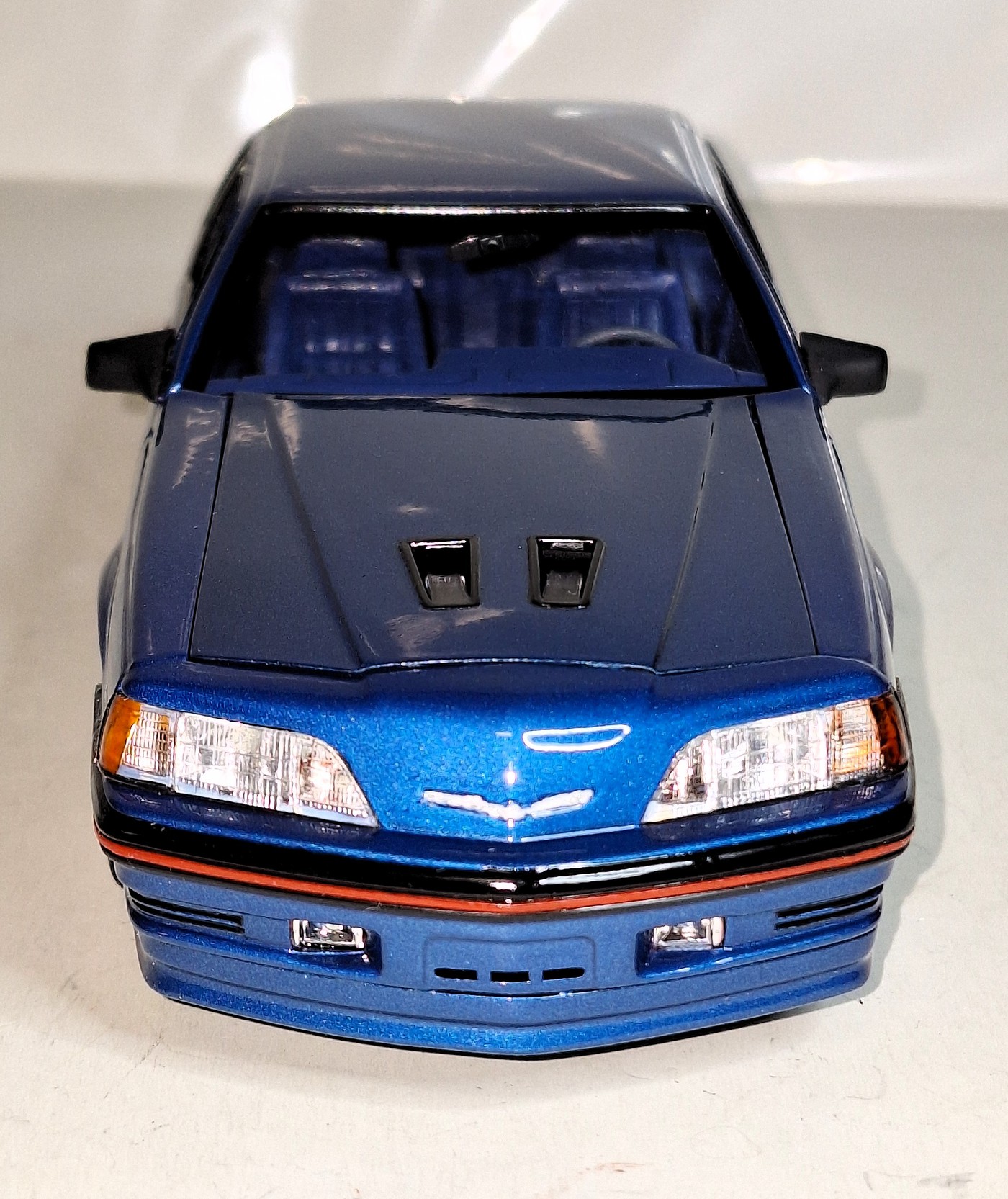

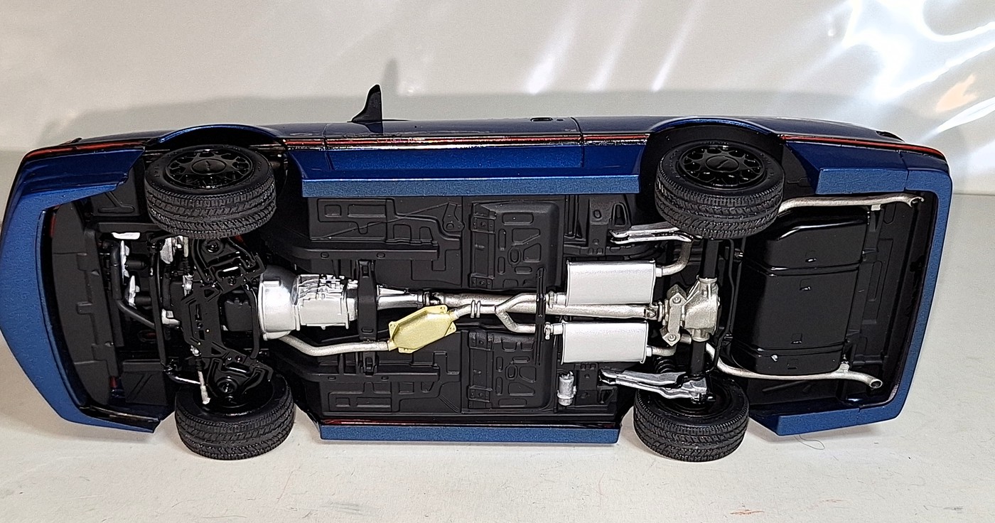

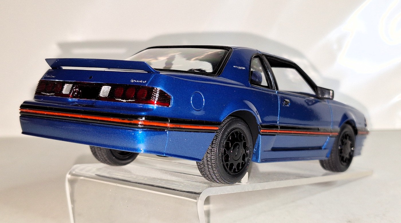

THarrison351 Posted October 2 Share Posted October 2 Another one started over thirty years ago and put away. This one was missing some tiny pieces. Mirrors, lenses, and decals. I created new door mirror glass out of plastic stock and foiled them. I stole the interior mirror from a Mustang low rider convertible that I've stolen other parts from. I'm still missing the fog lamp lenses. When I opened the box it turned out I had glued the aero kit on as well. The included extra wheels and tires looked terrible. I don't have any modern low profile big wheels, because I don't build those type of cars as a norm. I decided to strip the stock wheels and paint them black. Not great, could use a bigger tire and be lowered. The color is Testors Sapphire blue decanted, and sprayed over flat black. The red body stripe is the body plastic covered in BMF. Then I sprayed the body flat black and covered the body molding in more BMF and masking tape. The only drawback was this new BMF leaves a sticky residue you have to remove. Painters tape worked for me. The interior is a mix of custom gray with with Tamiya TS15 Blue and flat lacquer. I used those glue on instrument decals you can buy on eBay. Not great, but better than I can paint. I was in such a rush to finish it and post tonight, I forgot to put on the license plate. How I found it in the box. Those wheels 6 Quote Link to comment Share on other sites More sharing options...
