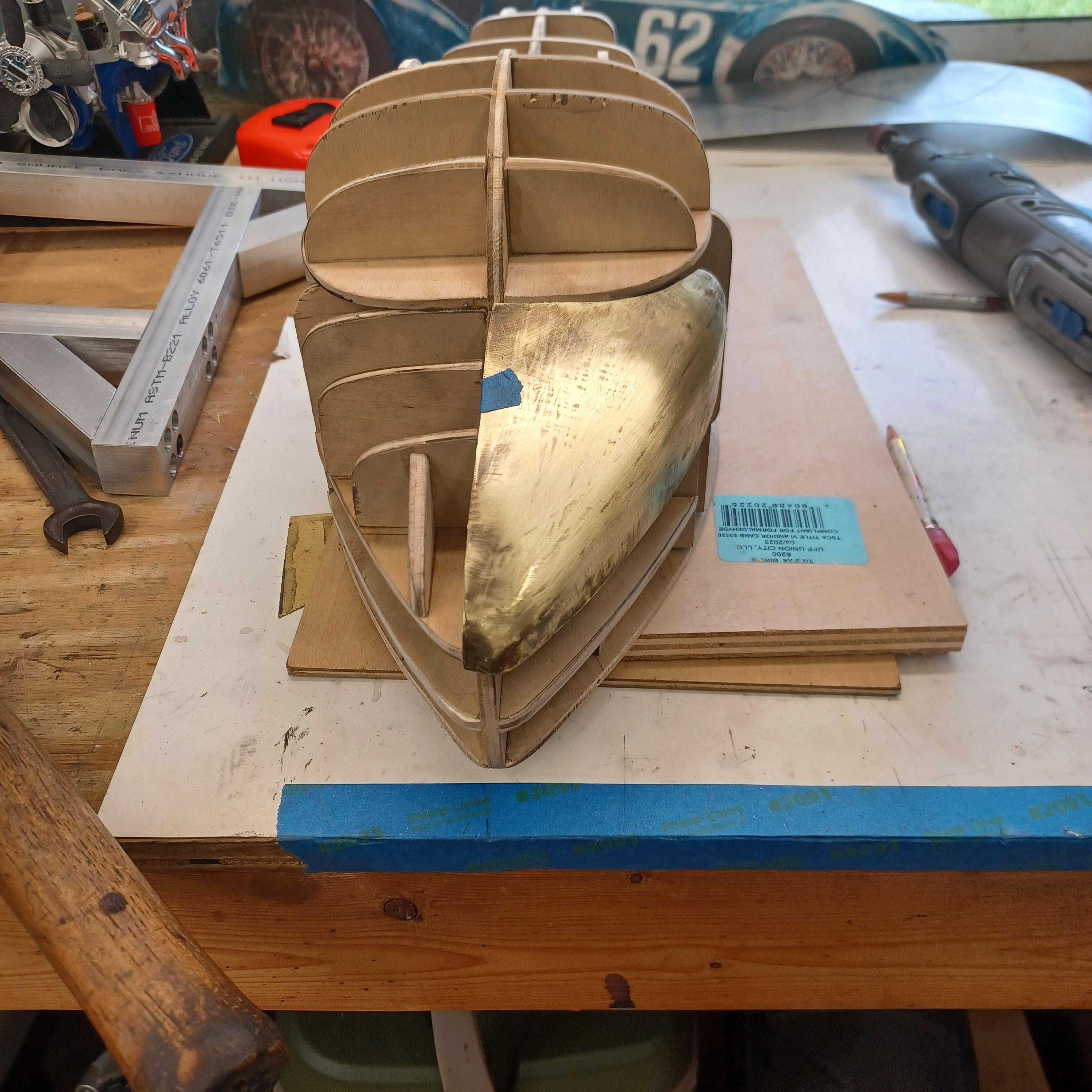

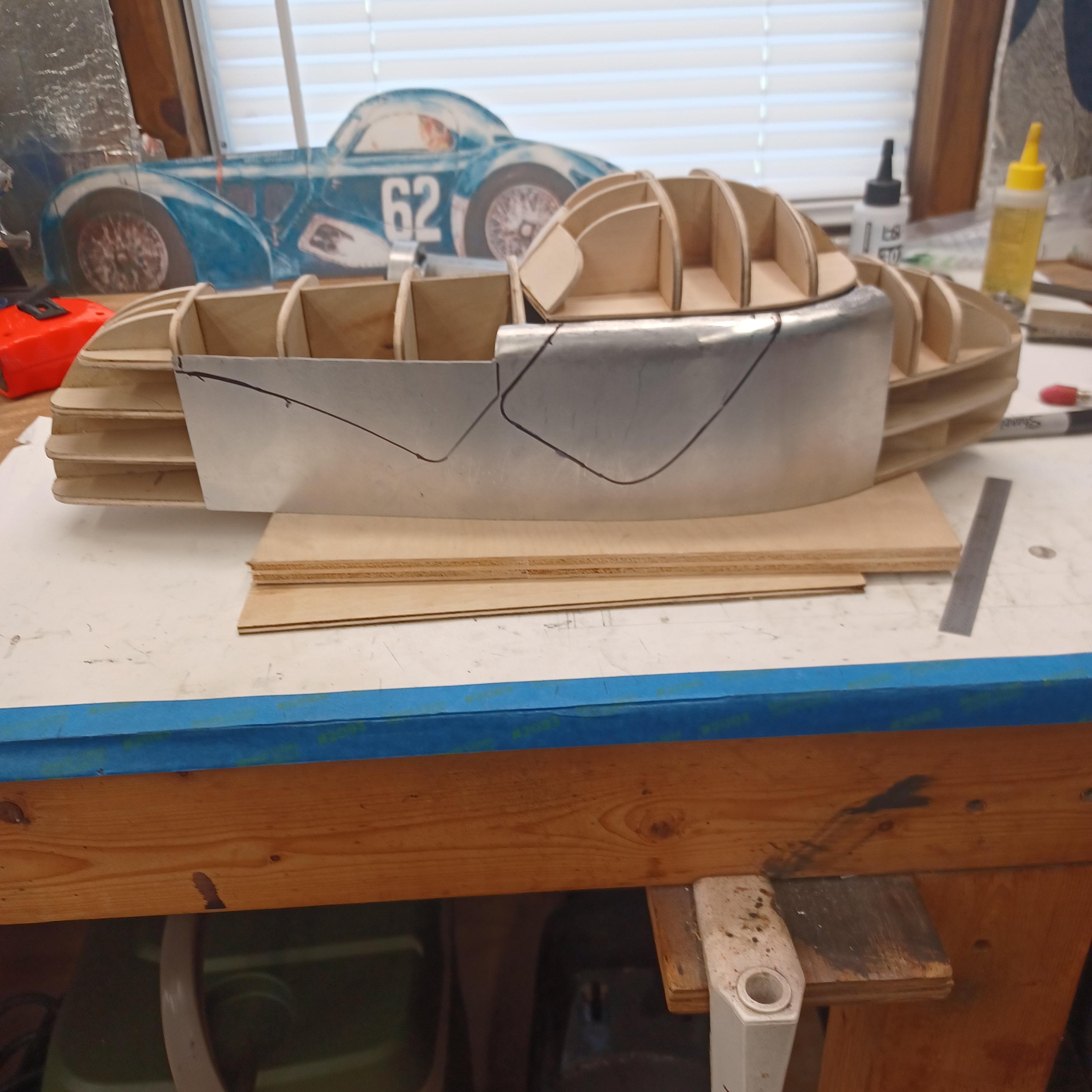

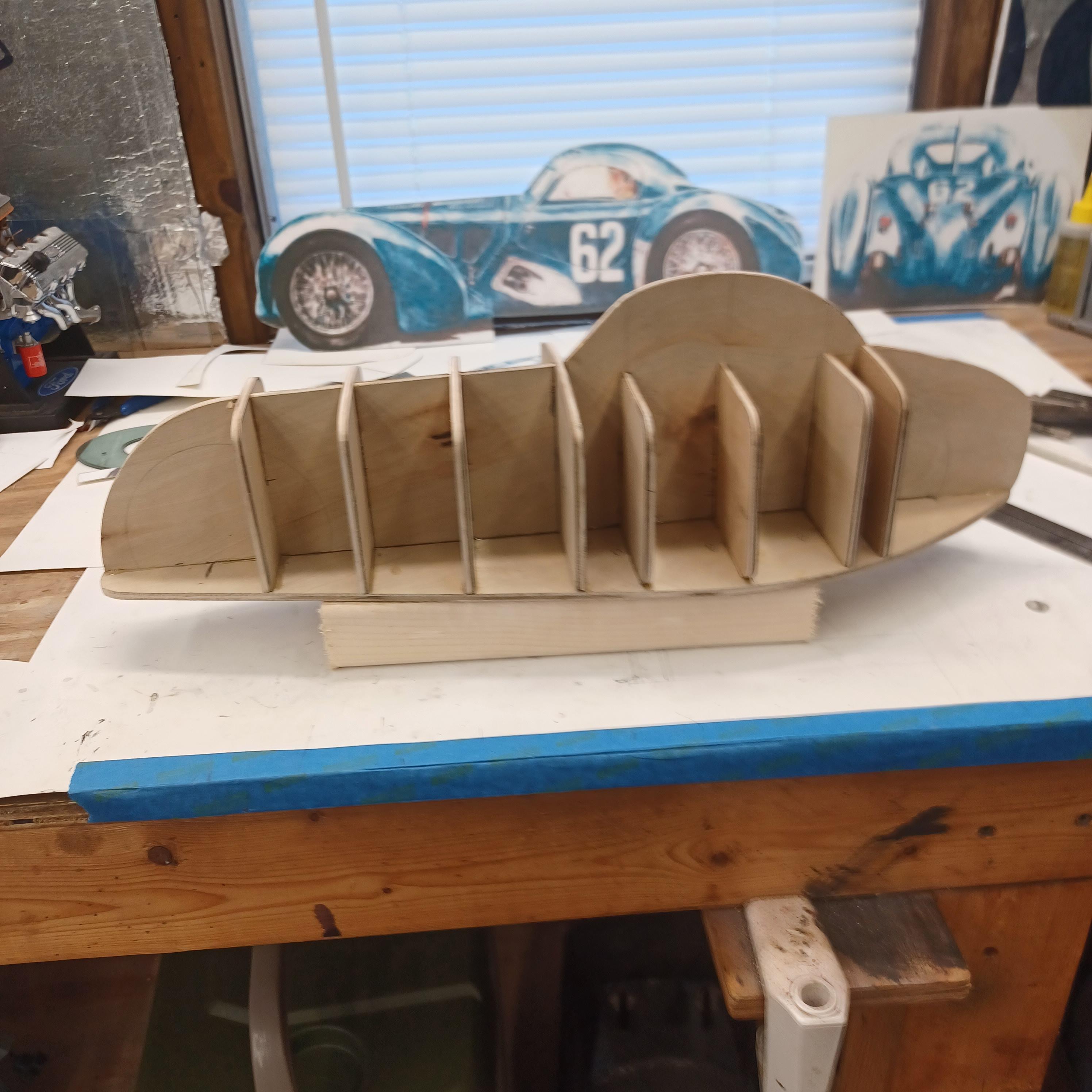

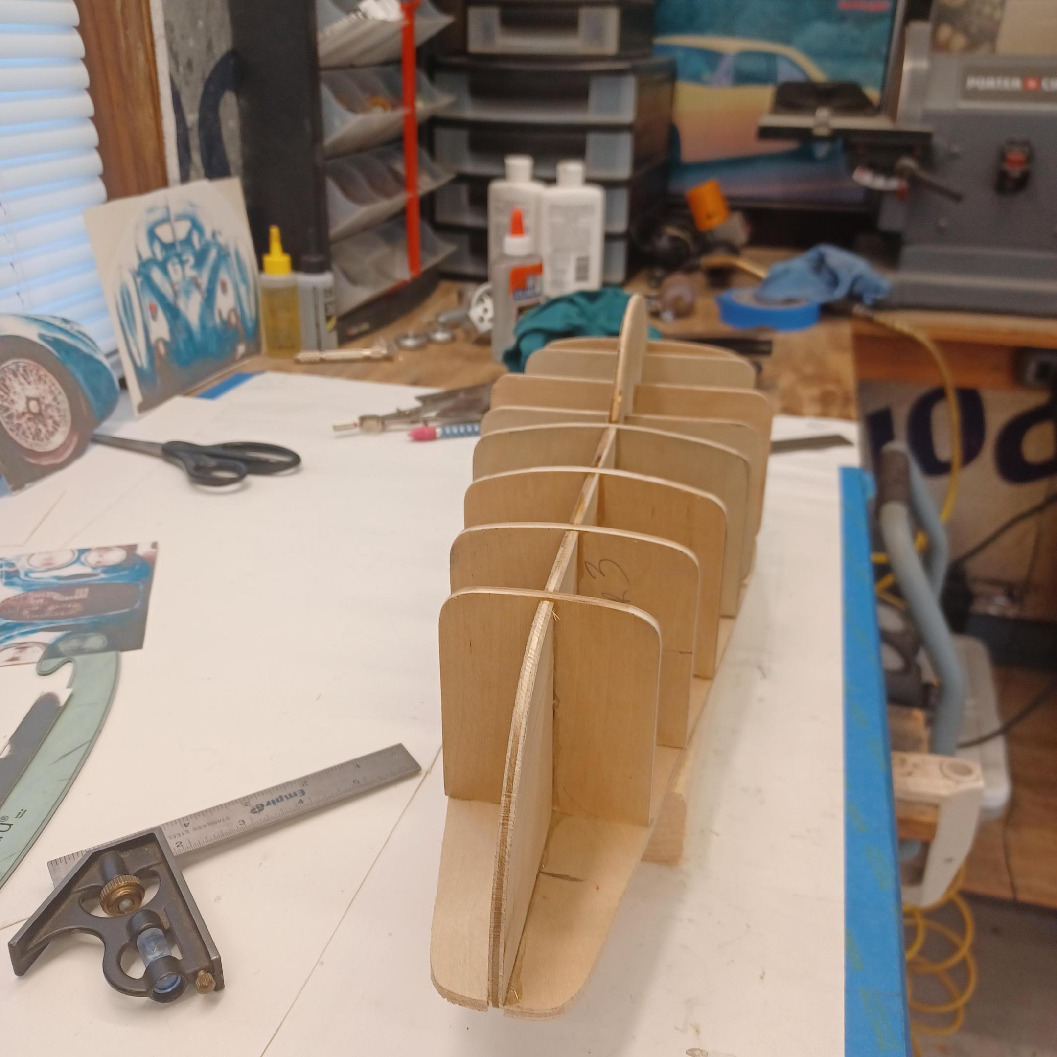

charlie libby Posted October 26, 2023 Posted October 26, 2023 just getting started on this project. i believe its going to be a long build. i am building an English wheel to help with the metal forming, i hope it works. i just got the metal today to build the frame for it, I'll get started on the it tomorrow. i had pictures of the car blown up to the correct 1/8 scale dimensions and am building a body buck from those. i have a few pictures of what i have done so far. i built this car body in full size a few years ago and sold it unfinished. last i heard it is in a hotrod shop in Detroit being finished. i can only find a couple of pictures right now.thanks for looking. 2

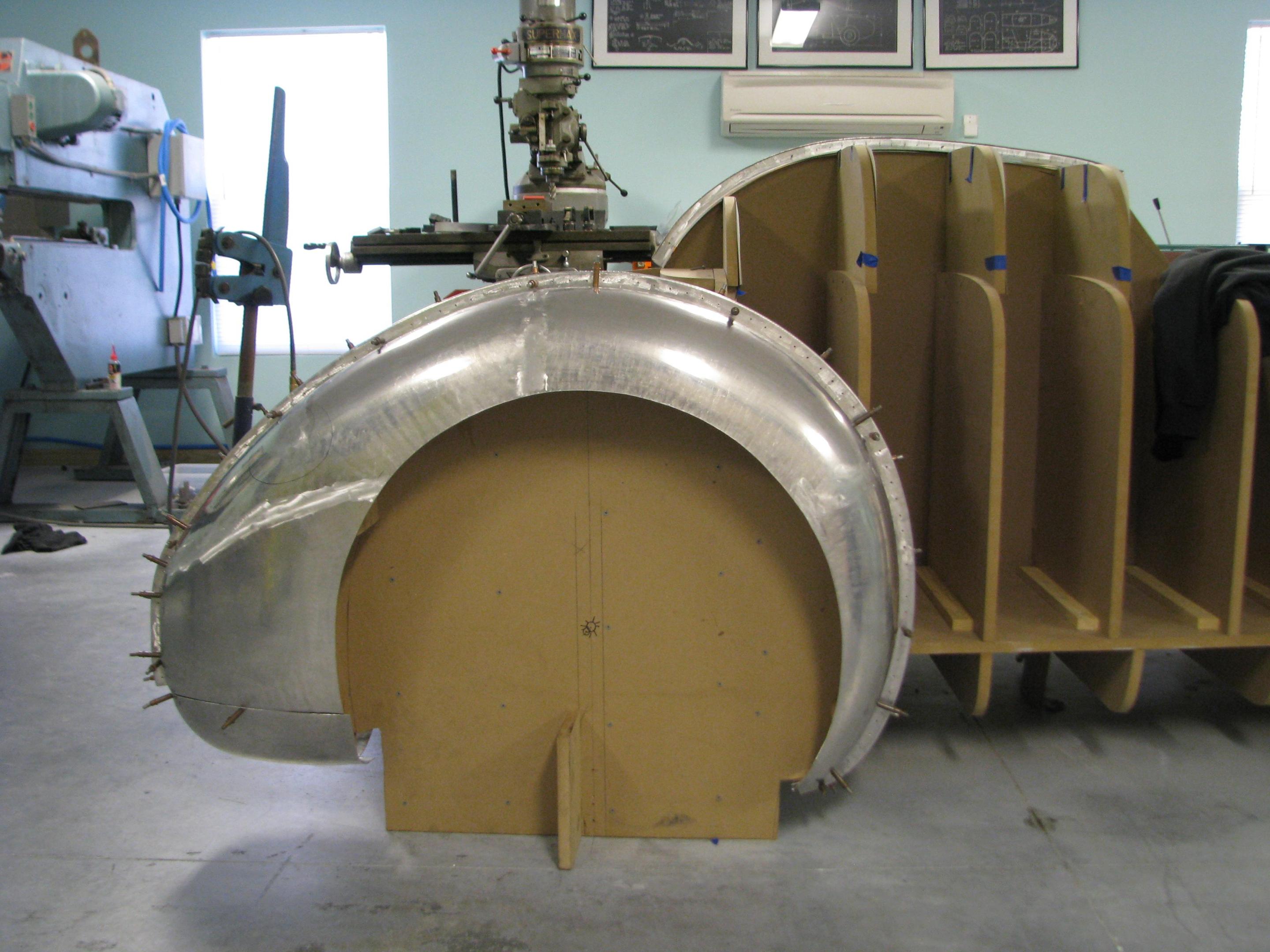

charlie libby Posted October 31, 2023 Author Posted October 31, 2023 got the English wheel up and working i might make a minor design change but i used it quite alot today and it seems to work quite well. better than expected. got the main part of the body buck complete and started on the rear portion of the car. i will do the bottom of the rear and then the sides. the aluminum side was just to try the wheel. i am going to try the back section in aluminum to see if i can solder with out destruction. 1

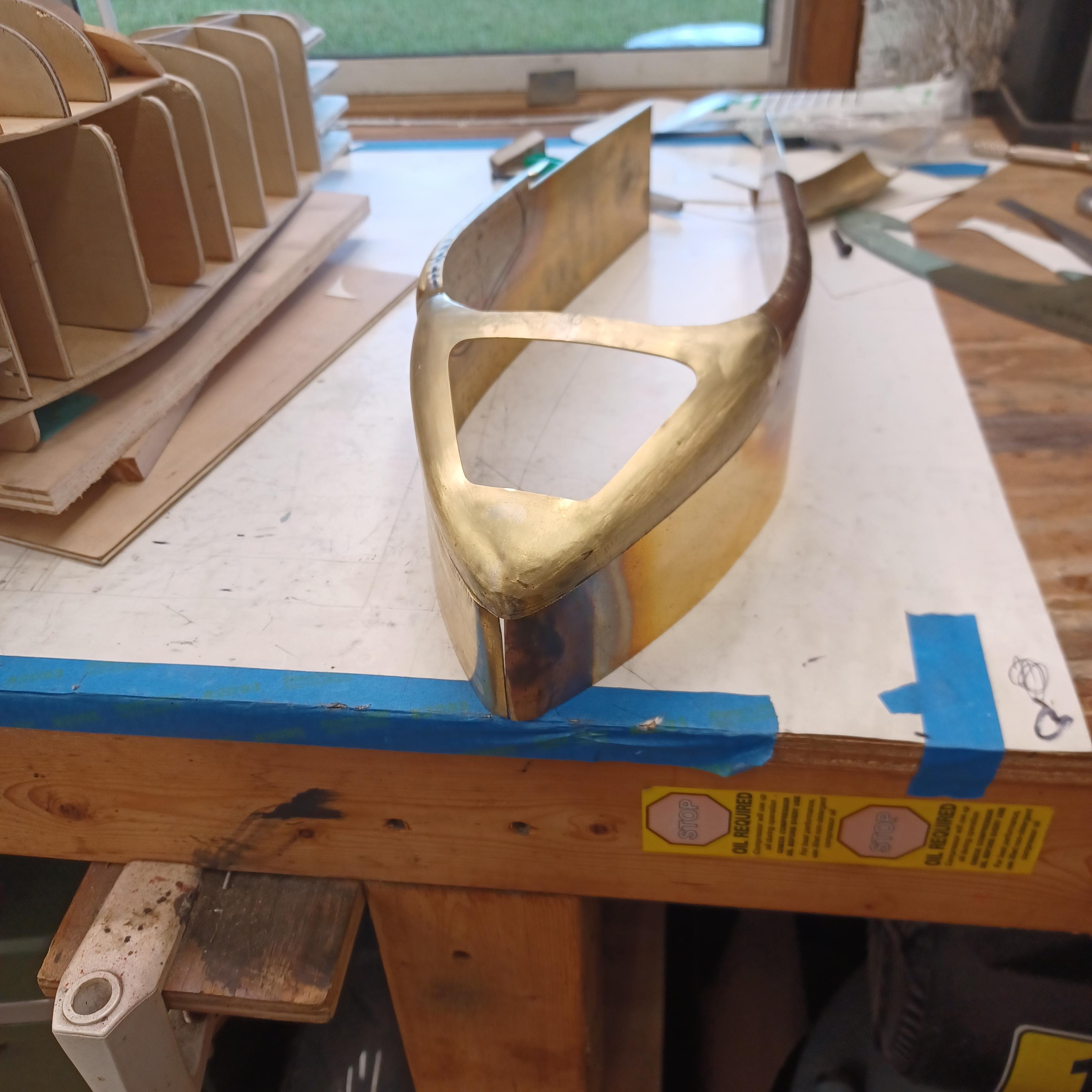

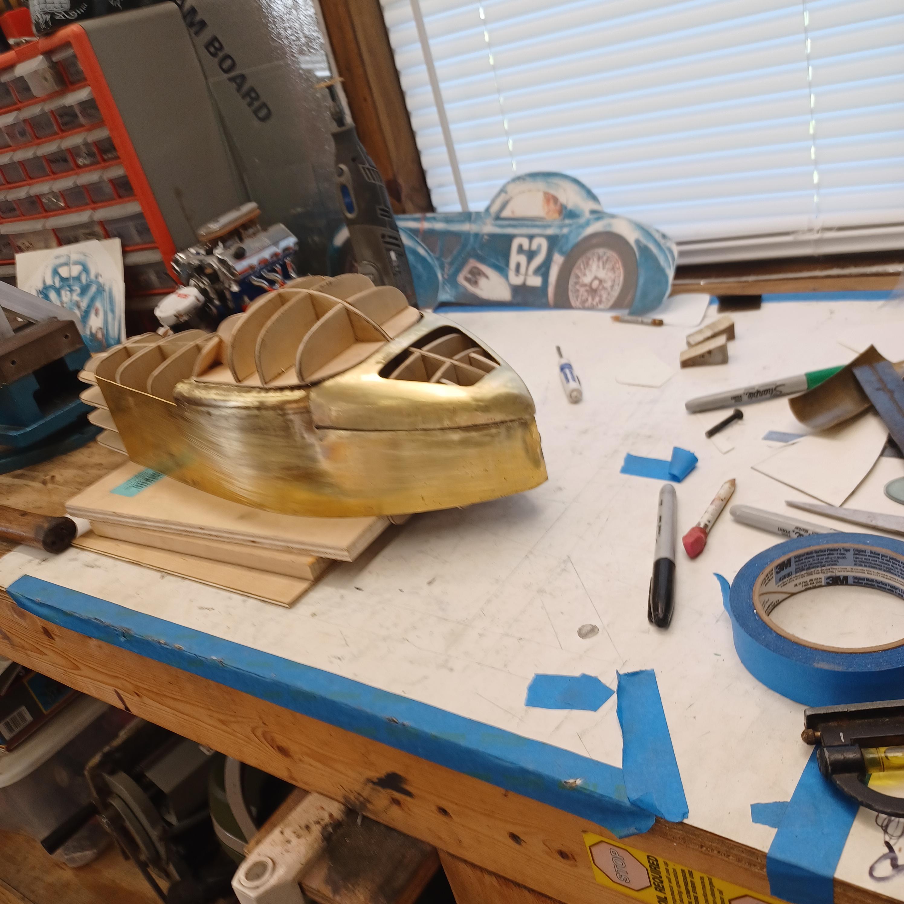

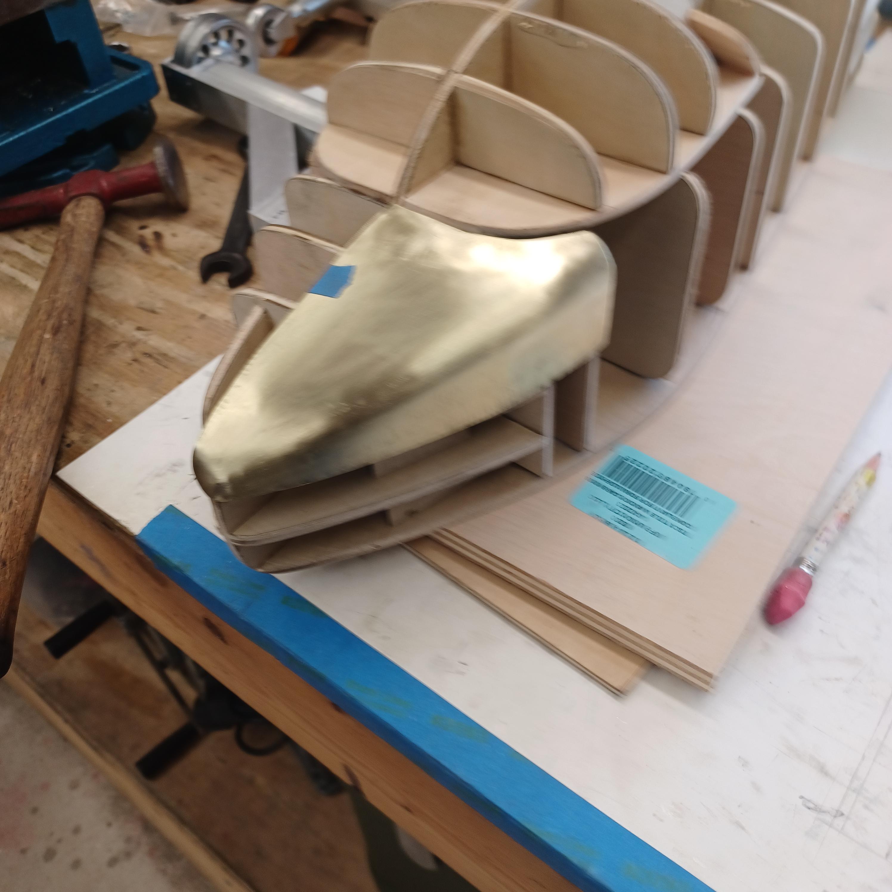

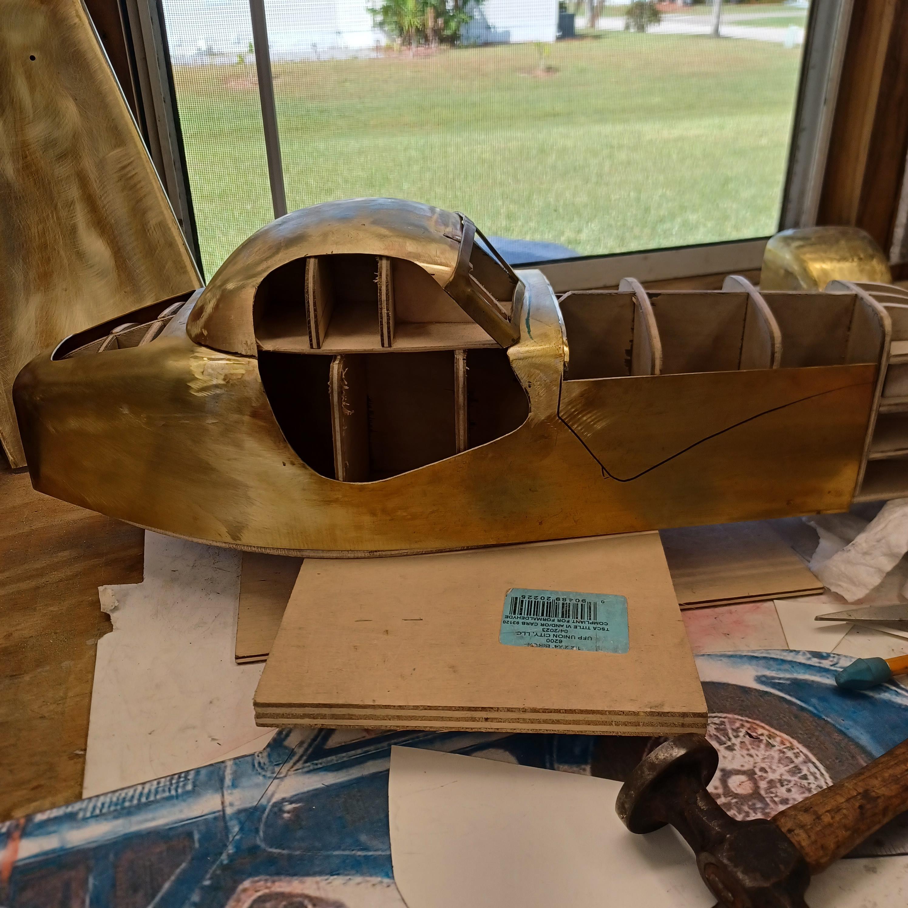

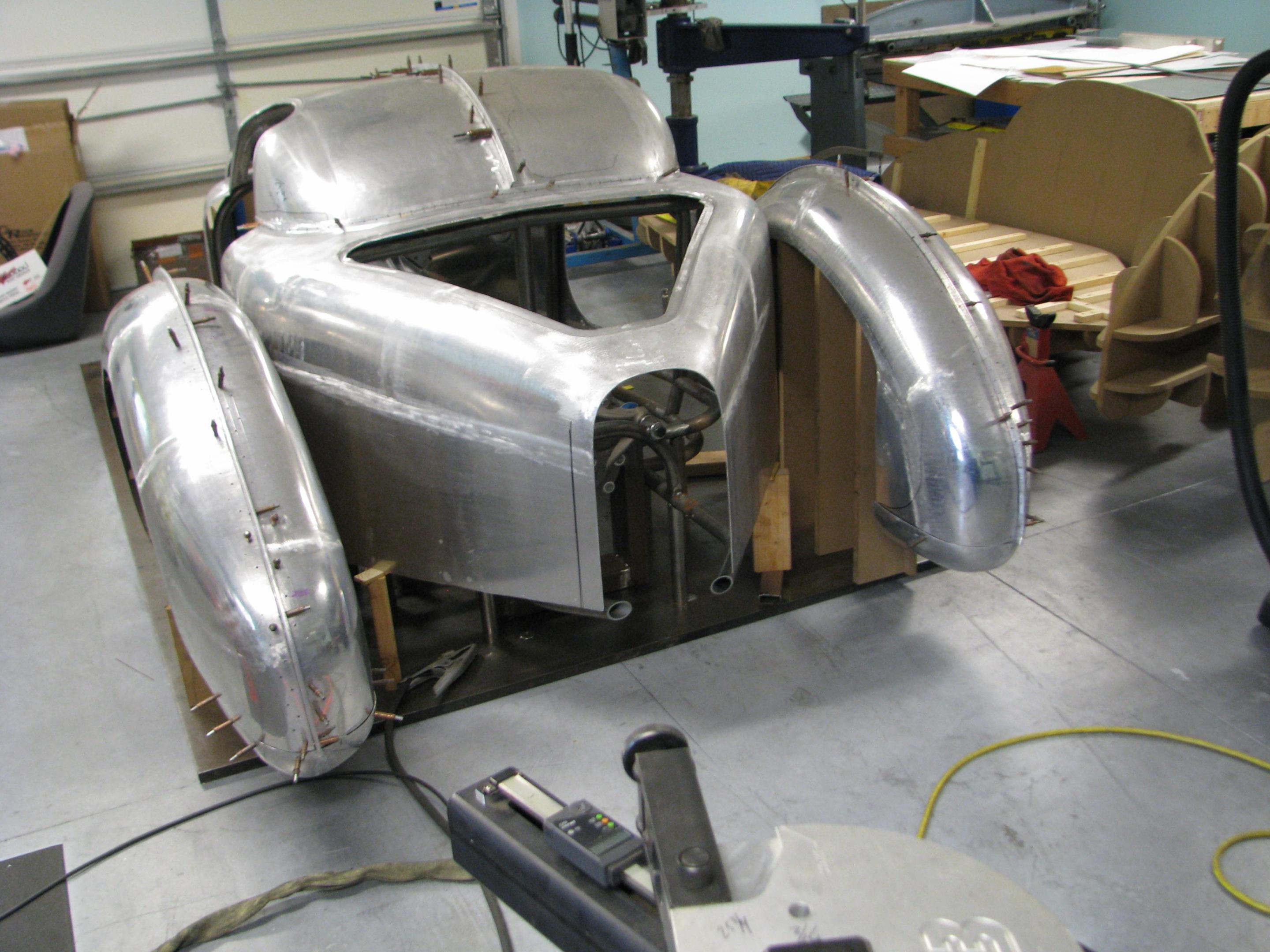

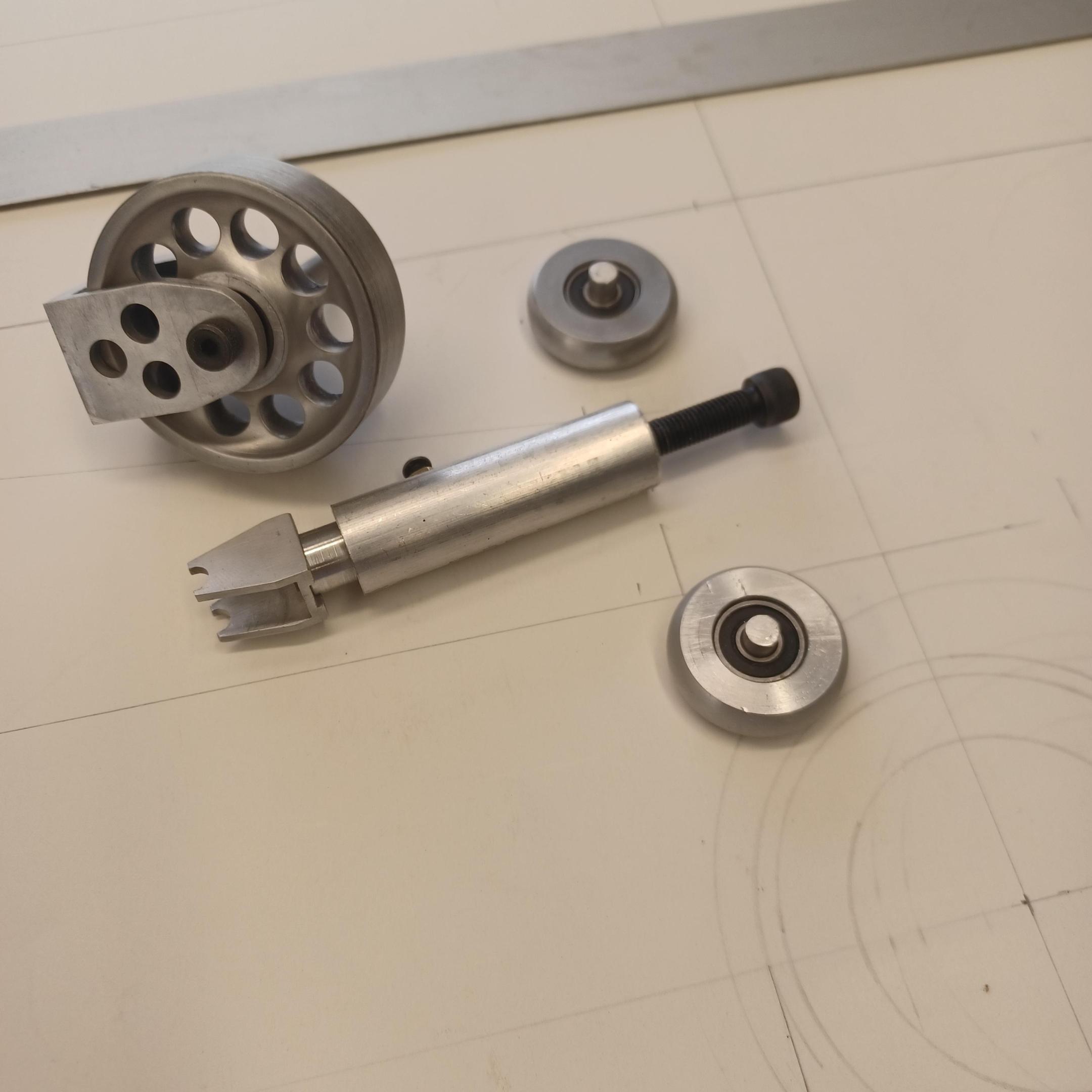

charlie libby Posted November 13, 2023 Author Posted November 13, 2023 hi everybody, nice to hear from all of you. thanks you for all the comments. the english wheel seems to be working well but the aluminum wheels are not going to last very long. i will have to make steel ones. the upper wheel my friend carl recommended using a bearing of the correct size in place of the wheel. i have made some progress on the main part of the body. alot of silver soldering, filing and sanding. iam going to cut the rear window and solder the roof on. i think the doors ,hinges and latches will take forever. have not made a final decision on how i will do that. I'll come up with something. pictures of the hammerform for the belly pan. got the doors cut and hood sides marked out . i will spend the next few days finishing the roof and windshield frame. hi francis very happy to hear from you. it must be getting cold in Canada.
