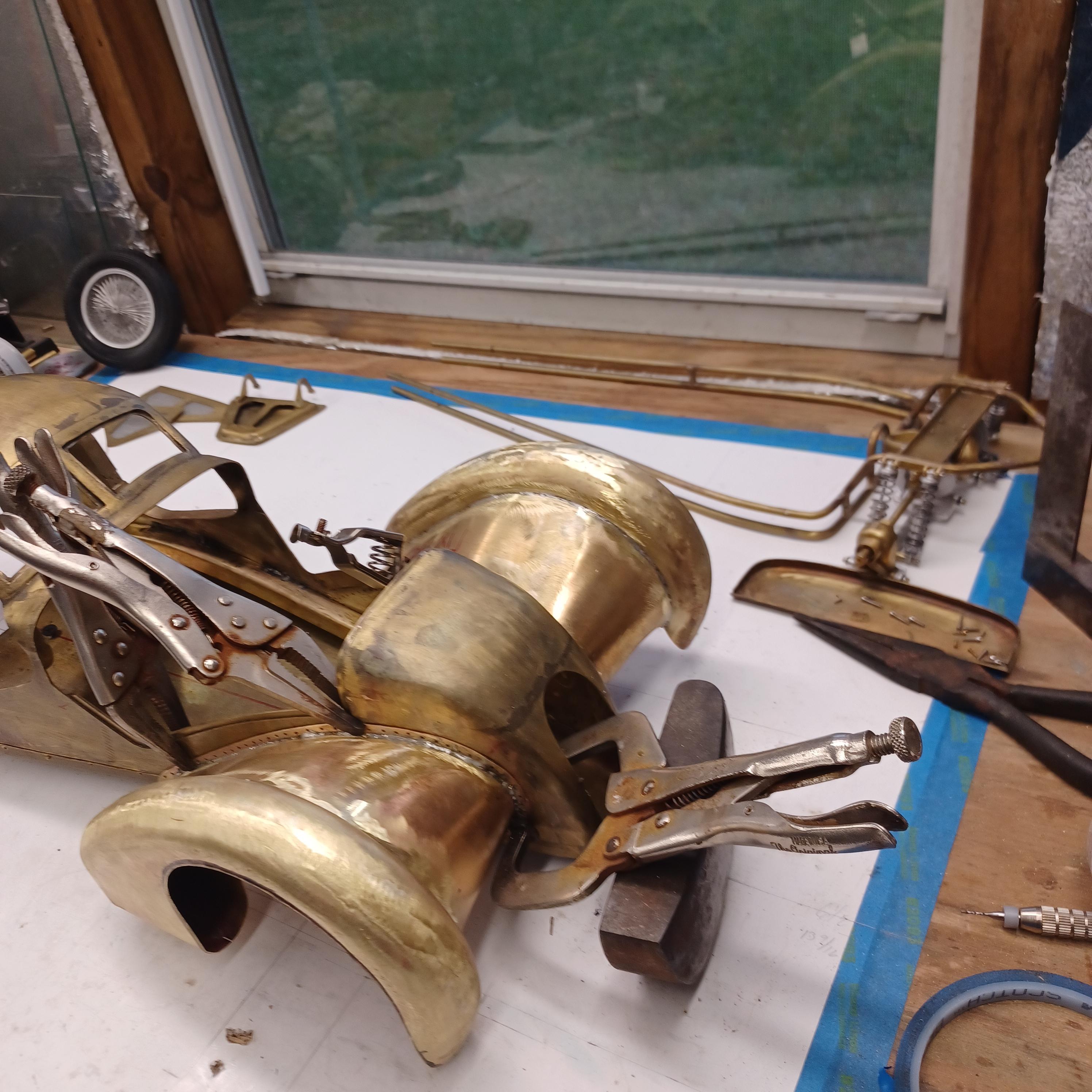

charlie libby Posted February 4, 2024 Author Posted February 4, 2024 hi andrew, took about 15 to 18 hours total for each, making the rim, the center the, center hub and drilling 160 holes. cutting and fitting 80 wires. but i think it was worth it. 2 more to go. going back on the fenders for awhile till my eyes come back to normal. i am doing the right rear next. i have the front hammer form shaped. nice to hear from you also mark,thank you. 2

charlie libby Posted February 16, 2024 Author Posted February 16, 2024 hi francis and randy, still working on fenders . will start on the forth one tomorrow. it takes a few days. i think the tire size is perfect the wheels fit the style of the car well. i am trying to get as close to the pictures as i can. thinking about colors now. got to decide on the engine and transmission and what the front suspension will be. i need the engine and transmission to build the firewall. more pictures when i finish the other fender 1

charlie libby Posted February 25, 2024 Author Posted February 25, 2024 hi pierre,noel and allen, glad you are still looking and commenting. thank you for your encouraging words. building 2 more wheels. finally have 4 fenders. got ll the wheel parts machined except the gazillion holes for the wires . about half of those. i came up with a great idea,now that they are almost done. i did a little reseach on ebay for stainless steel needles and found them about .032 dia. 1.5 inches long would be perfect for wire wheels. next time. hey , what about a miller 91 supercharged straight 8? somebody suggested 2 offy 4 cyl together. thoughts?

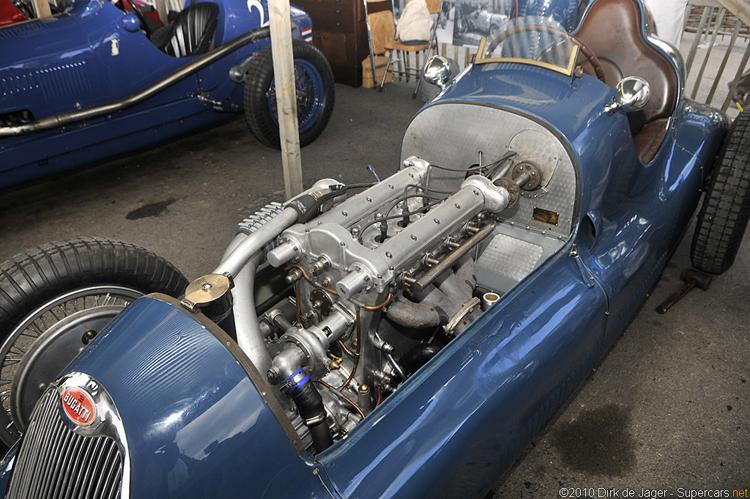

Big John Posted March 2, 2024 Posted March 2, 2024 thanks for the thanks Charles, Take a search look at the post war Bugatti type 73C, and 102, which were to use 4 cyl. twin cam engine with a front mounted roots type supercharger. It looks like it is pretty much what you are going for. Since this is a fantasy car anyway, what ever you build will be great.
charlie libby Posted March 3, 2024 Author Posted March 3, 2024 THEY REALLY DO LOOK ALOT LIKE THE OFFY. sorry about the caps lock. i have a good start on the offy and am excited about the roots type blower. it looks great. sometimes it gets a little messy. 1

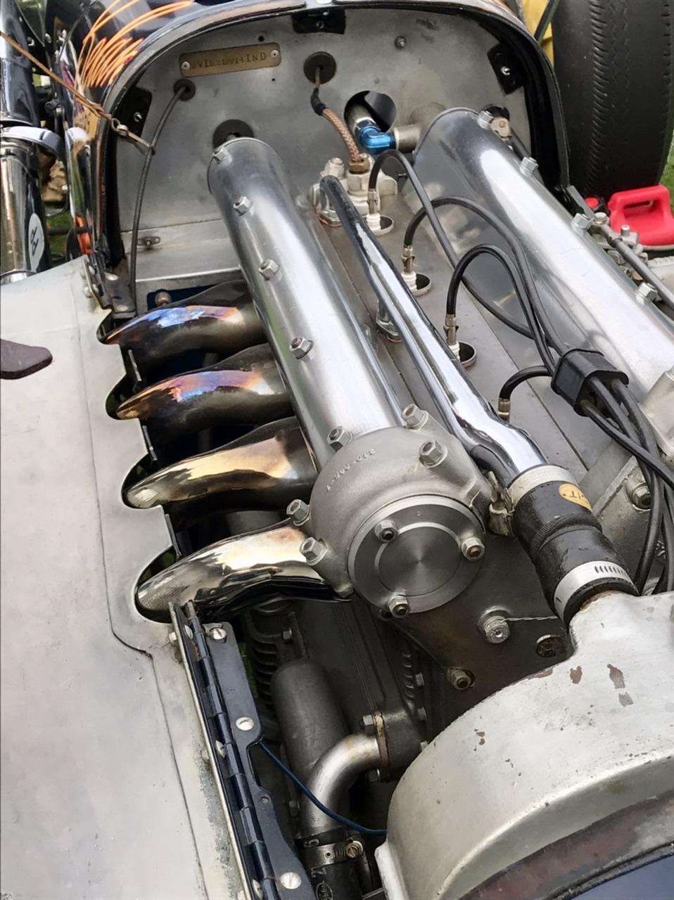

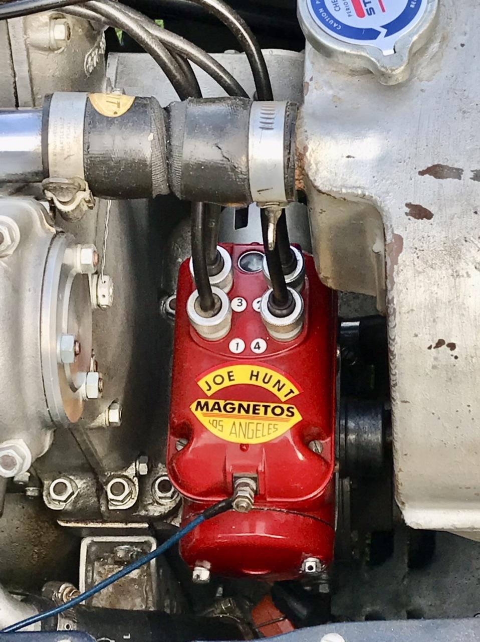

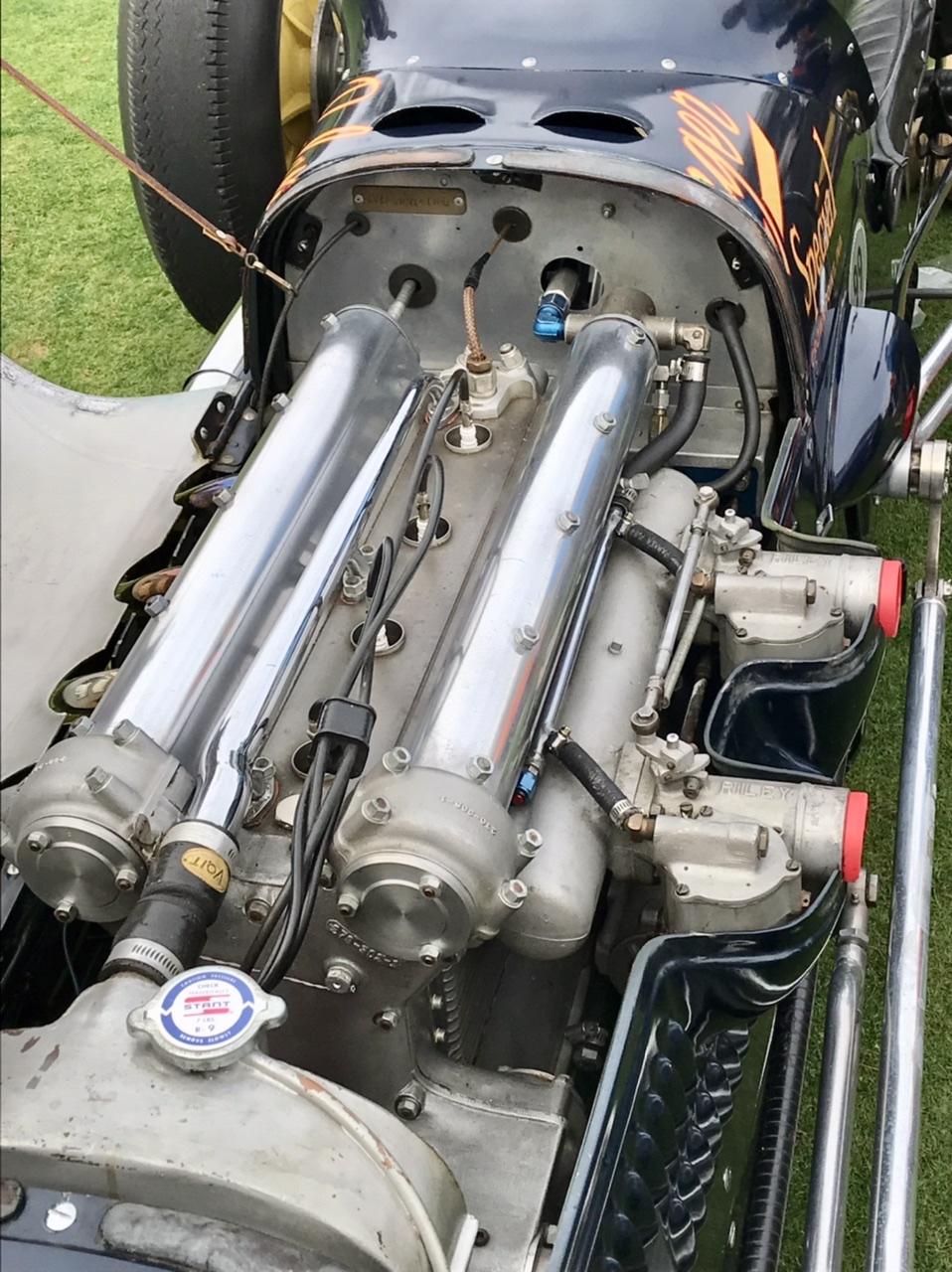

absmiami Posted March 4, 2024 Posted March 4, 2024 This is the 270 Offy in the Belanger Special - the Indy Museum brought it to Amelia this weekend … 1
absmiami Posted March 4, 2024 Posted March 4, 2024 So who can we convince to make the Joe Hunt markings as decals ?

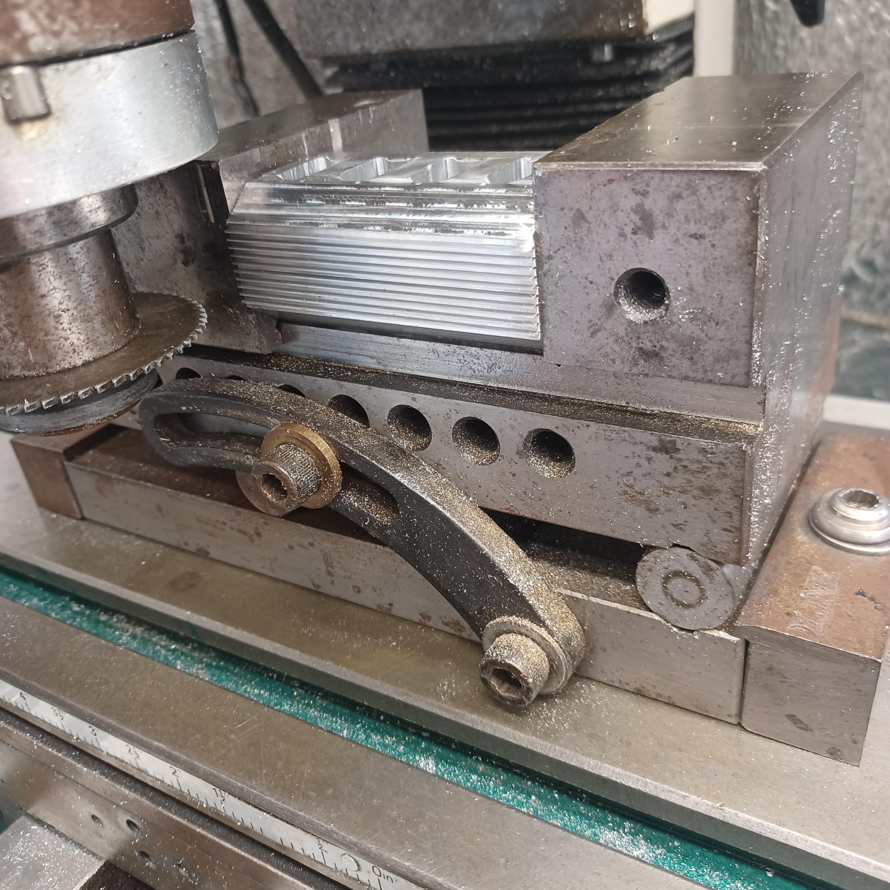

Codi Posted March 4, 2024 Posted March 4, 2024 Morning Charlie, This is getting better by the minute. I like the set-ups and RESULTS of your milling on the engine. You can tell an experienced machinist by not only the quality but the speed in which they work. Impressive and I too am looking forward to the supercharger / induction on this one. Will you be using different metals on the engine as you go along? Thanks and cheers! tim
Big John Posted March 4, 2024 Posted March 4, 2024 (edited) Nice mill work Charles Here's some info on the Roots blown Offy. Edited March 4, 2024 by Big John
charlie libby Posted March 5, 2024 Author Posted March 5, 2024 hi tim probably just my usual aluminum and brass. with some info from andrew , he was here at my shop today ,maybe some german silver. andrew thanks for the visit and the pictures , always great to have visitors. big John, WOW, thank you so much. that is great. where did you get that from? i am going to have it blown up to hang on my wall.
