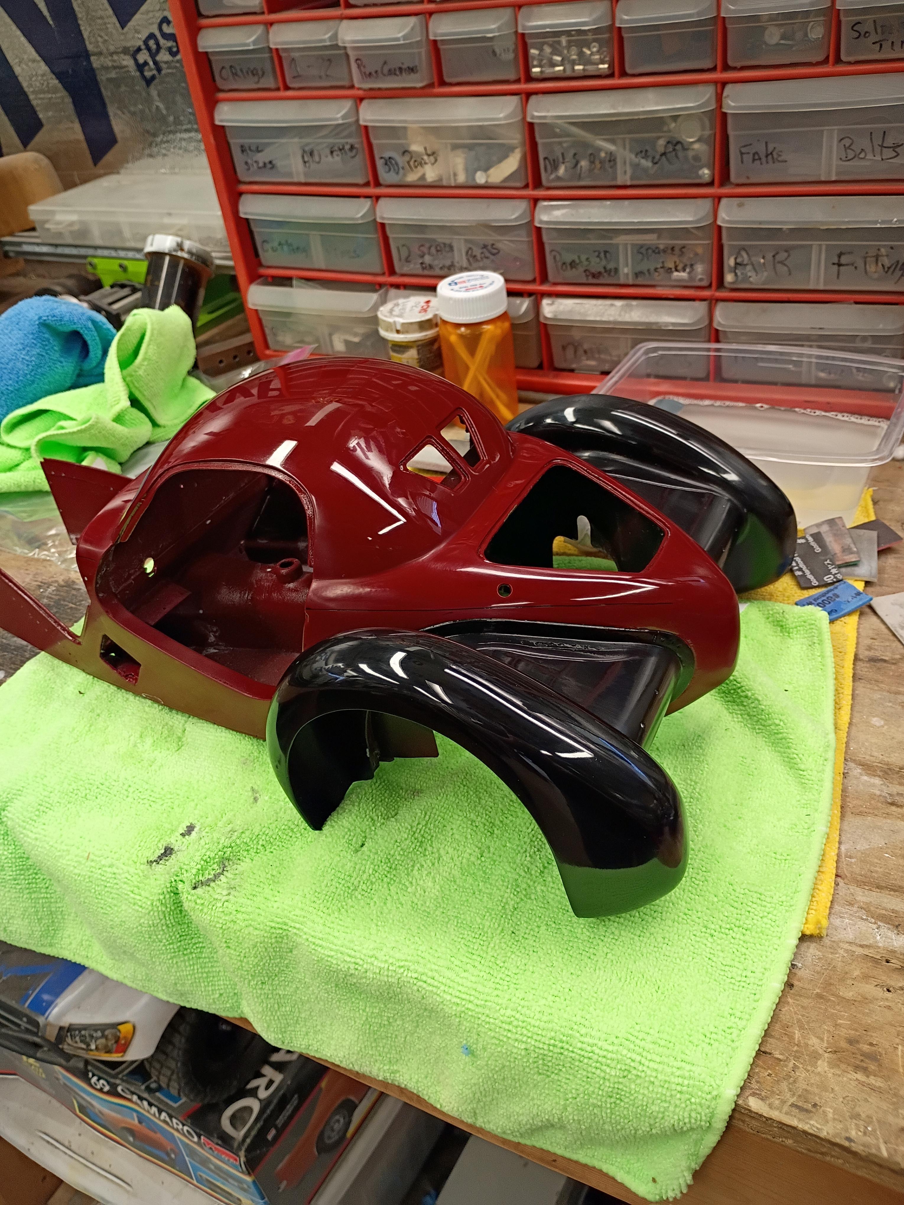

charlie libby Posted March 4 Author Posted March 4 thank you all for your kind thoughts . it is doing well. stiches are all out. got to keep it bandage for at least 4 for weeks. didn't slow me done as much as i thought it would. alot of sanding and painting and alot of plastic gloves. got the front fenders in black with 4 coats of clear. i can sand and buff next week. i have found thru test pieces a huge difference in the red if i paint it over gray primer or black. i painted the entire body black so that i can put it all back together to put 1/16 pin stripe tape down the length of both side with the doors , hood and nose lined up properly then disassemble and paint the red on the parts separately. chassis is going together well, it should its been apart and back together enough times. more time invested in drying time , but i am working on my new project in between.thank you all 2

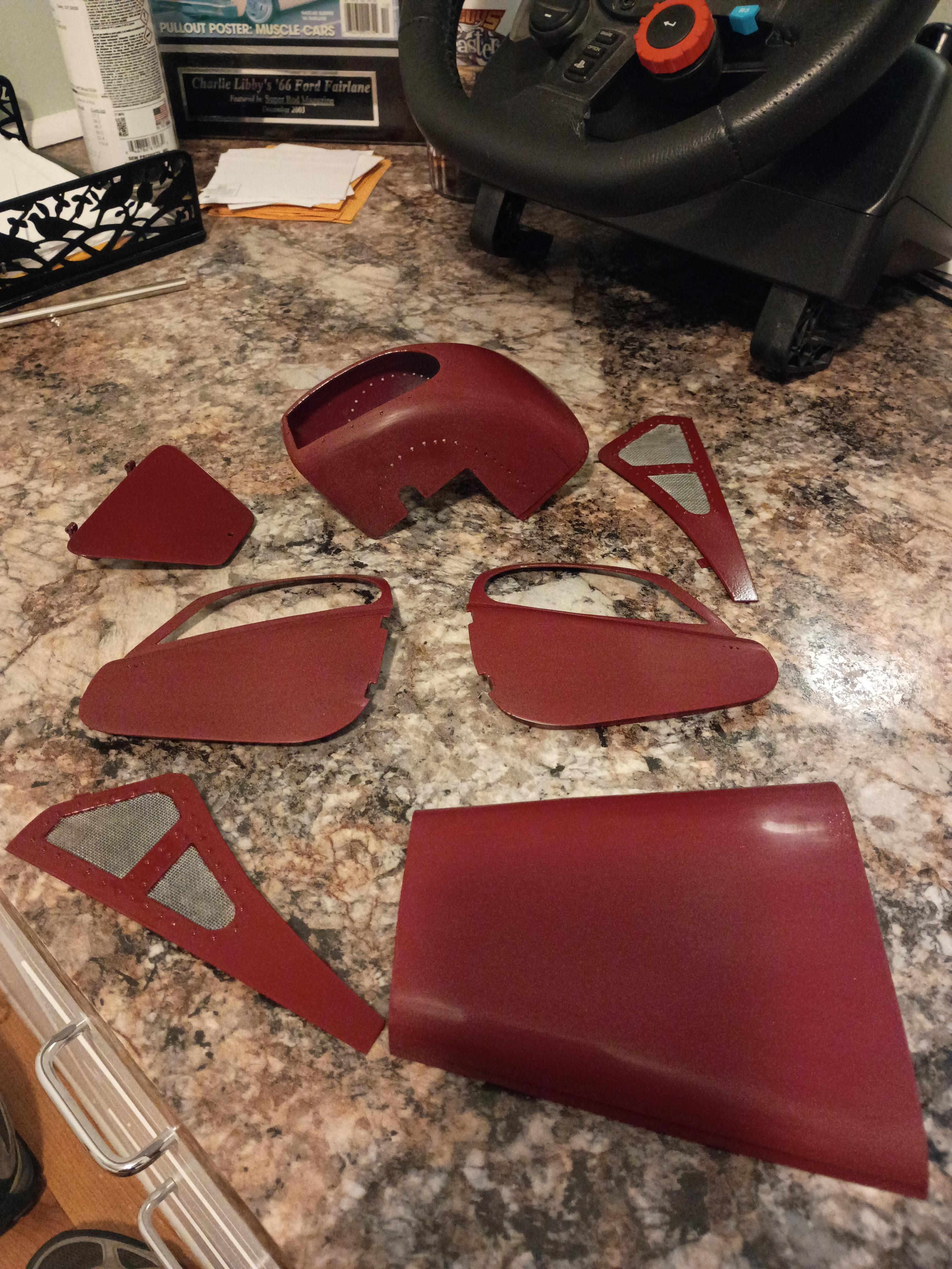

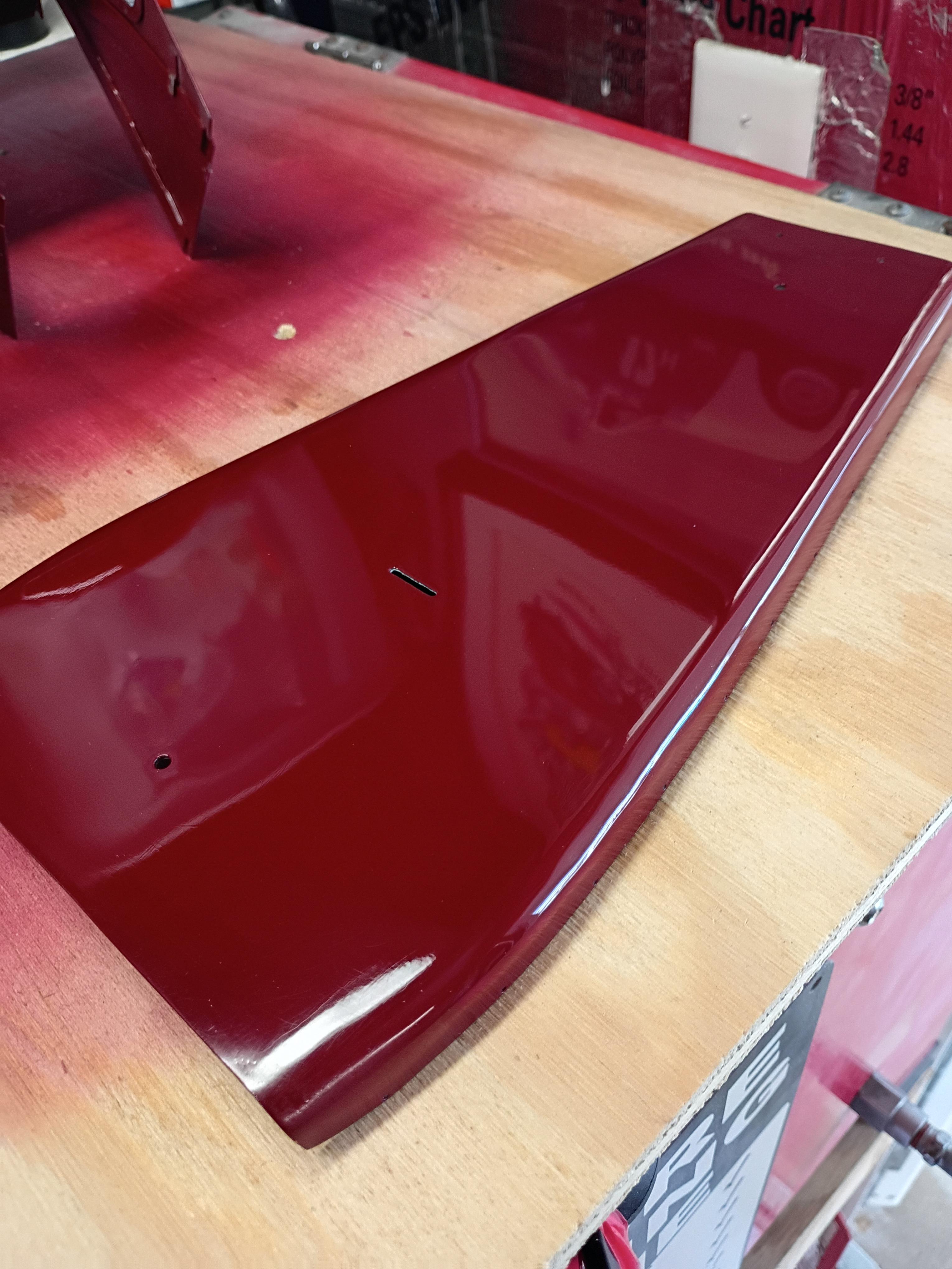

charlie libby Posted March 18 Author Posted March 18 i have been painting ,sanding and polishing. red is coming long well. i thought the pin stripe was going to be .040 but it is more to scale at .015 but hard to see in the pictures. none of these have been sanded or polished . i will start that this saturday. i like to wait a week after painting. the front fenders are sanded but not finished polishing. thanks ken . 1

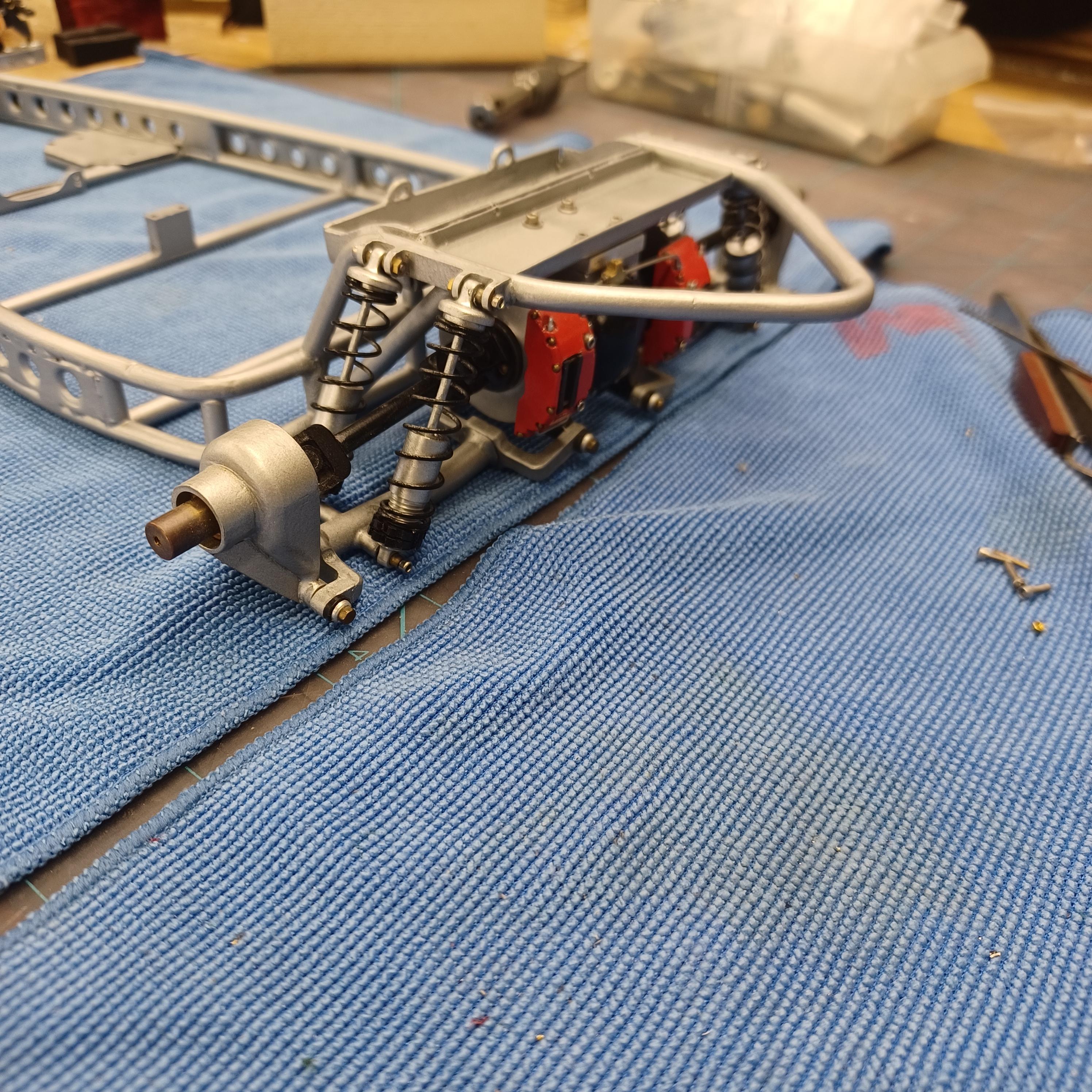

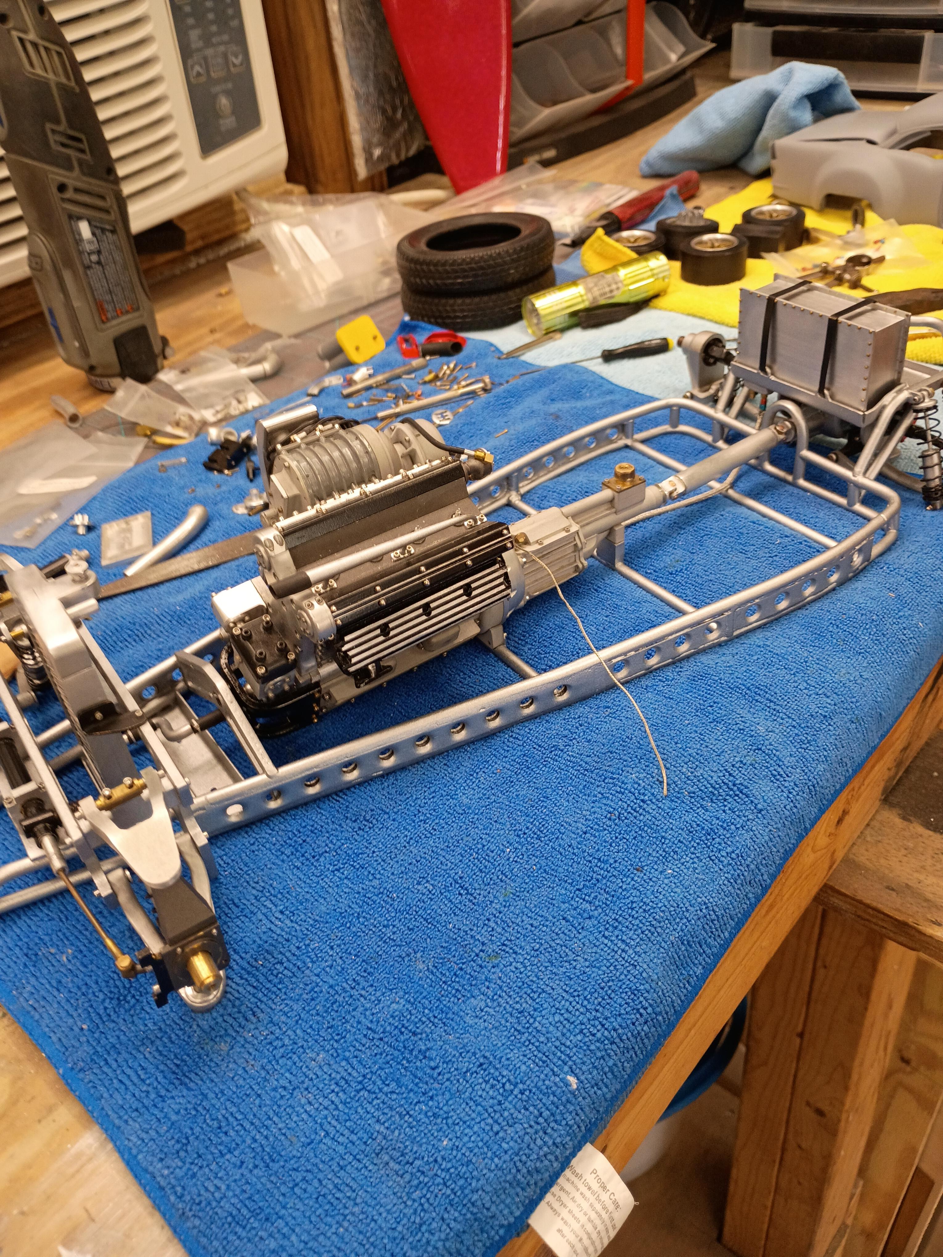

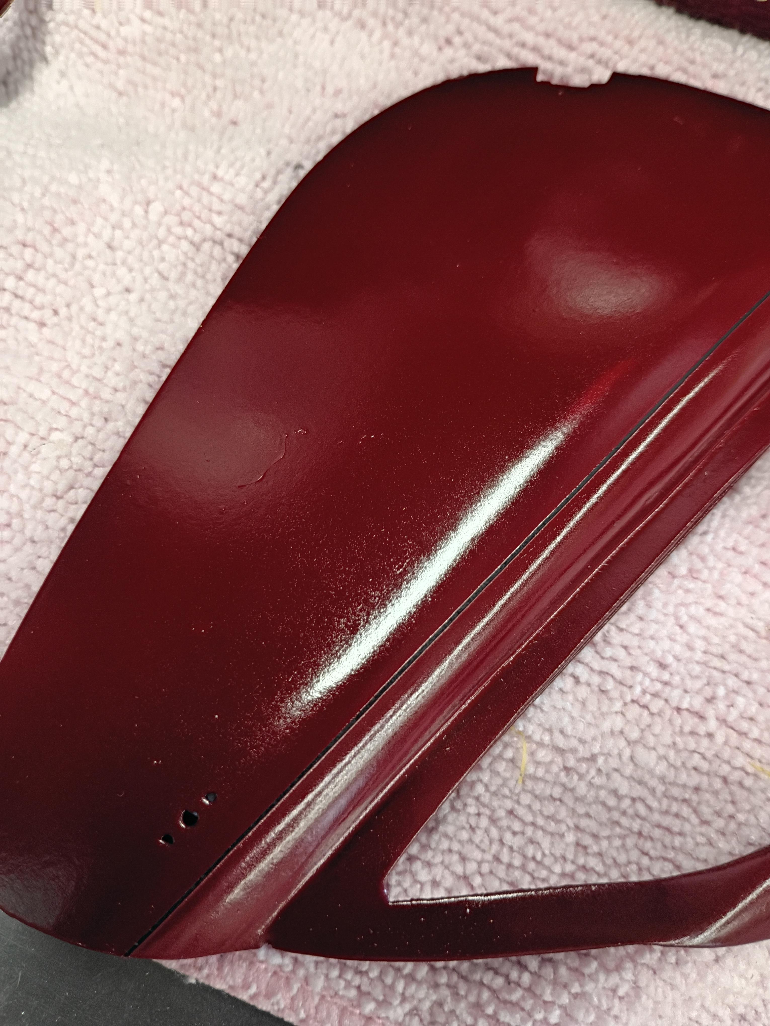

charlie libby Posted April 7 Author Posted April 7 hi everybody, computer has been down .assembly and paint is going well . i had to unsolder some of the chassis and make an adjustment i don't know what happened . it had been assemble before but its ok now. sand blasted and repainted. I think its going together well other then that .all the separate pieces are sanded out to 12,000 grit ready for polish. the body will get the clear this week. i think the colors go together well. looking forward to it being shiny. talk to you again soon. 1
