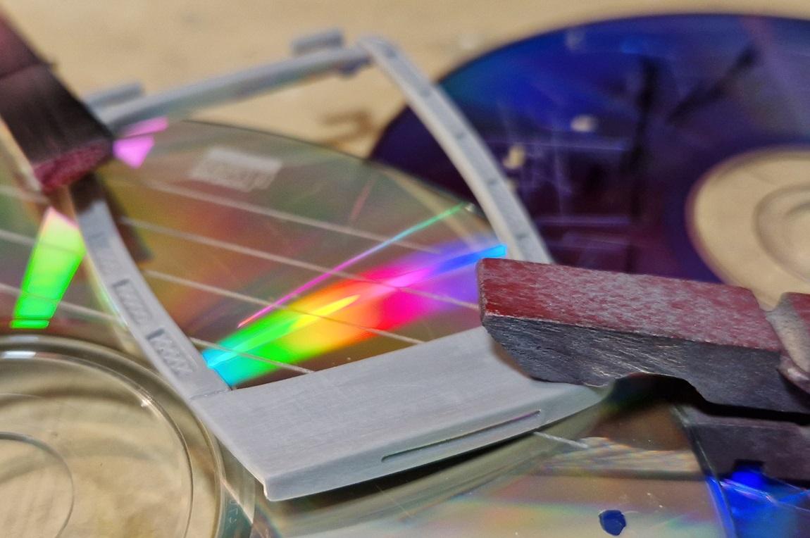

Funkychiken Posted December 29, 2023 Author Posted December 29, 2023 First problem in the engine cover is wonky, it will annoy me when its finished, so I tried a technique I learned in this Forum - peg it in an opposing twist and leave it on the radiator - i had never done this before, but it worked. Too much ast first, it twisted a lot the other way, I then did a moderate twwist back - and now it sits a lot better. Not a perfect fit because its a Revell kit - the details are not quite there for a perfect fit, but good enouth for me. 1

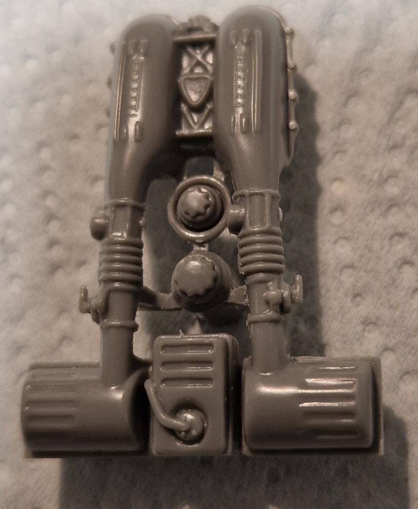

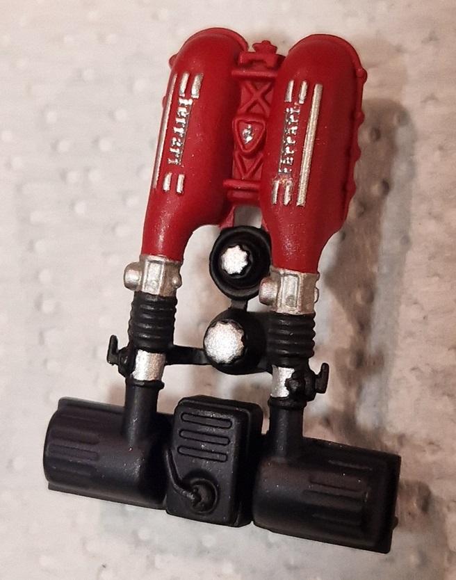

Funkychiken Posted January 5, 2024 Author Posted January 5, 2024 the kit is quite detailed, but the mouldings are not sharp or crisp making it look slightly toy like. I've removed the "ferarri" script off this piece and added photo etch. the silver highlights are probably not true to the original, but anyway... 2

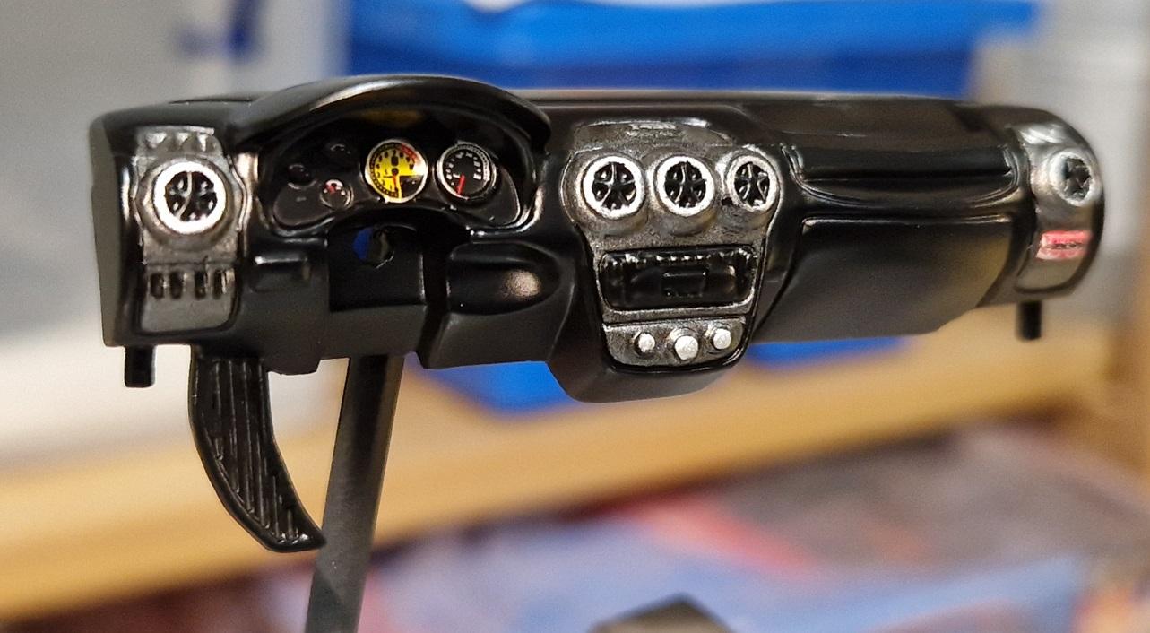

Funkychiken Posted January 7, 2024 Author Posted January 7, 2024 The buttons on the steering wheel are metal studs from Hiroboy, painted clear red...
Funkychiken Posted February 7, 2024 Author Posted February 7, 2024 Interior completed. I didn't like how the mig panel line stained the door cards, so I didn't do the seats. Still not up to the precision of a Tamiya kit, its a bit toy like, but its still an enjoyable build (so far) 2

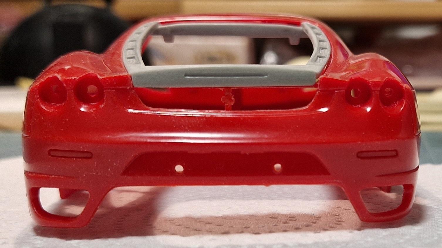

Funkychiken Posted December 28, 2024 Author Posted December 28, 2024 This has now been primered, coated ina few coats of Zero Paints Metallic red mixed with Gloss Black & then coated in Proscale 2K clear. Really not happy with the clear. I think i added too much thinner. last 2 goes on this clear have not turned out well... It looks purple in real life, not brown like the images! 4
beeRS Posted December 29, 2024 Posted December 29, 2024 That paint looks great. Can’t see any problems with the clear from the pictures.
Funkychiken Posted January 23 Author Posted January 23 On 12/29/2024 at 10:24 AM, beeRS said: That paint looks great. Can’t see any problems with the clear from the pictures. Hi Sonny, it was the orange peel and graininess of the clear coat that I wasn't happy with, but it was mostly dust free - which is a first! This has now been sanded and polished using Tamiya 2000 grit wet and dry, then Micromesh 3600, 4000, 6000, 8000, then Tamiya Coarse and Fine polish. The only burn through can be seen on the very tip of the nose in the last image, I'm happy with how its turned out - now I need to mask and paint the trim! 3

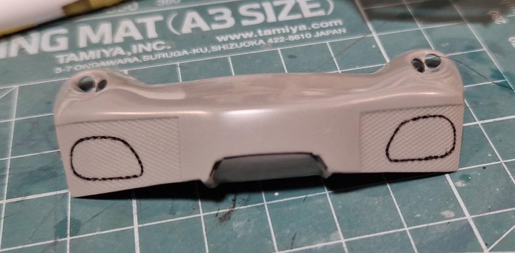

Funkychiken Posted Wednesday at 10:06 PM Author Posted Wednesday at 10:06 PM Masked inside & out for window trim & front air intakes I made the masks for the front intakes with some exposure to the front face & wiped off the excess with Thinner. Not long left now... 5
beeRS Posted Saturday at 06:19 AM Posted Saturday at 06:19 AM Nice work. Masking the curves for the front air intake can’t have been easy.
