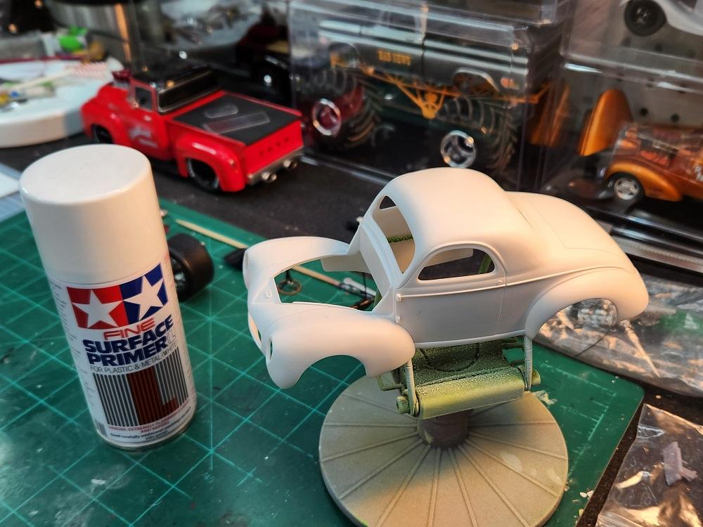

Zippi Posted January 30, 2024 Author Posted January 30, 2024 Well....it wasn't the ideal day to paint as it was 35° outside with 85% humidity. I fired up the ole garage heater and got it up to 65° and got the humidity down to 49% so I got after it and shot some primer on the 41 Willy's. The last two cans of Tamiya white surface primer that I've bought I've had issues with. Even though I shake the can up and I always set it in a container of hot water for 5-10 min the paint at times wants to come out in globs. Not sure what is up with the paint. I'll buy one more can and if I have the same issue I'm going to stop using it. 1
TarheelRick Posted January 30, 2024 Posted January 30, 2024 On 1/9/2024 at 11:42 AM, Zippi said: The wire in the insulation is already a tight fit so well see what happens. I've never done it this way before. I have found carefully sticking a common straight pin into the insulation will usually open it enough to allow the wire to go in and most often the insulation will reduce itself to original size rather quickly. Looking forward to more updates. You are doing some excellent work on this Willys. 1
TopherMcGinnis Posted January 30, 2024 Posted January 30, 2024 I use Vallejo primer with my airbrush. It works well with acrylics, lacquer and HOK.
Zippi Posted January 30, 2024 Author Posted January 30, 2024 9 minutes ago, TarheelRick said: I have found carefully sticking a common straight pin into the insulation will usually open it enough to allow the wire to go in and most often the insulation will reduce itself to original size rather quickly. Looking forward to more updates. You are doing some excellent work on this Willys. Thanks man. Good idea. 9 minutes ago, TopherMcGinnis said: I use Vallejo primer with my airbrush. It works well with acrylics, lacquer and HOK. Thank's for the info. I used to use Rust-Oleum flat white primer that worked really well but had the same issue with it and switched to Tamiya.
