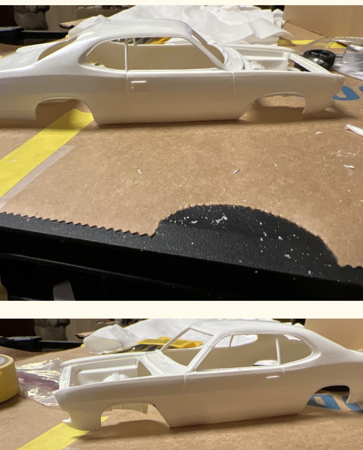

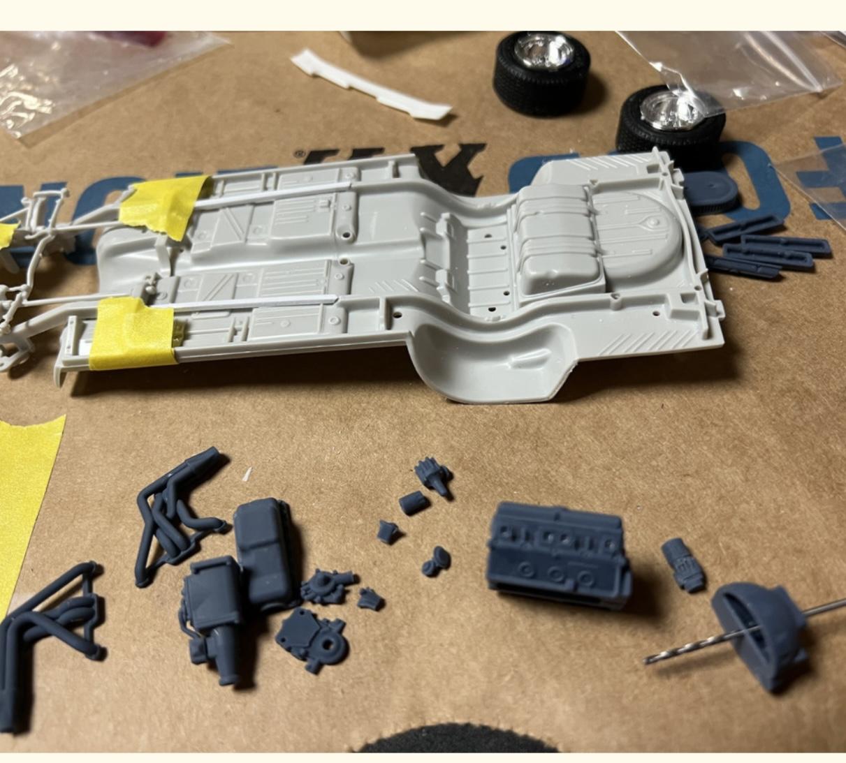

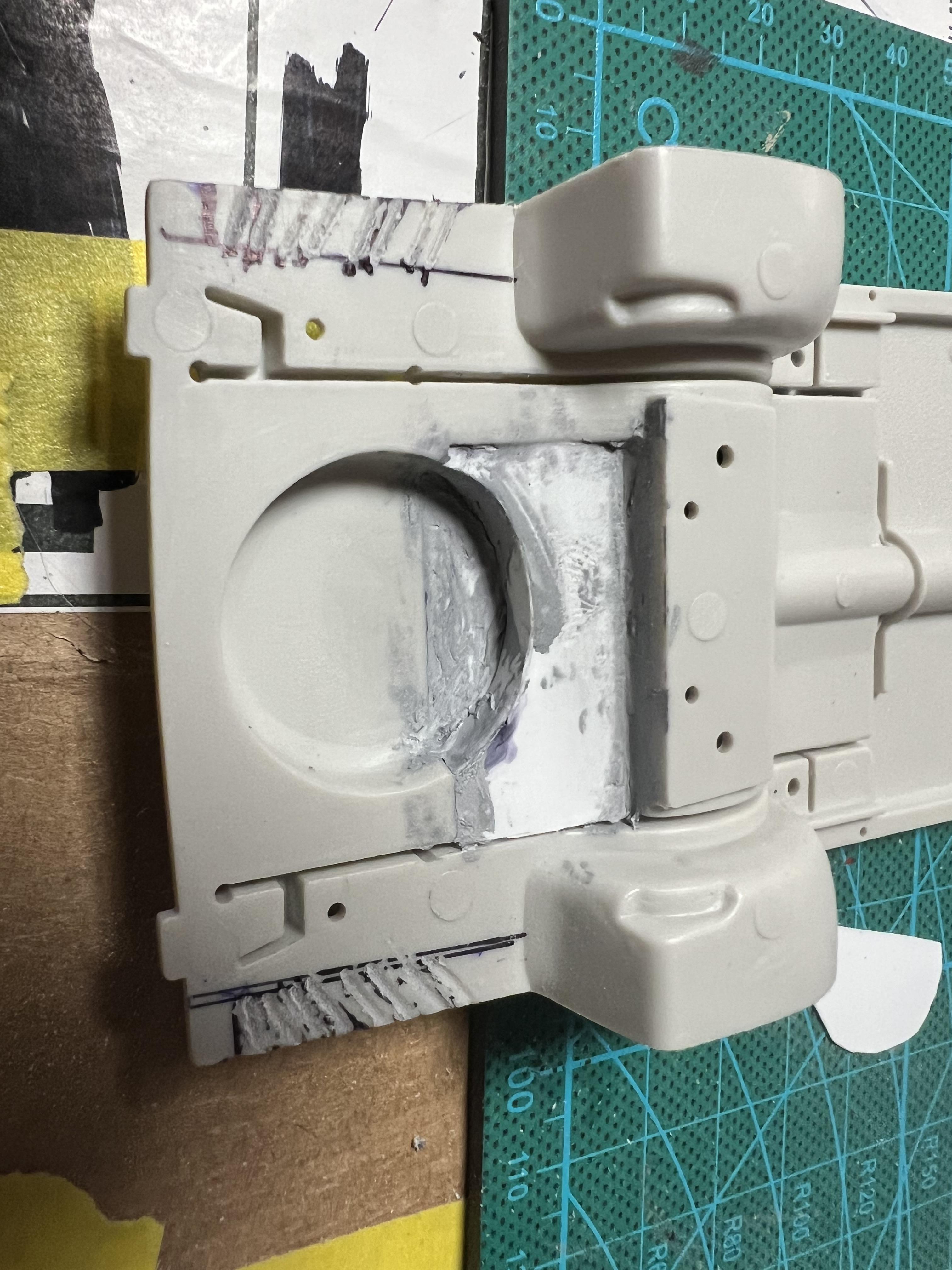

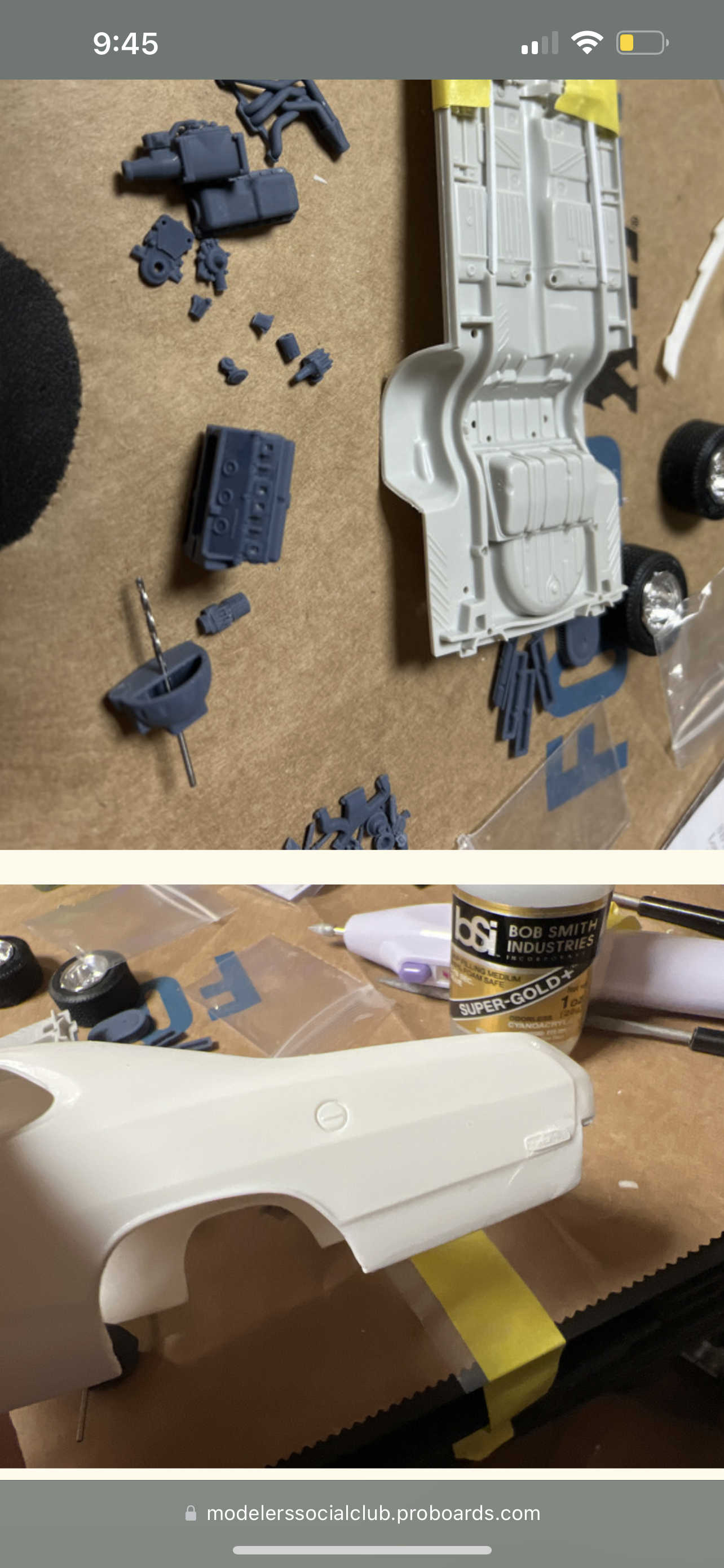

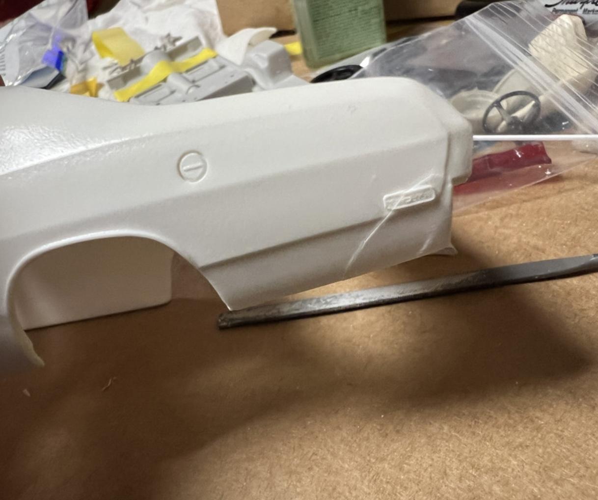

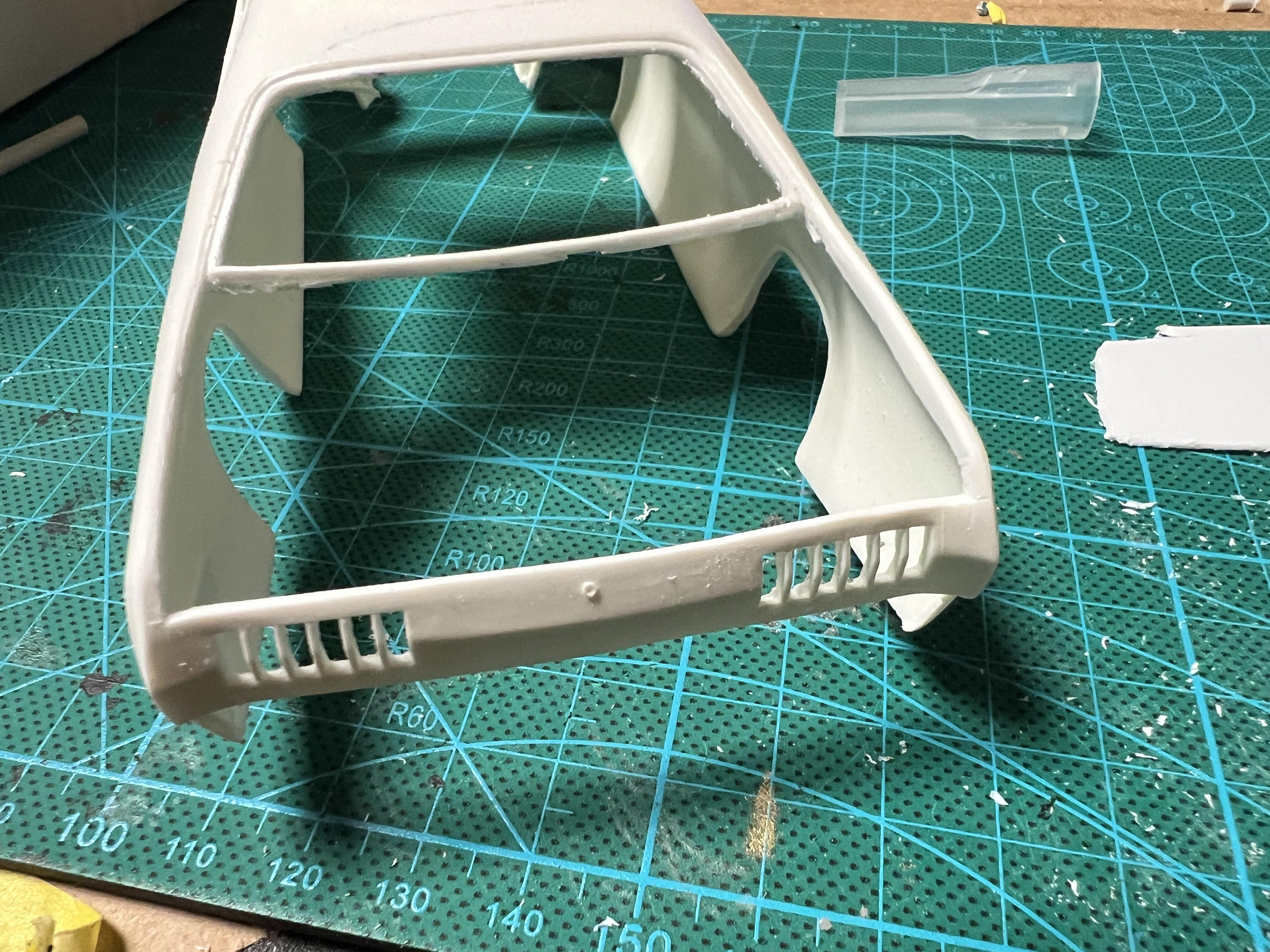

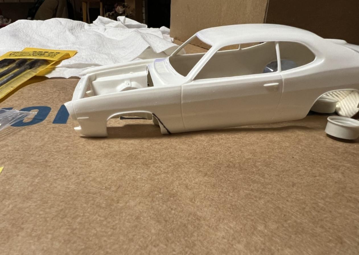

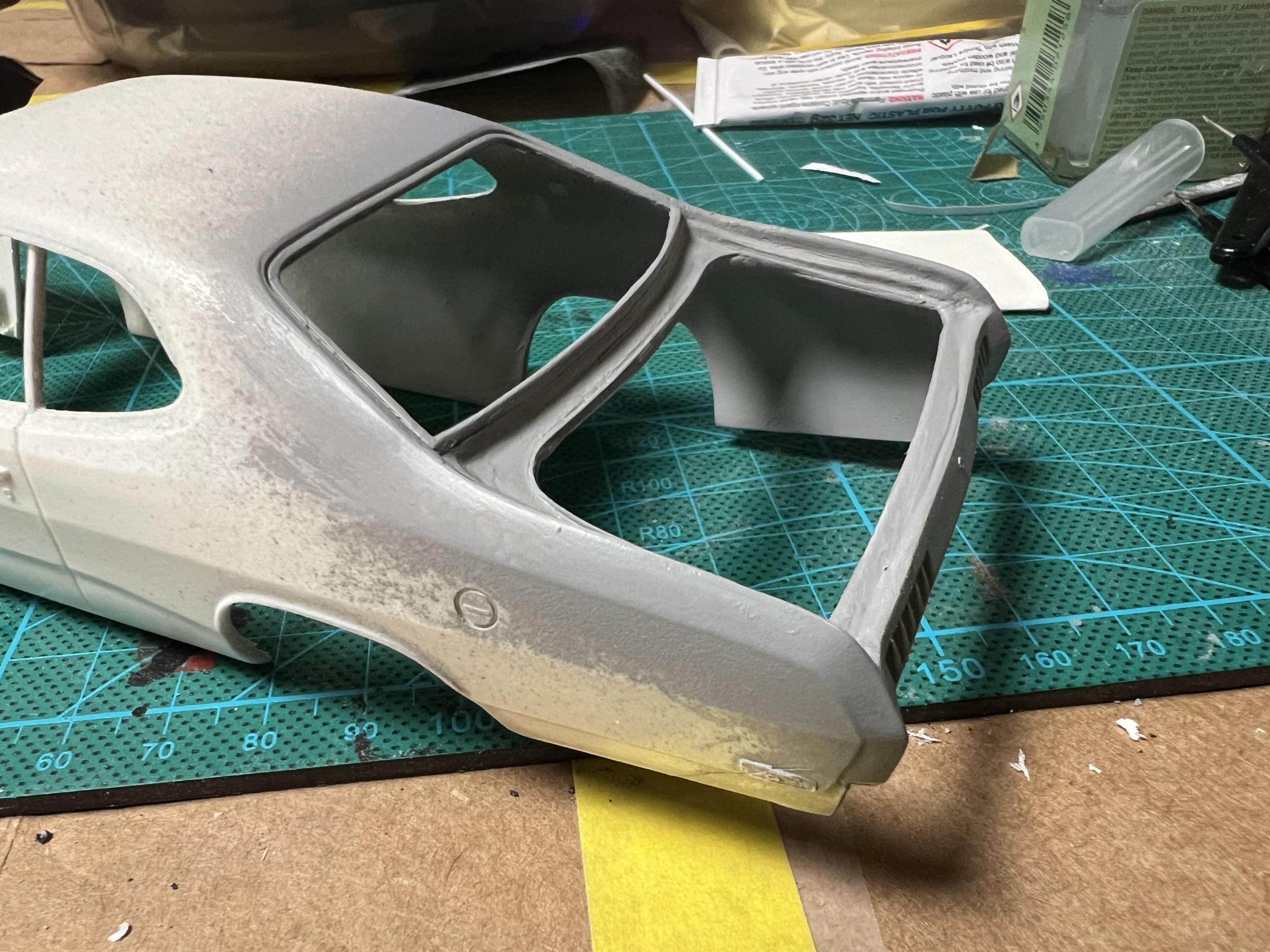

Moparman18064 Posted January 23, 2024 Author Share Posted January 23, 2024 I got a start on it, lots of filing just to get grille to fit, cleaned up a bunch of flash. While fitting pieces, I (oops) found out how brittle old resin can be by breaking the rear quarter panel while putting chassis in. Just what I wanted, more body work. I started shaping front fender openings. I also started working on engine/ trans/ header fit. I will have to do some work at trans crossmember to clear shifter. I also made the subframe connectors. More to come 5 Quote Link to comment Share on other sites More sharing options...

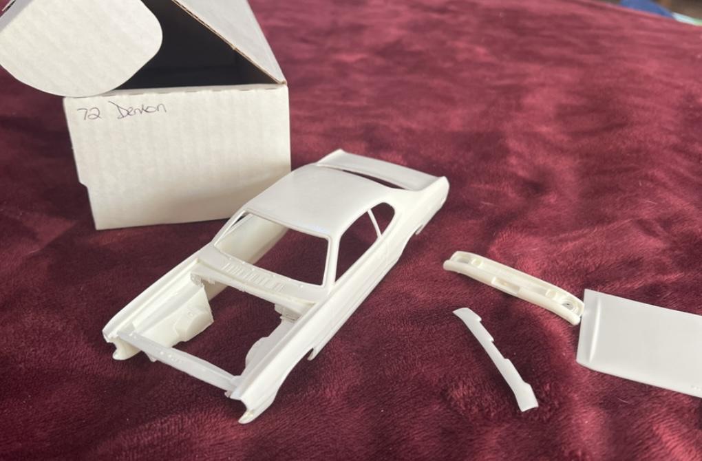

1972coronet Posted January 23, 2024 Share Posted January 23, 2024 Where'd you get the 1972 grille ? Link, please. Quote Link to comment Share on other sites More sharing options...
Moparman18064 Posted January 23, 2024 Author Share Posted January 23, 2024 2 minutes ago, 1972coronet said: Where'd you get the 1972 grille ? Link, please. It was all part of the resin kit that I bought years ago on EBay 1 Quote Link to comment Share on other sites More sharing options...

dragcarz Posted January 24, 2024 Share Posted January 24, 2024 You most definitely have my attention, I purchased this same resin kit for the 72 Grille for my current build. I’m following! 1 Quote Link to comment Share on other sites More sharing options...
Moparman18064 Posted January 24, 2024 Author Share Posted January 24, 2024 (edited) 44 minutes ago, dragcarz said: You most definitely have my attention, I purchased this same resin kit for the 72 Grille for my current build. I’m following! Do you know who made the kit? I can’t remember. I’ve been watching your build and the one Francis is doing and am blown away by both. Edited January 24, 2024 by Moparman18064 Quote Link to comment Share on other sites More sharing options...

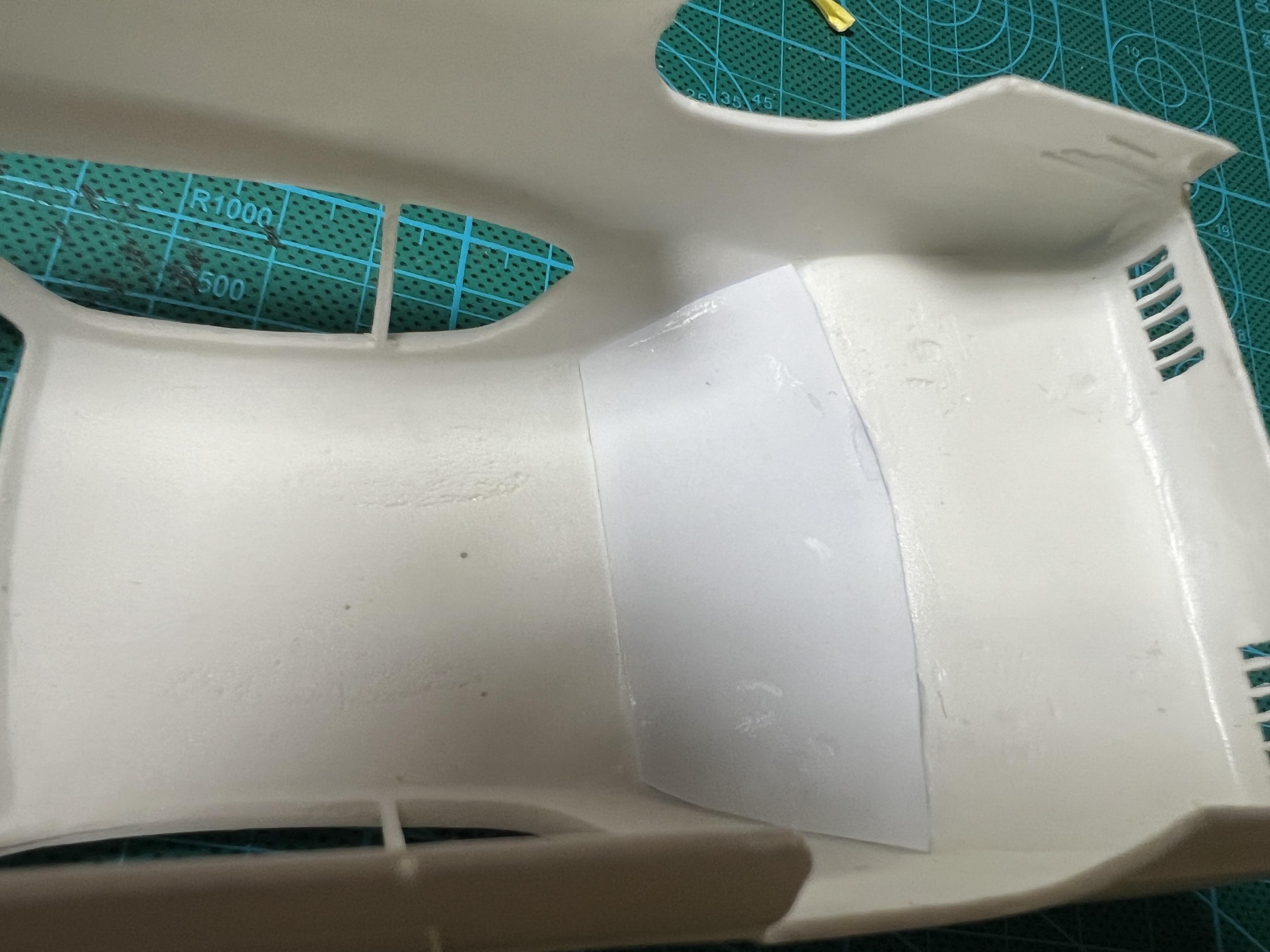

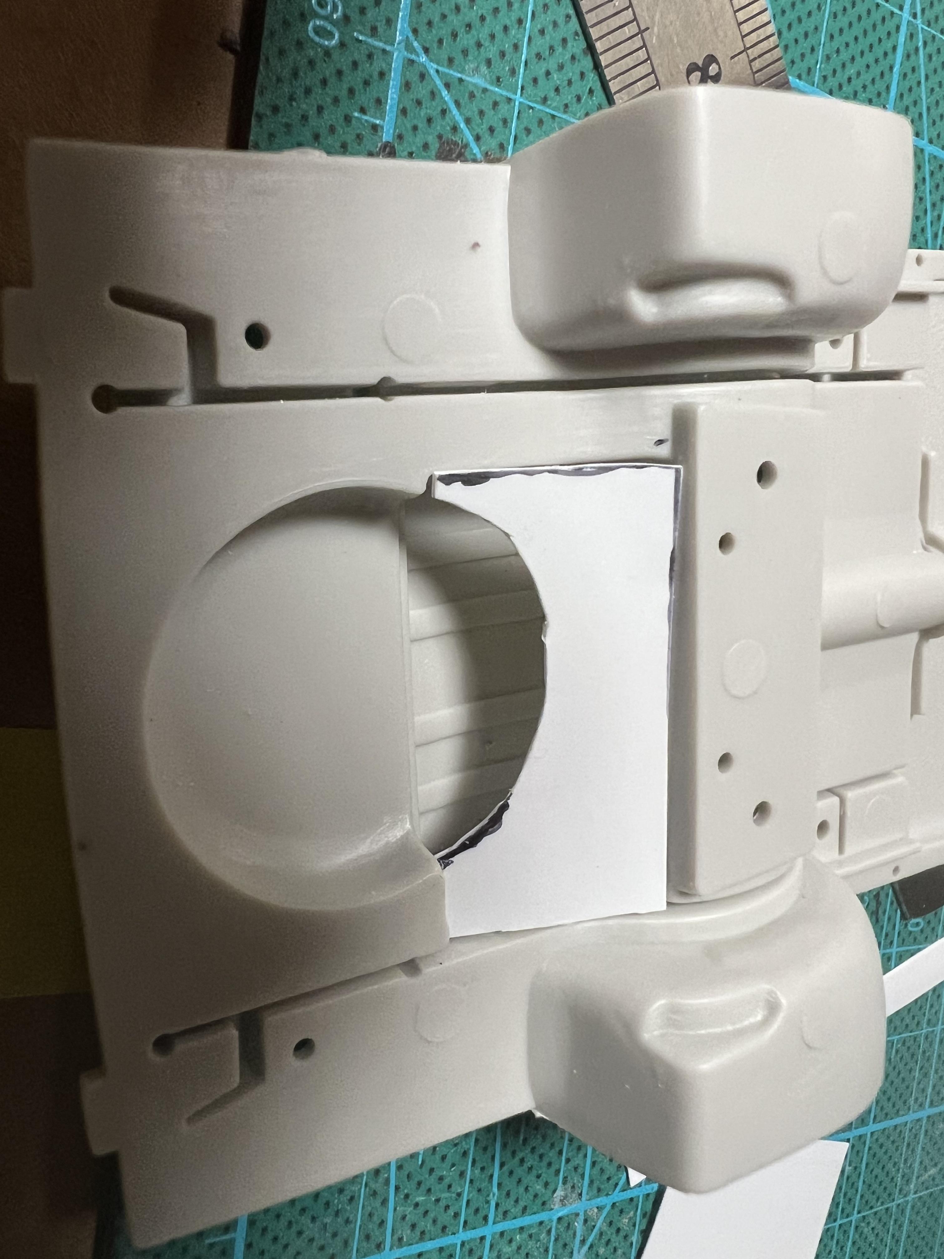

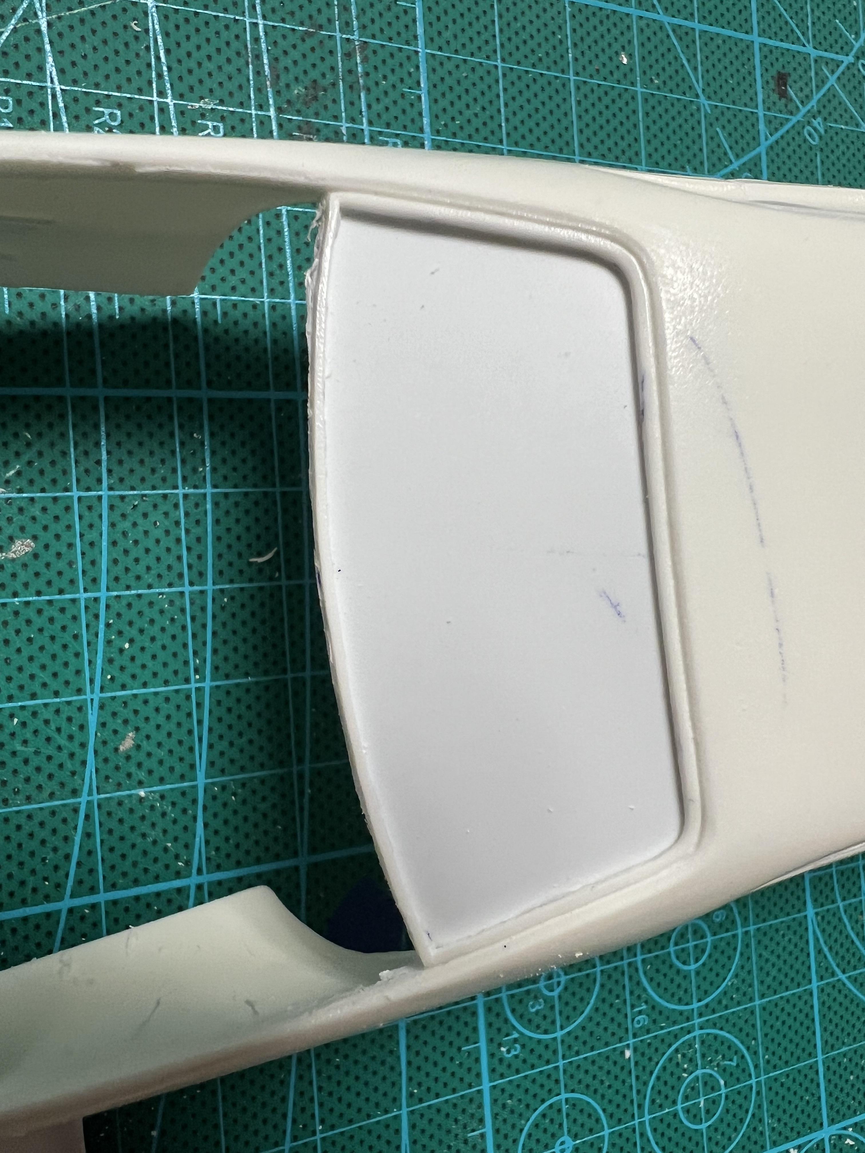

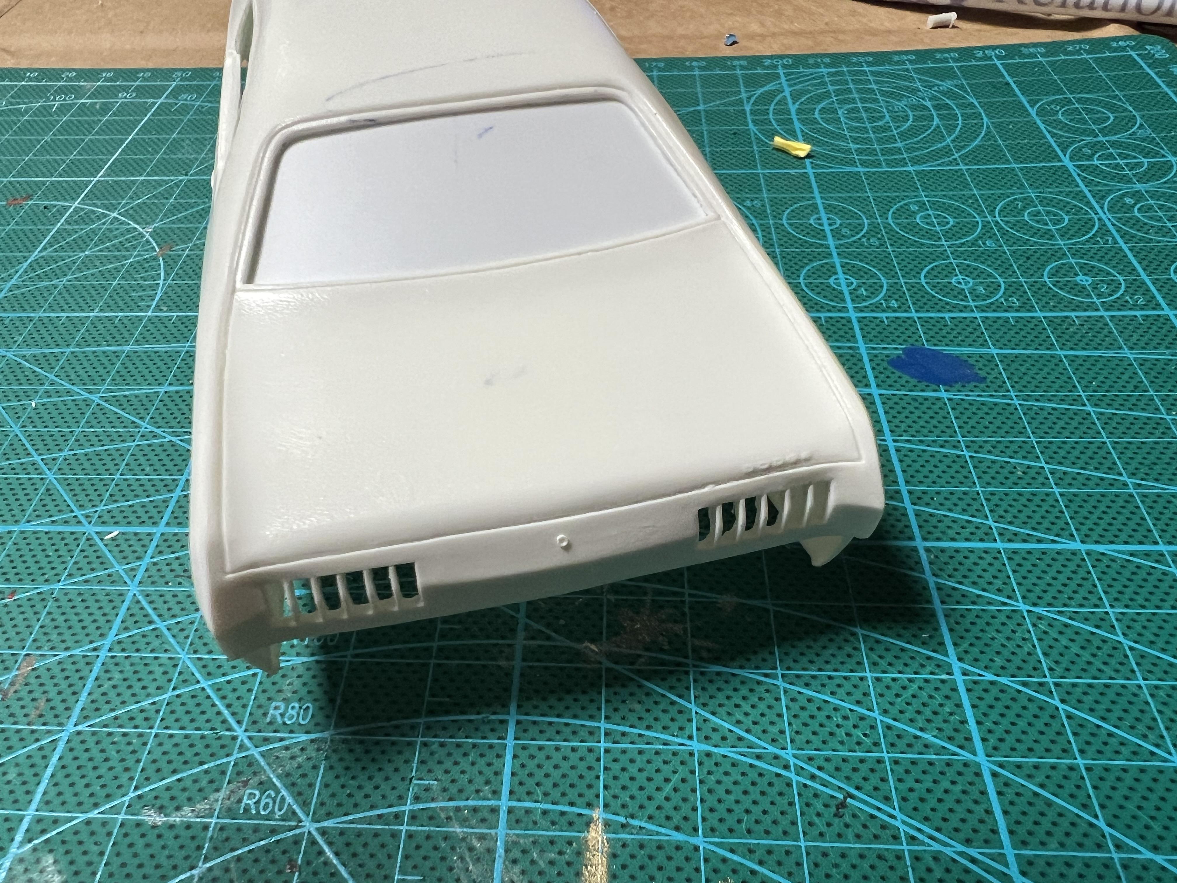

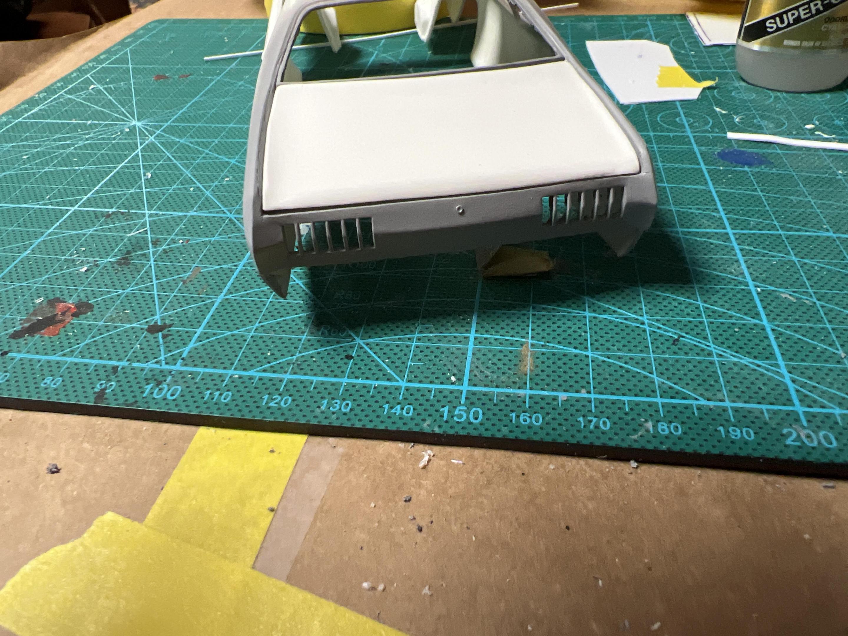

Moparman18064 Posted January 24, 2024 Author Share Posted January 24, 2024 On to the scary part. I made a cardboard template of rear window area, cut out a piece of .020 styrene sheet to match and glued onto body to stiffen up for the next operation. Then, using the back of a # 11 blade, scribed trunk lines over and over. As a result, I was able to remove trunk lid without breaking window trim, as there is no Dutchman panel. 6 Quote Link to comment Share on other sites More sharing options...
bobss396 Posted January 24, 2024 Share Posted January 24, 2024 On the breaking-body thing, I have started a while ago taking material off the sides of the chassis before doing too much. I remove maybe .050" to .062" per side, it makes fitting the chassis a ton easier. Any sharp corners, I radius them with a sanding stick. Not too much, any little bit helps. On regular plastic bodies, I'll also sand some off from behind the rocker panels. Most kits for some inane reason, the bodies curve in at the bottom quite a bit. 1 Quote Link to comment Share on other sites More sharing options...

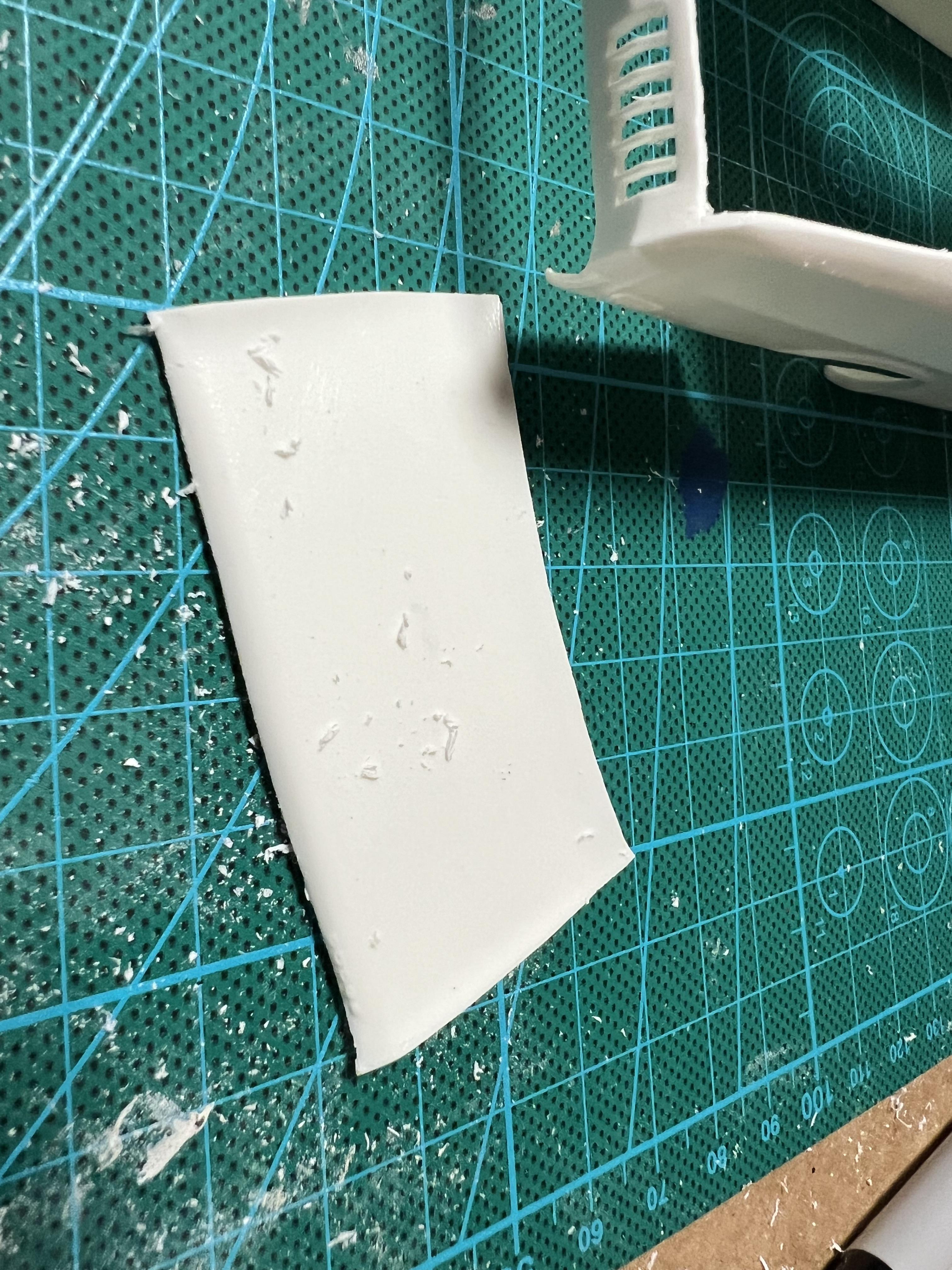

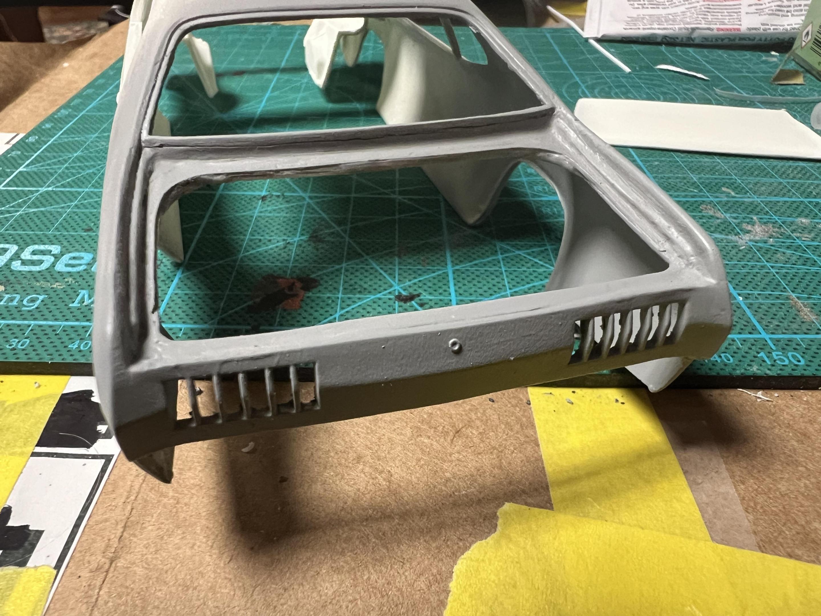

Moparman18064 Posted January 24, 2024 Author Share Posted January 24, 2024 Trimmed away template, this is where we are. The next thing will be to add gutters to strengthen it, and have something for trunk to close against 6 Quote Link to comment Share on other sites More sharing options...
Moparman18064 Posted January 24, 2024 Author Share Posted January 24, 2024 1 hour ago, bobss396 said: On the breaking-body thing, I have started a while ago taking material off the sides of the chassis before doing too much. I remove maybe .050" to .062" per side, it makes fitting the chassis a ton easier. Any sharp corners, I radius them with a sanding stick. Not too much, any little bit helps. On regular plastic bodies, I'll also sand some off from behind the rocker panels. Most kits for some inane reason, the bodies curve in at the bottom quite a bit. Thank you for the great tip. This is only the second build I am doing after being away from it for 30 years. I know this is a bit ambitious, but I want to build my skills back up further than they ever were. Quote Link to comment Share on other sites More sharing options...
bobss396 Posted January 24, 2024 Share Posted January 24, 2024 2 hours ago, Moparman18064 said: Thank you for the great tip. This is only the second build I am doing after being away from it for 30 years. I know this is a bit ambitious, but I want to build my skills back up further than they ever were. I got back into the hobby in 1995, I was away for 20 + years. I figured I would be good... not really. I was using tube glue, knew nothing about primer or removing mold flash. You will get there, little by little. Quote Link to comment Share on other sites More sharing options...
dragcarz Posted January 25, 2024 Share Posted January 25, 2024 13 hours ago, Moparman18064 said: Do you know who made the kit? I can’t remember. I’ve been watching your build and the one Francis is doing and am blown away by both. Like you, I purchased the resin kit several years ago, and I don’t know who made the kit. I thought I purchased it from Slixx decals. They still list a 72 Demon under the Competition Resin Pro Stock. It looks a little different from what I have, and has an interior tub. Maybe it’s been modified over the years, the grille looks the same, and the front wheel openings are still incorrect. Thanks! 1 Quote Link to comment Share on other sites More sharing options...

Moparman18064 Posted January 27, 2024 Author Share Posted January 27, 2024 12 hours ago, Keef said: Loving this one so far! I’ve always been terrified of resin bodies. They feel so fragile to me. I’ve used resin hoods and parts before but, bodies always scared me. I’m watching this one. Mopar or NoCar! I definitely understand where you are coming from. This is my first resin build. It got really hairy after I cut out the reinforcement I put in, but is stiffening up with the styrene gutters I have now put in. The thickness of the resin just in the trunk lid varied between .049 and .096, filing it was a very delicate procedure, to be sure. I agree with the Mopar or no car, but appreciate anything nice also. 1 Quote Link to comment Share on other sites More sharing options...

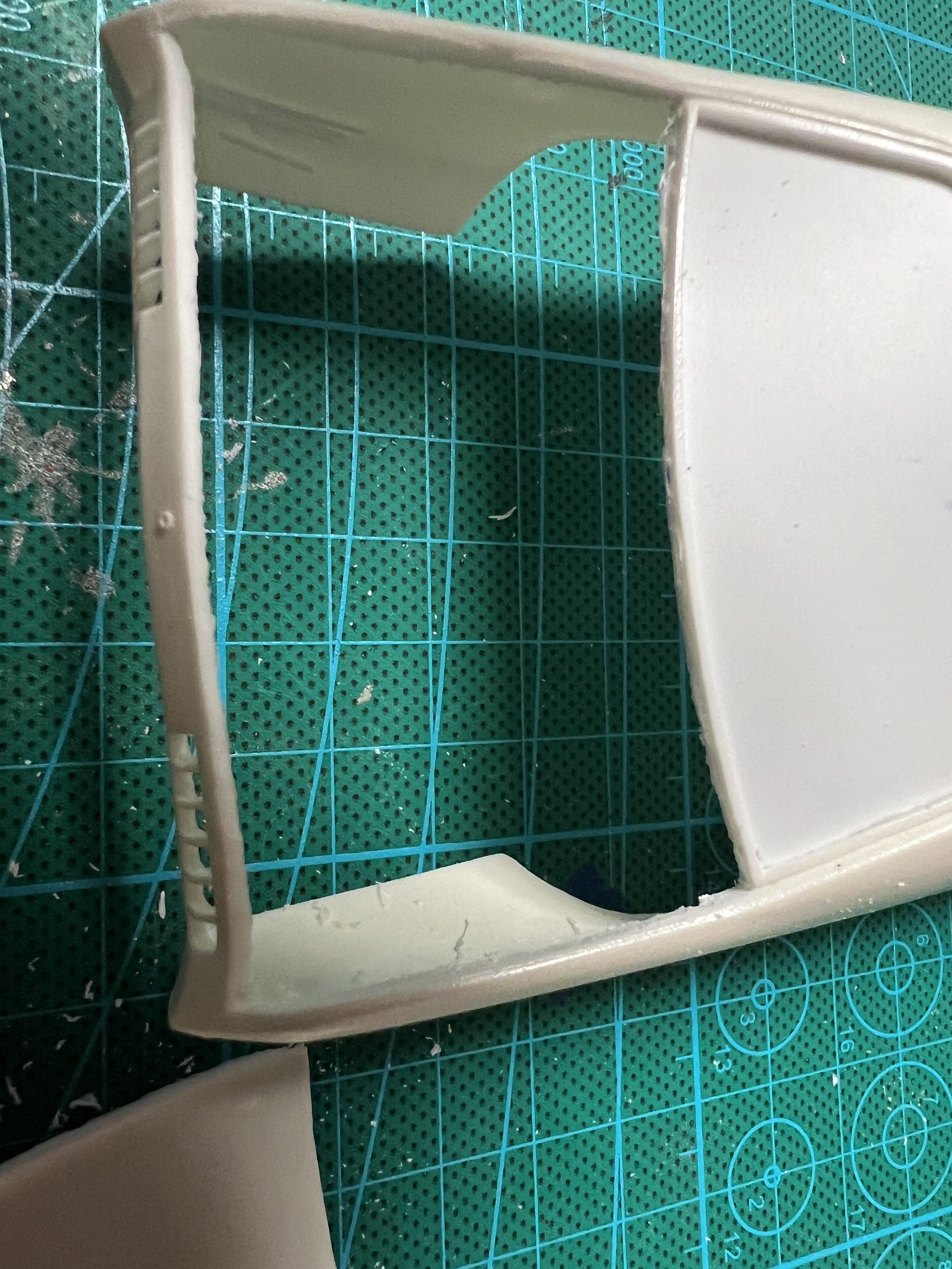

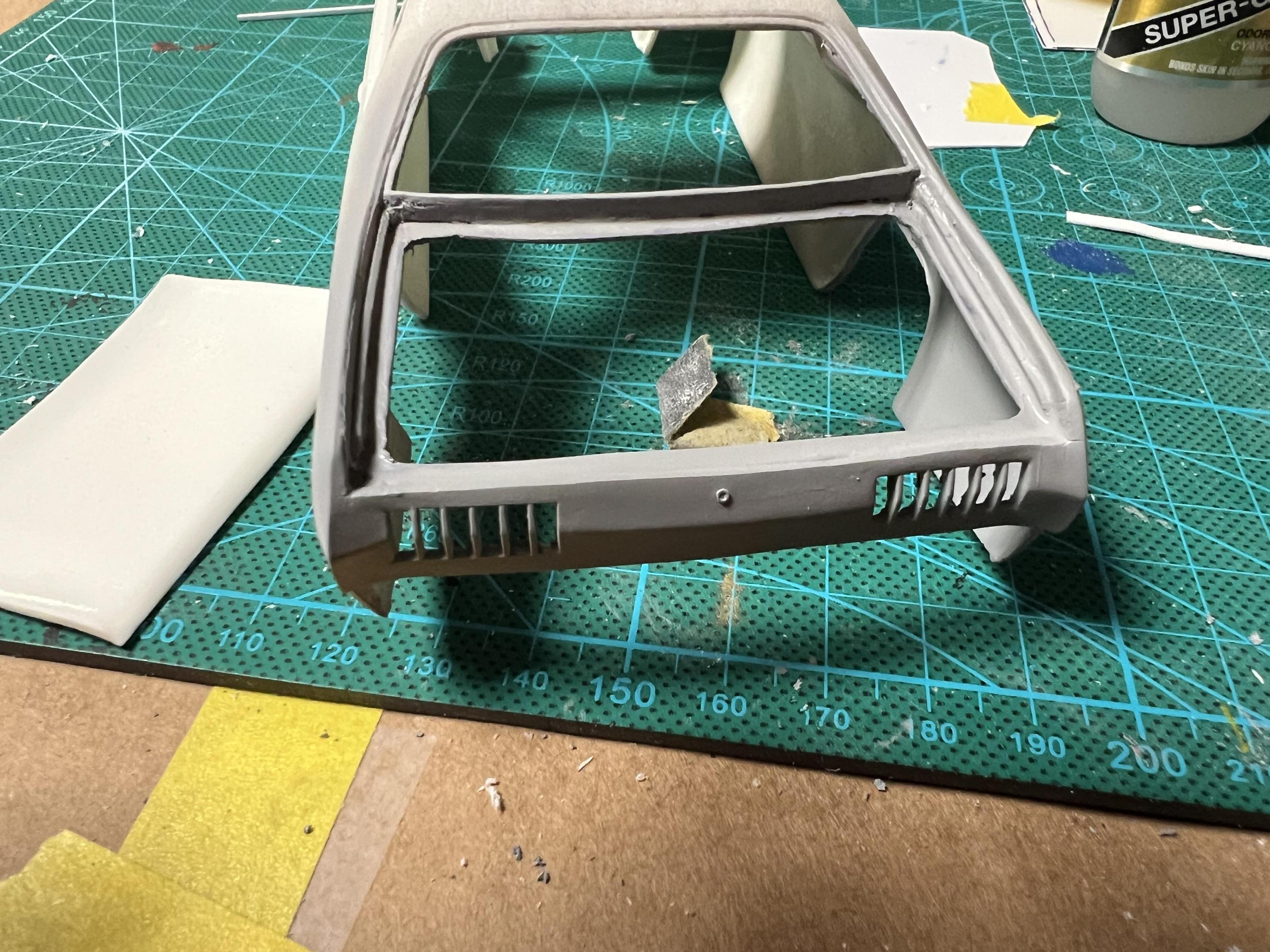

Moparman18064 Posted January 27, 2024 Author Share Posted January 27, 2024 (edited) In progress picture of trunk gutter, still have some shaping, weatherstrip channel to install. It’s a little rough yet, but getting there Edited January 27, 2024 by Moparman18064 Add photo 5 Quote Link to comment Share on other sites More sharing options...
Moparman18064 Posted January 29, 2024 Author Share Posted January 29, 2024 Weatherstrip channel on, some fine sanding should make it presentable 4 Quote Link to comment Share on other sites More sharing options...

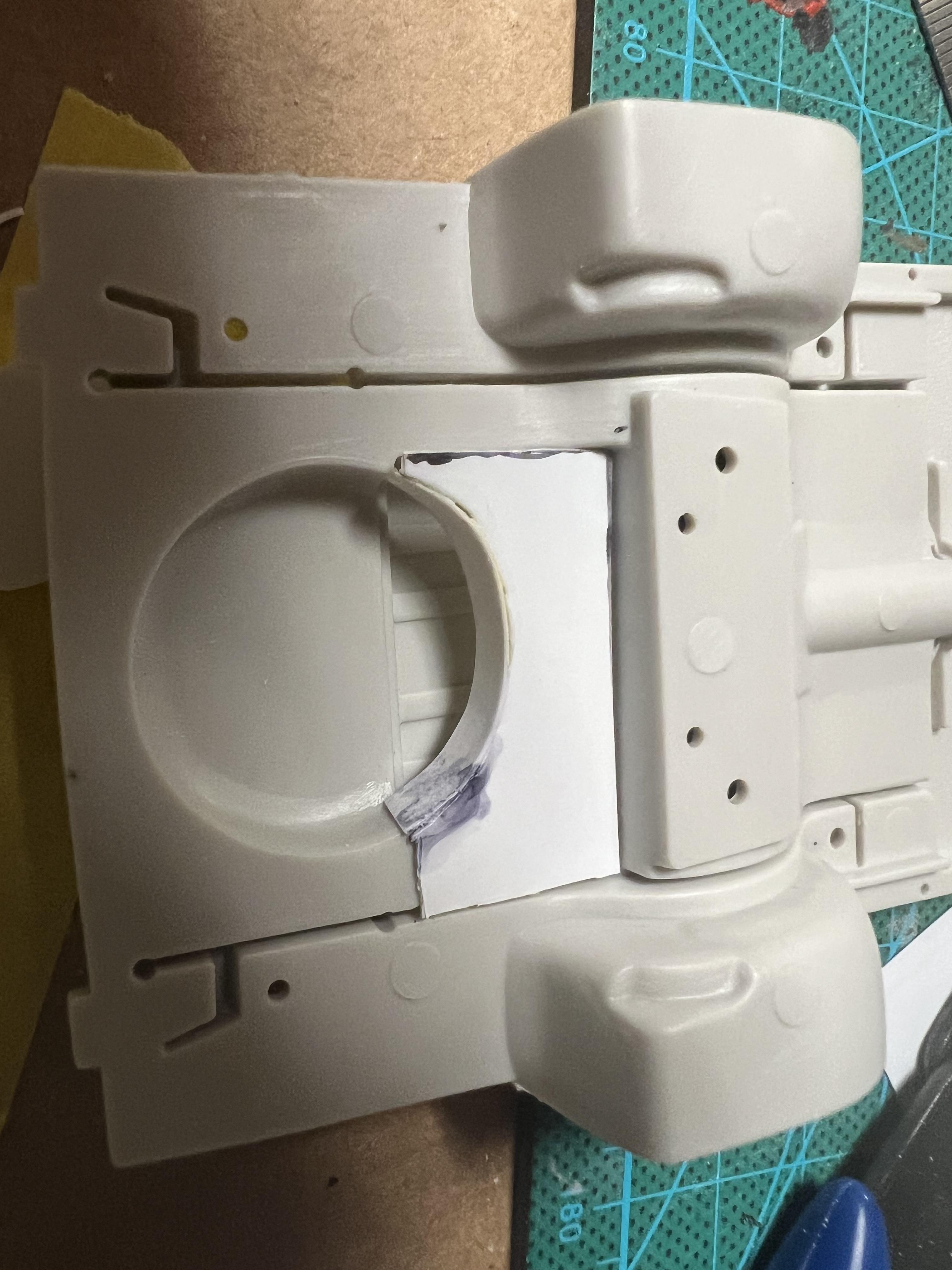

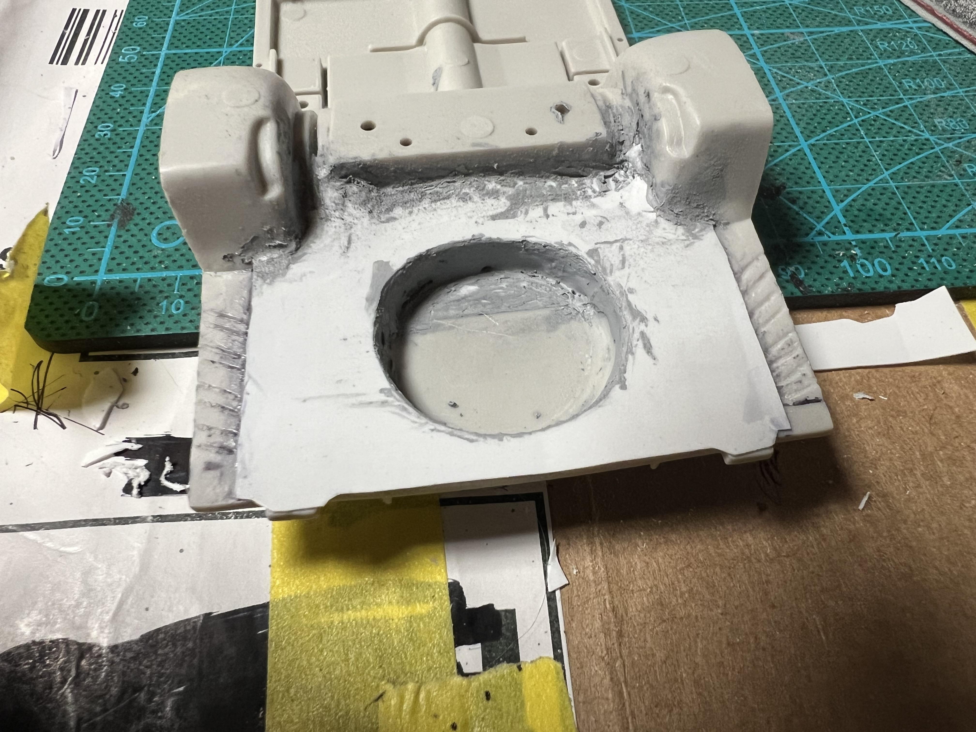

Moparman18064 Posted January 31, 2024 Author Share Posted January 31, 2024 (edited) Working on trunk floor, as it will be seen Edited January 31, 2024 by Moparman18064 1 Quote Link to comment Share on other sites More sharing options...
